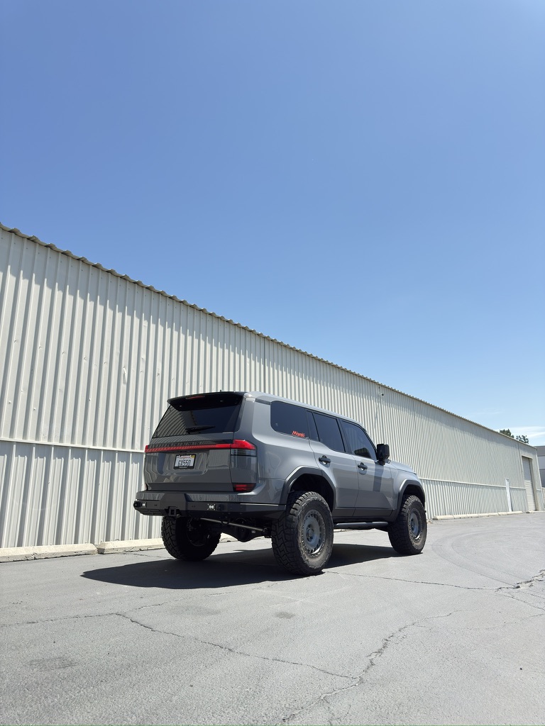

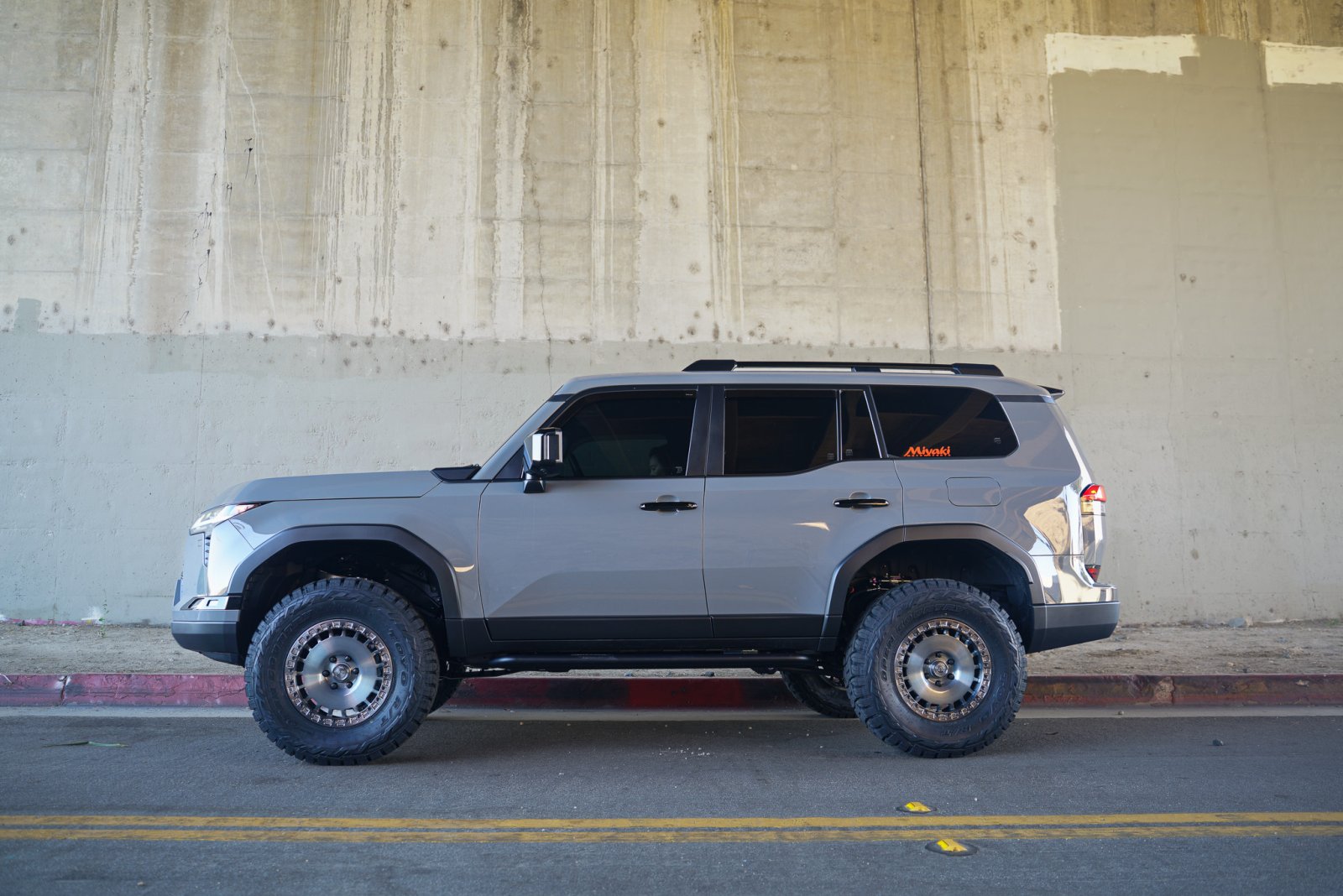

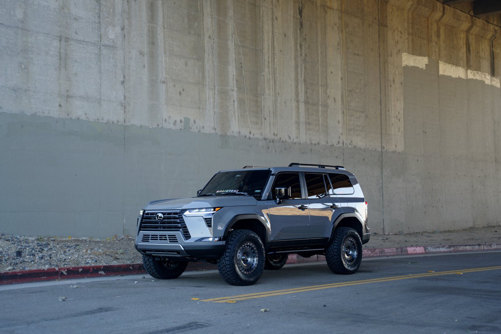

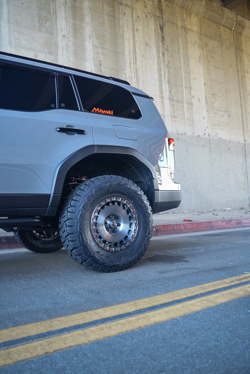

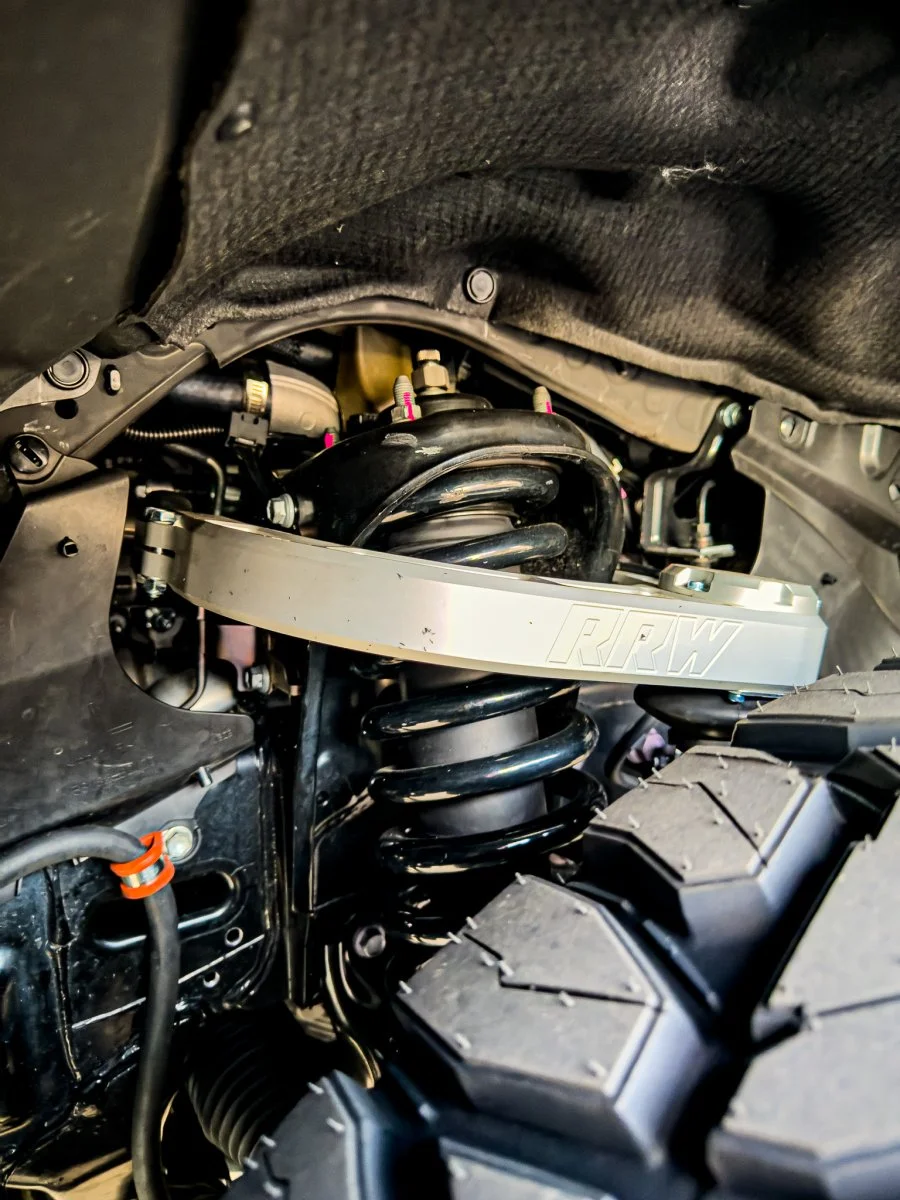

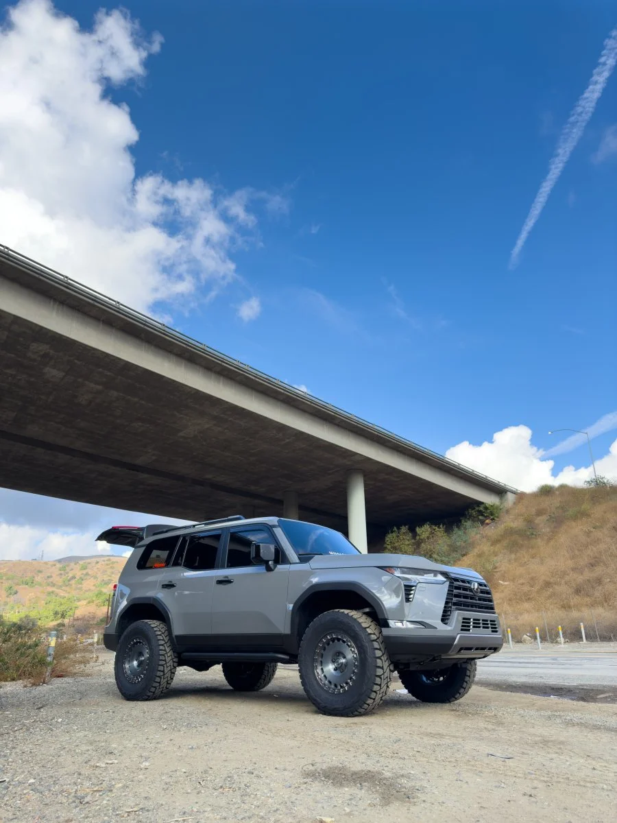

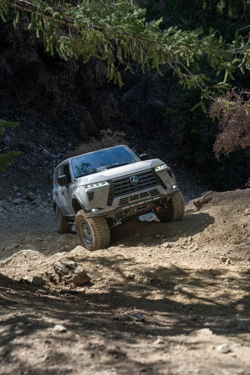

The GX is now installed with Dobinson MRR 3 Ways along with RRW Upper Control Arms. My new wheels came at the same time so I upgrade the tires to 35s as well. Here are some pictures to share!
View attachment 5554View attachment 5555

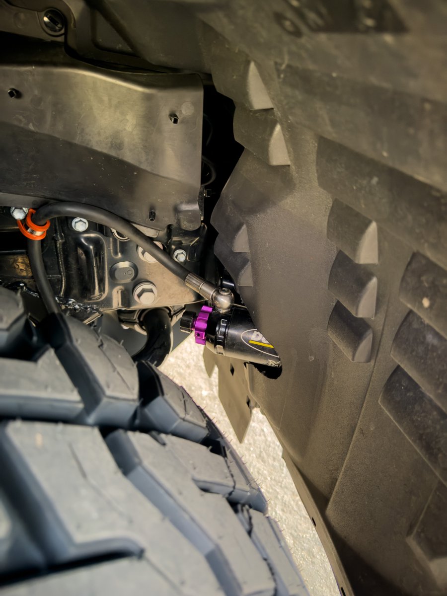

I have about 1,000 miles on the Dobinson suspension so far. Since this is the first MRR kit installed on the GX, we encountered some minor installation issues, which were resolved after working with Dobinson. Their customer support was great—thanks, Dave! Due to the Overtrail being equipped with EKDSS, the original location to mount the reservoirs recommended by Dobinson for the LC250 didn’t work. We installed the reservoirs in front of the tires and wedged them behind the front of the fender liner. So far, I haven't experienced any rubbing issues with the 35-inch tires; there are about two finger-widths of space between the tires and reservoirs when in full lock. I haven’t had the time to take the car off-road yet, so I can't comment on whether it will cause any rubbing issues during that type of activity.
As for the Relations Race Wheel (RRW) billet upper control arms, they are a high-quality component and add extra flair to the build! The completely sealed uni-ball is quiet and requires very little maintenance since it’s sealed and doesn’t need frequent greasing. While billet upper control arms are pricey, you get what you pay for. I would 100% recommend them!
I also purchased the ICON adjustable track bar to help center the axle. During my first alignment, I faced numerous issues. Most alignment shops don’t have the proper alignment specs for the GX, and after getting the car back, the rear end felt like it was swerving left and right when I accelerated quickly from a dead stop. The adjustable track bar should help resolve this issue.
Last but not least, I upgraded to new wheels and tires! My previous setup with stock tires was fine, but I really wanted to go with 35s. I designed a new set of wheels with true beadlocks. This time, I’m running 18x8.5 with a +35 offset, paired with Toyo Open Country R/T 35x12.5R18 tires. I do experience slight rubbing when I reverse while turning the wheel to the left. I believe a slight caster adjustment should eliminate the rubbing issue.
I plan to take the car to Cleghorn OHV in the upcoming weeks as soon as my work schedule settles down. I will share more pictures and videos whenever I can.
Cheers, everyone, and happy holidays!
Awesome! My MRRs are coming next week. What diff drop kit did you use? And did you have to do links/spacers for the eKDSS setup? For mine, I ordered from Icon their tubular UCAs, diff drop, and adjustable panhard bar. Very curious to know how the on-road ride/feel changed with your setup.
I am actually not running any diff drop kit at the moment. No issue or any modification done to the EKDSS set up.

Sorry for the late repy. I have the extended travel front strut and no light for the KDSS.

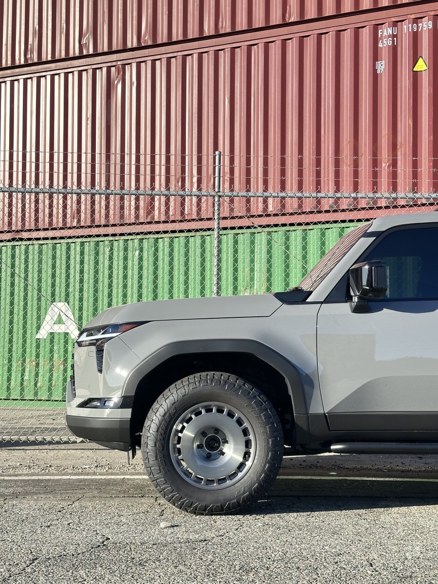

Working in the wheel/auto parts industry for over 10 years has given me the knowledge and resources to manufacture my own monoblock forged wheels. Here is the first set I built for my GX. The spec is a little bit on the aggressive side but I think it works well with the factory Toyo AT Tires 265/70R18. It does have a slight poke and zero rub.
Finish : Gloss Brushed Gunmetal
Weight : 12.7 kg each
Material : Monoblock Forged

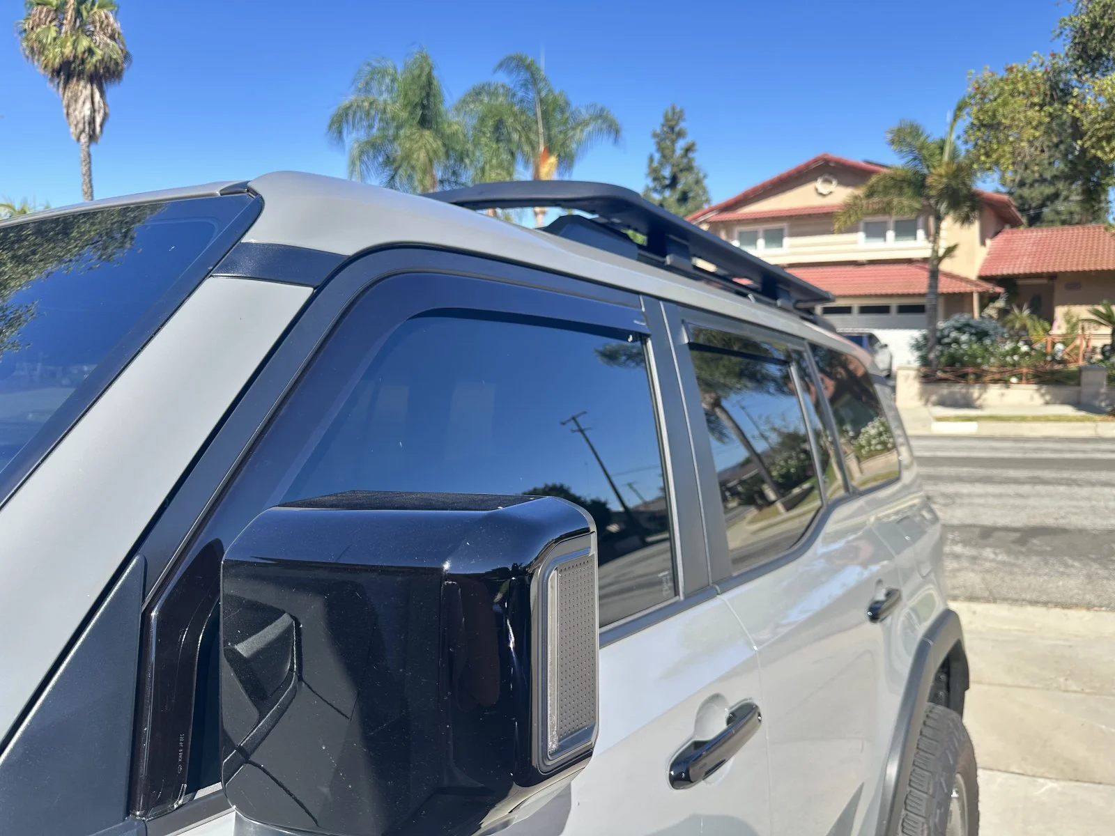

WINDOW VISOR

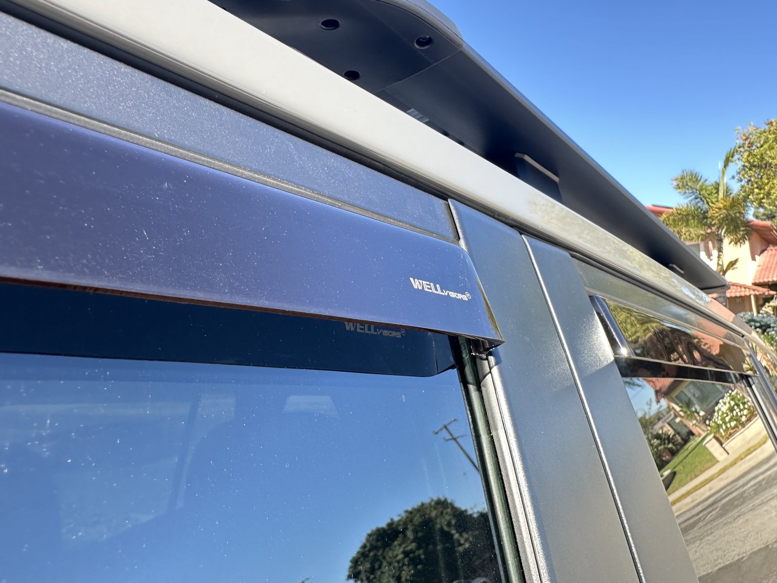

WellVisor - R&D Vehicle for WellVisor - August 2024 .
I was invited by WellVisor to try out their new visor for the GX550. This is the slide-in type, and the installation was very straightforward as it does not require any double-sided tape or clips. The visor does require a minimum of 24 hours to "settle in". The reason I mention this is because there's a safety feature for the window to roll down automatically if it detects something in the way (such as fingers, etc.). To let it settle in, simply leave the window closed for 24+ hours, and the window will work normally again without trying to roll down on its own when you try to close it.
I love how simple the design is and it sits flush with the door. Definitely a must-get accessory for all GX owner.

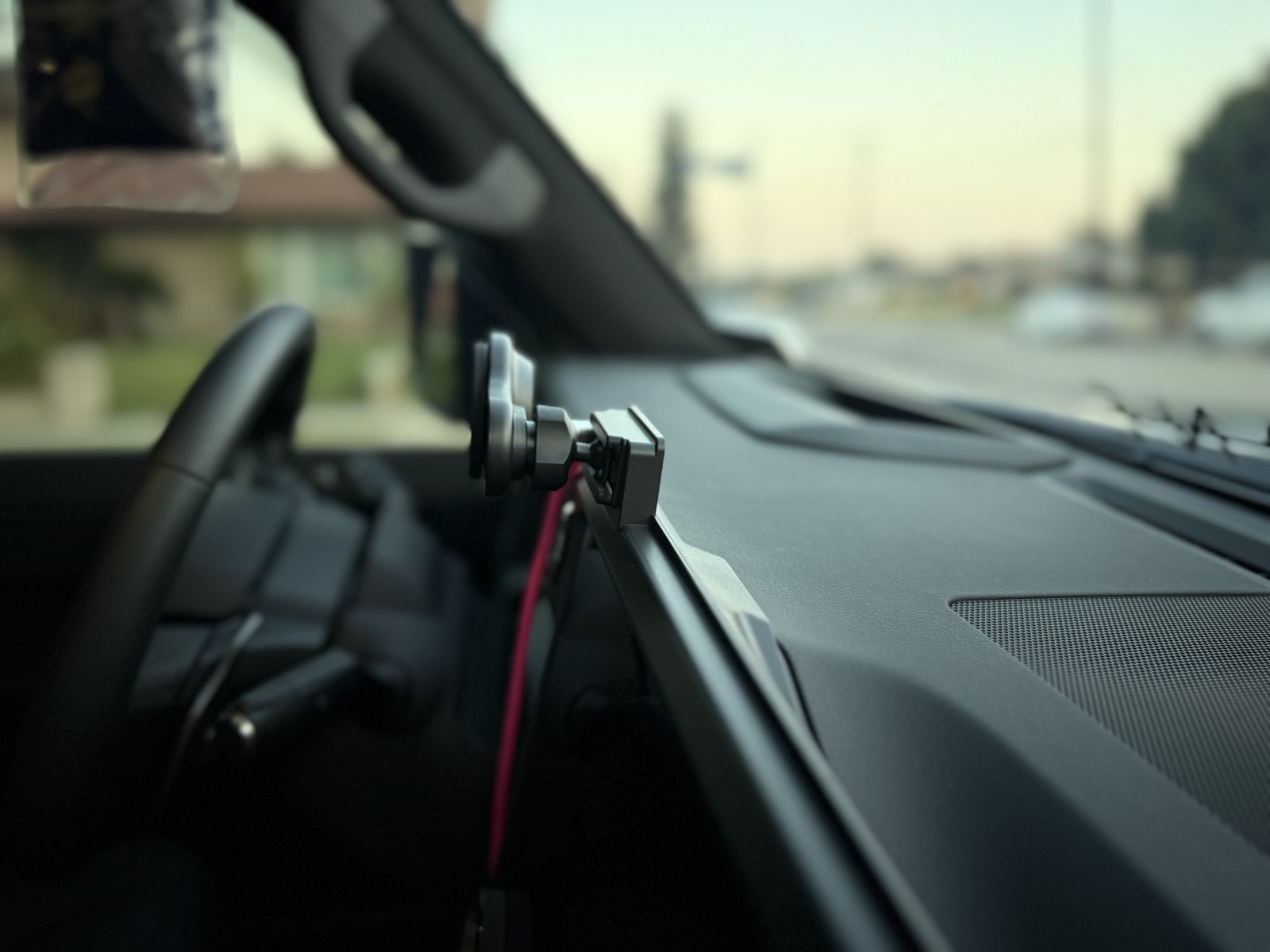

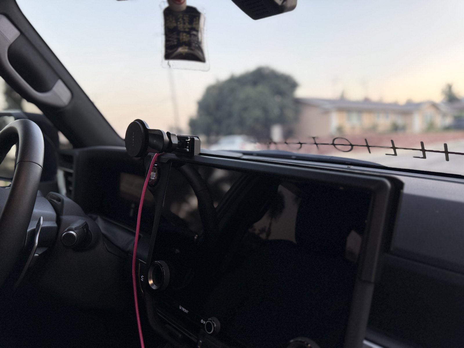

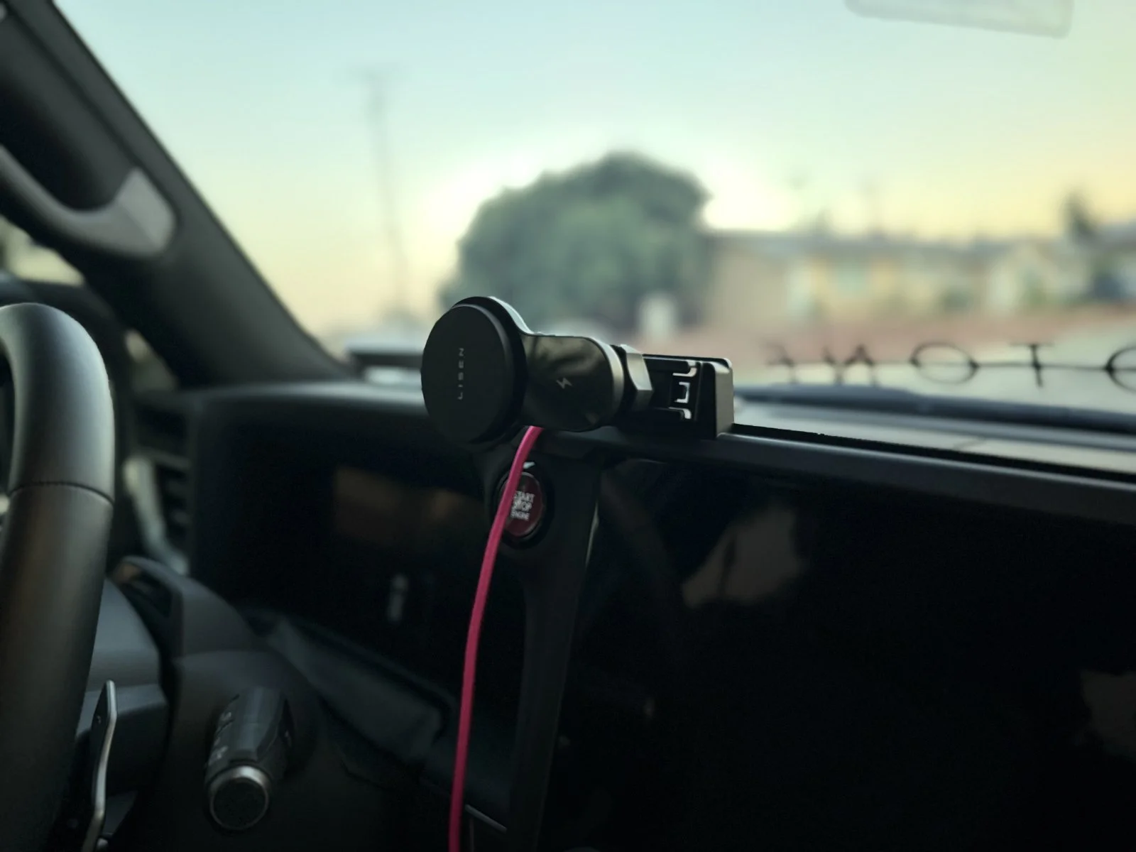

The GX model specific phone holder has been installed along with a MagSafe wireless charger. I would rate this item 7 out of 10. The installation was straightforward - it doubleside tapped and wraps around the top part of the monitor. My only complaint is that the mounting point from the bracket and MagSafe mount is not sturdy enough. The phone shakes on light, uneven roads.

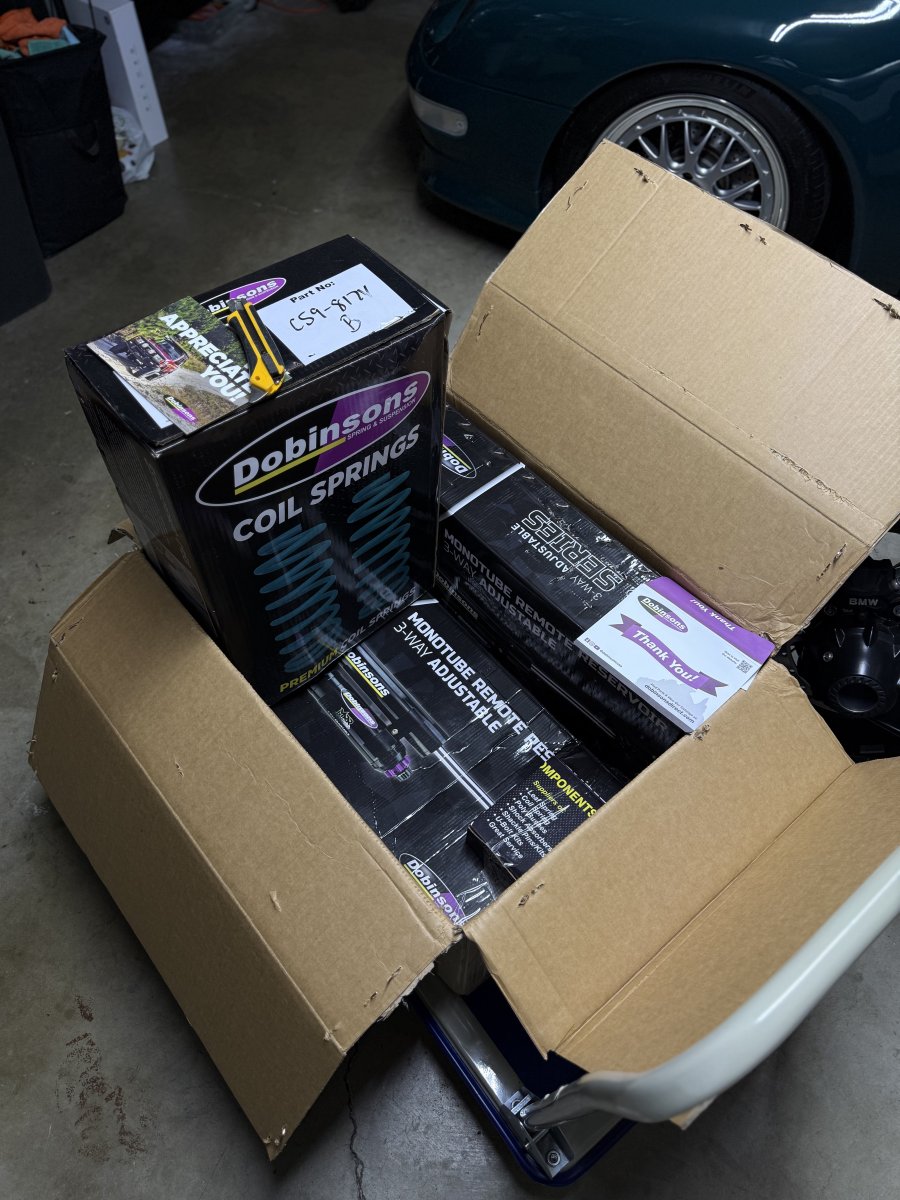

Dobinson MRR 3 Ways Arrived
RRW Billet UCA Arrived ( not picture )
If work allows, I should have the lift kit on by next week.
Does the mount block anything?
