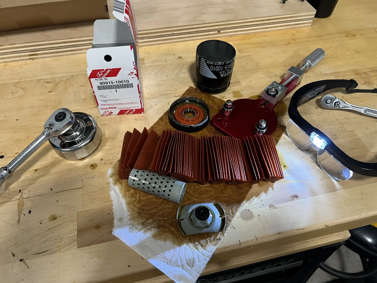

Accordion’d the filter at my first change. 1446 miles. Only one section had minor metallic debris and minimal RTV throughout. Under very heavy magnification there is a fair amount of shiny particles throughout but nothing outside normal for the first 1000k. Very well made in JAPAN filter I might add. One of the best quality I’ve seen. Bought a whole case from my dealer as most online retailers/dealers are the selling the Thailand variant.
