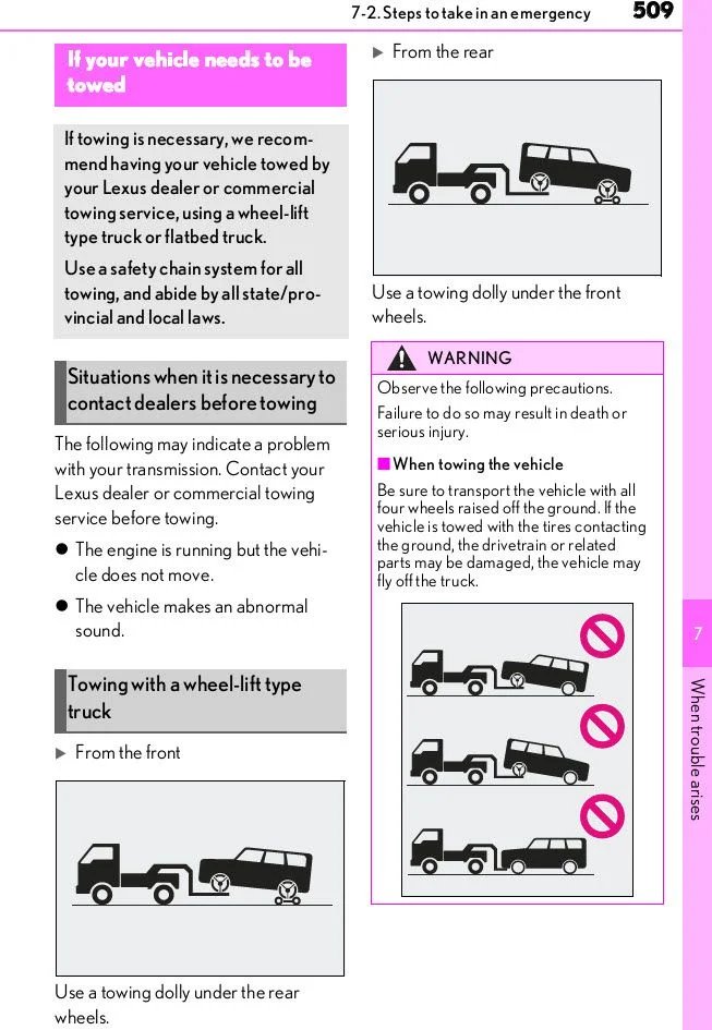

Has there been any information on whether this vehicle can be flat-towed behind an RV?
According to the manual (page 509), that would be a no. Flatbed towing only.
And no way to modify this? I heard some (likely older) cars could have manual locking hubs added to each wheel to get them to flat tow (but that also eliminates any braking in the tow vehicle so not good in that respect).
