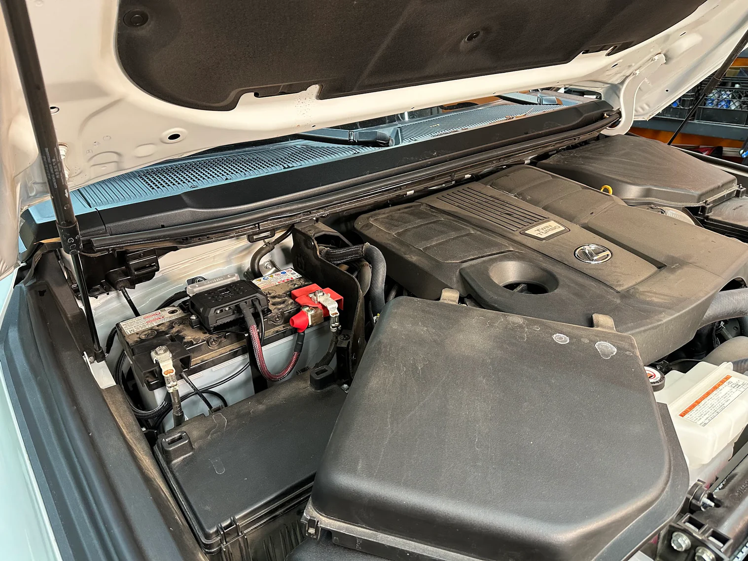

I just bought the Garmin Powerswitch. It is a module that you install near the battery and then run all your accessory light wires to it, and then you turn on the lights from your phone. So, you don't have to run wires through the firewall and make new switch holes etc. I have yet to install it, but there is plenty of info on Youtube.
This is another option that lets you use an app on your phone and also physical switches with no wires attached. You can sticky-tape a switch pod to your dash, clip it to your sun visor, put it in the cupholder or your pocket. The benefit is that you don't have to route wires through your firewall and drill & mount a switch or switches.

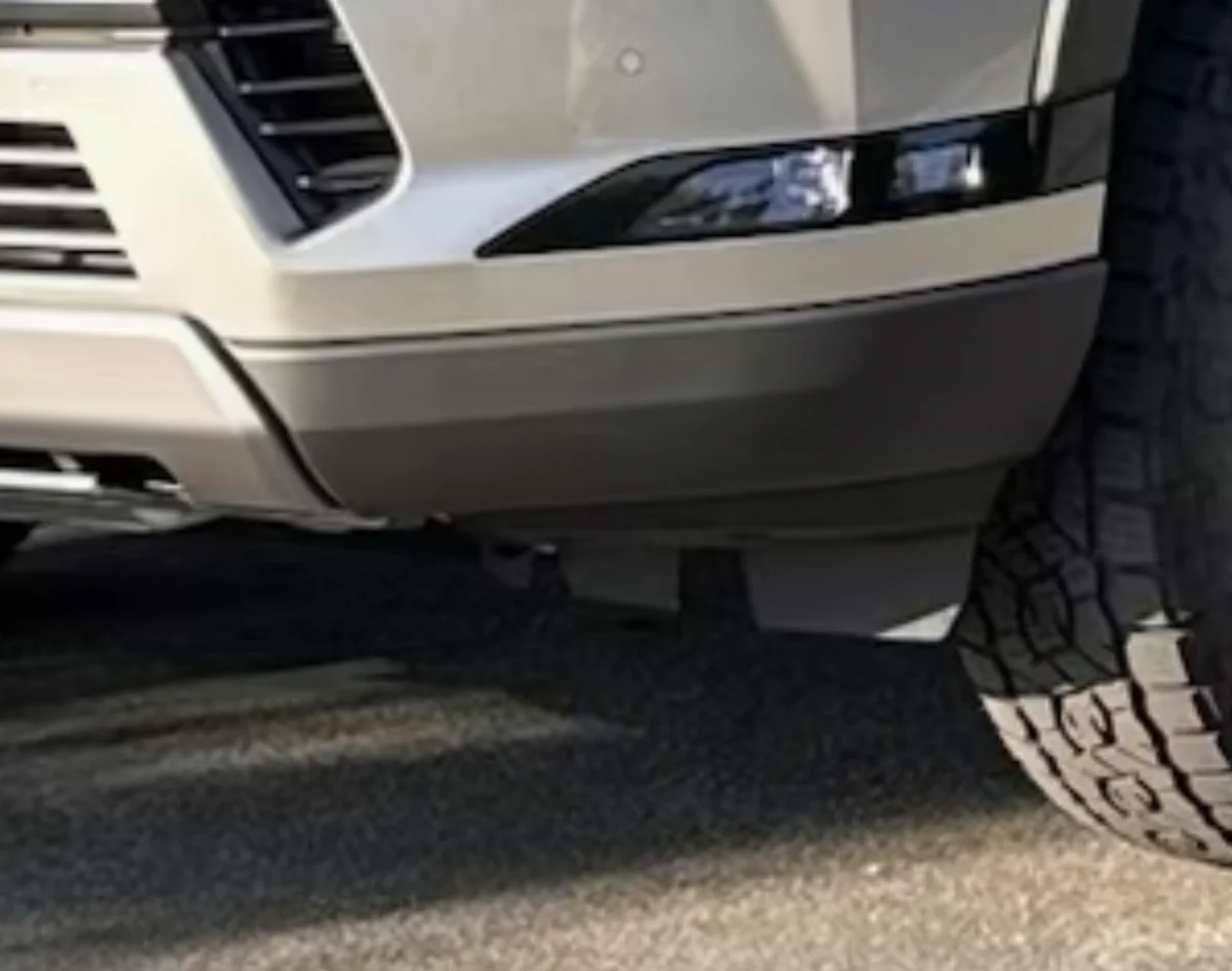

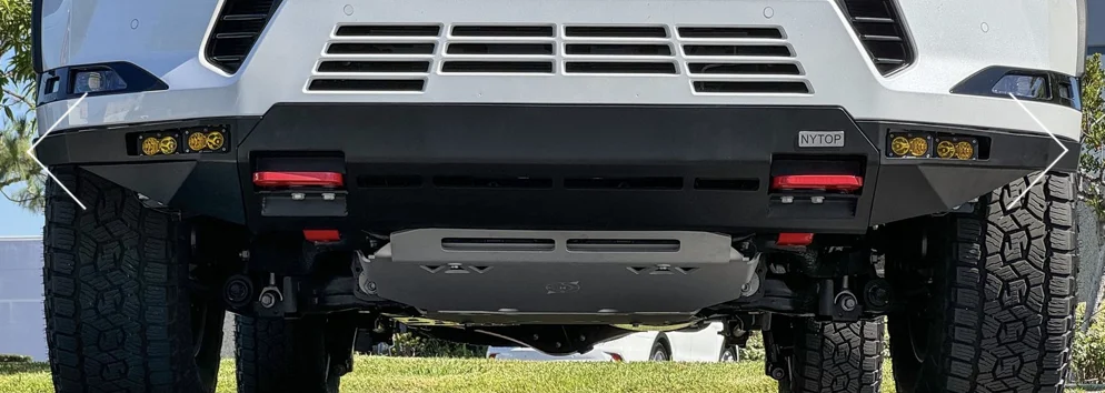

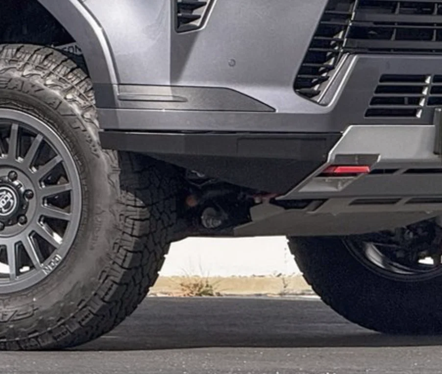

What is everyones take on these lower profile bumpers (this one is a NYTOP) - understand improved approach angle - but look at how much more of the components are exposed to air in the first two pictures (lower profile) versus the last picture on the right is stock. Seems like that introduces all the components to the air and ultimately more noise.
Thoughts?

A Garmin switch looks like this, View attachment 5857
