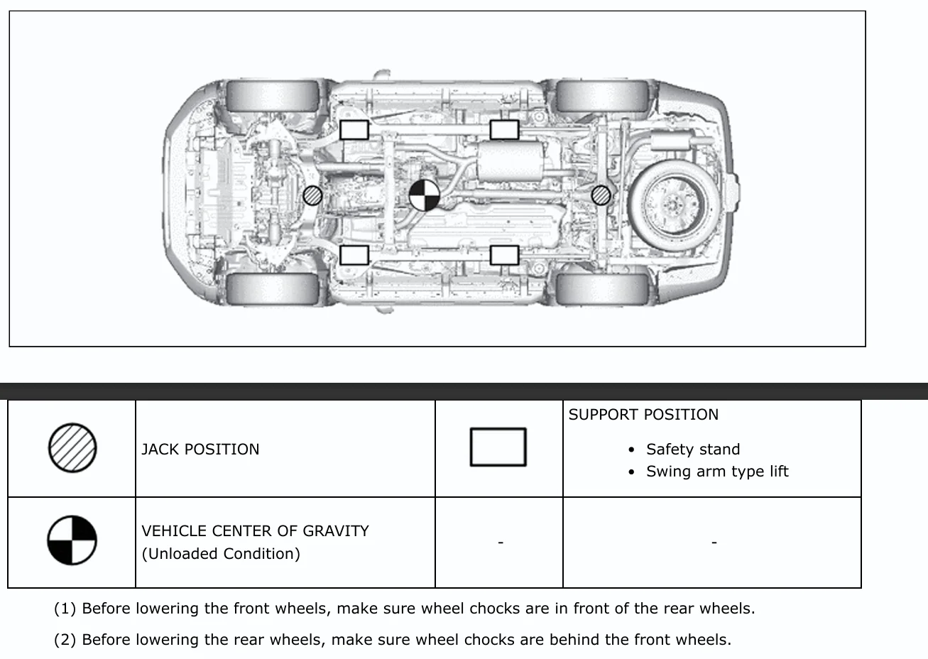

Hi, is there a safe center jacking point on the front of the GX550? The manual says the jack locations for the front are on the frame near the center but that's where I'd like to place my jack stands and I feel it's safer to place both of the front jack stands at the same time vs jacking up one side than the other
Sorry if this is a duplicate thread, having network issues on my end. Thanks!
following up, here's the jack points if anyone's searching in the future
