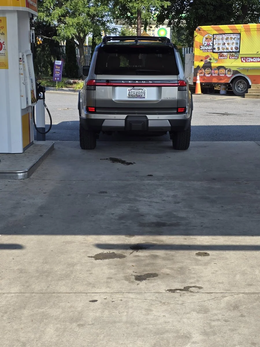

I read a few posts with similiar observations. Read it is a full tank of gas among other causes. I have atrached a photo at the gas station immediately after filling up. This is before I started the vehicle and did not look again after starting the vehicle and allowing the computer to adapt, if that makes any difference at all. What see all u?? It seems to be pretty parallel with the ground to me
Probably as parallel as it gets. I think I read in that thread to measure from the center wheel hub to the fender & that should be the same.
I see a slight lean to the passenger side. I just measured my premium plus and it seems to lean a quarter inch in the same direction...

Close enough.

Are you sure you're measuring from the exact, precise center of each wheel to the exact same place on each wheel arch? Or, if measuring from the ground, are you sure you're tagging the exact same place on each wheel arch? I say this because there is plenty of slop in the system if you just eyeball it. Oh, and also make sure you are parked on perfectly level ground...which you will never find. The best thing I've found is to measure on a good garage slab, then turn the truck around and measure again. A good garage slab should be about as close to level as you'll find, with a slight downward pitch out of the garage for drainage (thus turn around and measure again).

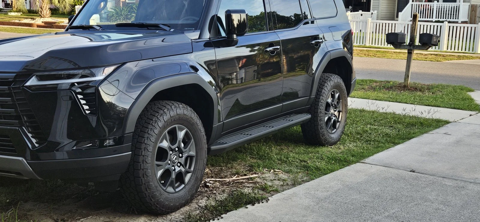

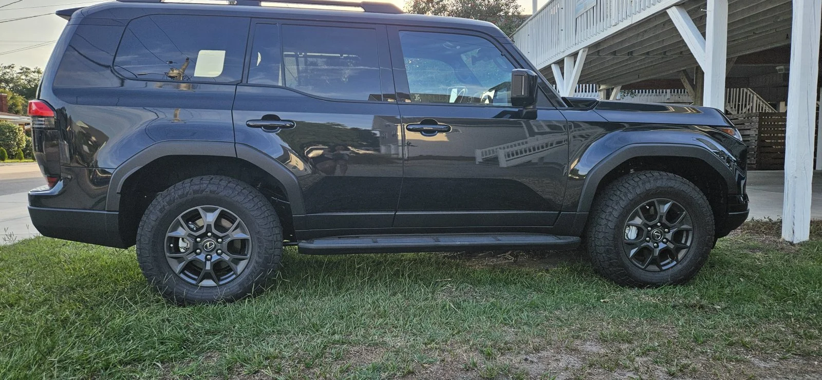

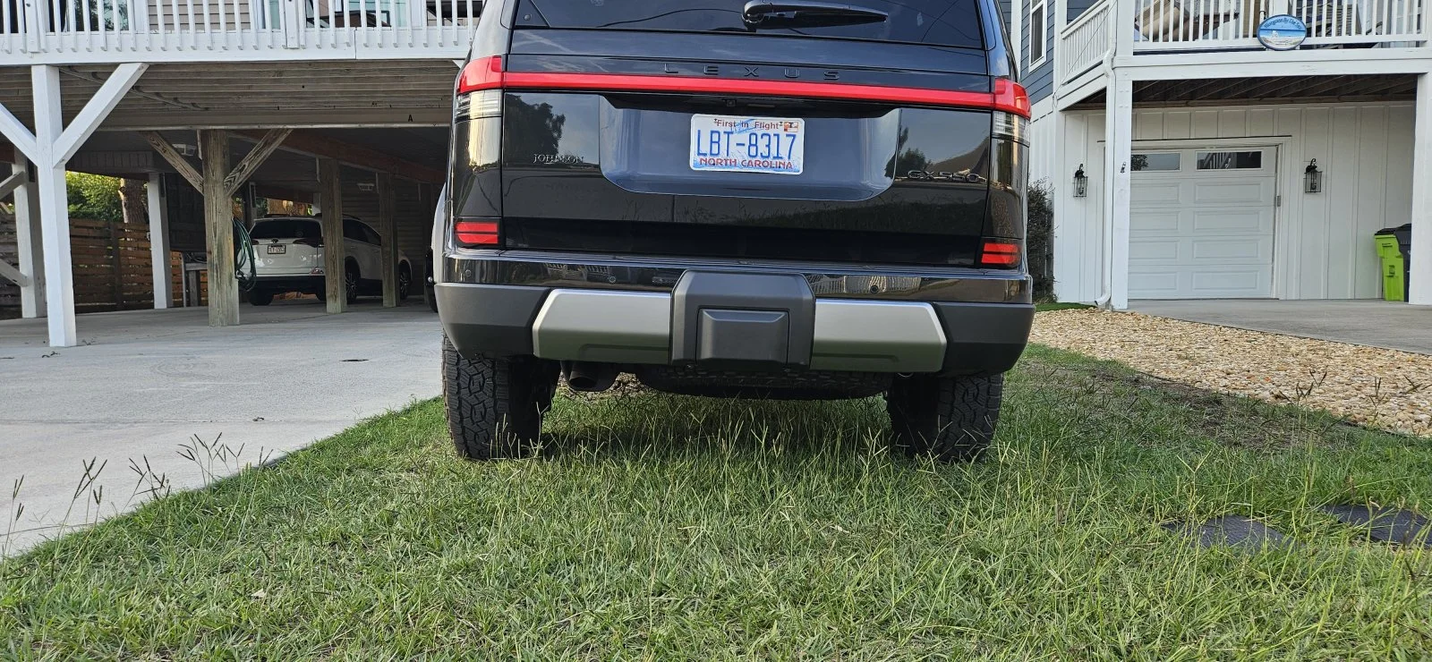

Crazy! I had the exact same thing, but thought there was an issue with the suspension, causing the vibration in the truck! I even measured the wheel well and it was off by two inches, leaning to the right. It was parked at the beach over July 4th... Super flat and leaning all weekend, and then it just went away.
