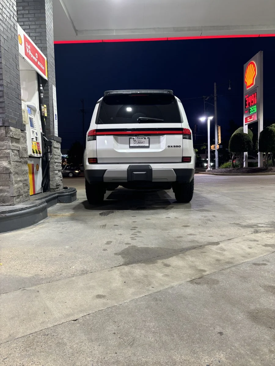

So, my one substantive complaint on new-to-me 550 is this . . .
That happened after my first fill up last week. It's a good 1.5" lower on that side in the rear. I didn't notice any adverse handling or anything, but it's definitely leaning.
I opened a ticket with the dealer. They said they hadn't seen it on any others, but have only sold a handful here in Memphis.
Any thoughts or experience from the group ? I find it hard to believe that they wouldn't properly engineer a progressive spring rating on that corner if this was a known thing.

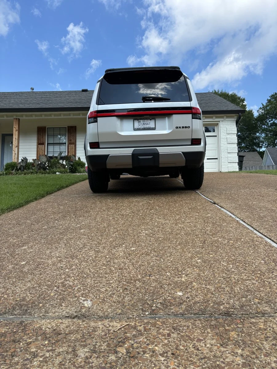

Just filled up at the costco on winchester in Memphis. I def see sag on your passenger side. Below is a back photo shot of mine on a full tank. Doesn’t appear to be leaning like yours. Im on a incline in that photo and will post again after fill up on level flat surface with zero incline

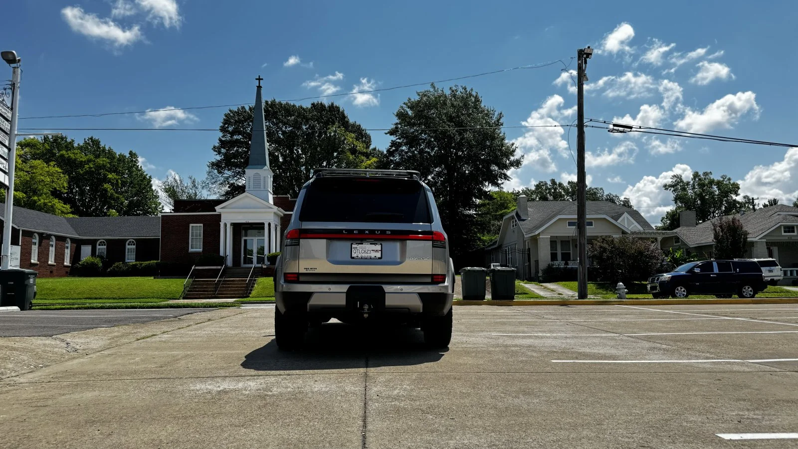

Topped off at perkins/poplar and took photo on flat level surface

Hm. I do see a little lean there ? Have you measured fender height from ground? I’m working on driving down this tank of gas, and am definitely noticing it leveling out.
