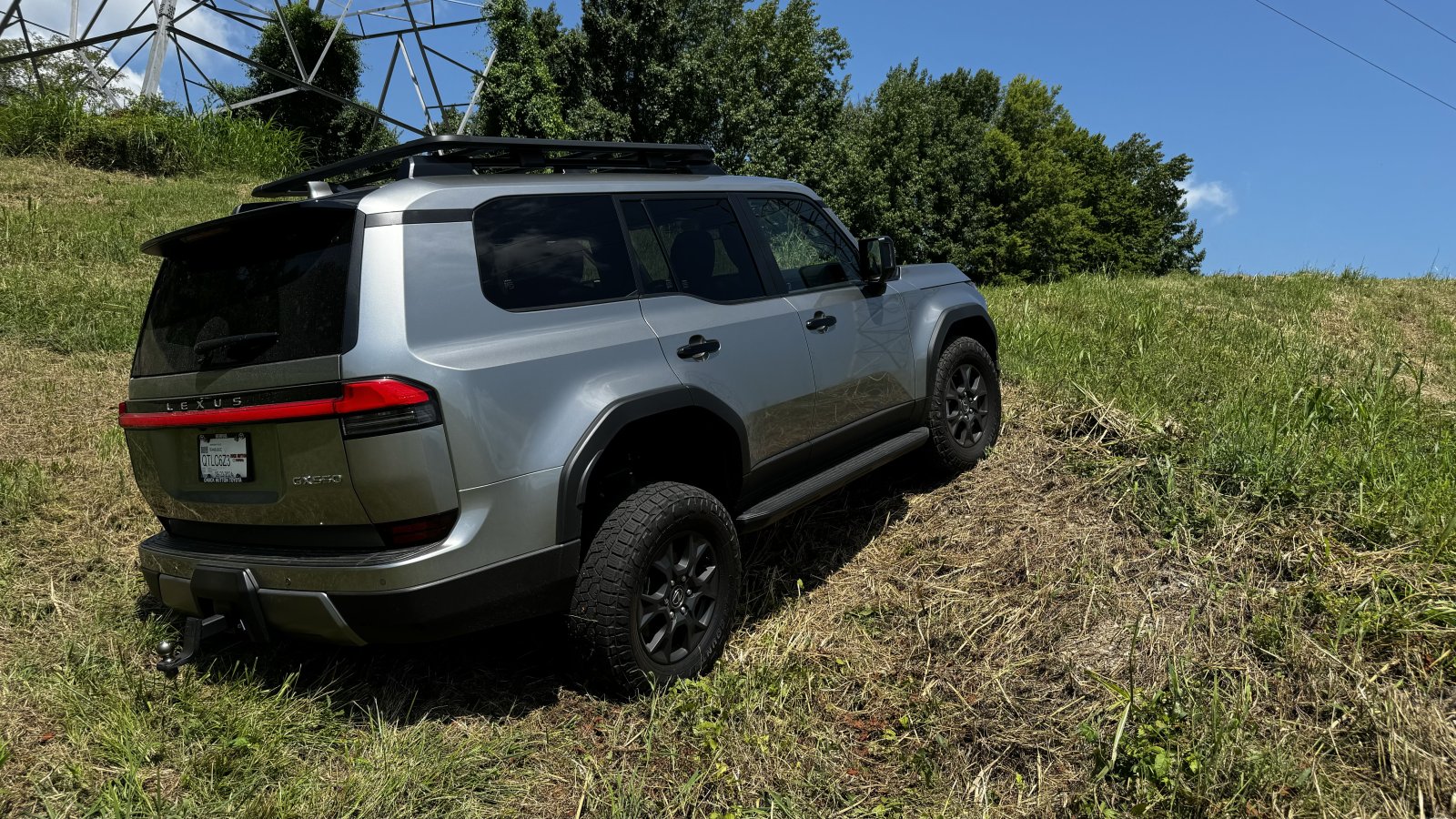

Man, that’s surprising they said it’s within spec. It’s visually way off in the photos.

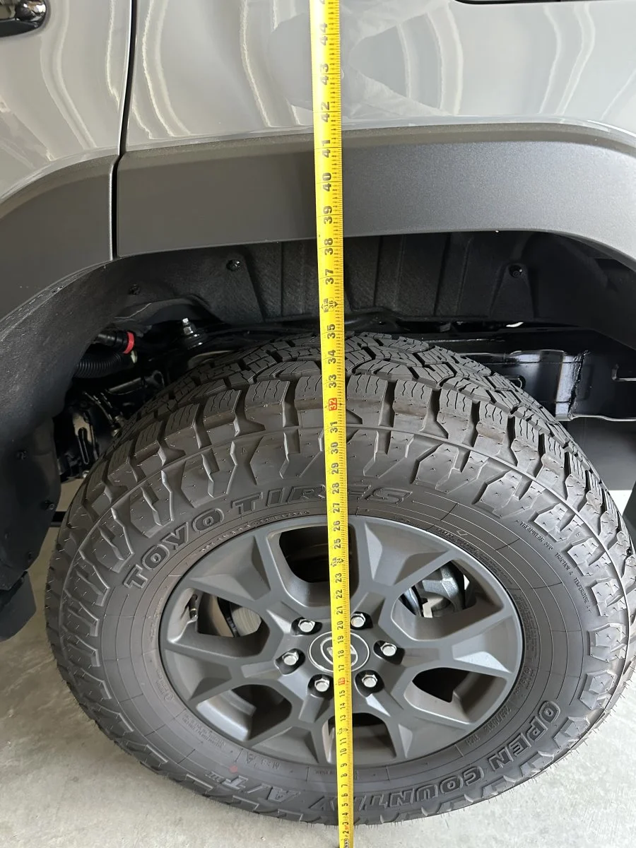

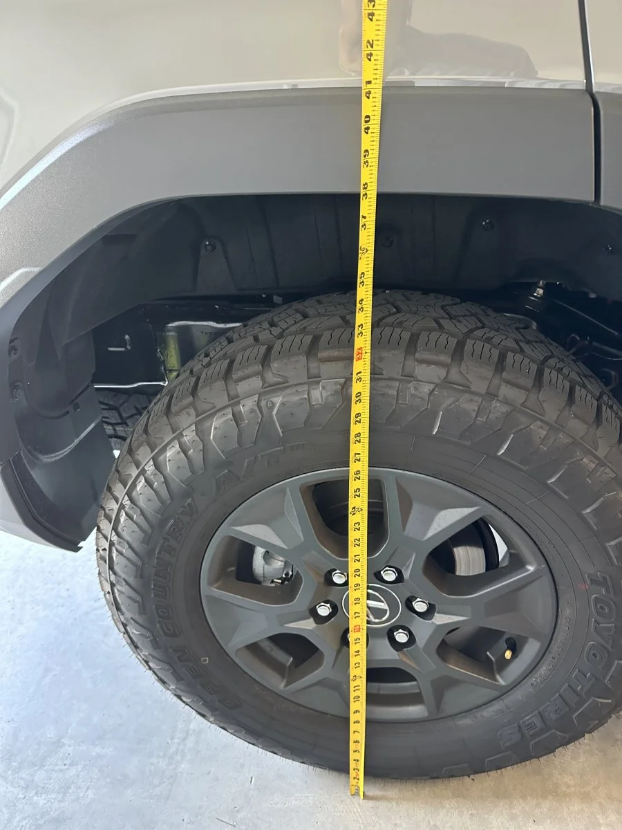

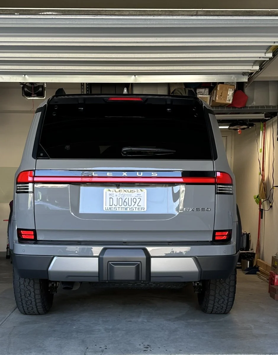

Hello I just picked up a new gx550 overtrail 4 weeks ago. Currrently at 1300 miles. It also has a lean to the right. Picture of vehicle height, order is LR, RR removed the front cause wrong order.
Hello I just picked up a new gx550 overtrail 4 weeks ago. Currrently at 1300 miles. It also has a lean to the right. Picture of vehicle height, order is LR, RR, FL, FR.

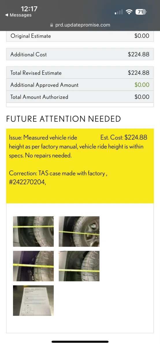

picking up my car now. they said car is in range of spec. ugh. but its been submitted at least. guess we gotta live with a 70k+ uneven car.
