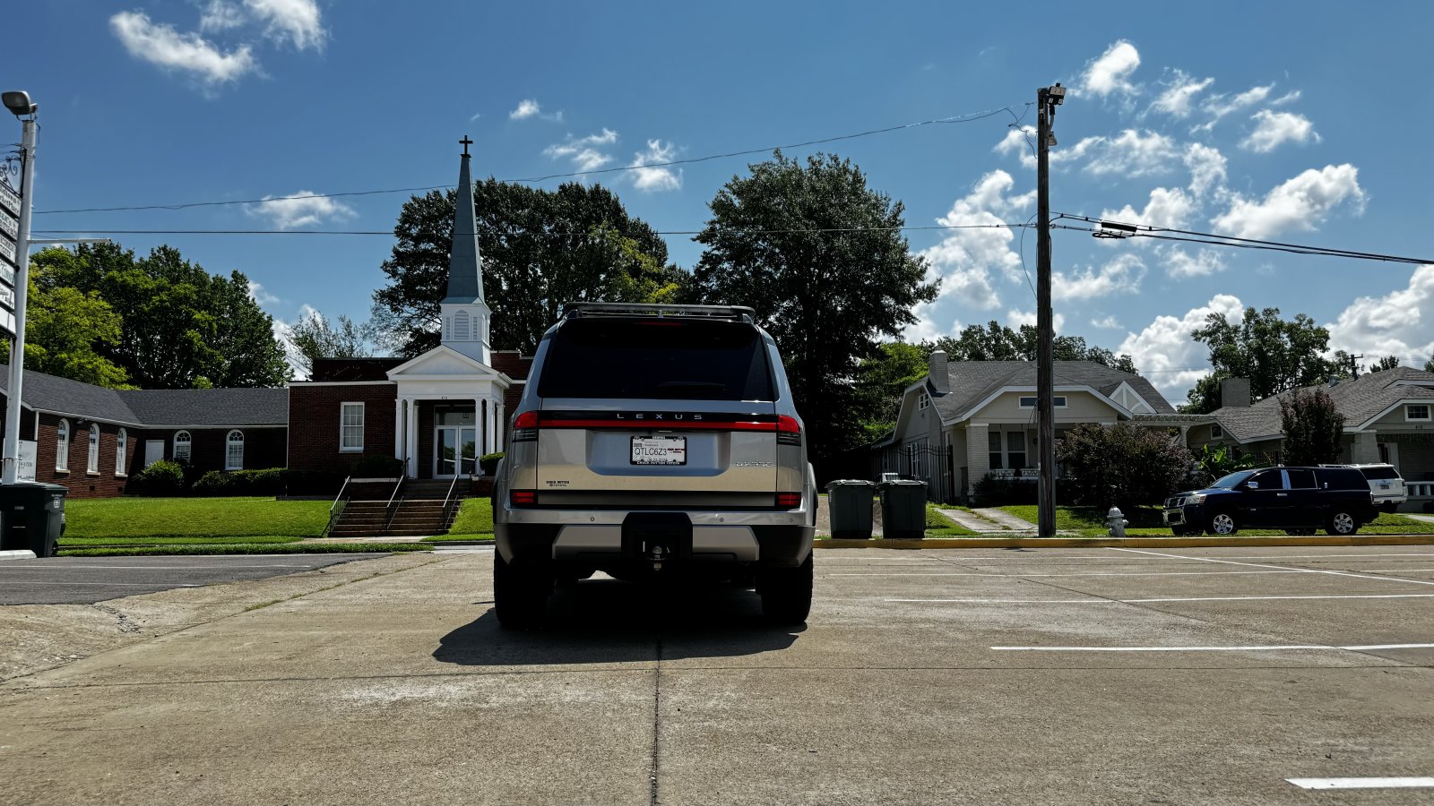

So, my one substantive complaint on new-to-me 550 is this . . .
That happened after my first fill up last week. It's a good 1.5" lower on that side in the rear. I didn't notice any adverse handling or anything, but it's definitely leaning.
I opened a ticket with the dealer. They said they hadn't seen it on any others, but have only sold a handful here in Memphis.
Any thoughts or experience from the group ? I find it hard to believe that they wouldn't properly engineer a progressive spring rating on that corner if this was a known thing.

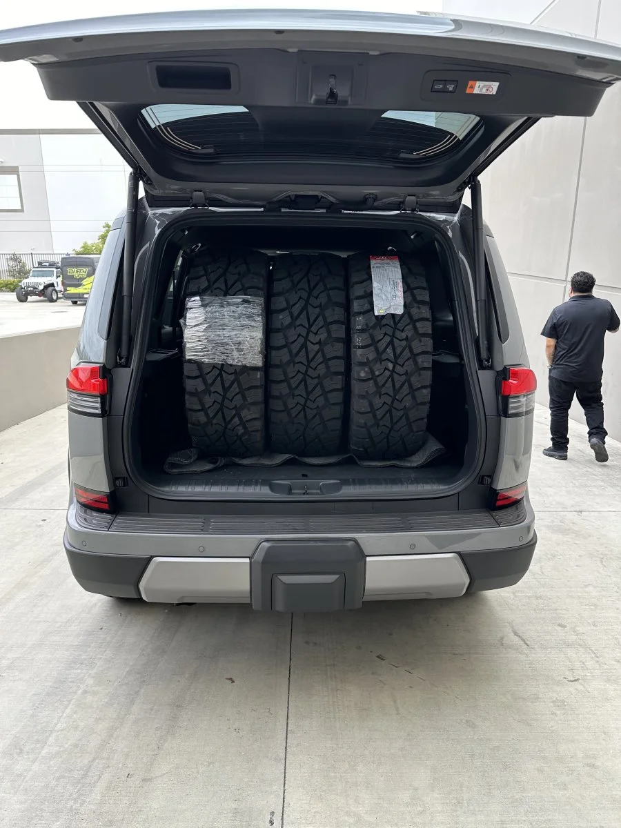

Finally got westscott lift installed. It also looks like it resolved a little of the lean. But my wife and i drove to joshua tree and she says the lean is no longer visible.
Wheels to come. 4 wheels and 4 35 inch tires fit. If anyone is wanting to know if it fits.

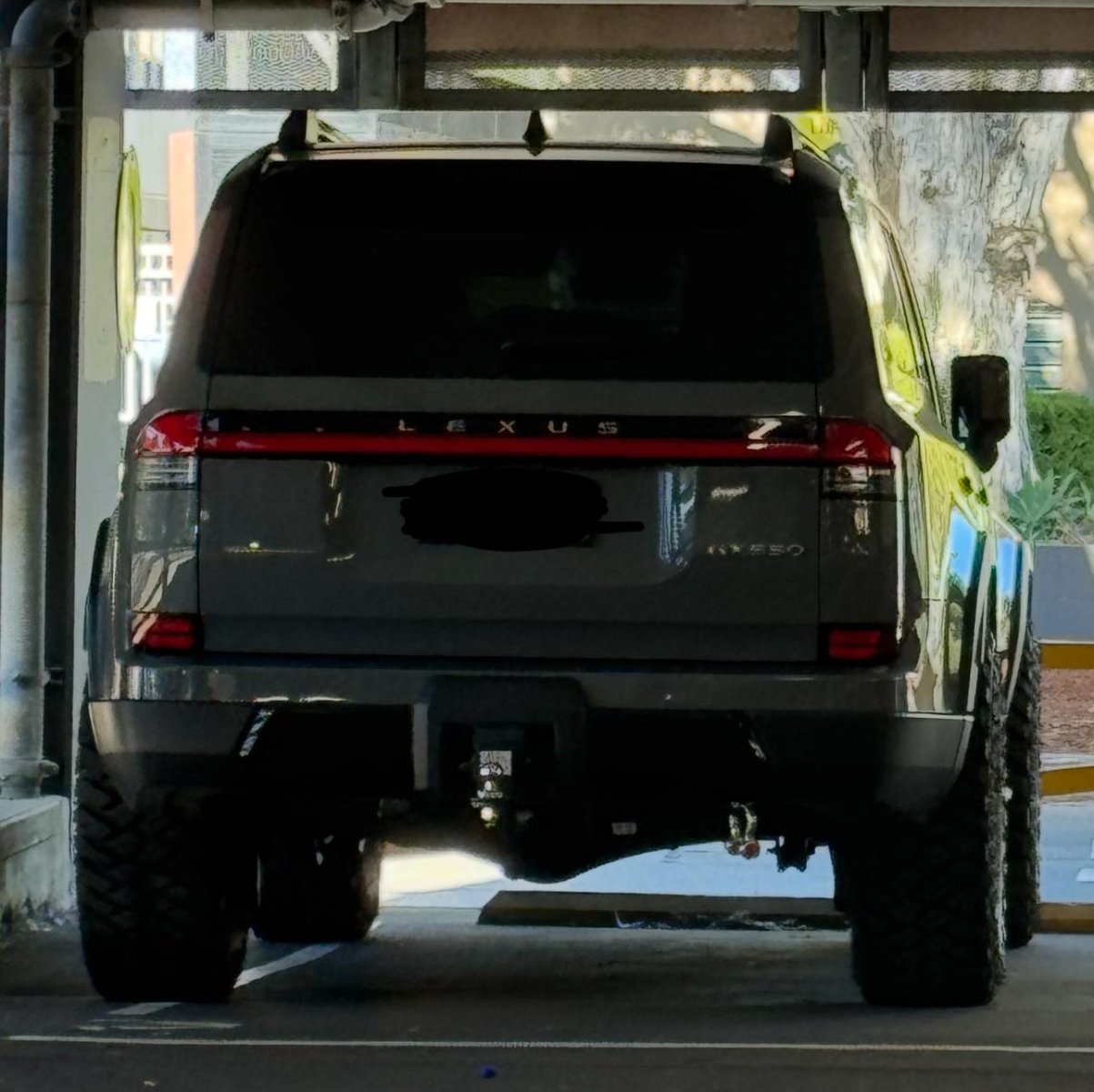

I know this has already been covered to some extent but I have a 25' OT and absolutely HATE the lean, it is eating the soul of my OCD...
Terrible photo attached but there is between 20-25mm of lean in my car towards the right side, confirmed by a reputable tyre shop after going for an alignment.
My car has the westcott levelling kit and 35's installed - the lean was 100% present prior to doing these mods.
Should I raise this issue with Lexus as my car sits at the moment, or should I revert it back to stock prior to doing so?
If i take it to Lexus as it is now, worst case I may need to pay for them to "recalibrate" the KDSS, or install shims etc.?
To be honest it will probably cost me more to revert the car back to stock.
