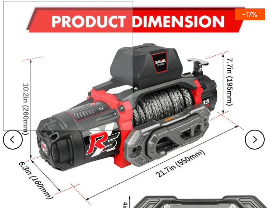

I just noticed that X-Bull is advertised at 13,500 lbs. That's a monster! I'd investigate that to see how true it is....make sure the advertised pull ratings are apples to apples (max pull is only for the first wrap of rope on the drum - is that what Brand A is advertising, is that the what Brand B is advertising?).
As I mentioned before, most of these winches are pretty much the same - planetary gears, similar power, similar speeds, similar waterproofing, similar electronics, etc. Check the power rating, line speeds, rope or cable specs, etc. Also, is the winch cheap because the fairlead and hook are optional at extra cost? Is shipping free? Etc.
A couple final comments on the X-Bull:
Check the size - it's big!
Overall Dimensions (L x W x H) - 23.6" X 13.4" X 10.2"
For comparison, the advertised dimensions of the SCAR 12k winch are
21.3” L x 6.3” W x 7.9” H
I'd check with Josh at JW Offroad to make sure it will fit. The bolt pattern is the standard 10" X 4.5" so it should bolt into the bumper's winch tray just fine, but make sure it will fit in the space allotted in our trucks. I haven't yet investigated the space up there/back there as I have yet to disassemble anything on this GX550. I don't know why the X-Bull would be so wide (13.4" vs. 6.3").
Also, can you "clock" this winch? This means that you can unbolt and rotate the right side cover with the free-spool handle so the handle faces forward. That would be a benefit for our application with a winch that's pretty much hidden with only small access ports in the front face of the bumper.
Regarding the size of the X-Bull, I just noticed that the pictures they have show that it's much smaller in dimensions....it certainly looks smaller.....something is incorrect....
Yea the more I read on it (which is not much) the less confident I am it's something I want to invest in. Just too many questions marks for that money.
