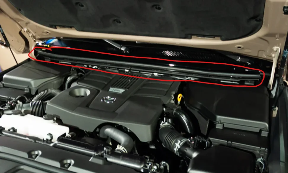

That is from air escaping the rear of the hood. There are many other car makers that this has happened to and owners usually add some tubular weather stripping to the back firewall where the hood meets it. They also add some vinyl tubing in the weather stripping to add some rigidity. The success rate is usually 90-95%.
Again, I don't have mine yet but this seems like a cheap thing to try.
Some other people have used spray foam insulation between the frame of the hood and the skin. I am a bit leary of that option.
