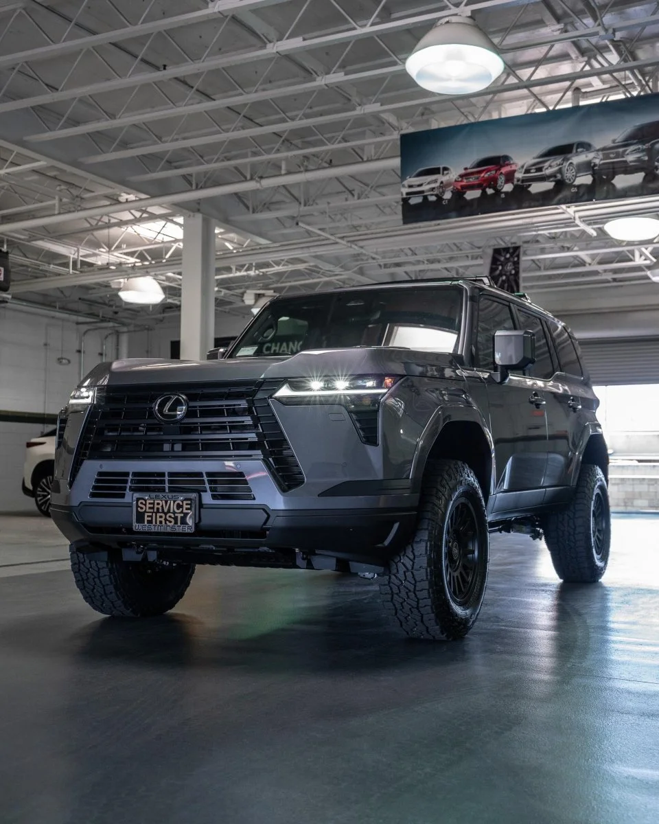

Check out this video here. Westcott preload collar lift kit with 17" +35 offset. I just placed an order for their lift kit. Now I need to find some +35 offset wheels.
Pucks and shock extenders. I wonder how much worse it’s going to make the ride. You’re going to lose some degree of articulation. You are ok with cutting up your new vehicle? I get it’s for the look and it does look really cool, but if you are seeking more performance off road, this isn’t it.
What I would be interested in seeing is you doing the mod though. And if you can provide any data since Wescott doesn’t have any numbers listed. Thanks

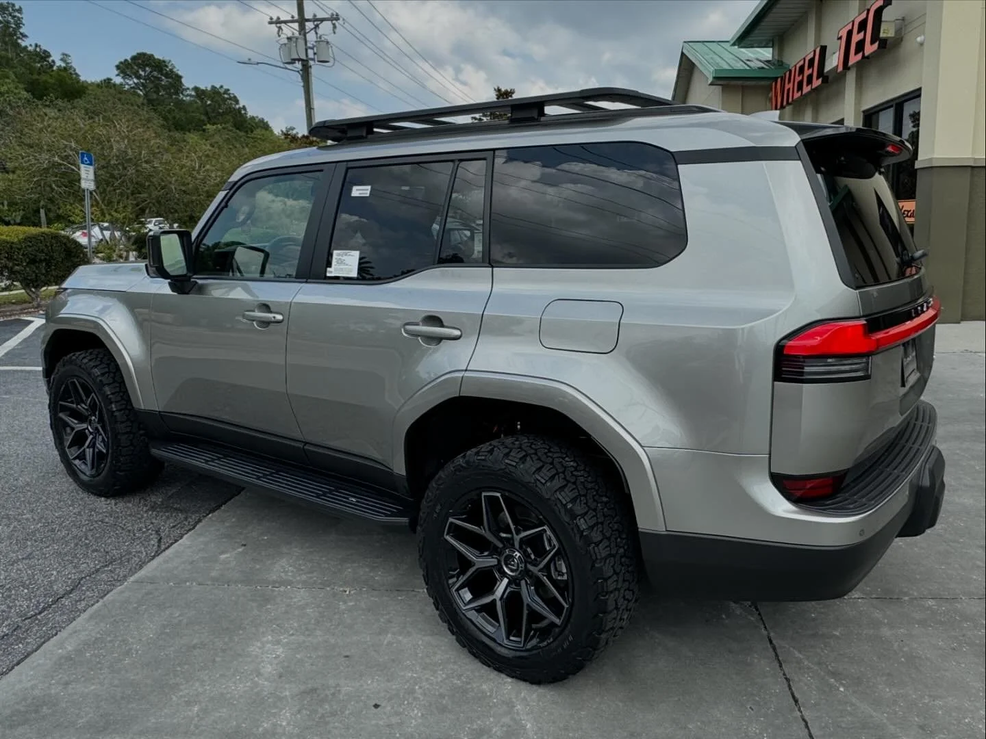

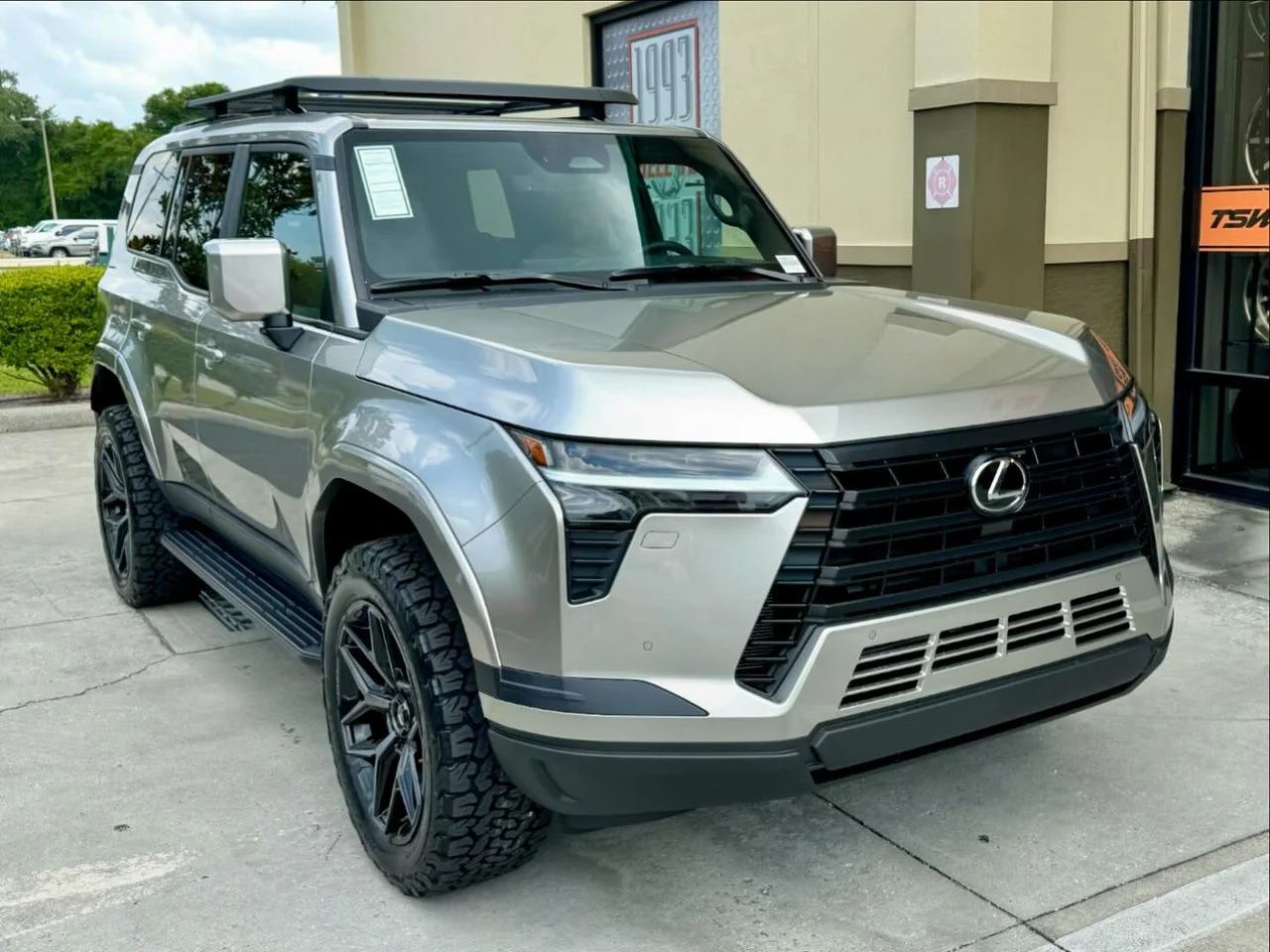

From Wheel Tec: 20x9 / +20mm offset Fuel Flex wheels with BFG 275/55/20 tires (KO2/KO3?) - Stock suspension

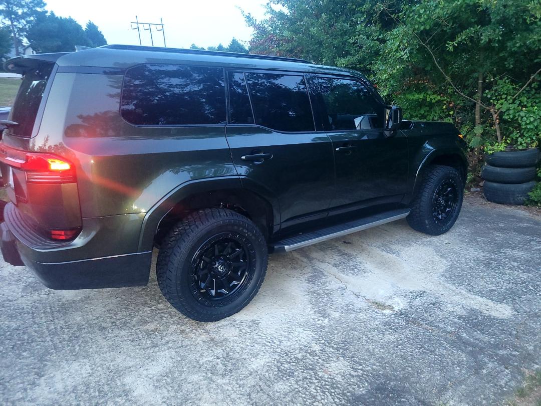

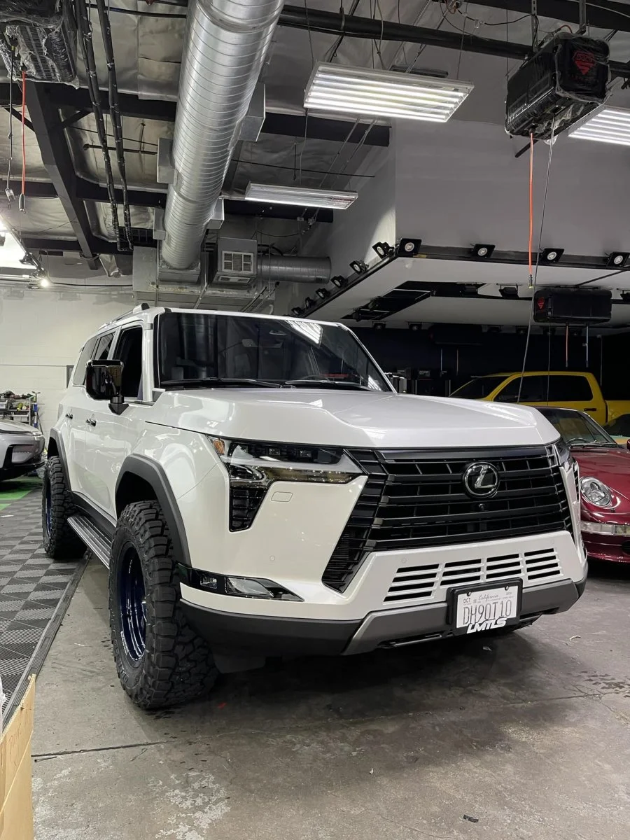

Meet Maximus wearing fuel covert 20x9 /et 20 and Firestone destinations XT 275/55/20 , Got the idea for this setup after peeking SUPERSIXs ride
