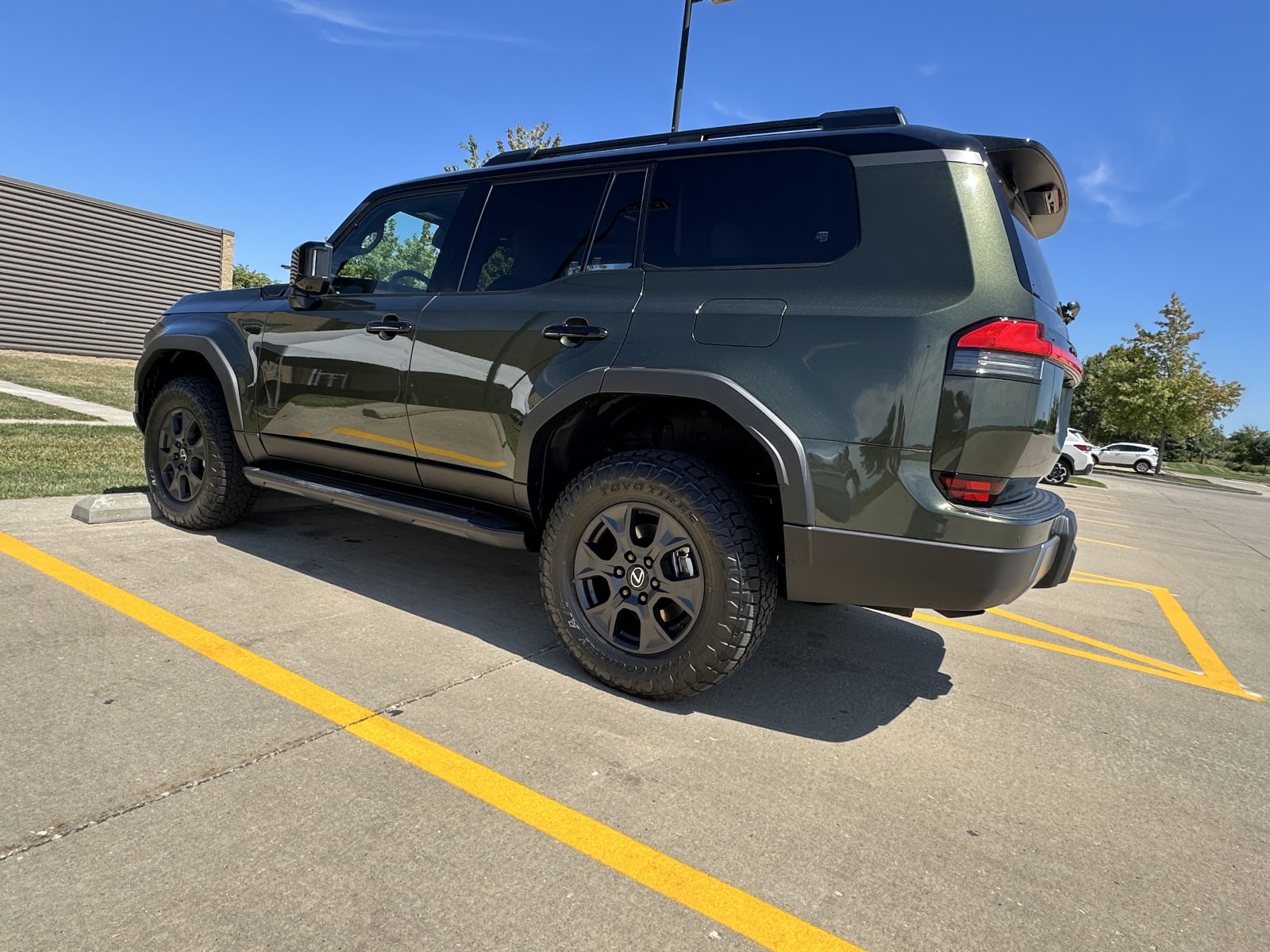

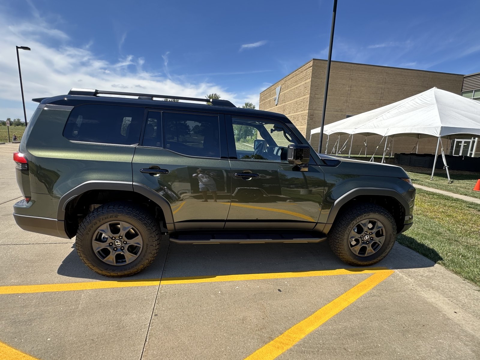

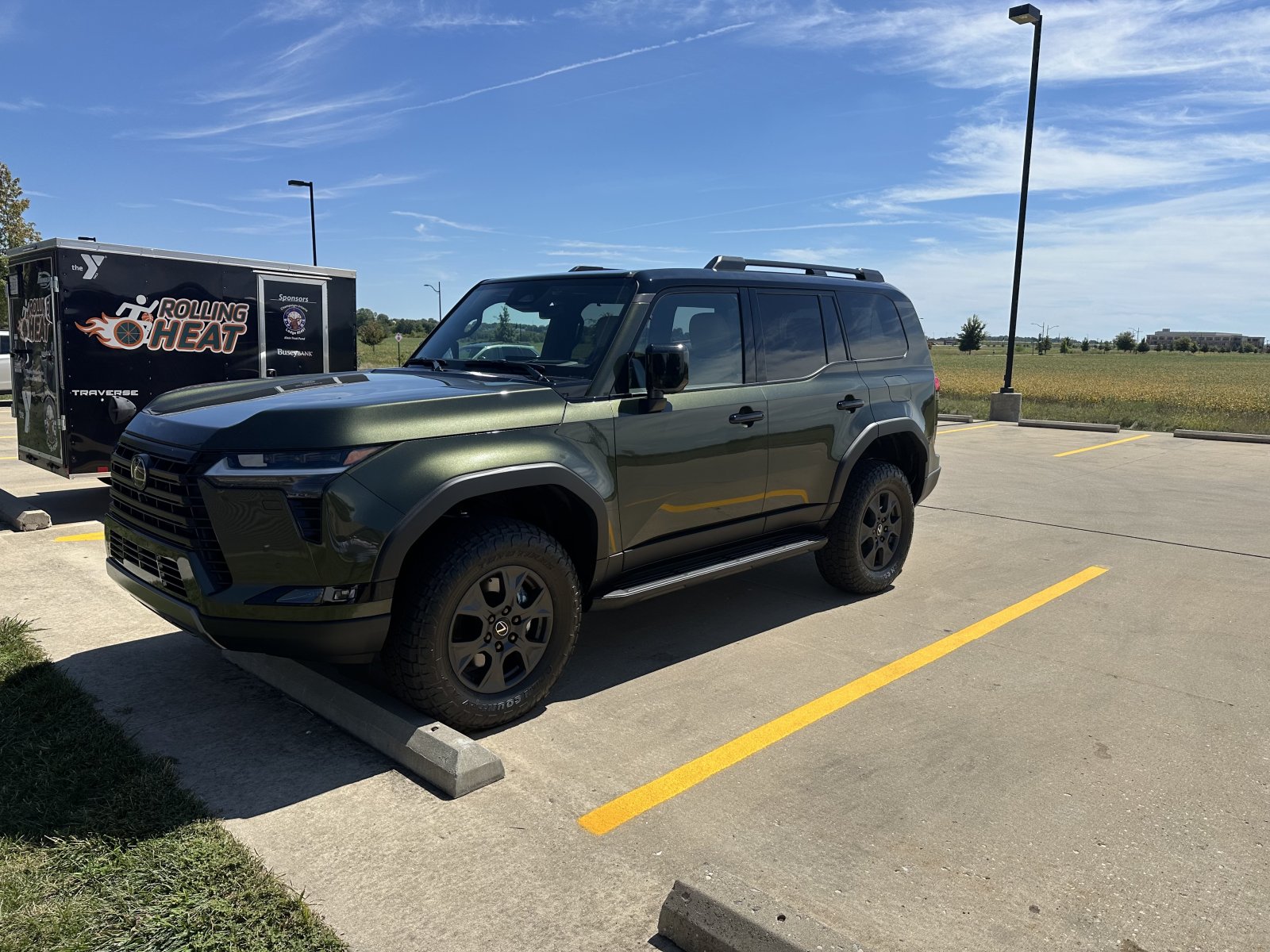

Picked up my 2025 a week ago. Curious if anyone has swapped out the factory 18" set to 22" wheels and tire set when not offroading? If so, can you post pictures or how does it look? Trying to figure out if 22" fits. Dealership's parts department provides inconsistent answers. Ty.

I mean the OD of the tires is 32-33” so I don’t think there is any debate if they will “fit”. Just need to pick a tire with the right aspect ration from 22” with less sidewall.
The luxury models come with 22 inch wheels from the factory. If you get the right wheel offset, width, and tire size, a 22 inch wheel fits fine
I'm not sure I see the value - the luxury and premium models from what I've read are very uncomfortable with the larger/low profile wheels, some reviewers even asked why Lexus even made them given how bad the ride was compared to the x5 and others. Go test drive one of those first - the ride quality might be the best test.
