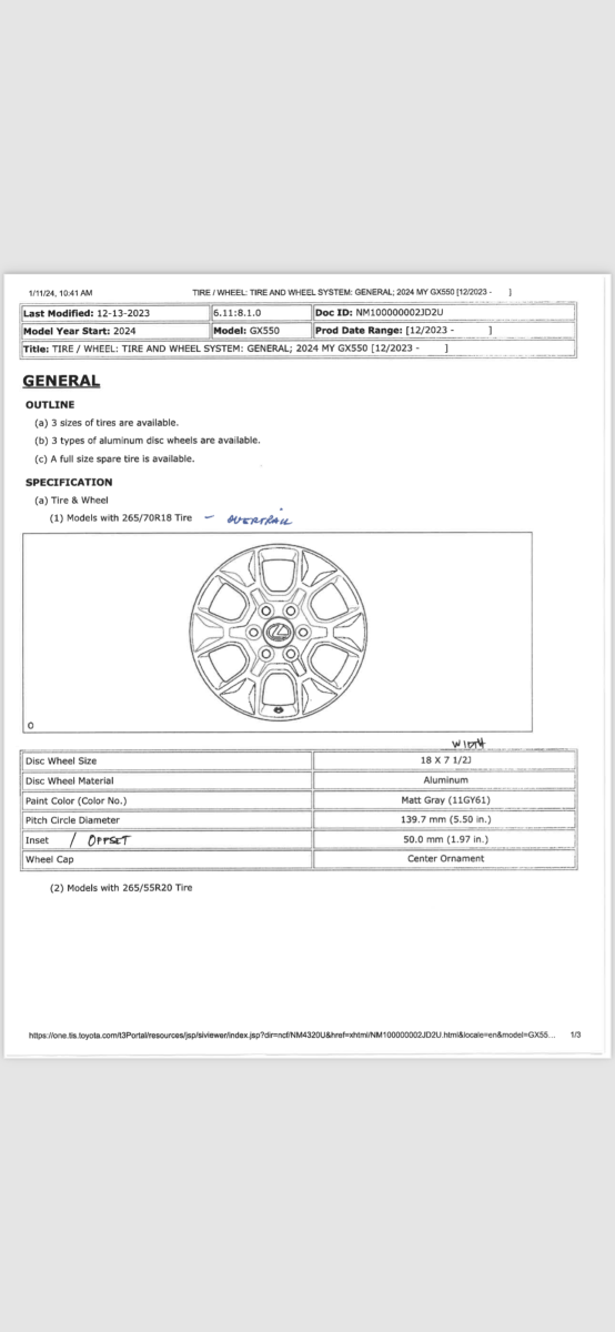

Hey cool. Something I can help with.
My dealer was able to provide me this a couple months back from their internal systems. Seems very legit and detailed
Should be 18x7.5J ET50 6x139.7mm(5.5”)
265/70R18 Tires.
Basically, and should surprise no one. Same same as the tundra.

Dude you’re a life saver. I’ve been hunting this information for over six months. Thank you! Now to find a TE37 this size haha

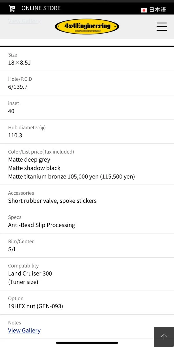

I came across the legendary Bradley Takumi that has a “tuner” spec that is specced for the lc300 world market and should be an attractive alternative to the oem OT wheel
