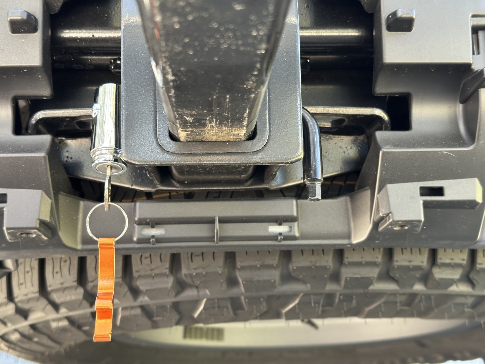

View attachment 5423I put my Sherpa on today to test it out. I had to remove the additional plastic trim to be able to insert the pin, but then put it back on after. The Kuat pin that comes with the rack worked great. Able to lock it with wiggle room to spare. I would reach out to Kuat about getting a newer/different pin than the one you have.
And for what it’s worth, the rack doesn’t insert very far into the receiver compared to my old truck. This is actually really nice because there’s plenty of room to get between the truck and the rack and open the glass. And with the rack tipped back the whole hatch opens easily without hitting the bikes.

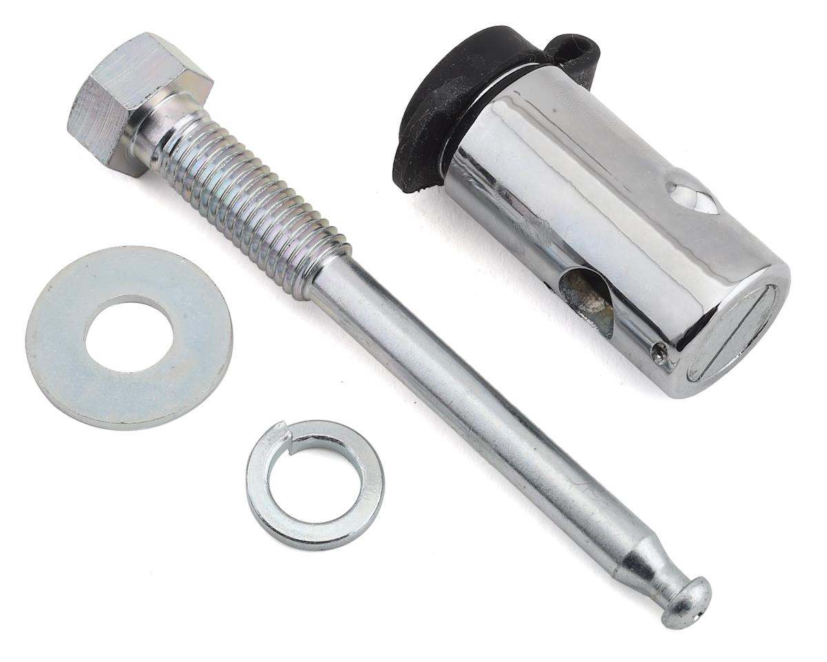

Thanks. I’ve already called Kuat but they can’t help It’s a threaded pin and that’s all that works on my particular rack. They don’t have a pin that’s long enough. Yours looks to be a lot longer than my threaded one. I’m out of town and heading to a bike store today to see if they can help. So far nothing works. Thanks for your reply.

I’m still not sure why you can’t swap the threaded pin for a newer style pin from Kuat like the one that came with my Kuat Sherpa. I have an extra 1/4”-1/2” of play after the lock is on and secured.

it sounds like the user that’s having trouble has a threaded pin for her rack. Mine doesn’t have the threaded pin and fits fine with rook to spare. I believe that Kuat sells the pin similar to mine in 2 different lengths.

I think I see the problem. His is what your pin looks like, right?
