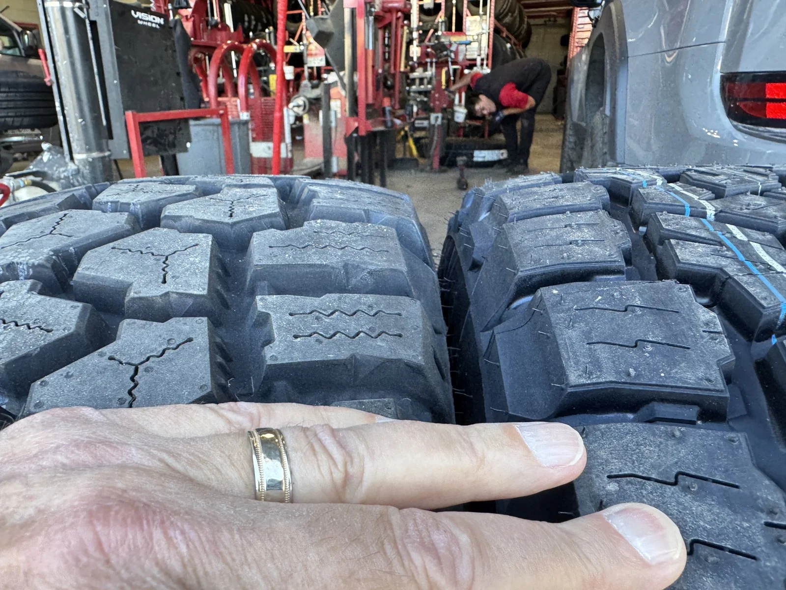

I recently replaced my OEM 265/70R18 Toyos with BFG KO3 275/70R18's on my 2025 OT+, including the spare. While the larger spare fits the underside/mount nicely, it now interferes with my ball mount. I can no longer slide the shank in far enough to use the deep pin hole; I’m forced to use the outer hole, which leaves the hitch sticking out further than I’d like. I'm now looking for a ball mount with a shorter shank or considering cutting my current one (though I don't know if that is recommented). Any suggestions for 'short-shank' drop ball mounts?

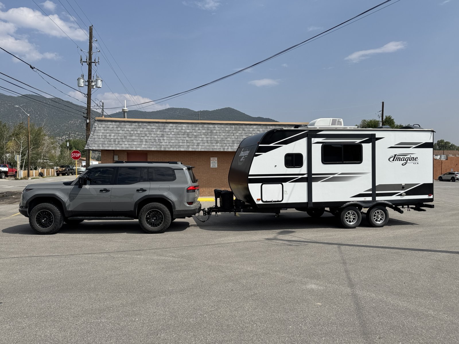

My ball mount setup is actually sticking out farther (from back of hitch mount) than what is recommended in the owners manual; I think 3”. Don’t have the page handy, but I recall there is a reference sketch there. I debated over that, but, after various tests with my new suspension and new summer wheelset (wider track and E tires, @ 50 psi) I’m having zero issues. The trailer now tows like a gem, tracks great, zero sway, no dangerous bouncing.
Other than height differences, I’m using the same exact hitch, ball setup (WD and anti-sway) as I used on my 2022 Sequoia and our 2017 MBenz GLE43 (air ride suspension).

Happy my KO3's are E Rated for towing and off-road. Ride great at 35 PSI. I do increase tire pressure when towing. The built in Compressor is great. I'm using an Andersen Hitch setup. Since I can't use the deeper pin hole, the increased leverage is noticeable on the rear suspension. I'm looking to have the Andersen shank professionally shortened - cold-cut bandsaw and chamfer the edges.
