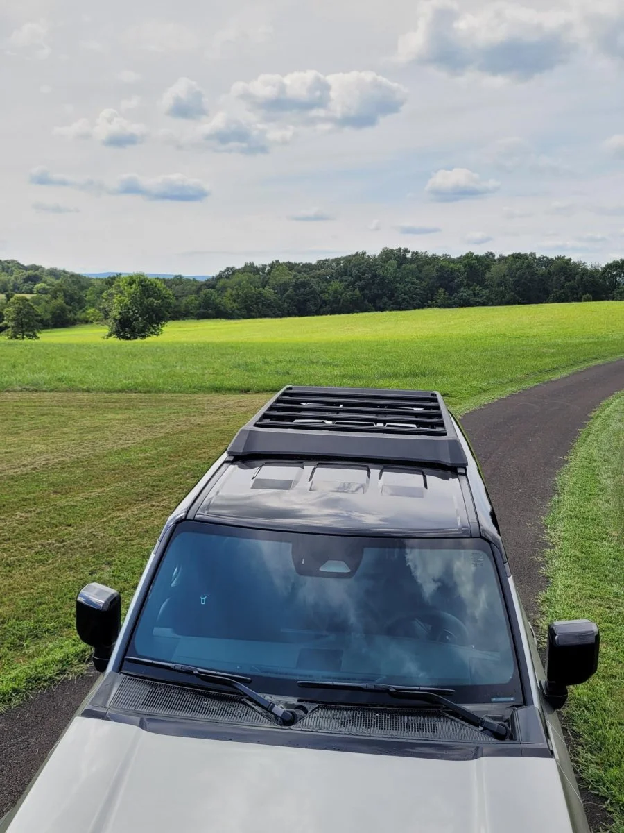

It fits. Really well. Super easy install and great instructions. I would recommend this over the Lexus roof rack (noise, not very tight on the roof). I didn't want to wait and didn't need a full length rack either.

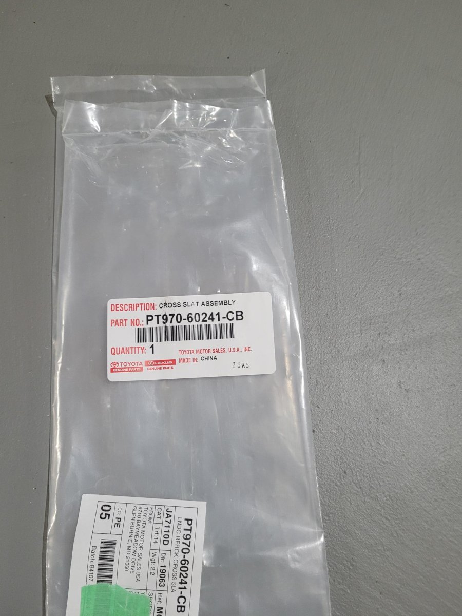

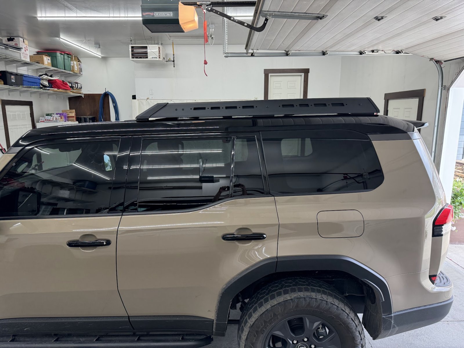

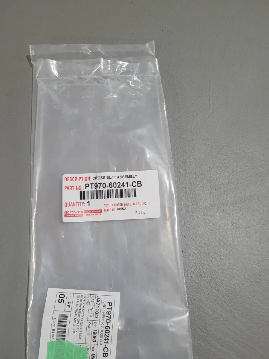

I installed the Landcruiser FE roof rack on my 2025 OT, it was easy and I did it solo in about 1 hr. The WIMYA video is decent and has good advice. Yes, apply some silicone around the plastic sleeves that are for the roof bolts. Get a good step ladder. Follow torque settings per Toyota, and do NOT over torque any of these. One thing you should do is also order a single crossbar (cross slat), part number below. For some strange reason Toyota omitted the rear cross bar. They have the bolts in place already in the roof rack frame and the open space at the rear is obvious. So all you need to do is buy the extra cross bar and install

I installed the Landcruiser FE roof rack on my 2025 OT, it was easy and I did it solo in about 1 hr. The WIMYA video is decent and has good advice. Yes, apply some silicone around the plastic sleeves that are for the roof bolts. Get a good step ladder. Follow torque settings per Toyota, and do NOT over torque any of these. One thing you should do is also order a single crossbar (cross slat), part number below. For some strange reason Toyota omitted the rear cross bar. They have the bolts in place already in the roof rack frame and the open space at the rear is obvious. So all you need to do is buy the extra cross bar and install View attachment 14450View attachment 14451
