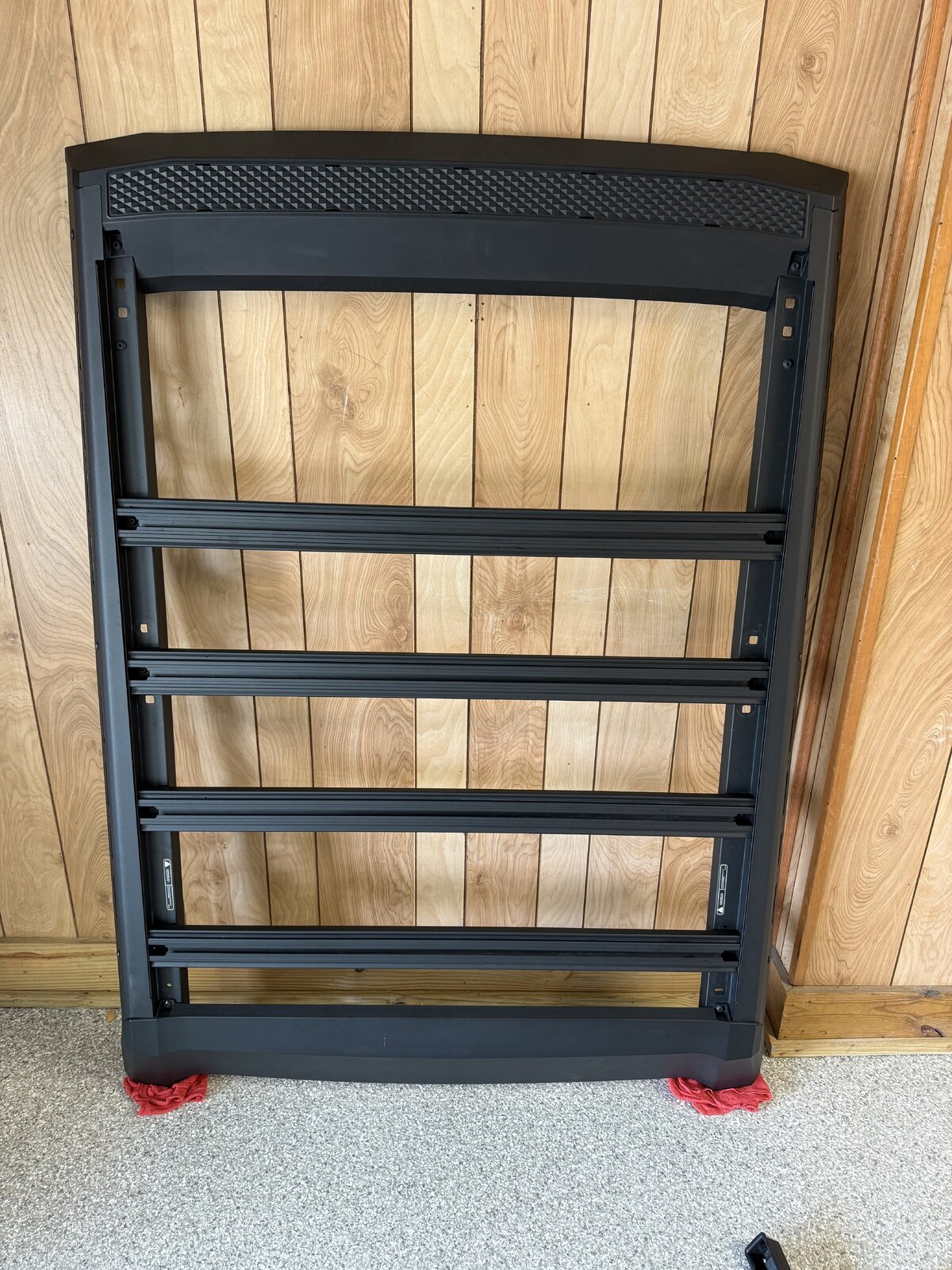

I just picked up a take off rack from a LC owner and assembled the two main sections using the small torx screws (with red loctite) after everything, I have 14 of those screws left. Any idea on where those are supposed to go? I looked all over and couldn’t find anywhere else to put them. In addition to those screws, I just have the main mounting bolts left for the brackets. Appreciate the help!
those 14 torx bolts attach the rack to the stanchions that are attached to the roof. The PDF Toyota instruction guide shows those.

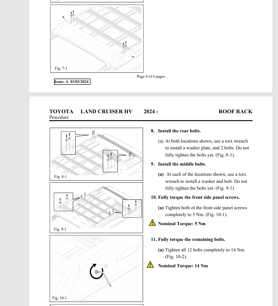

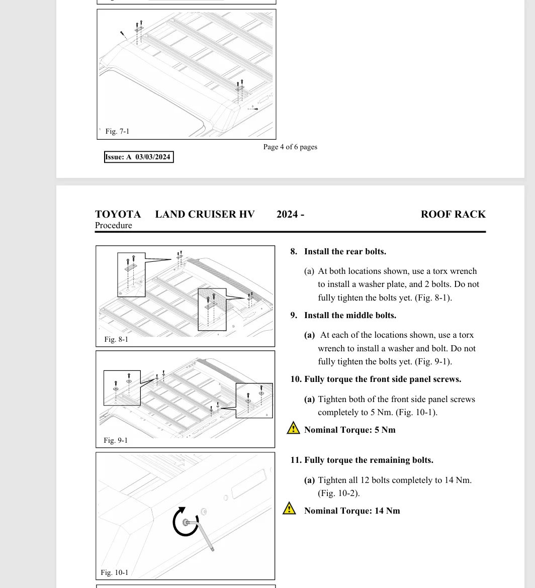

there are 3 pairs of 2 torx bolts on each side that go through the washers and washer plates, and then 1 bolt on each front side. Illustrated below, check the Toyota install guide
no problem, just take your time when you lift the rack on top and avoid scratching paint. Line up all those 14 torx bolt holes to brackets (stanchions) and only a slight finger tight all those torx bolts before you use the ratchet. Send pics when done!

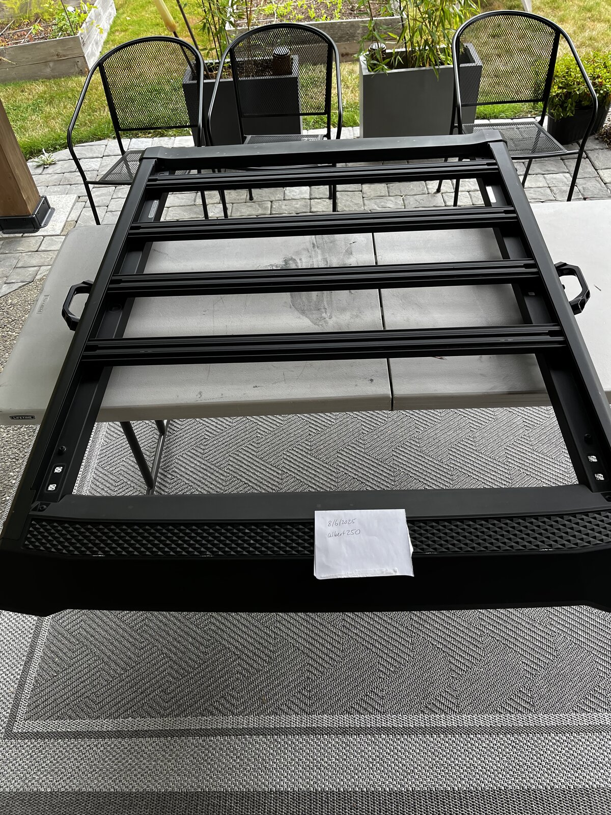

I’m thinking the Cale75 on that forum is a fraud. I asked him respectfully for a piece of paper with his site name and date on it due to all the fraud going on - heard back nada. $600 with shipping is a scam.
Just got a picture from the guy - so maybe its legit.
