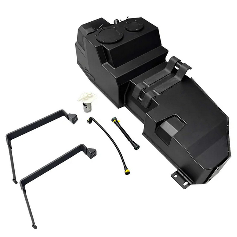

new FK (Chinese??) 29 gallon direct replacement extended range tank. $2k for 8 extra gallons and you get to keep your spare.

Time to look at alibaba for better deals since these are coming from China. $1399
Untested brand (but probably the same) for a similar full replacement tank 110L = 29 gal
The link also offers the aux tank for $1599
Maybe it's just me - but I'd avoid any Chinese knock off tank. I'd rather pay more for a known brand/installer.
I think I'll purchase this tank. Anyone have a Slee discount code?
you offroad much? i'd like a closer look at all these after market tanks. Seem to hang lower than stock. Definitely the LRA one, not sure about this one that claims a built-in 5mm skid. Is the skid an actual skid or just the bottom part of the tank?
The Overtrail comes standard with a 4mm skid most everywhere and 1mm sheet metal under the gas tank. I hit the front 4mm skid on a rock and it is bent. Like beyond recognition. On a very mild trail my tire dropped of a small rock and between the suspension compressing and the low clearance of the front skid, it made a dent that's practically touching my front diff now. If it hit the tank, that 1mm sheet metal would rip like paper.
Im upgrading all the skids to 1/4" (>6mm) aluminum or steel.
If the skid on this tank is an actual skid and not just the bottom layer, and if it doesn't hang too low, I might consider. Otherwise, a jerrycan it is.

I would much rather have a aluminum/magnesium alloy tank than a aluminized steel tank. Aluminized steel will still rust at the welds sending rust into your fuel system. Not great for us folks in the States with ethanol blended fuel, which attracts more water from the air.
