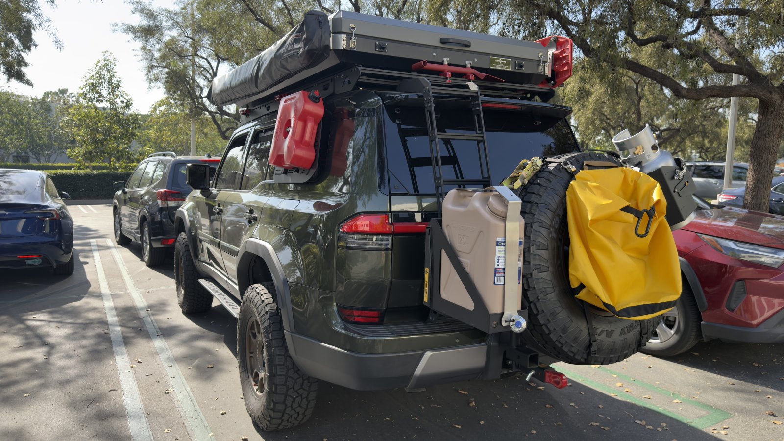

Ah I see now thanks for the feedback, yeah LRA looks like the move… wonder what the GX looks like with a spare on the rear 😅 not too interested in modifying exhaust
This is what it looks like.

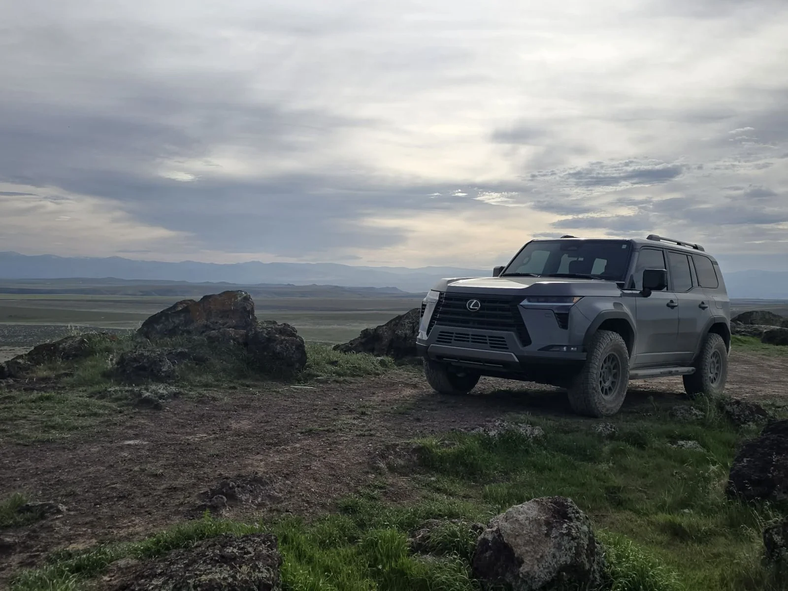

Got a chance to do some offroading over the weekend and finally test out the LRA tank. I initiated the fuel transfer the second my range on the display went to 0. I didn't time it, but seemed like it took probably 15 minutes for it to transfer the full aux tank to the main while I was driving. The fuel gauge doesn't update in real time, but it did actually periodically update without needing to shut the ignition off like LRA initially thought might be needed. Basically updated once at roughly halfway and another at some point later when it was finished, so that was a pleasant surprise. Didn't get quite back up to a full tank, but close.

Thanks for the writeup. I saw from a review that your range increases as you drive so you get a sense of what's happening in the background. Does the pump automatically shut off once the gauge shows red light? Did you calculate how much gas was transferred?
The pump did automatically shut off. It was difficult to hear it running from the front seat and just ambient noise, but kind of turning towards the rear I was able to hear it if I really listened. I'm not sure of a great way to calculate it. I kicked off the transfer when I initially hit "empty" with just the reserve left, and that's supposed to be 2-3 gallons? I plan on doing the same thing now for what is in the main tank and I will note the total gallons it takes to fill both tanks up. That should at least get a total that is within 1 gal or so I'd think.
Based on the manual you would have 3.2 gal remaining once the refuel light comes on. Perhaps you can calculate based on the range added when you started the fuel transfer. Thanks for doing this.

Dang, maybe I was extremely close to legit running out of gas from the main tank then. I was initially thinking the aux tank would completely refill the main assuming you didn't run it out, so that might explain it. I guess I will refill as close to when the refuel light comes on and note the total gallons it takes for both.

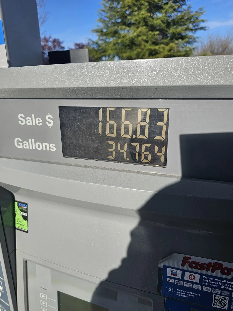

Another little update, I finally ran it down enough to do a full fill up. Everything worked normal until the last ~3 gallons and it took a little hand holding to get the last few in without it clicking off. No big deal IMO. I filled up within probably 5 miles or so of the fuel light coming on, so just taking the supposed 21.1 gal factory tank and assuming there was ~2.5 gal still in reserve, the main tank would have taken 18.6 which would leave 16.16 for the auxillary tank, so right in-line with the initial assumption.

I was informed that the last few gallons going into the aux tank will be difficult because of the rising vapors. You would need to give a few minutes for the vapors to settle before any additional gas is allowed to flow in. Alternatively, you can forgo the additional fuel if time is limited.
