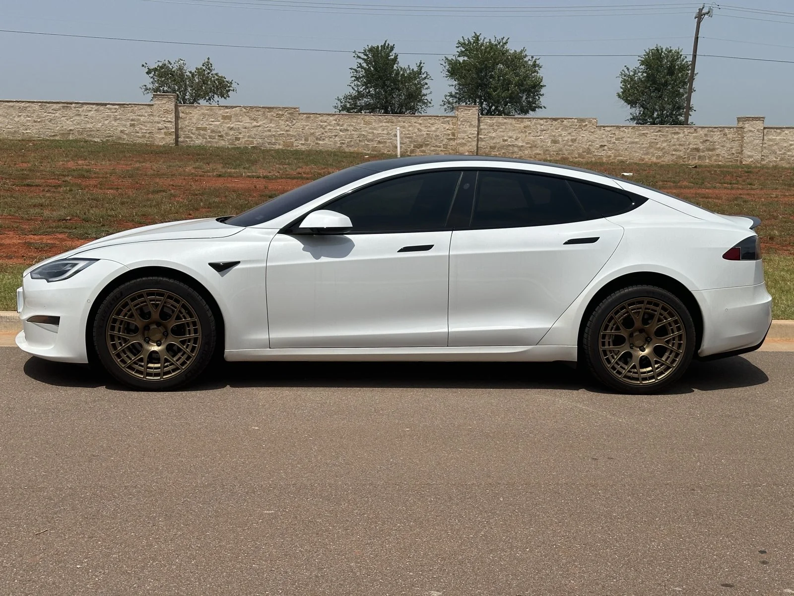

I think its in house, I have a 2021 Model S Plaid
Beautiful.
