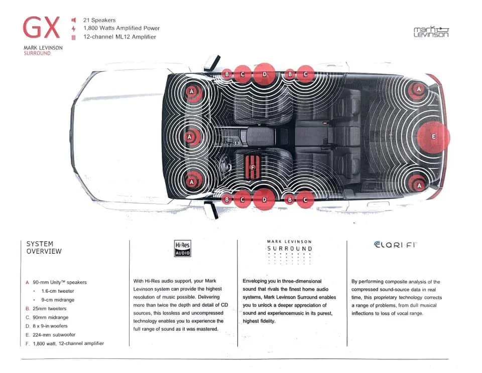

Update from dealership. They opened up the rear door panels and confirmed that there are no speakers in the location of the lower rear doors. This is the reason if sound is faded all the way to rear, bass is not existent. Dealership said this is all correct and working as designed. I have to say this is the worst audio upgrade option I’ve personally come across.

There appears to be multiple subs all over the vehicle (all doors including back hatch, presumably somewhere in the dash, etc....) instead of one main one. Which partially explains Lexus' claim of good sound no matter where you're sitting.
It’s terrible and I’d like to see these subs because I think they forgot them honestly and we are all being lied to

Is there an actual subwoofer and just no separate controls for it in the audio settings?
No subs and a very basic system sound adjustment. It reminds me of a cheap sound system put in base models for Hyundais

I am taking my car to the dealer this afternoon for same reason. Definitely missing 2 speakers in the rear seat doors, but I can only count 16 speakers and can't figure out where the remaining 5 would be hiding. All my sound comes from the front speakers, which has almost no bass. I sat in a friends GX with base stereo and it sounded better than ML.
