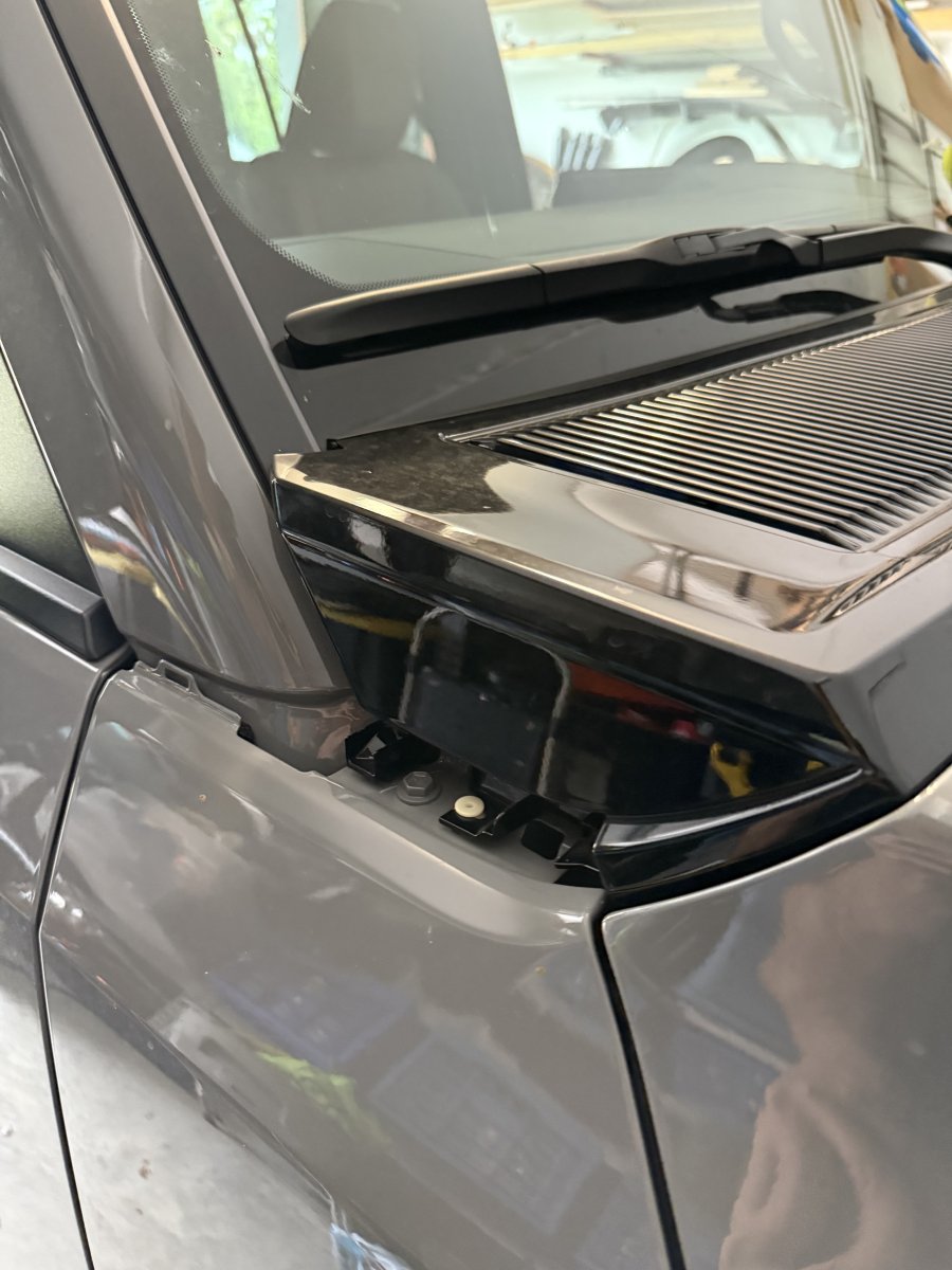

Hi all. I'm new to this forum but love my GX 550. I'm struggling to find which exact part this is so that I can order it. We had our windshield replaced and the part must not have been reinstalled correctly. It's a 2024 luxury+ model. Any ideas what this missing part could be? There are a ton of options when I look at cowl trim. Much appreciated!
You want this part,
You can buy it at Bell Lexus Parts. I provided both the right and left. I'm thinking you need the passenger side which is the right.
SEAL, FRONT FENDER TO COWL SIDE, NO. 2 RIGHT​
Part Number: 5386860040
SEAL, FRONT FENDER TO COWL SIDE, NO. 2 LEFT​
Part Number: 5386960030
