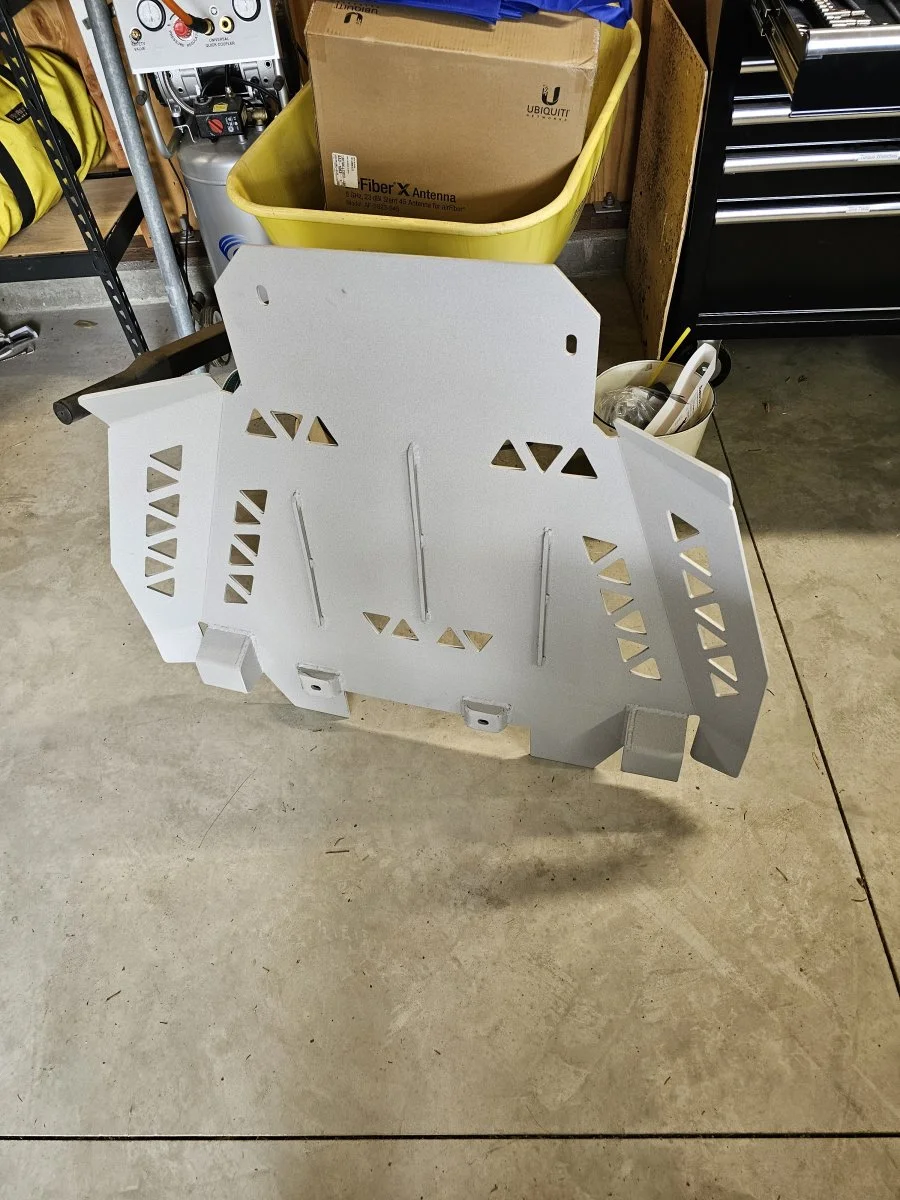

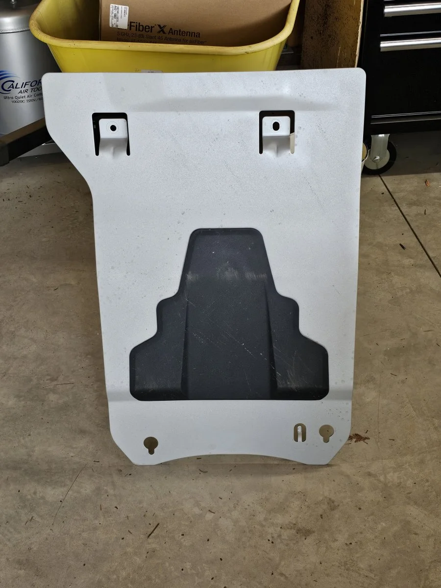

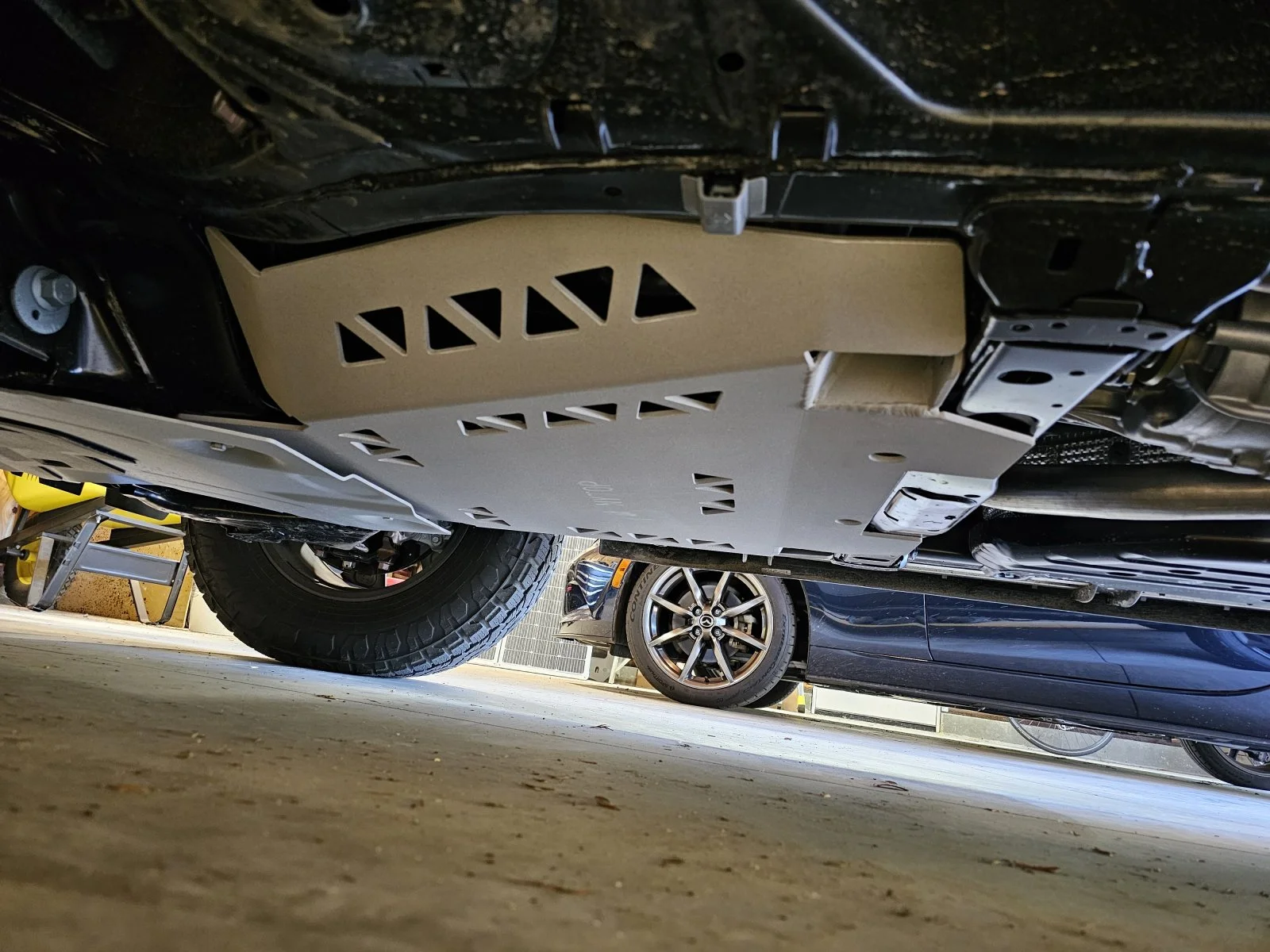

I installed this to replace the rear skip plate on my 2025 Overtrail. It is 0.25" thick (plus some welded on reinforcing bars) instead of the 0.16" thickness of the OEM part, and more importantly covers the catalytic converters. I was interested in doing this for two reasons. One is to discourage theft of the converters, and the other is to prevent vegetation I am driving over from possibly being set on fire from the hot converters. The plate was well engineered and had all the fasteners I needed plus spares. The unit was packed like it was fine china. I needed some kind of jack to support it in order to do the installation myself.

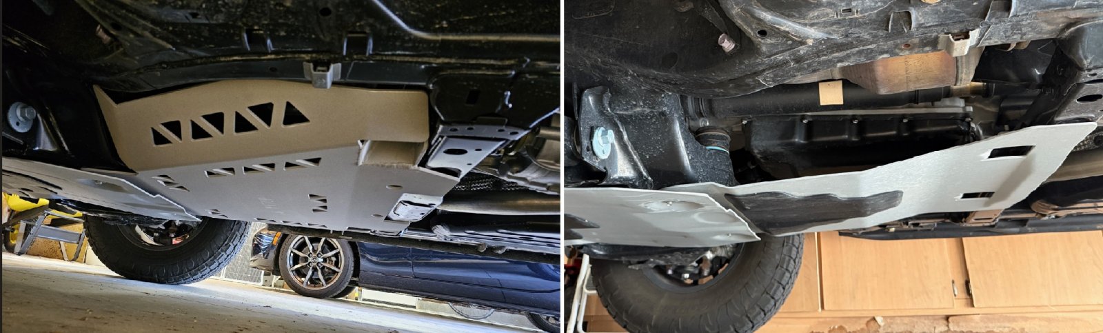

That's a nice piece. Do you have any pics of it installed? I like the idea of the skid plate covering the cats, as well as the increased thickness.
I ordered it 3/21/25 and received it on 3/26/25. It will probably be harder to remove and reinstall the front skid plate because the replacement bolts have separate washers and it may make it harder to use the keyhole openings so you might have to remove those bolts instead of just loosening them.

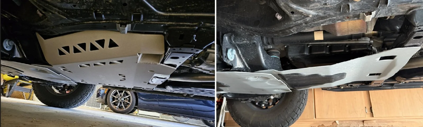

Thanks for posting the picture. It looks like it works fine with the stock front skid plate and it provides much better coverage - and protects the cats from theft.
Here's your picture compared to the stock Overtrail setup:

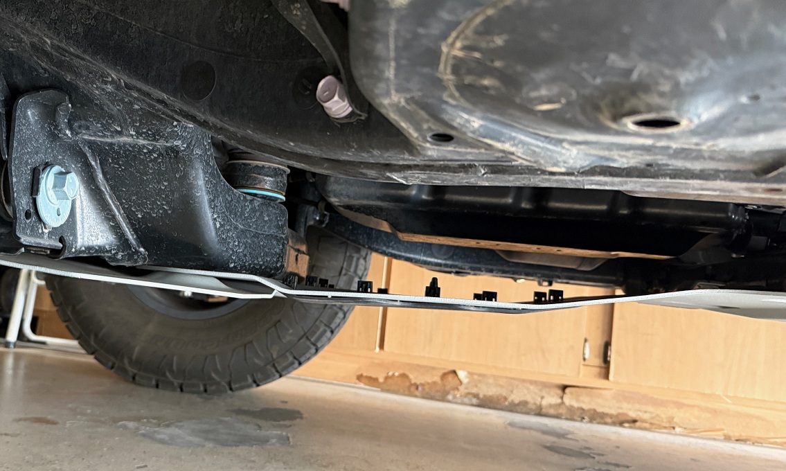

The NYTOP skid also gets rid of the really weird side-view of the stock skid plate:

Ughhh I hate both designs
Really good to see this design. The stock one was mounted using those two super-weak tabs, and I broke my tabs off finally after bending the hell out of the skid several times and bending it back as best I could. This one appears to bolt into the front side of the cross member?
