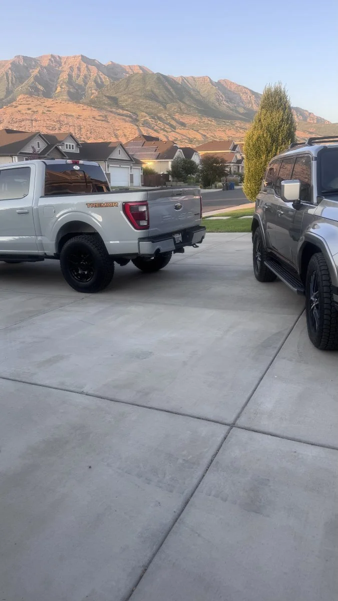

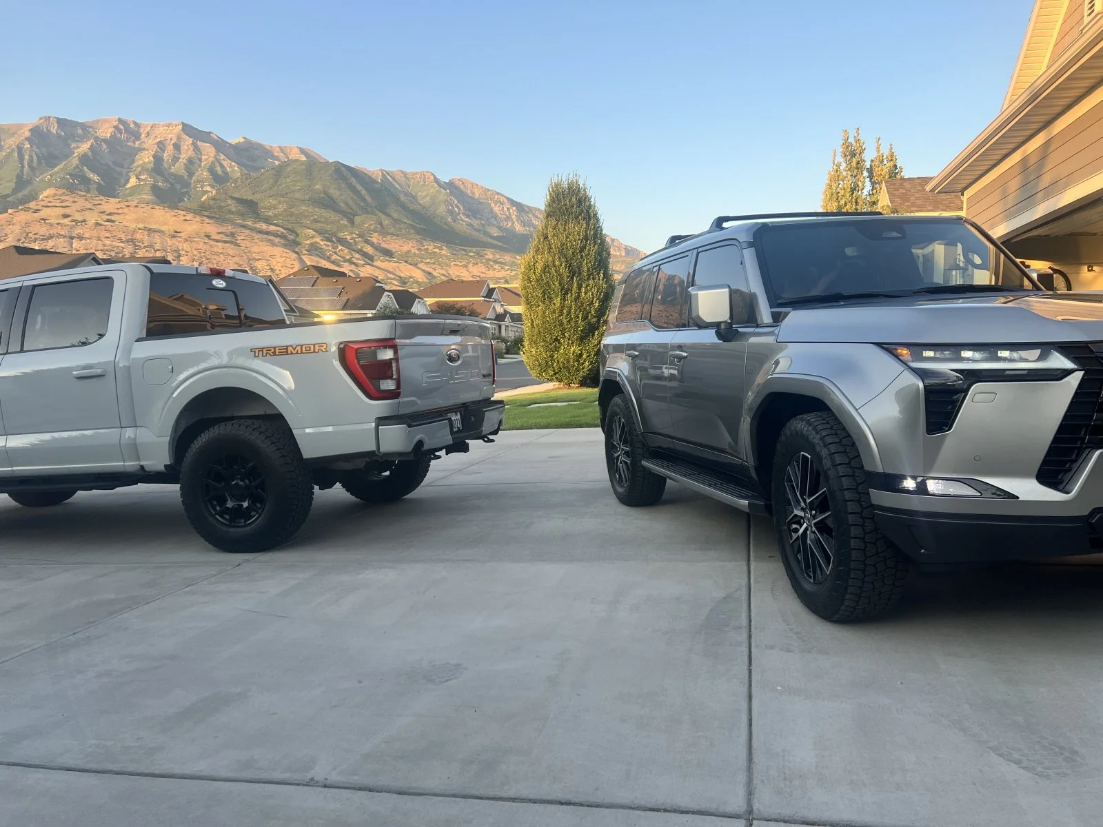

Yeah I was happy to keep such a good ride. The 275/65s ride better than the OEM 255s. I have loved the Terra Grapler G3s! If you do LTs you will greatly affect the ride quality. I know bc I have a tremor f150 and went for XL 116 load range to KT 123 load range. This pic is right now…

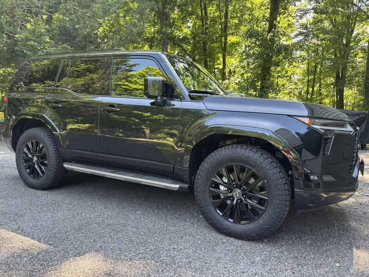

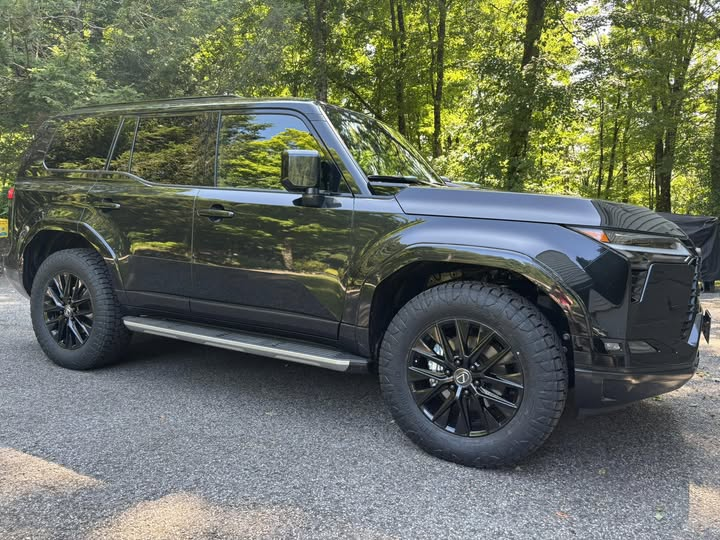

Thanks to a lot of the info from this forum. Powder coated the stock 20" Premium+ rims gloss black and added 275/65/20r SL Nitto Terra Grappler G3s. Gloss Black Silicone lug nut caps from Amazon and will be adding the upturn gloss/matte wheel cap tint to cover the chrome Lexus caps.
Wow looks amazing!! Did you also do the spare? If so, any issues fitting it in the spare location?
Also, any other images from the side view? Would like to get a sense of whether a leveling kit is truly needed. Thanks!
Looks great! Just a warning, I (think) the Upturn Prints covers only work on flat surfaces.
Can you clarify what you mean... did you go with the 116T SL or the 126S E1?
My 116's have been a nightmare. Super choppy ride at any speed. DT tried balancing them 4 times over 1600 miles. They swapped out two new ones earlier this week. Still shit. To be fair the ones that kept showing off were the passenger side and they only started with replacing the two rear. Supposed to be swapping the other two front on Saturday, so perhaps that finds the culprit. We'll see. Not sure what I will do if I pull out of their parking lot after the remaining swap and find that these tires are still bouncing. Haven't really been able to enjoy the ride which is quite unfortunate.

I was going to do wheels too but decided I didn’t hate the stock wheels. My GX is completely stock suspension. No lift or leveling kit nor are there any mods to make the tires fit. They fit flawlessly w zero rub full turn and backing out of my driveway. Zero rub. I feel like you could do 35x11.50s fine and be completely stock suspension. Also I was gonna go w the Toyo AT3s as u had had them on my last truck and went w the Grappler g3 bc Discount tire said they were super quite and drive awesome. To which they do. Suppy happy w them so far.. had them for abt a month…

Have you taken it on any light trails to see if you run or bottom out when articulating? Curious with this size and no lift! It does look great!
No trails with big articulations, couple of the really big speed bumps and just flatter dirt/rock roads. Haven't experienced any rubbing or issues with things hitting but haven't really pushed it too hard.

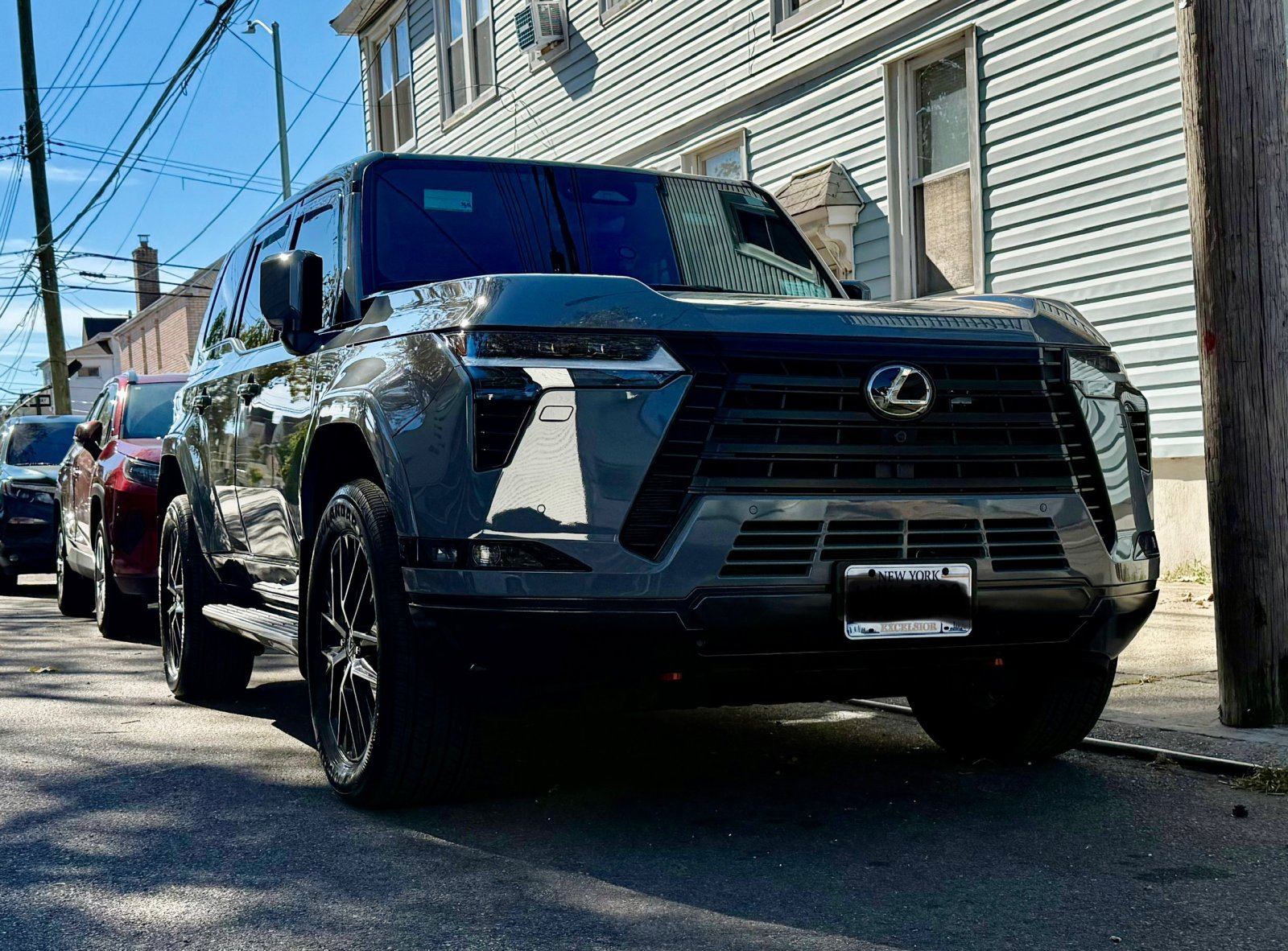

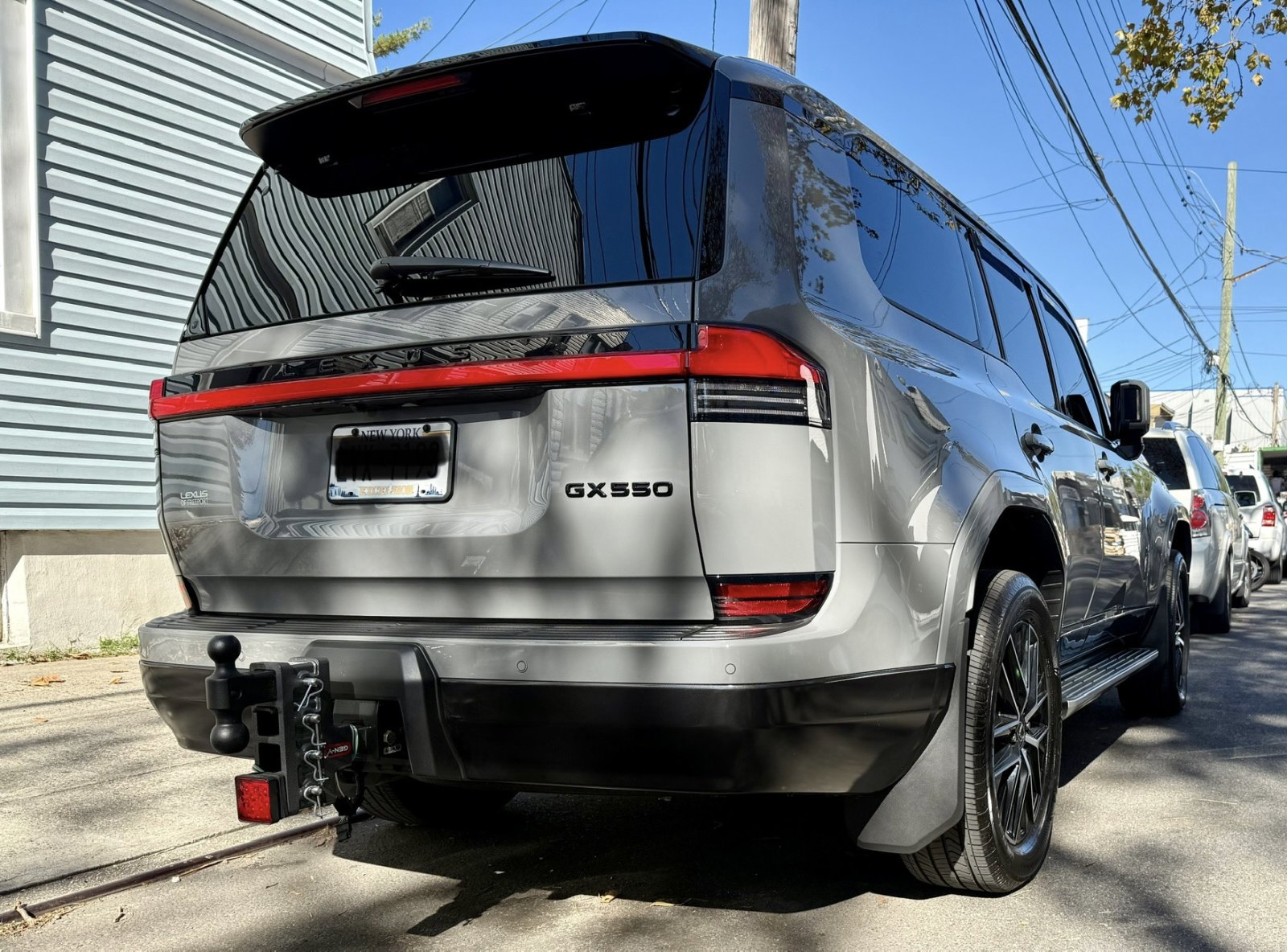

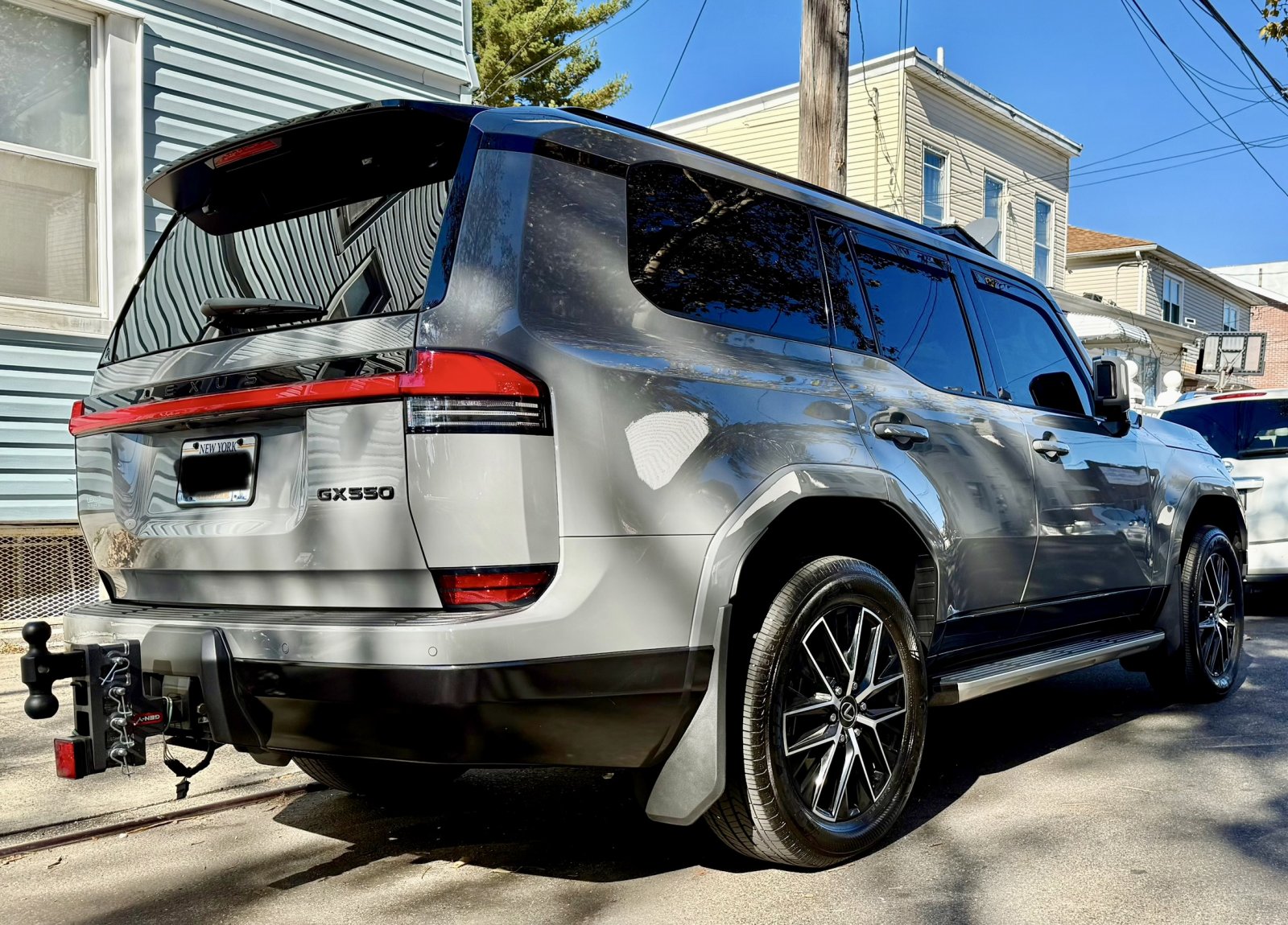

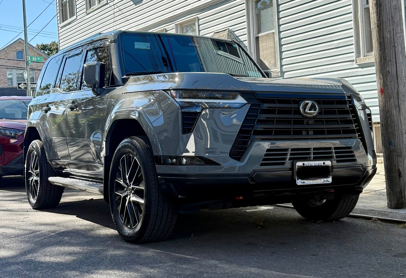

Do you think you would rub if you had 1” spacers? I added it on my truck and I’m trying to decide if I go 275/65 or 275/60

I think you should be fine. I haven't had any situation where i've rubbed or anything. You did the peak front 1" spacer? I would think that would make it even better as it'll give you as much space as the rear has.

Happy with your decision months later? I really like what you did am probably going to do the same
