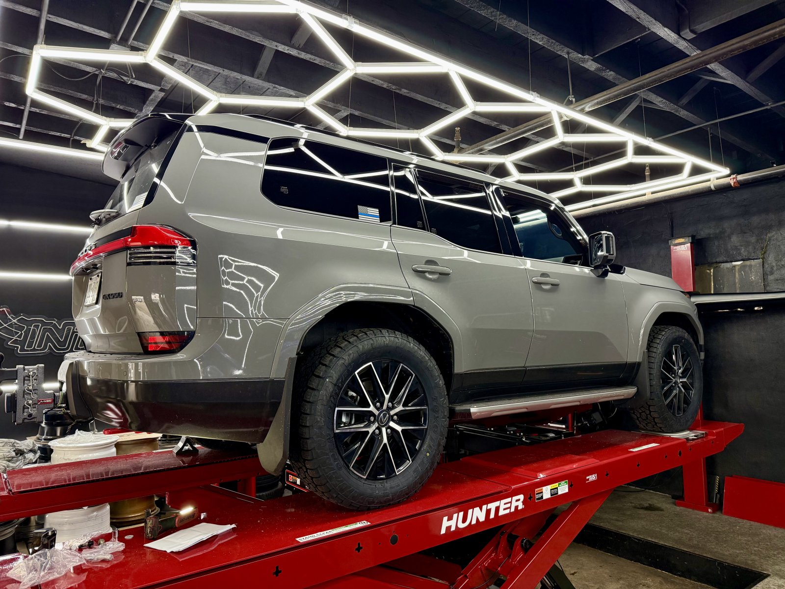

I put the same Nitto Terra G3 275/65R20 on my prem+ wheels. Discount had them at 40psi. Rough ride. I dropped to 35psi, but still feel like it could be a bit more supple.
And thank you giving me the confidence that they would fit. I know I would have wanted more tire had I used caution and went with 275/60 as that's what most forums/threads say are the max (without noting that the spare is the limiting factor). 34's fill out the wheel wells nicely.

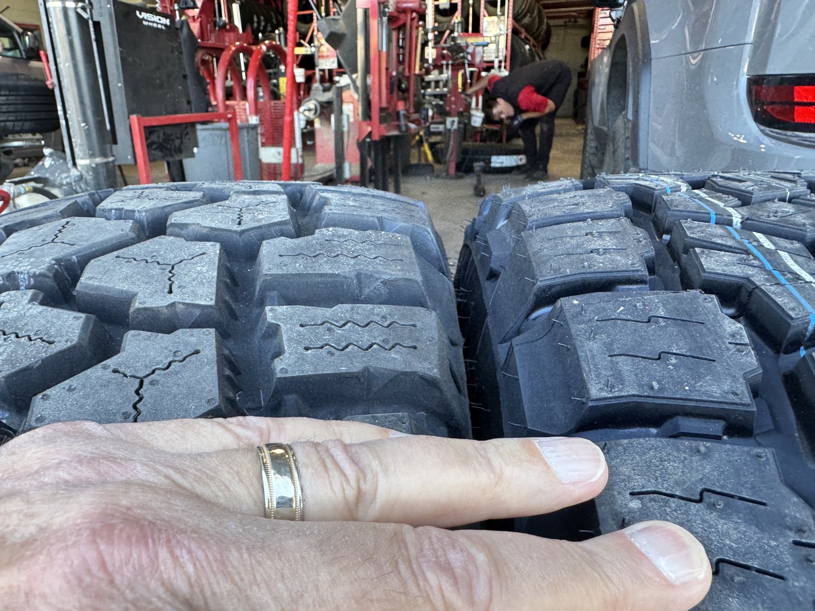

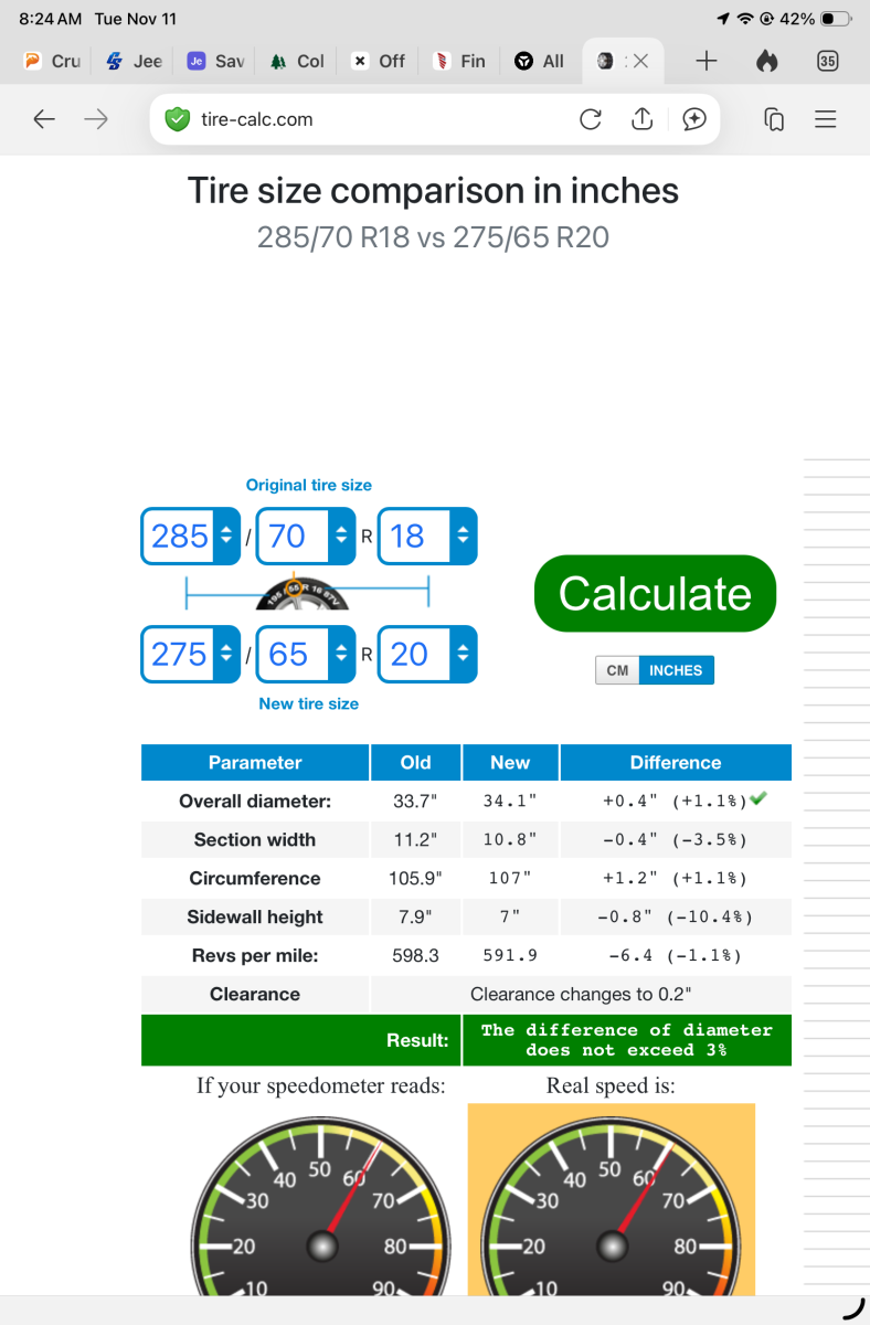

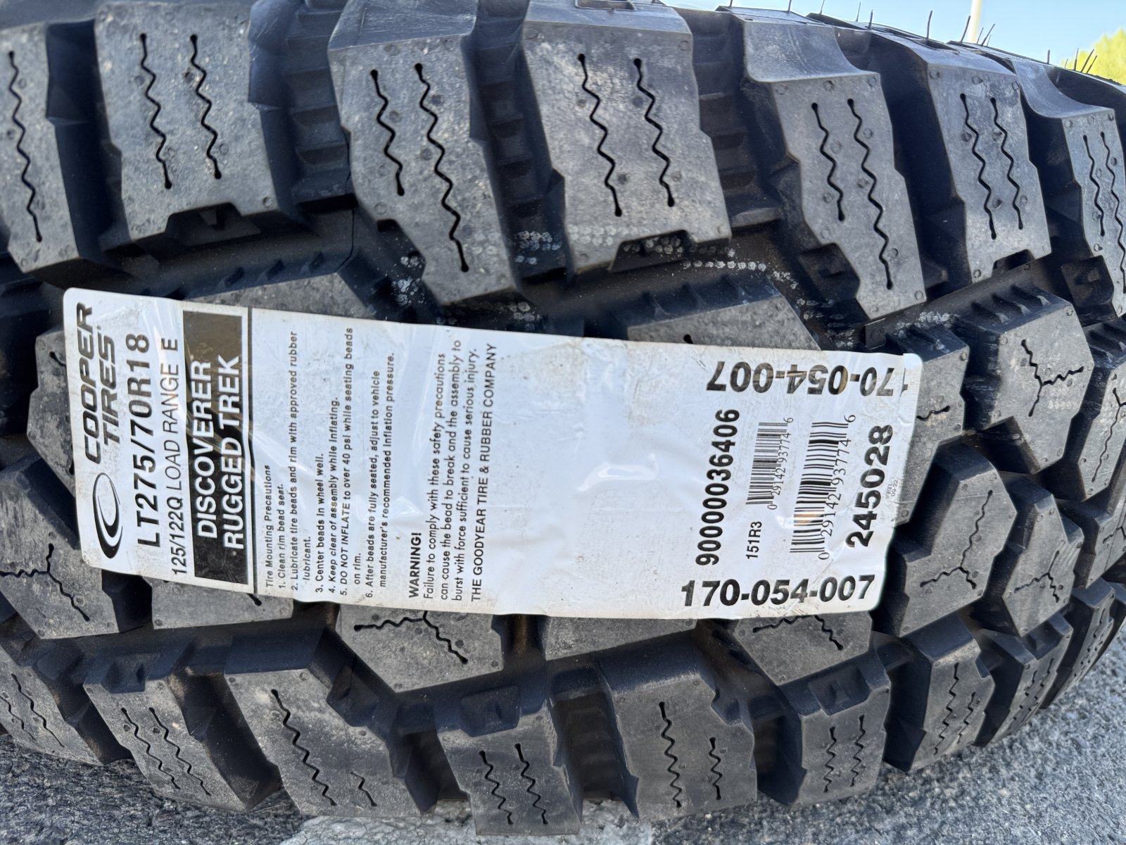

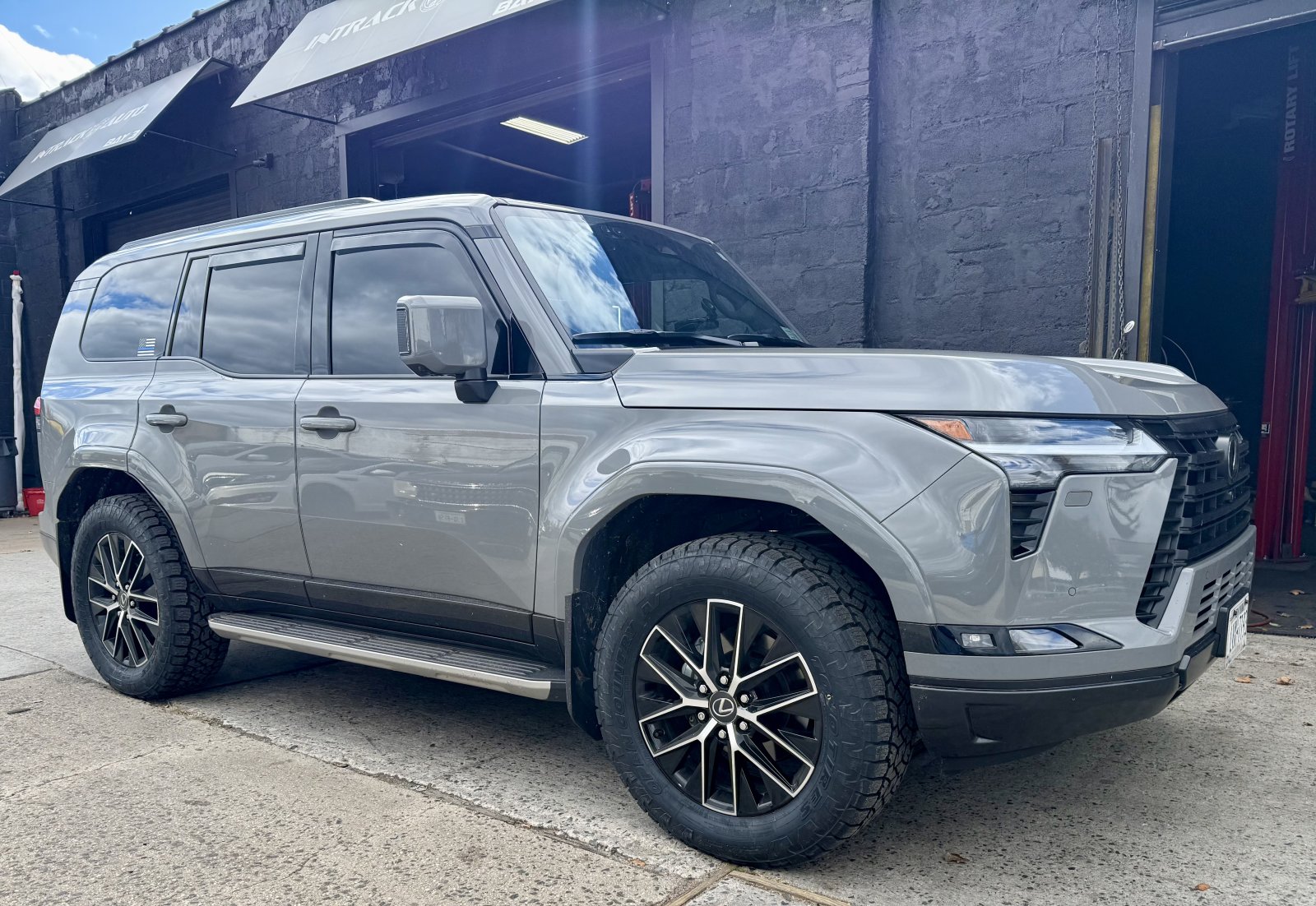

Ray, I’ll address your spare tire concern with what I know.
Short version: 😊

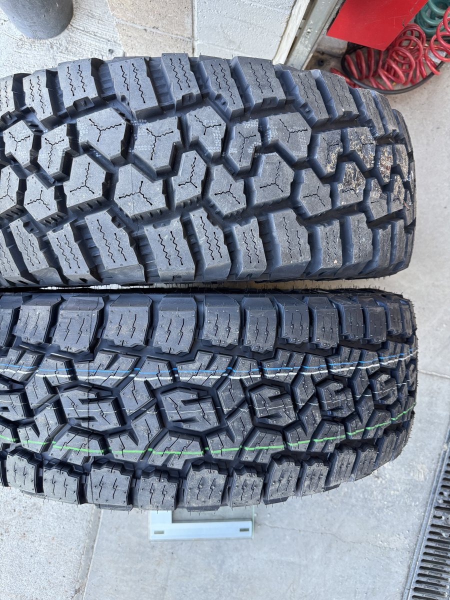

Right now, before getting your GX, is go by a tire shop that has the same exact Cooper Discoverer RT you see in my pic. Use that as your gauge. Then stand whatever 275/65/R20 you’re considering next to it. That’s an easy test. No mounting required at this point.
Long version: 🤨
A couple initial caveats: 1) My GX is a ‘24, yours I guess will be a ‘25 or ‘26. So I cannot be absolutely positive that the provided spare tire space is/will be exactly the same diameter as my ‘24. Maybe Toyota-Lexus slightly increased that space, volume without announcing it. 2) You cannot fully rely on stated manufacturer nominal specs, or, that all 275/65/R20 will be the same true diameter.
I currently have the Cooper 33.7-ish spare (stated to be 33.66) mounted, inflated and fully seated up into the spare tire space. It rests against all 3 or 4 touch points that guide it into place as you crank it upwards. It is fully seated vertically and laterally with no remaining space, none. I do not use a 5-tire rotation, so it’s okay to be a different tire. I only wanted an E rating, with nearly the same diameter as the mains.
That’s why I’m doubtful that a true 275/65/R20 would fit upwards all the way. However, an actual ‘shy’ 275/65/R20 non-E (significantly deflated, spray lube on touch points) might have a small chance of fitting.
Before I committed to my new tires path I went to my local DT store, and we mounted up the Cooper spare I thought would just barely fit. It did. It’s a very tall 275/70/R18 E, actual about 33.7 (vs. a nominal tire calc of 33.2). It just, just fits as I describe above.
Next, I ordered in my 4 main tires, the Toyo AT3 E, in size 285/70/R18. It is an actual ‘shy 34’, coming in at 33.7, same as my spare.
That’s how I did it, after looking at several websites - and then doing a hands on confirmation.
You can see the Cooper spare and Toyo main side by side in the photos before we mounted all the tires.
Best to you, you will love your GX!
-DJ

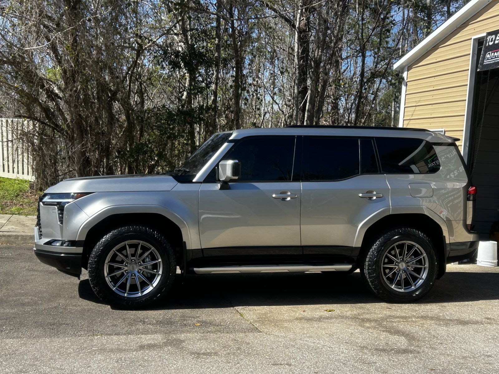

From my understanding if you get wheels with a different larger offset (+ 30's vs +18) you might not fit the 275/65/20's and might need to go down to 275/60/20's. I have not done it yet and like you I am waiting to get mine. I will attach a link that shows one GX550 Aftermarket Wheel & Tire Thread.
20" Vossens HFX-1
275 60 R 20 - Toyo Open Country Tires
Finally got my ride. Added Vossen 20 inch on 275/60 Cooper AT's and loving the look. Little bit of a poke but looks good

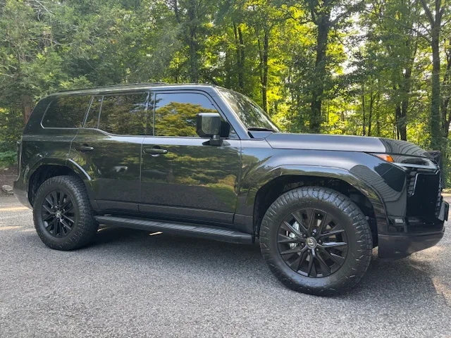

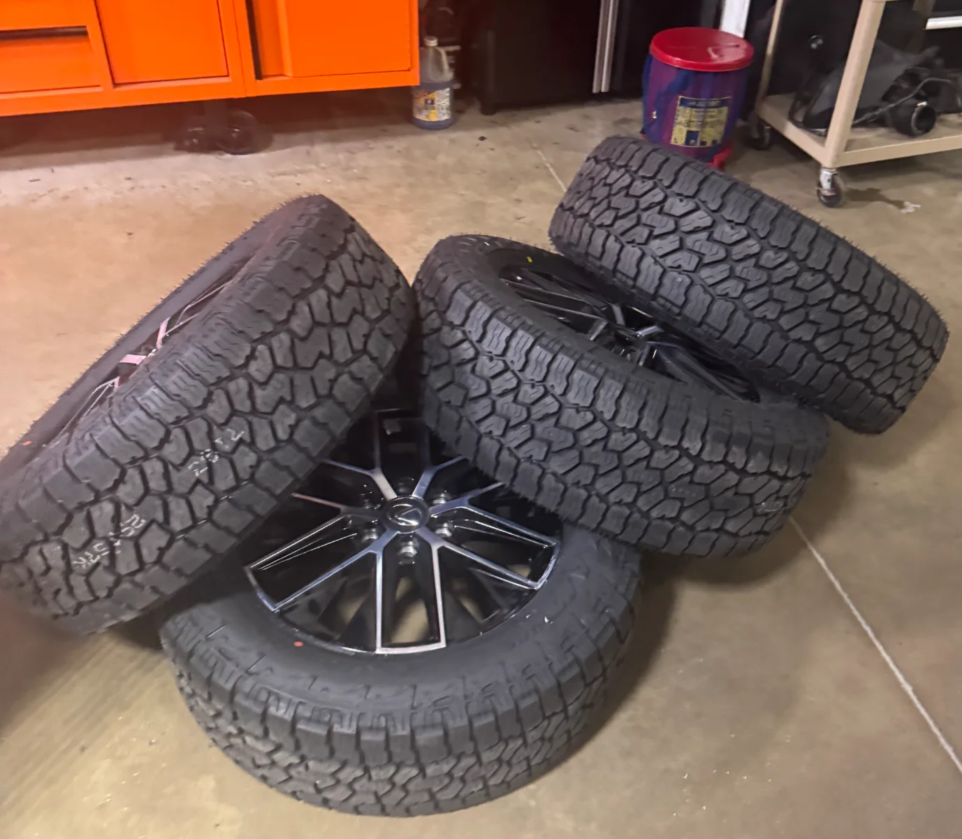

Thanks to a lot of the info from this forum. Powder coated the stock 20" Premium+ rims gloss black and added 275/65/20r SL Nitto Terra Grappler G3s. Gloss Black Silicone lug nut caps from Amazon and will be adding the upturn gloss/matte wheel cap tint to cover the chrome Lexus caps.
