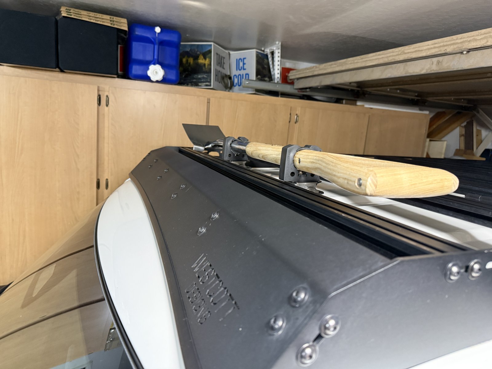

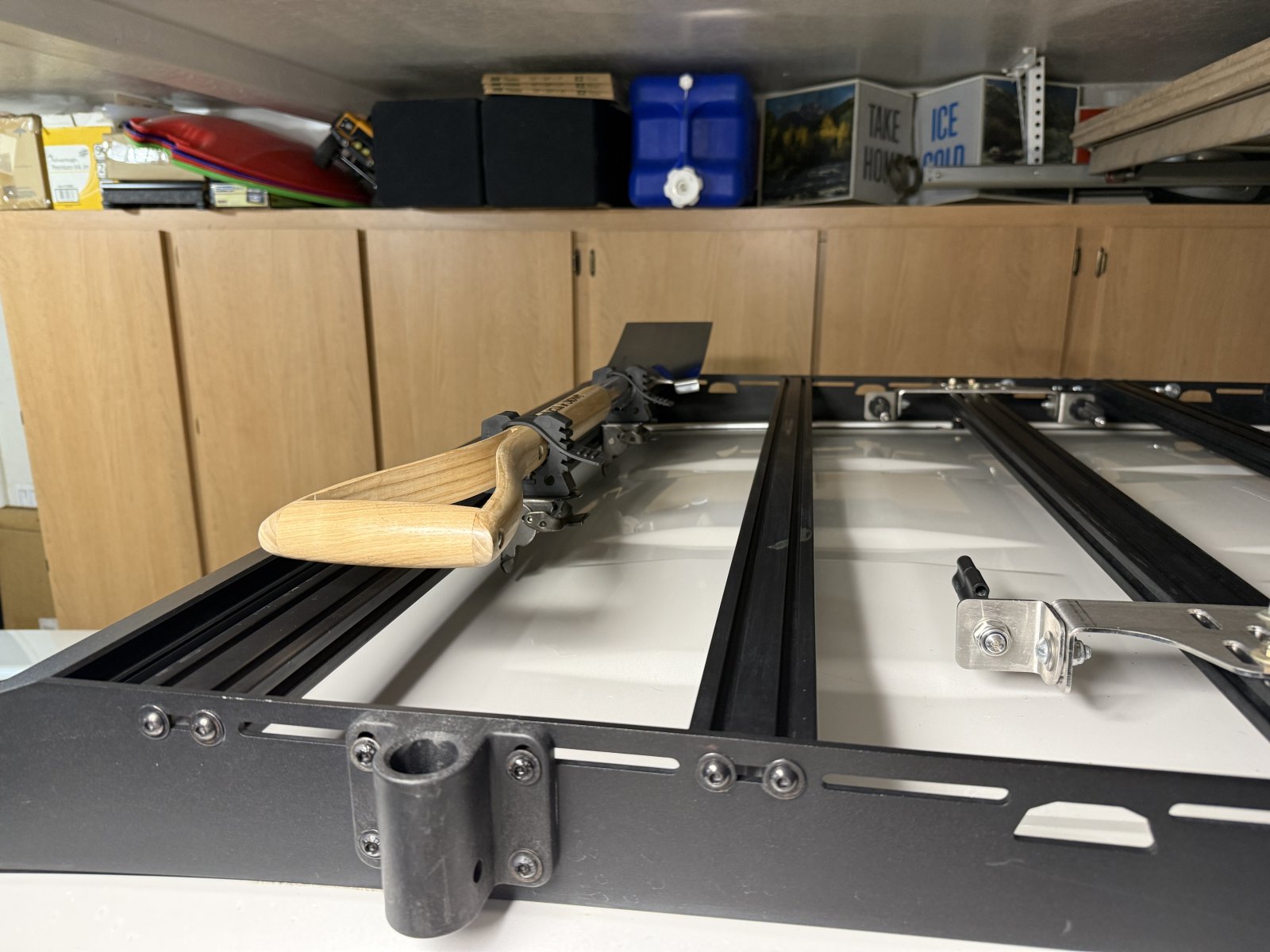

Anyway, tonight I was tinkering, as my wife says, and I finally finished my new shovel mounts for my roof rack.
After my December to Remember adventure in the new mud pit at my favorite local camping spot, I realized that I need a good shovel that you can actually dig with for a good amount of time without breaking your back or making your hands raw. I have carried my father's US Army-issue folding shovel for over 30 years but it's more suited for digging fire pits and single-serving field latrines. Since I'm not a $300-super-off-road-overlander-Armageddon-spiked-razor-sharp-shovel-zombie-survival-tool kind of guy, I looked for a useful and somewhat classy alternative. After far too much research, I settled on the Kent & Stowe border spade which is a quality 41" long English stainless steel spade with an ash handle. Two requirements were stainless steel and a wooden handle with a real hand grip. I hate the simple straight handles that dig into your palm with any amount of real work. I'm not a soft hands guy but I also don't dig holes for a living. I found this fine English tool at Walmart online, of all places. $92 shipped to my door. Only £39.99 on Kent & Stowe's UK website which is about $54 but then you have shipping and import taxes on top of that...a few clicks on Walmart's website and it appeared on my doorstep.
I chose this shovel size and shape because it's good for swiping sand away in a rowing motion as you're on your knees by the truck, such as scooping sand and gravel away from behind the tires. The size (blade is 9" long x 5.5" wide) is good for moving some material but also not so big that you're trying to move too much weight with each scoop. Same for mud. You can cut in manageable scoops instead of trying to move a 40-lb clod of wet mud with each scoop.

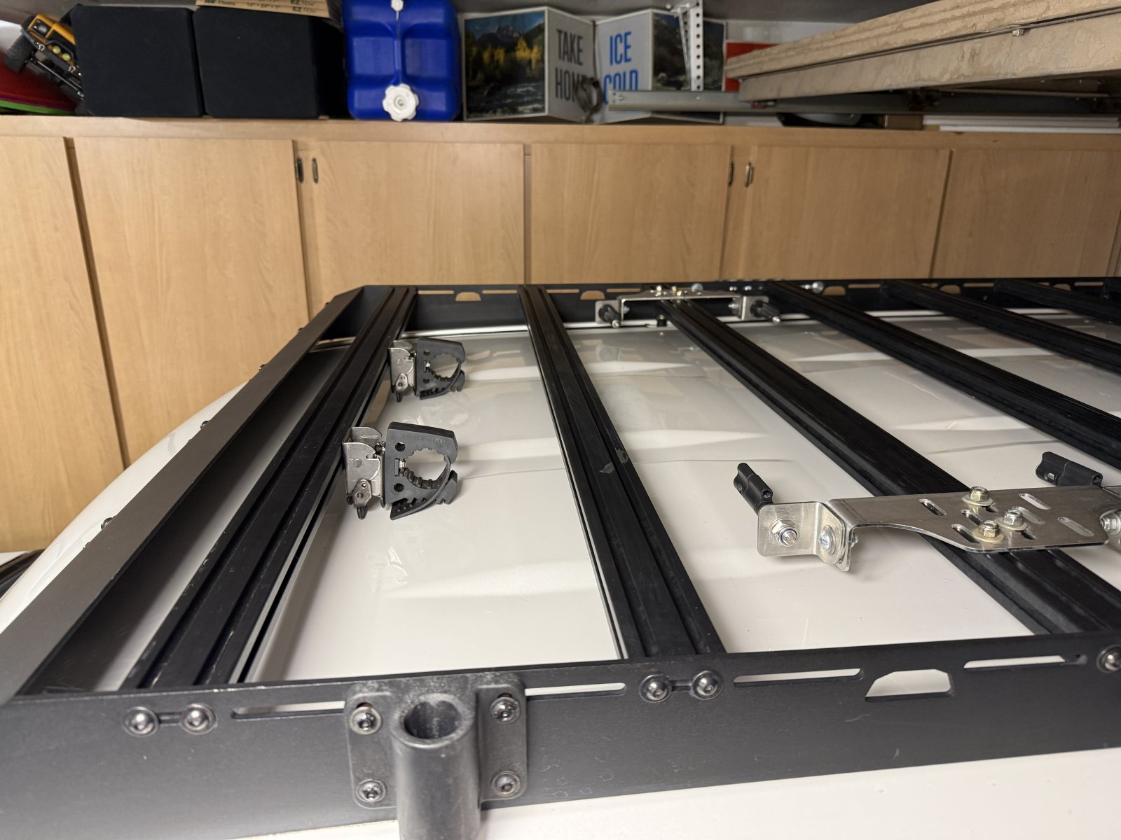

In keeping with my quest to keep my roof rack as low-profile as possible, I didn't want to bolt on a shovel mount that stuck up a few inches, thereby losing my garage clearance. I also don't really have clearance on the side of my low-profile rack to strap on a shovel without hitting the body of the truck. Most shovel mounts from the Armageddon crew are also nearly as expensive as the $300 Armageddon shovels. I figured I'd just be throwing the shovel in the cargo bay with all my other junk and then I had an idea.
Years ago I bought a couple of folding & locking hinge mounts on Amazon for some long-forgotten truck-related project. These look like the same brackets. They sat in a little box on the back of my workbench forever. A couple months ago I cleaned off my workbench and I relocated them. As I lay awake in bed one night at about 3:00 AM thinking of stupid random things like mounting a shovel on top of my truck, I remembered these hinges. The next day I had to tear apart the garage cabinets to find them because of course I forgot where I put them. Then I spent a good 2 weeks moving the project forward in very small increments, as is my way.
I found the perfect rubber mounts at Harbor Freight (Vehicle-Mount Rubber Tool Clamp). $2.99 each. Take that, $250 Armageddon zombie apocalypse shovel mount companies. I had to use my Dremel to cut down the flanges on the hinges to clear the roof when folded, and also cut down stainless steel bolts to fit just right in the hinge and in tracks on my rack and into the Harbor Freight rubber clamps. I removed a cross bar to get the bolts all in the proper places on my workbench, reinstalled the cross bar, and it works exactly as designed.

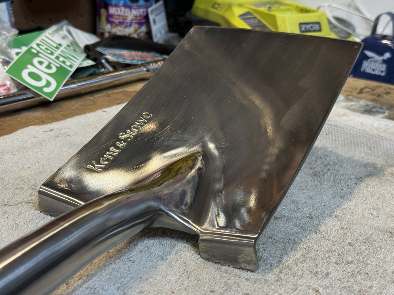

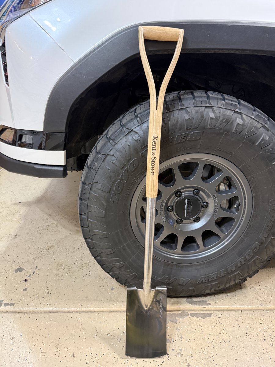

Ah yes I bought the smashing Kent and Stowe shovel from across the pond. It is a splendid contribution to my kit for overloading adventures without the bollix of a larger blade. They did bang me for about 100 quid and have no idea why I suddenly needed yet another garden tool - but it looks spot on.
You shall be pleased with ye old spade. I used mine for fire duty a weekend past. It performed admirably.

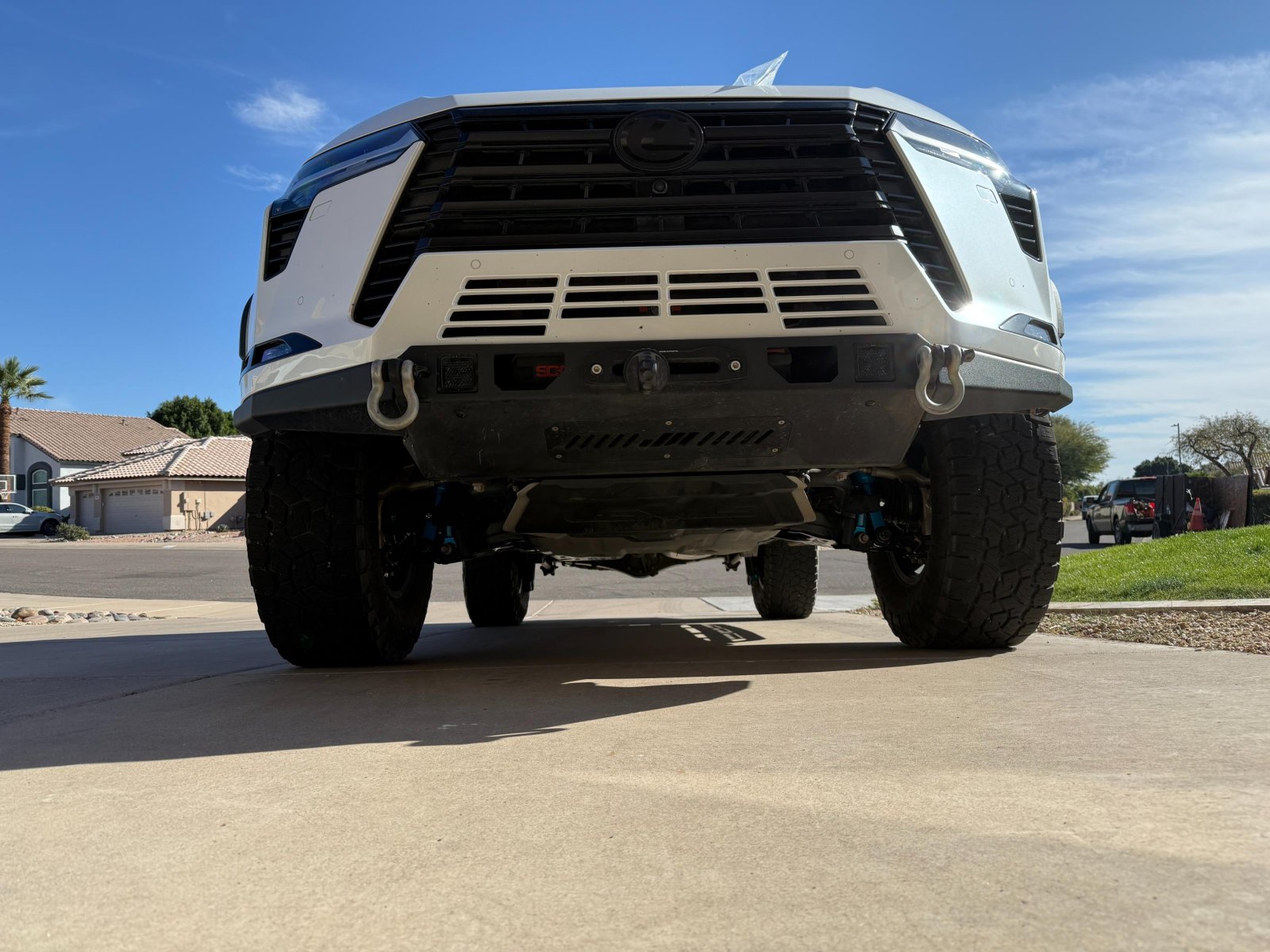

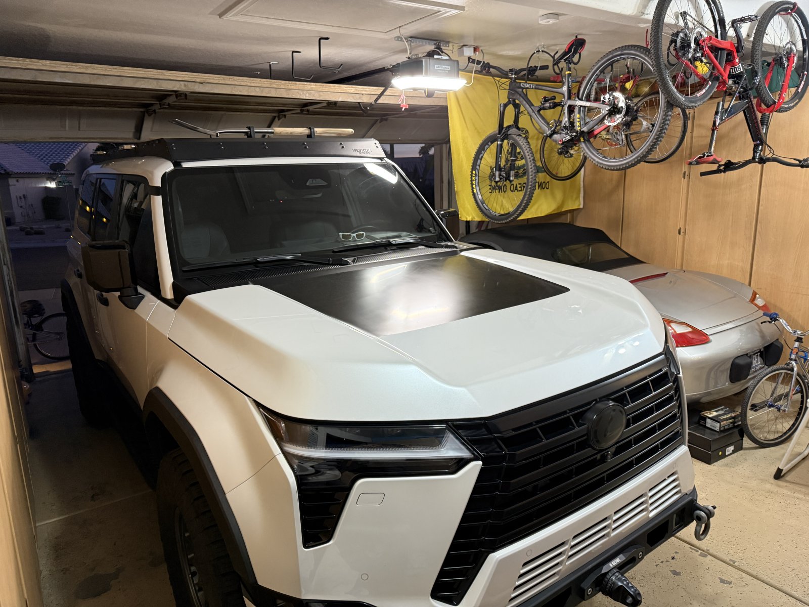

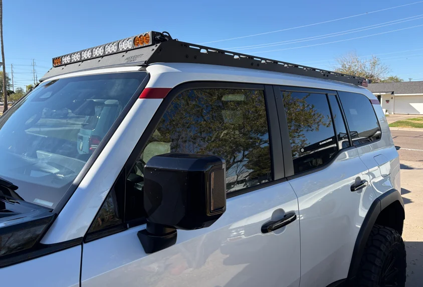

I picked up my Overtrail here in Arizona on June 7, 2024. I had Westcott Designs in Phoenix install their preload collar lift kit, their full length modular roof rack, 17" Method 703 wheels (titanium color, +35mm offset), and Toyo Open Country AT3 tires size 35X12.5R17LT (load range C). I think it turned our great, the ride is great, feels nearly the same as stock, feels a little more supple or softer than stock, and it seems like I can feel a little extra weight or inertia with the wheels & bigger tires. The stock Toyo AT3s are 265/70/18 and they weigh 44 lbs each. The 35s weigh 59 lbs each. Not sure how much the stock 18" wheels weigh compared to the 17" Methods but I'll weigh a stock 18" wheel & tire and figure out the weight of the new Method wheel & tire.
Only other changes are a hood blackout that I had a local wrap shop make for me, a touch screen protector from OCD Plug which is definitely worth it (2024+ Lexus GX 550 | 14" Main Infotainment | Matte/Anti-Glare | Screen), and an iphone wireless charger mounted in that odd space beneath the 12-volt plug (Amazon.com). The screen protector has a bunch of bubbles in the photo below but they all went away after a couple days. There is now no glare or reflection on the screen and no fingerprints. I located the wireless phone charger in this spot so that my phone can sit there and charge and I can still see it if needed (I just used double-sided tape). My truck didn't come with the stock wireless charging pad - I checked into getting the stock charging pad but the tech guy at the dealer said they are way too slow and it's better to just use the USB plugs.
Next upgrades will be rock sliders that also have good running boards so my kids can better climb up into the truck. I have the stock rock rails which are worthless as a step. Westcott Designs is working on rock rail/running boards. There are a few vendors with them already available but I'll wait to see what Westcott has to offer. The Westcott roof rack is incredibly well made and surprisingly cheap at $995. The similar Prinsu rack is $1355 and the Dissent Offroad rack is $1799. I'm hoping that Westcott's sliders are more attractively priced. Dissent's sliders are $1795. NYTOP has sliders for $1400. I also have a 7-foot Ironman 4x4 shade canopy that I'll be mounting to the roof rack.
I do like the NYTOP front bumper at $1200 but I'm waiting to see what winch bumpers come available. I've been building and wheeling Land Rovers for the past 25 years and I like having a winch up front. I'll probably upgrade the rear bumper too but I don't want to get a swing-away tire carrier. I had one for the larger tires on my Land Rover LR4 and the swing-away is a pain in the ass. You end up not putting things in the rear cargo bay because it's a pain to use 2 hands to open the swing-away and then open the hatch. I'll be picking up a cheap Toyota spare wheel that fits the GX550 and I'll mount a cheap spare 33" or 34" tire on it and leave it underneath in the stock location (will have to see what will fit underneath). I'll be mounting an ARB compressor somewhere in the truck so maybe a 34" tire will fit uninflated or underinflated. I'll be selling the full set of stock 18" Overtrail wheels and tires. I also sold the stock Overtrail roof rails and cross bars to a guy with a new Land Cruiser that came with no roof rails or cross bars. The parts are interchangeable - I took detailed measurements of the mounting points on the GX and they exactly match the Land Cruiser.

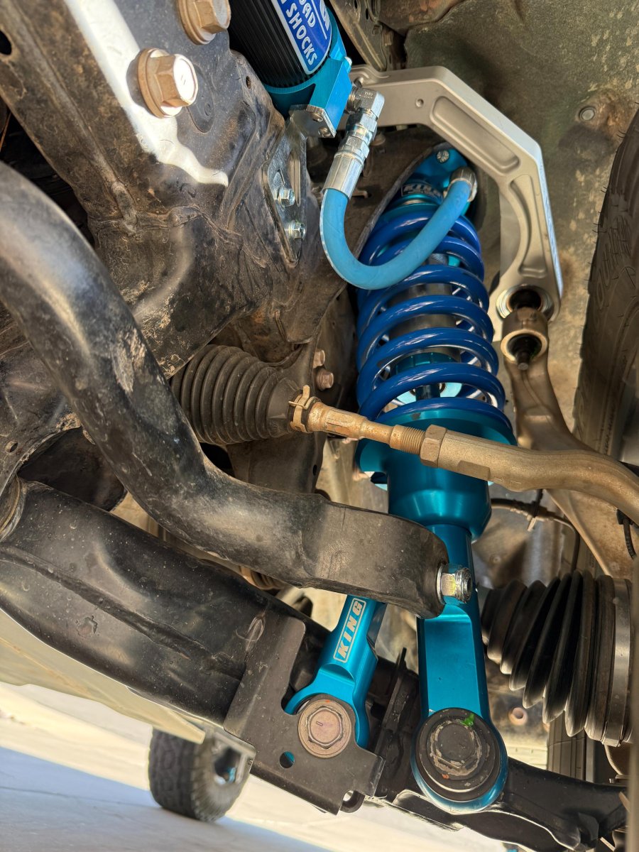

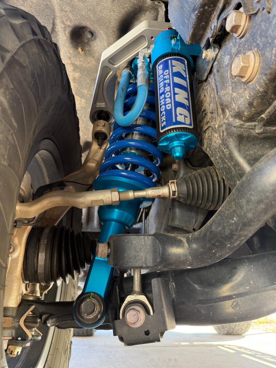

I've been enjoying the King suspension. Haven't been able to do much offroad driving yet but I've had a few jobs that have taken me out into the desert. I drove for a while with the shocks set about 10 clicks from all the way firm (there are 26 clicks total adjustment so 13 would be the middle between all the way firm and all the way soft). While offroad yesterday I adjusted to only 6 clicks from all the way firm. Makes a big difference. This thing handles almost like a sports car when you firm up the settings. There is virtually no body roll while cornering. I'm going to drive on 6 clicks for a while, then dip into the softer settings to try it out.

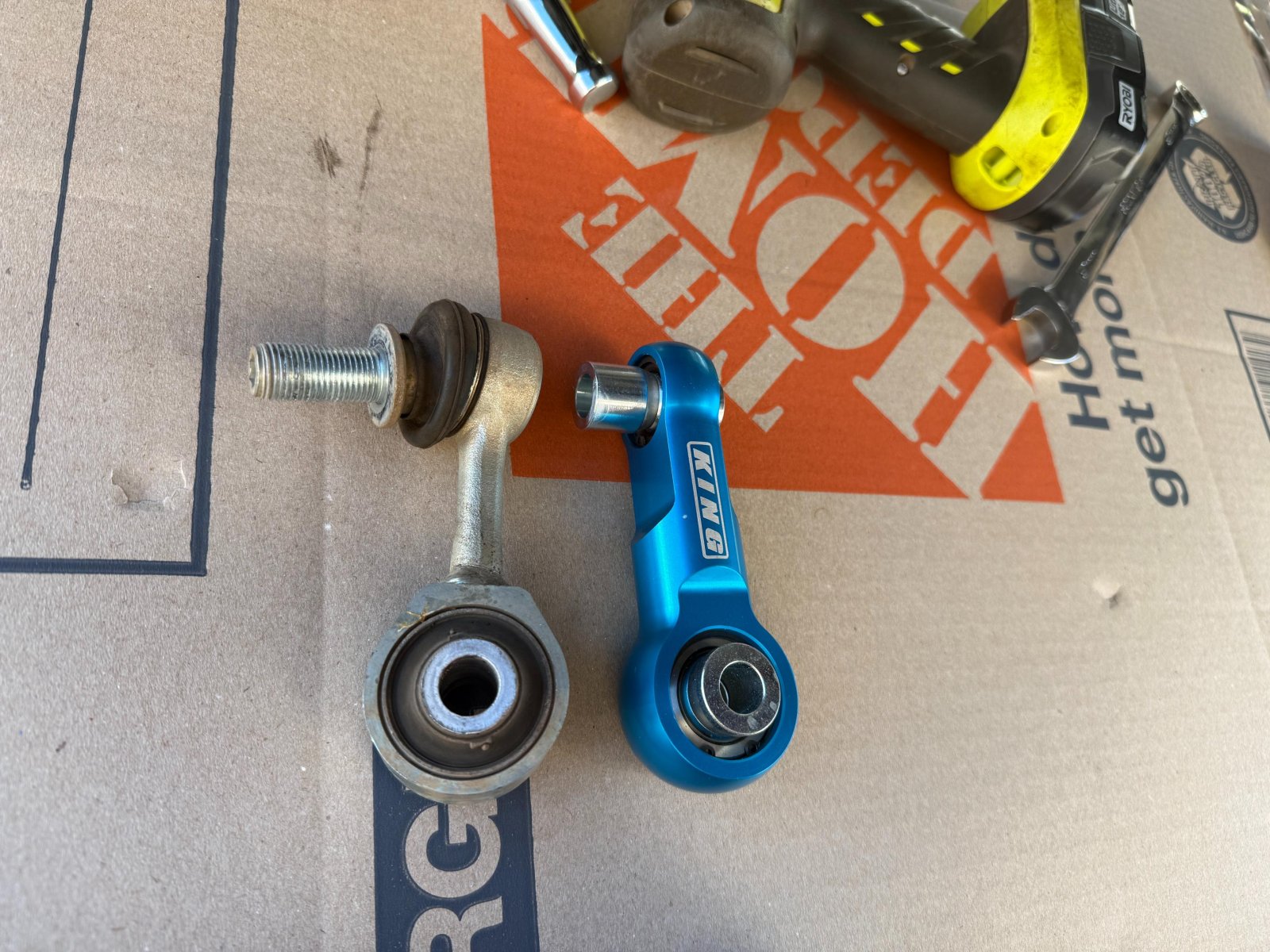

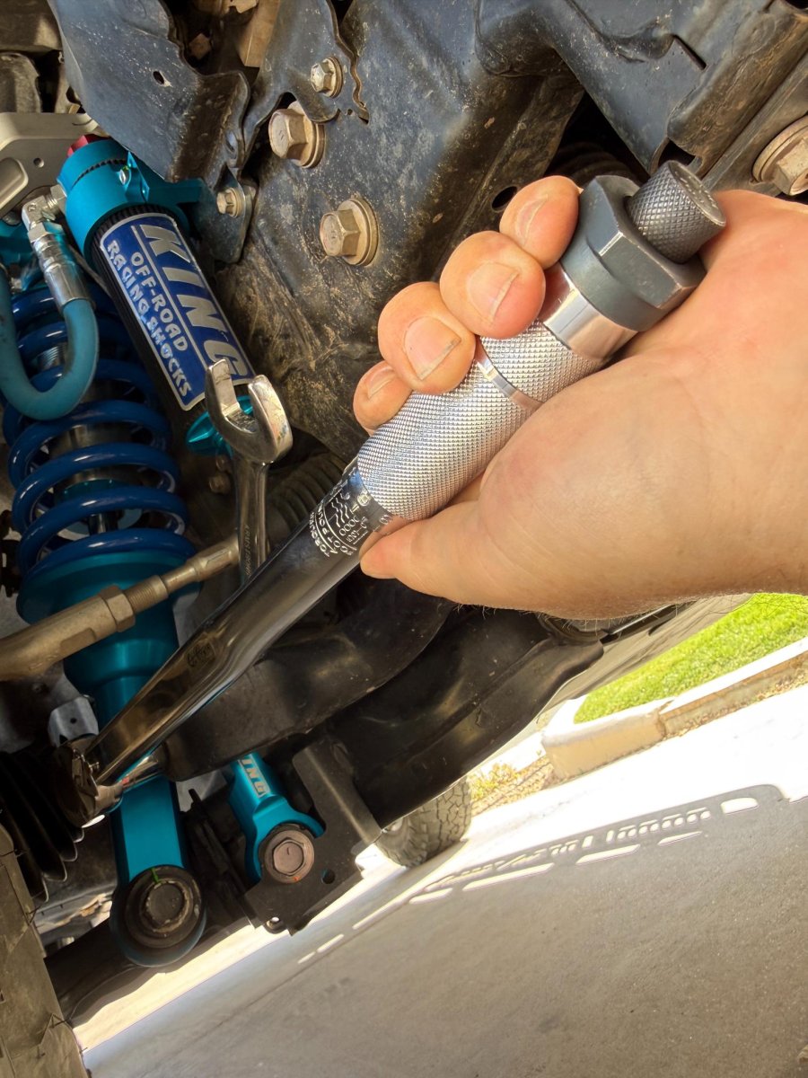

Today I installed my King front sway bar links. Not sure they are really necessary but what the hell. Next will be rear lower arms. In hindsight, I should have kept those nice anodized blue Camburg rear lower arms. Maybe I'll order them back.

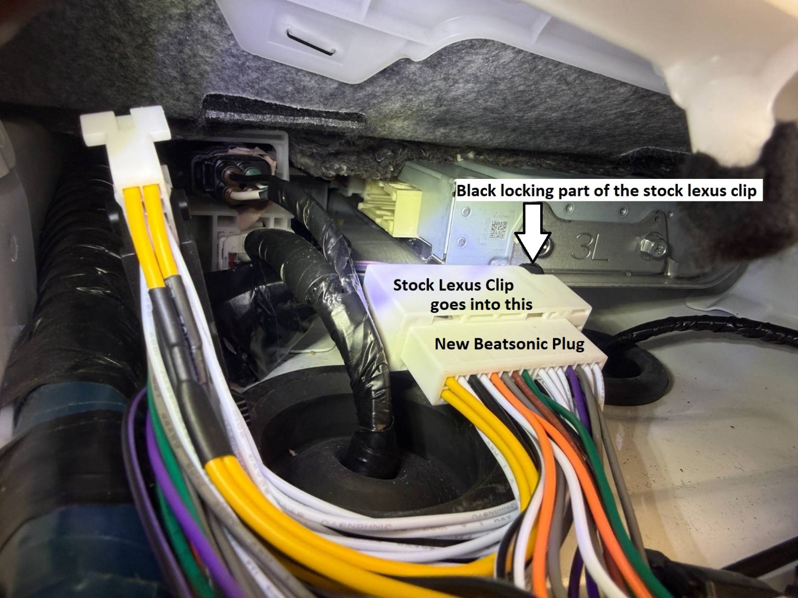

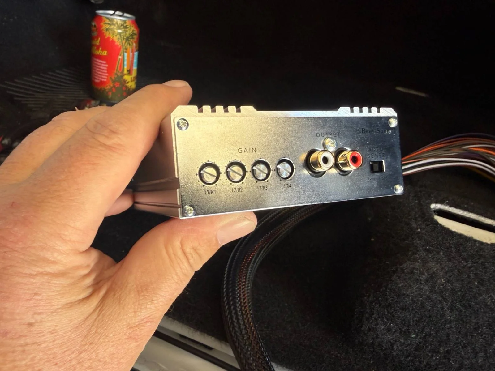

Installed the Beatsonic amp for my base Overtrail stereo (not the ML stereo).
Beat-Sonic Encore Sigma Plug and Play Amplifier Kit for Lexus GX550
It was a royal pain in the ass. Not because of Beatsonic and their stellar product, but because of the tight spaces, sharp corners & pieces everywhere, stubborn clips, etc. This reminds me why I hate car stereo work. In fact, the last time I personally installed car stereo equipment was in 1988 when someone smashed the driver's window and stole the stock Clarion head unit out of my Suzuki Samurai. I installed a $32 Sparkomatic AM/FM/cassette deck head unit from Kmart along with 2 detachable speakers from my boom box. The stock front speakers were re-used (not stolen) and I added the 2 rear boom box speakers for that full, rich, auditorium Sparkomatic sound that we all crave. The rear speakers were secured with duct tape. My apologies, I digress.
The Beatsonic product was very well packaged and clearly professionally made. Much higher quality than I expected. Directions were easily found online, although the directions make it look like a walk in the park and reality was a bit less enjoyable.

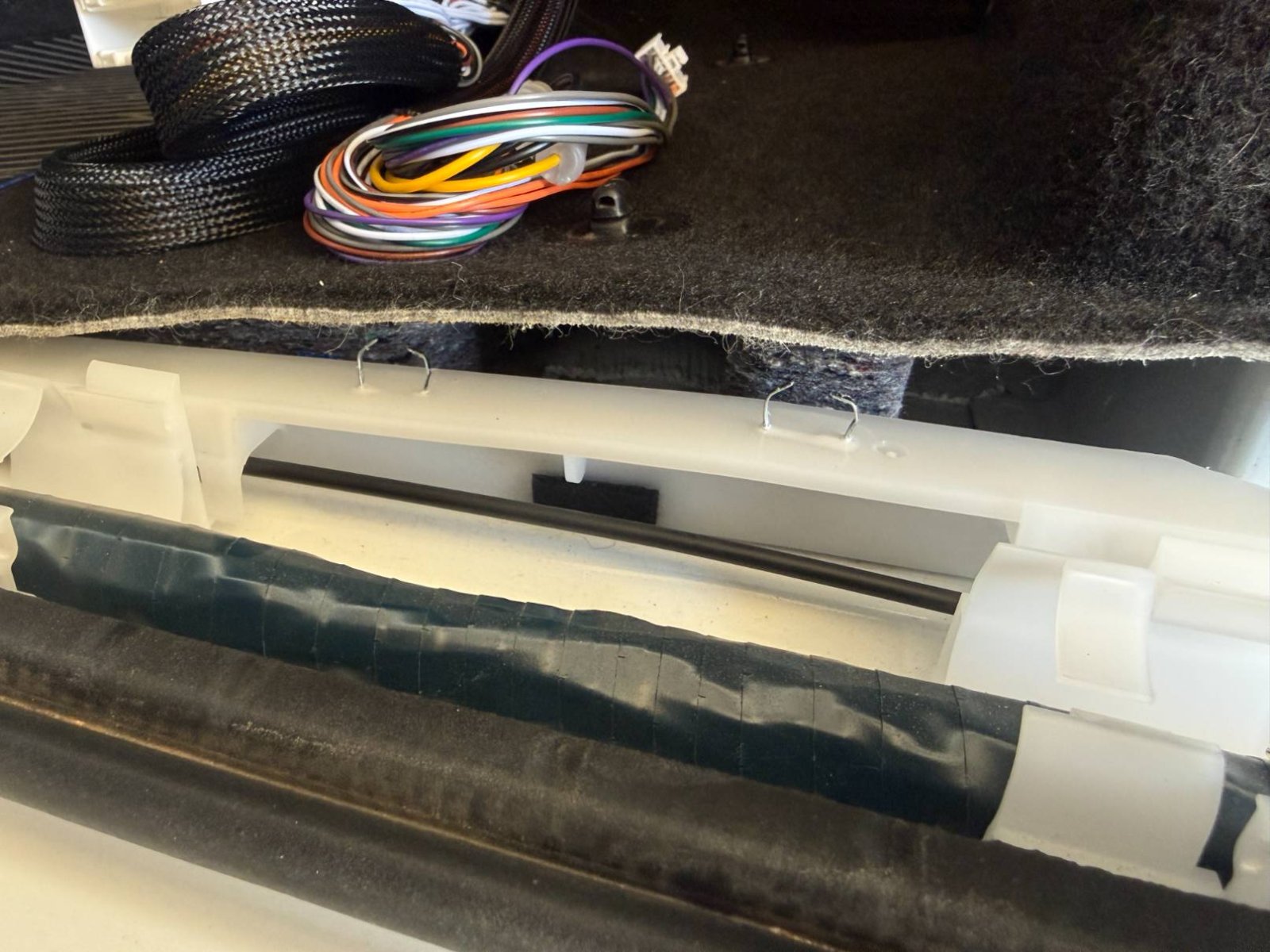

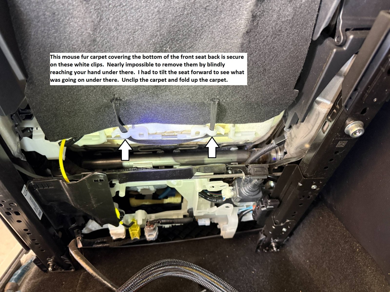

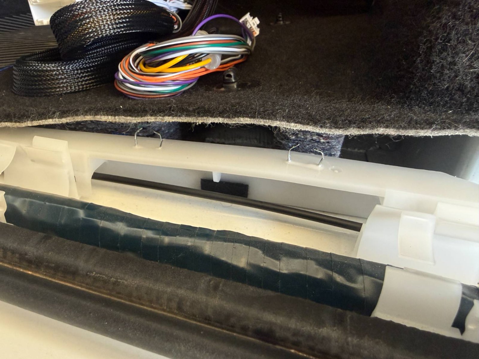

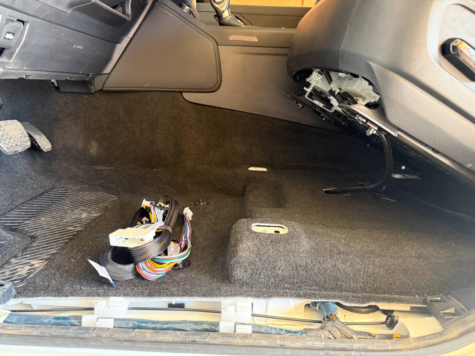

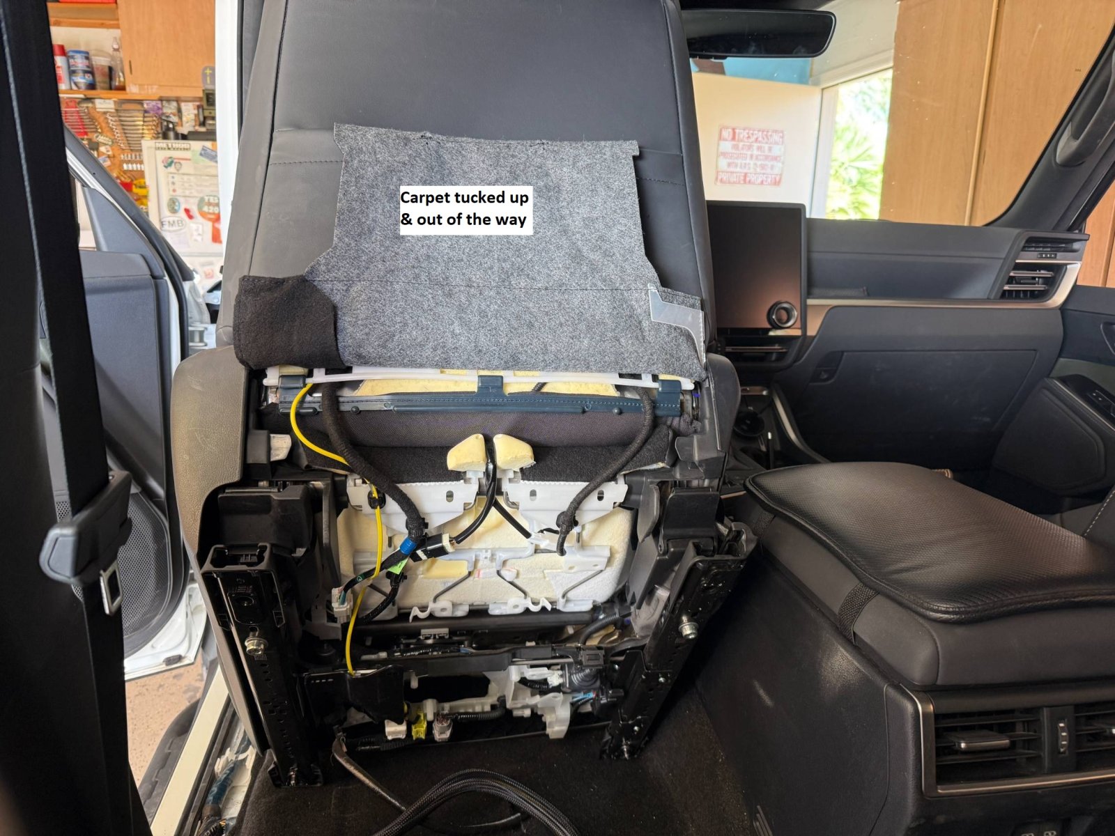

First step, undo all seat bolts and tilt that seat way back. Pull the door sill trim and pull up the carpet. Get rid of the evil sharp staples that get yanked out of the carpet or they will cut you. I just clipped them back with a wire cutter.

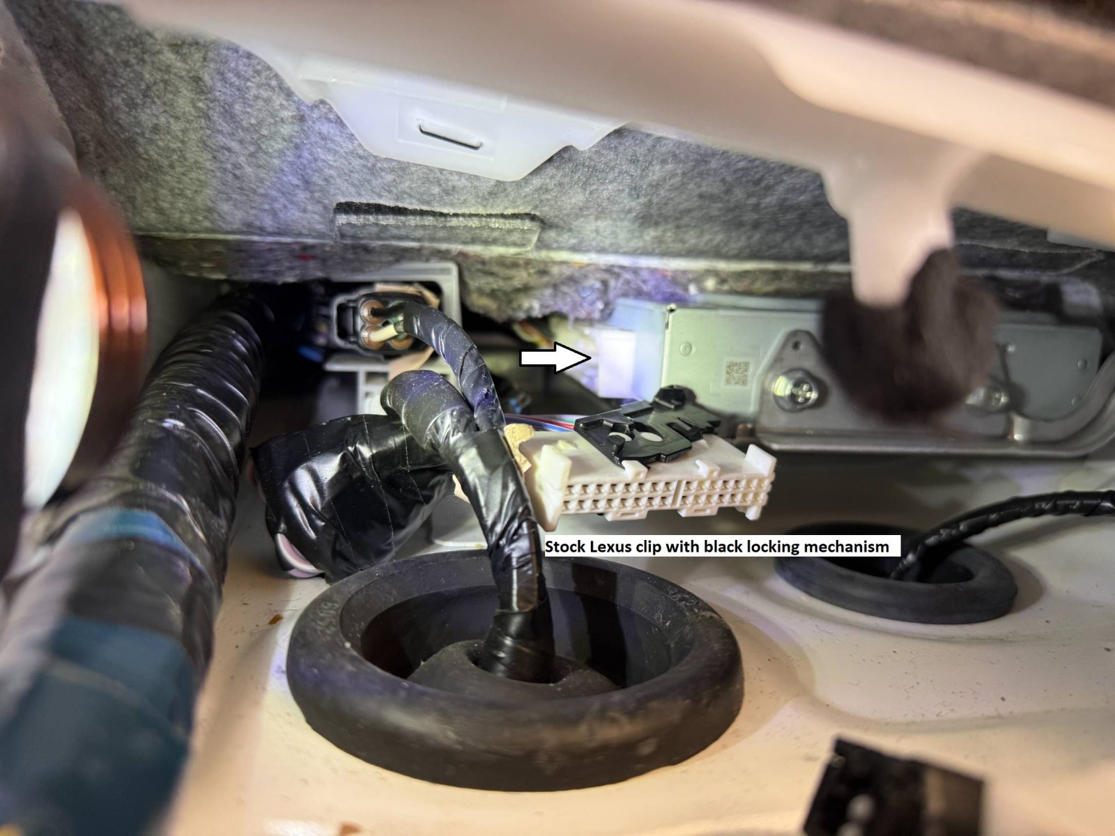

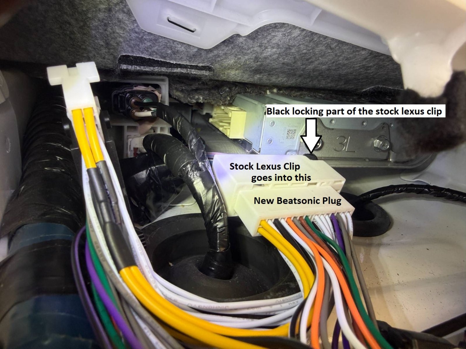

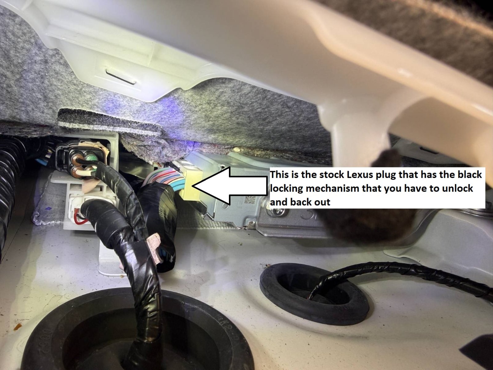

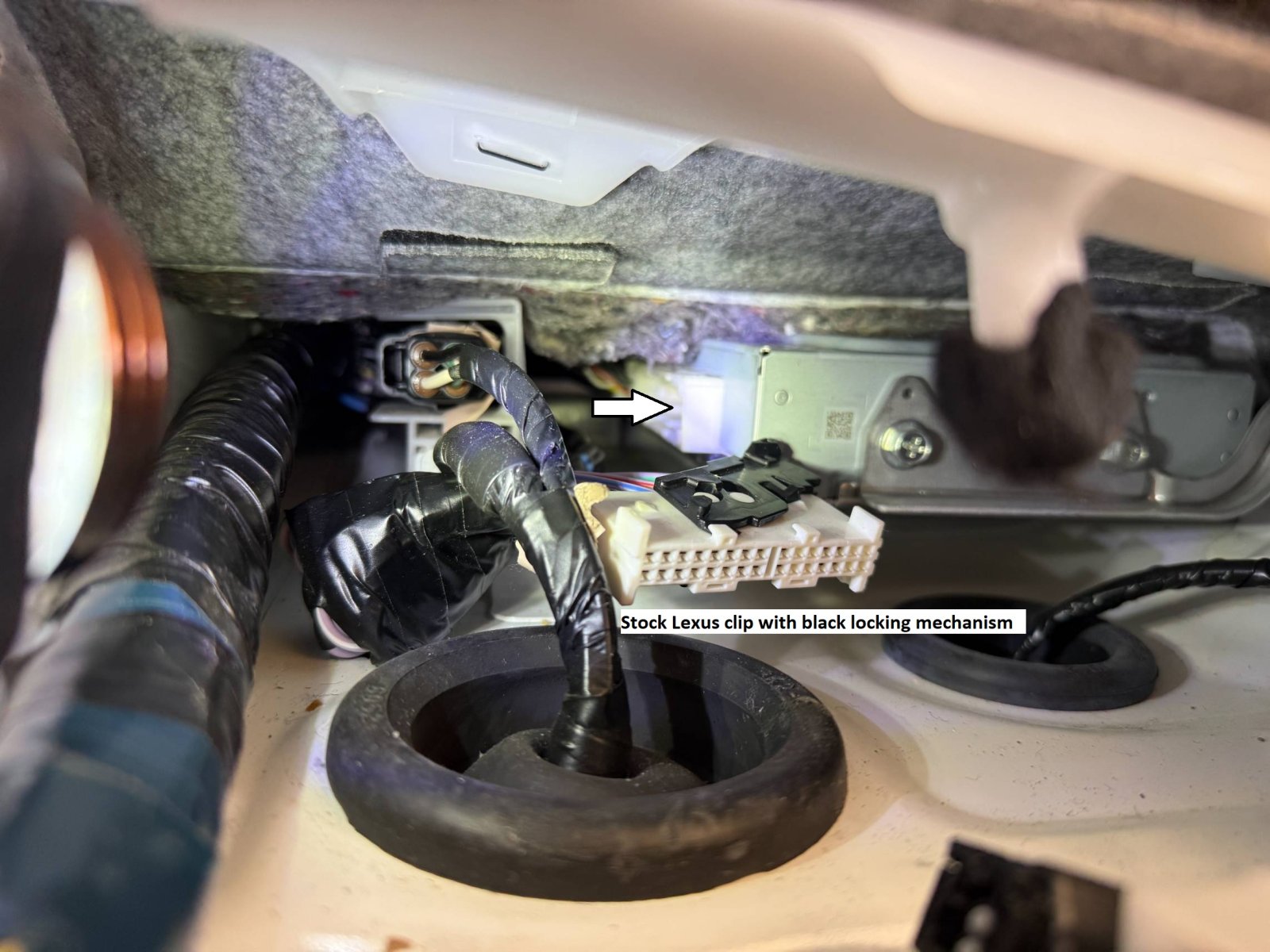

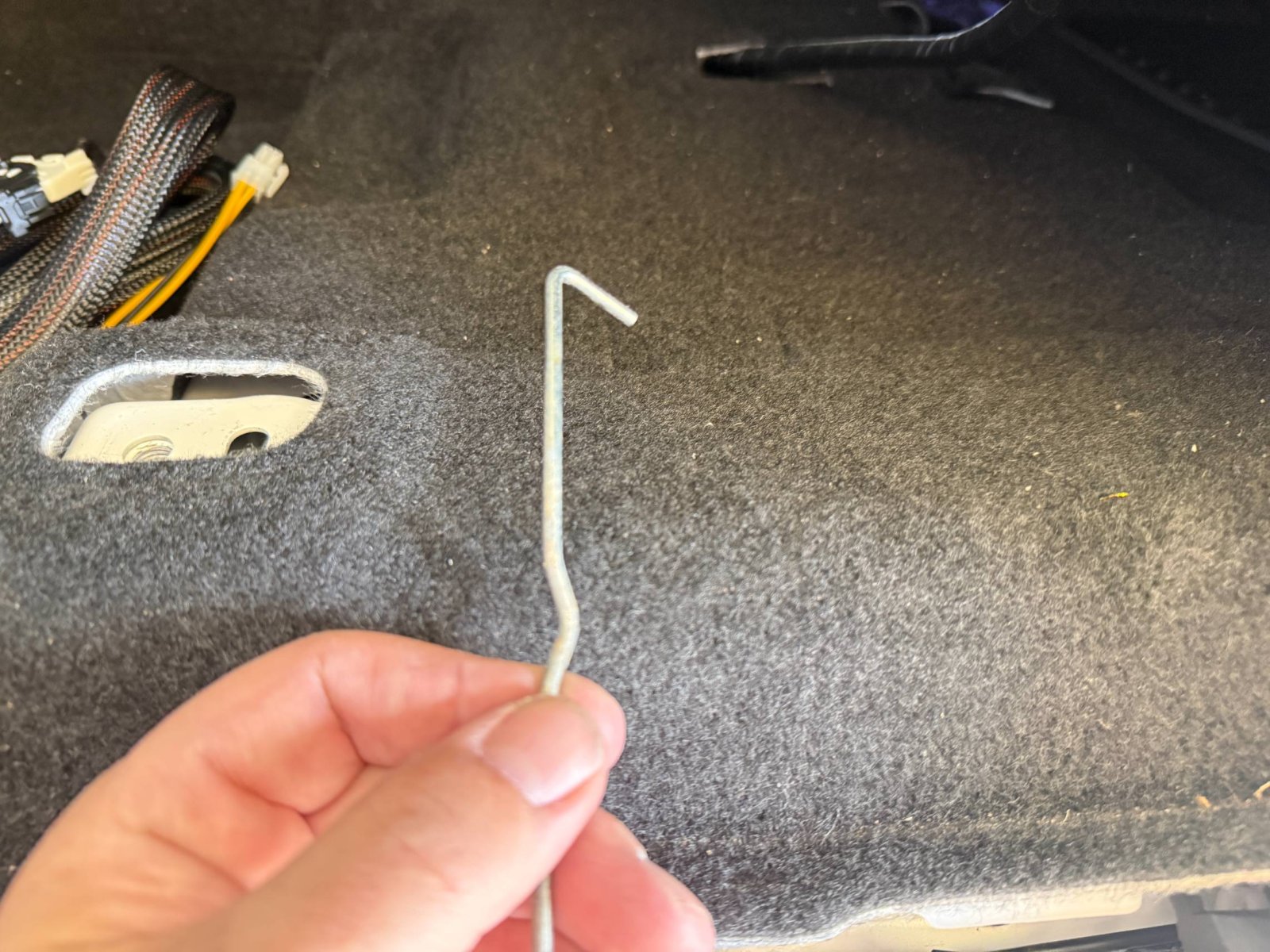

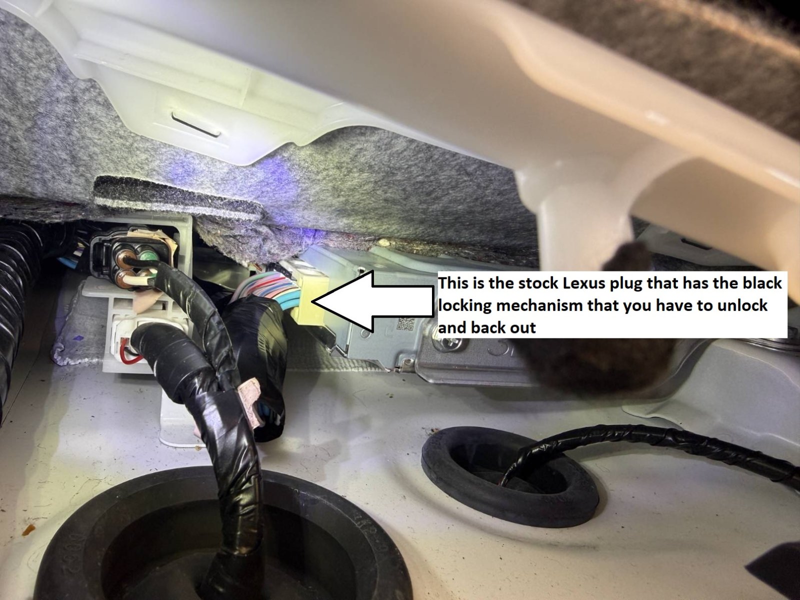

My fat fingers couldn't press the black locking mechanism button to release the stock Lexus plug that is plugged into the stock amplifier so I used a tent stake to reach in and press the button and then I jammed my hand in and was able to yank back the clip. Then it took an act of God to back the actual plug out of the amp - there are other wires & clips in the way that prevent the main clip from backing out. I just pushed the other clips forward to make some room.
The instruction video show a nice bit of generous wiring lead on this clip so you can pull it out and have some room and a pleasant experience plugging in the Beatsonic main secured clip, but they must have been short on wiring when they built my truck because I had no room to pull out the clip, I had only a fraction of an inch of room to move the clip around. Then I could not, for the life of me, get the black security clip to snap home. It eventually happened but I left some scraps of flesh and blood under there.

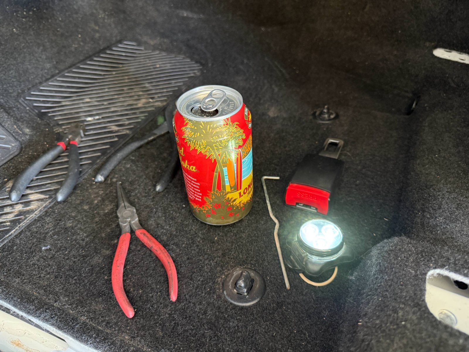

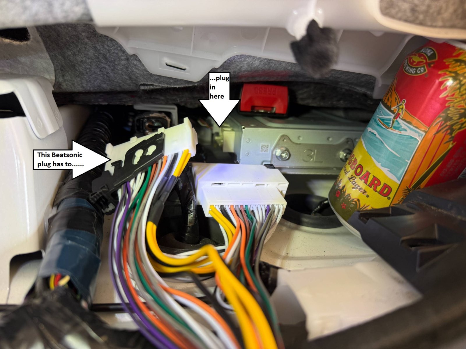

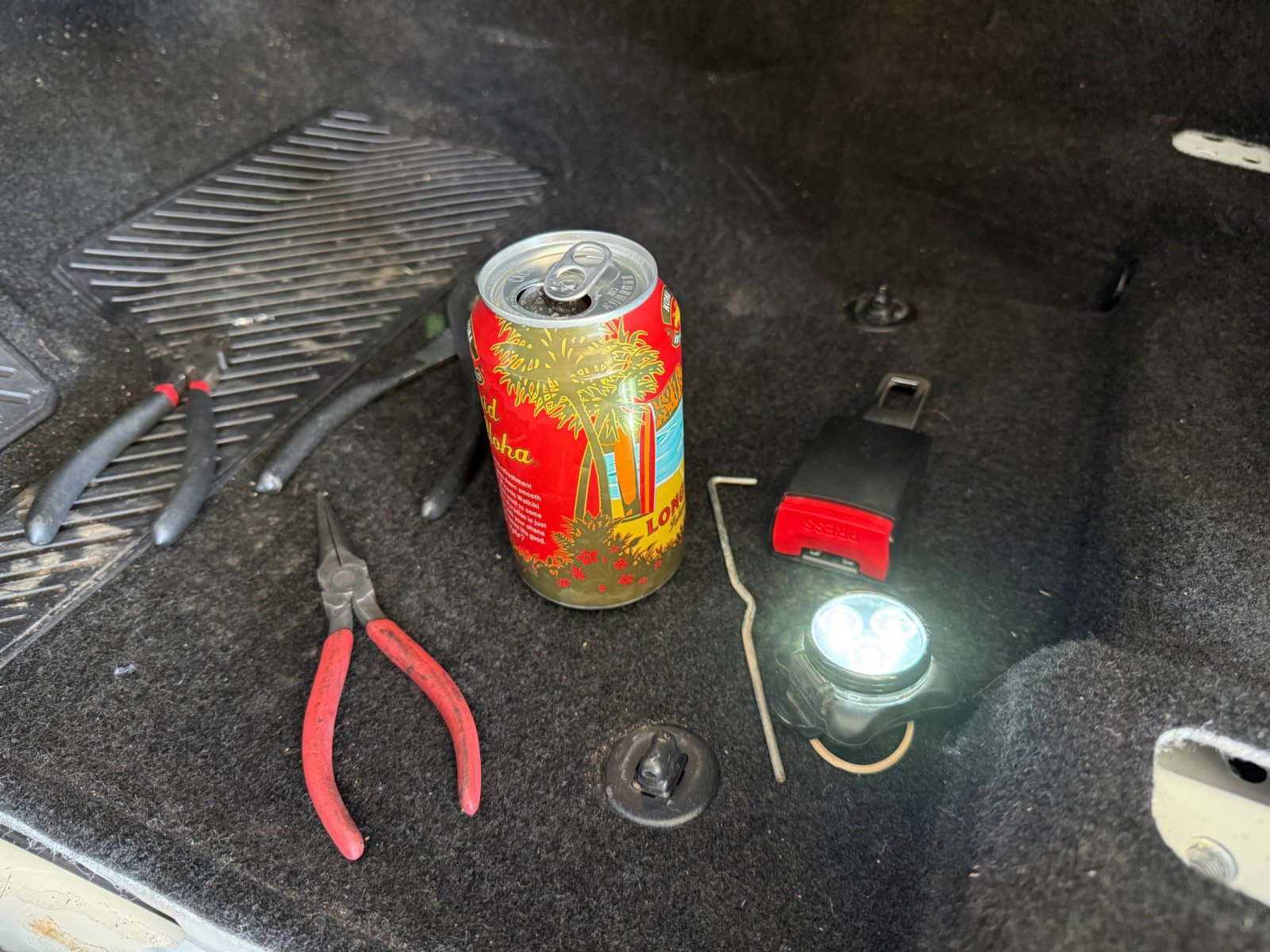

To insert the Beatsonic plug back into the stock Lexus amp, I got smart and jammed a full beer can and a seat belt extender under there to make some room. The step immediately after was the best step in the whole process because it involved popping open the beer can.

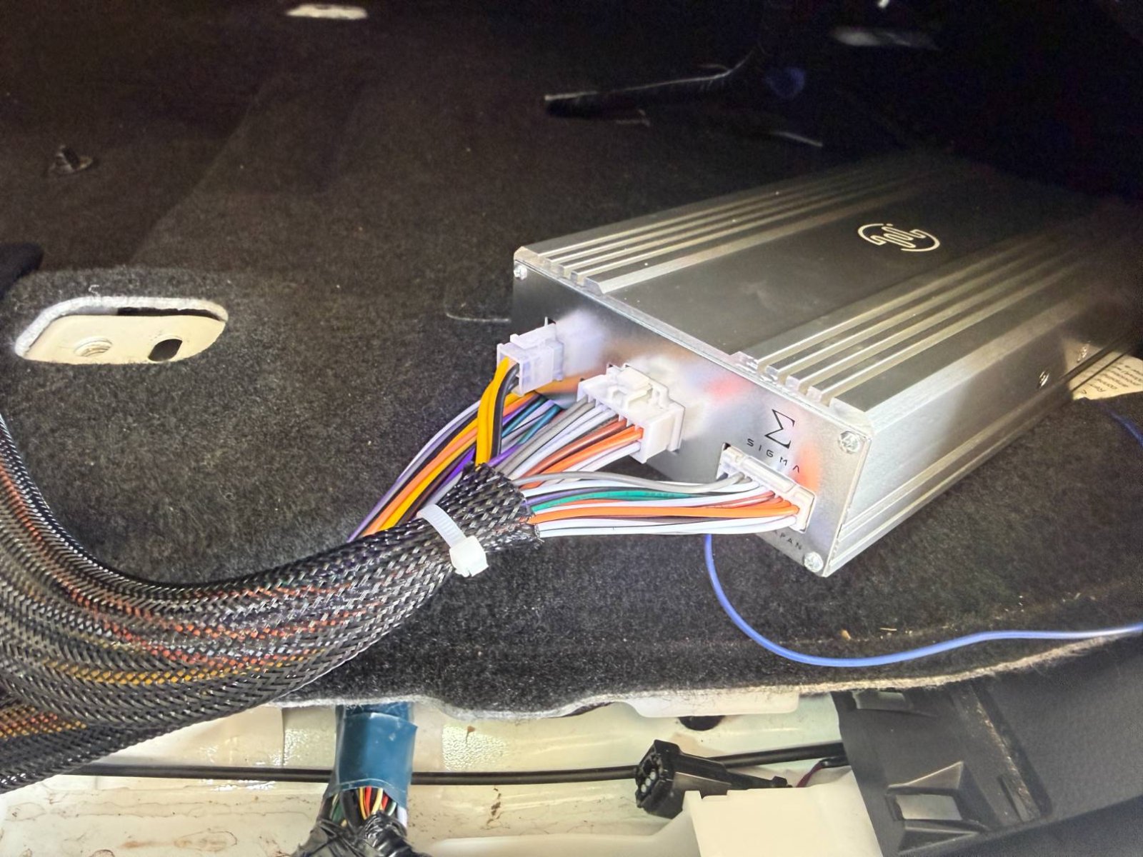

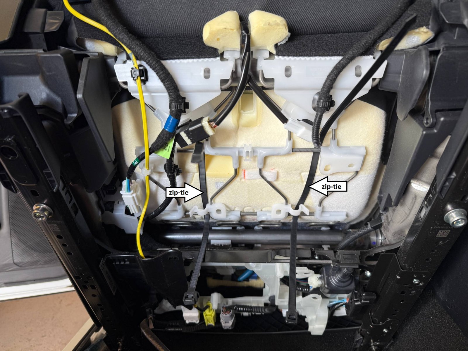

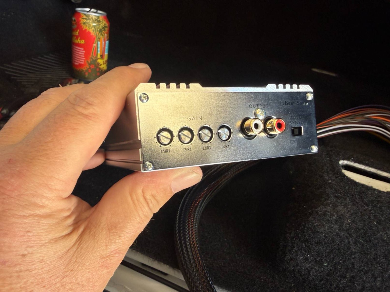

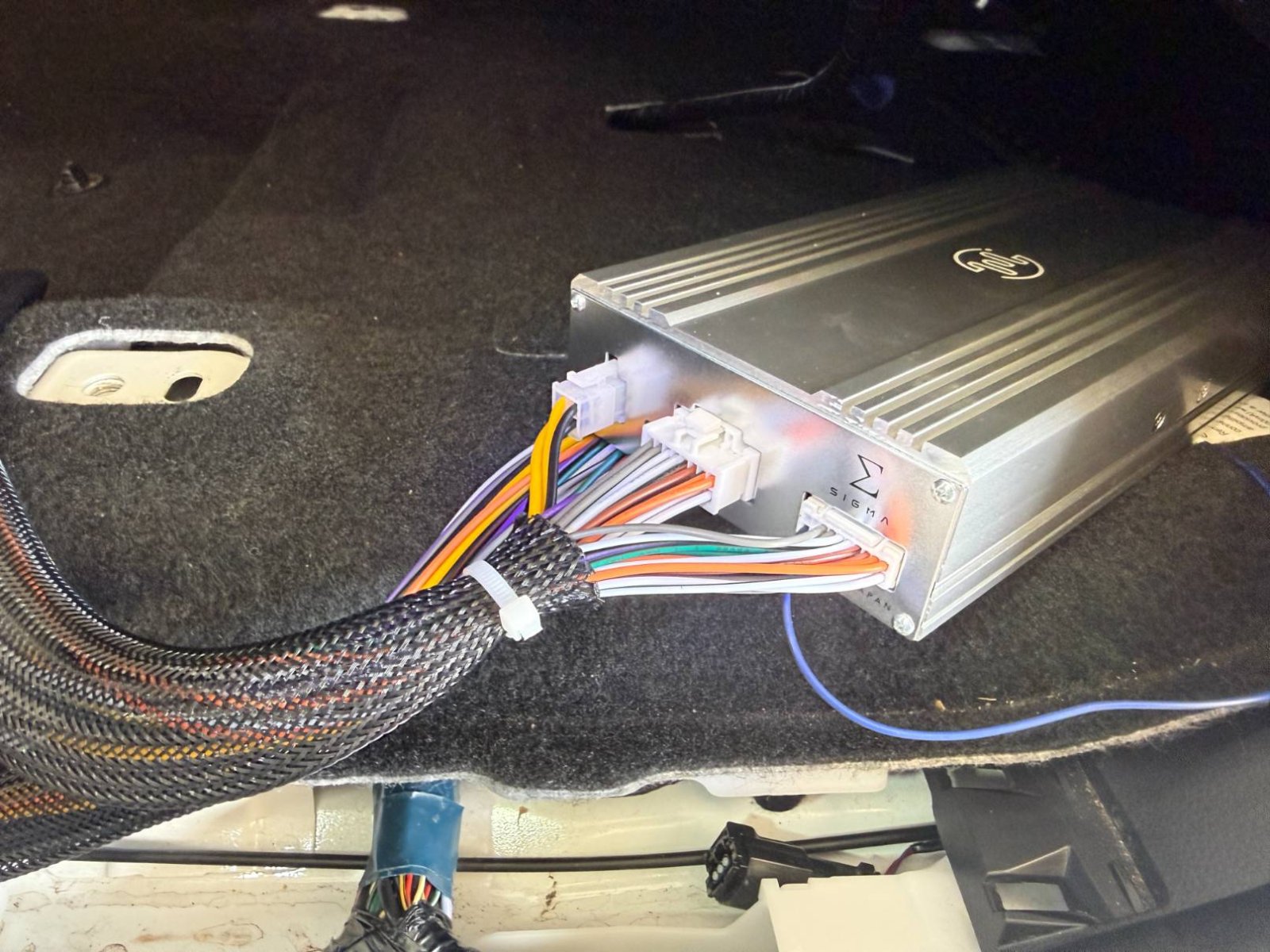

The rest of the job was easy. Route all the wires through the second carpet opening per the instructions, I set all the Beatsonic gains at 1 tick from all the way up, plug in the Beat Box, bring the protective sheath all the way up, secure it with a small zip-tie, shove the Beat Box back onto the rear floor, move to the rear door. I also used small zip ties to secure the loose wires where the sheath didn't cover to keep them manageable. You have stuff and coil a lot of wiring under the carpet between the stock amp and the second carpet opening.

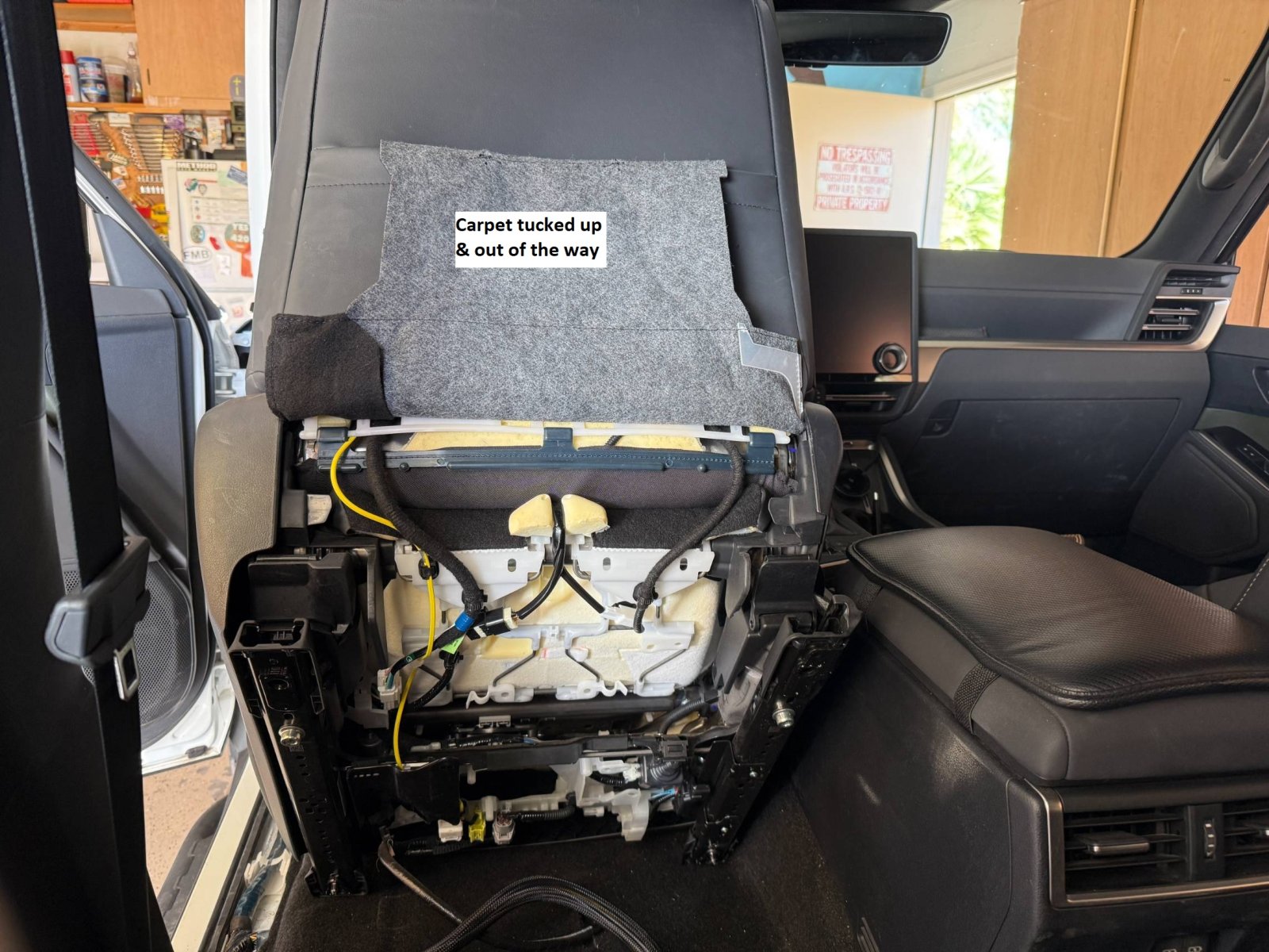

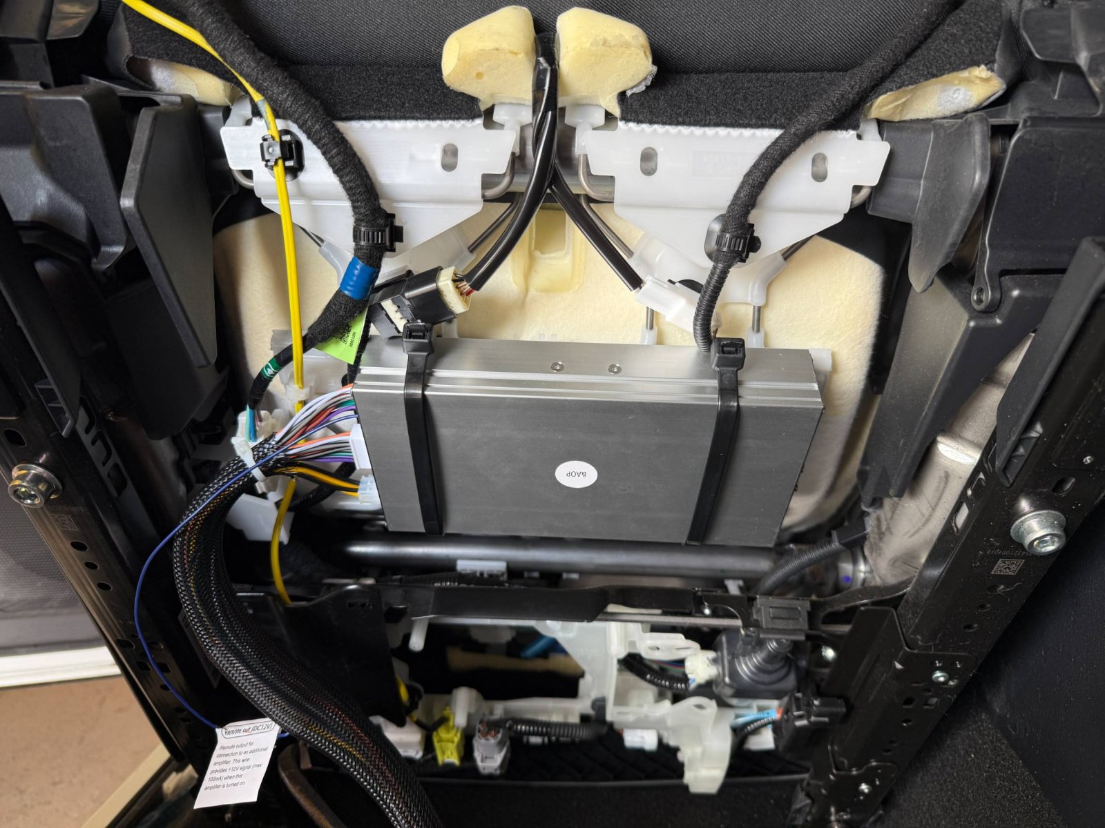

Then I tilted the seat forward, removed the headrest, and used the seat back tilt feature to stuff the top of the seat back up into the headliner by the sun visor. This held the seat in a forward-tilt position. Then I sat in the back seat and the mounting the Beat Box was pretty simple. First I removed the elastic holding down the mouse fur carpet covering the bottom of the front seat, fold the carpet up and tuck it into the seat back pocket. I got extremely frustrated trying to blindly unsecure the elastic before I decided to tilt the seat forward so I could see what I was doing.

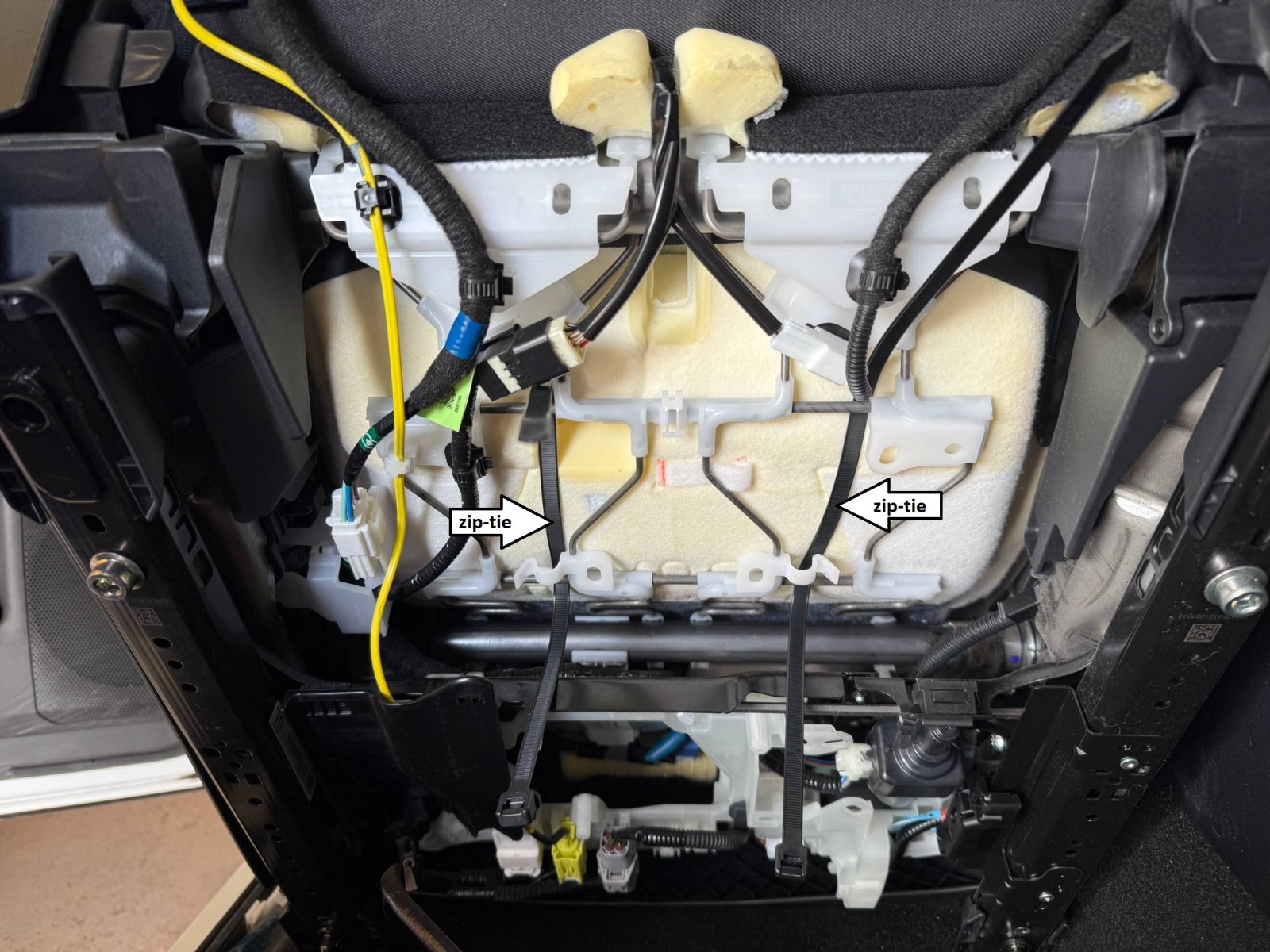

Then I used some heavy duty XL zip-ties I had on my workbench to secure the Beat Box up & under the seat.

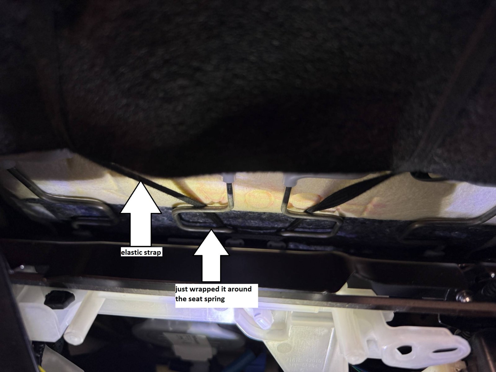

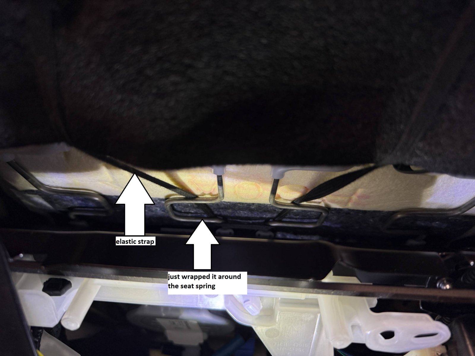

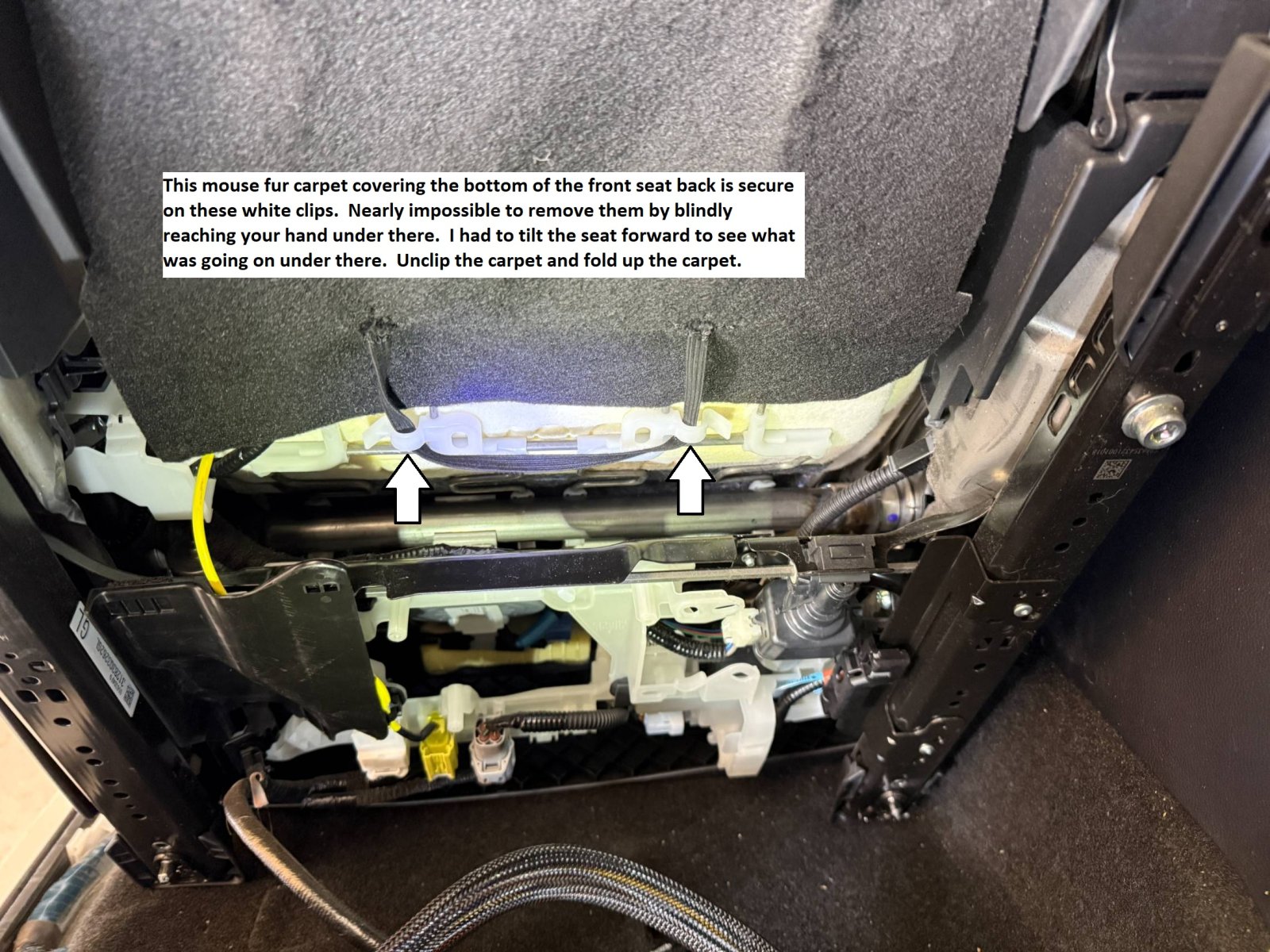

Then fold the mouse fur carpet back down but I've covered the original securing clips so I just pulled the elastic strap down and around the seat springs to hold it in place.
When I started my truck after finishing the install, I wondered what kind of drunken savage had left the volume absolutely blasting. The volume was set at #25 and it was soooo much louder than before. I turned it down to about 12. Previously, having the volume at 12 meant you could barely hear it. Not only is it louder, it is so much clearer and so full of body, like Pamela Anderson in the early 90s.
I haven't driven the truck yet with the Beat Box rockin', but I will tomorrow. Looking forward to it. Now all I need is a tape deck add-on and I'll be cool again.

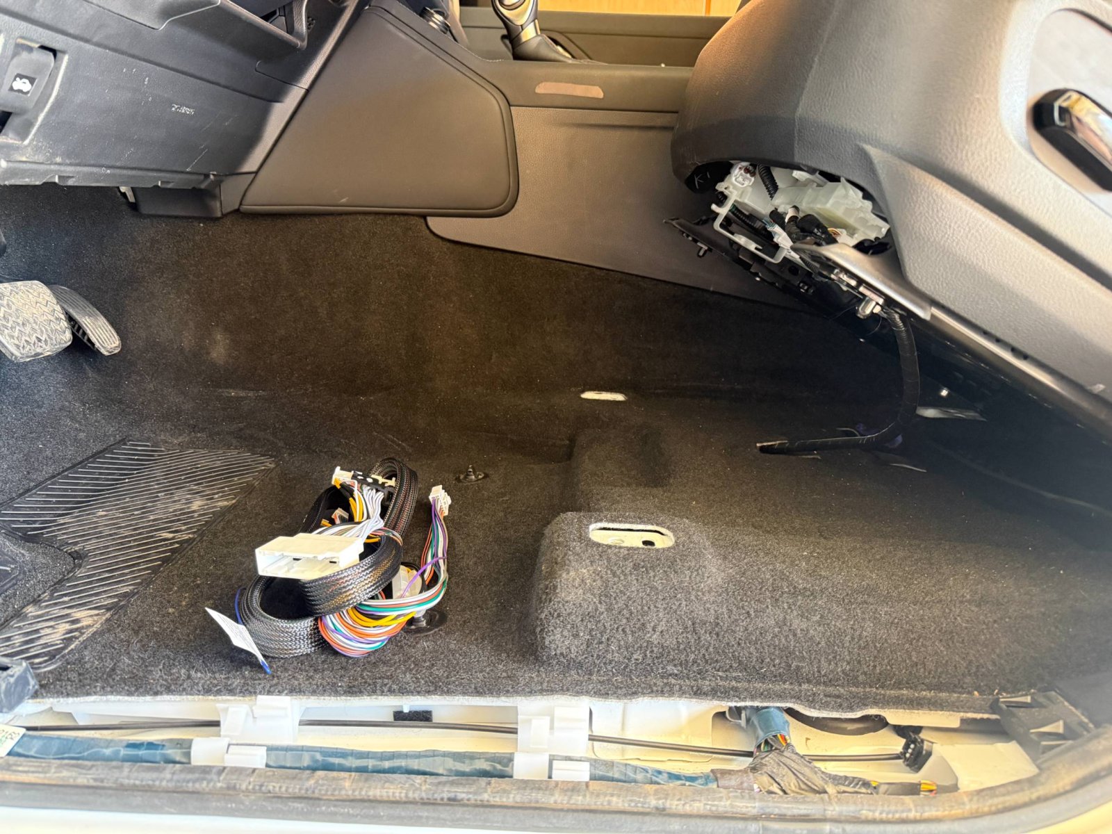

View attachment 19435View attachment 19436

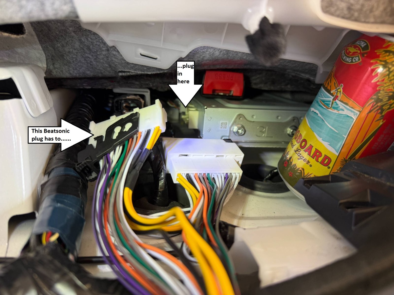

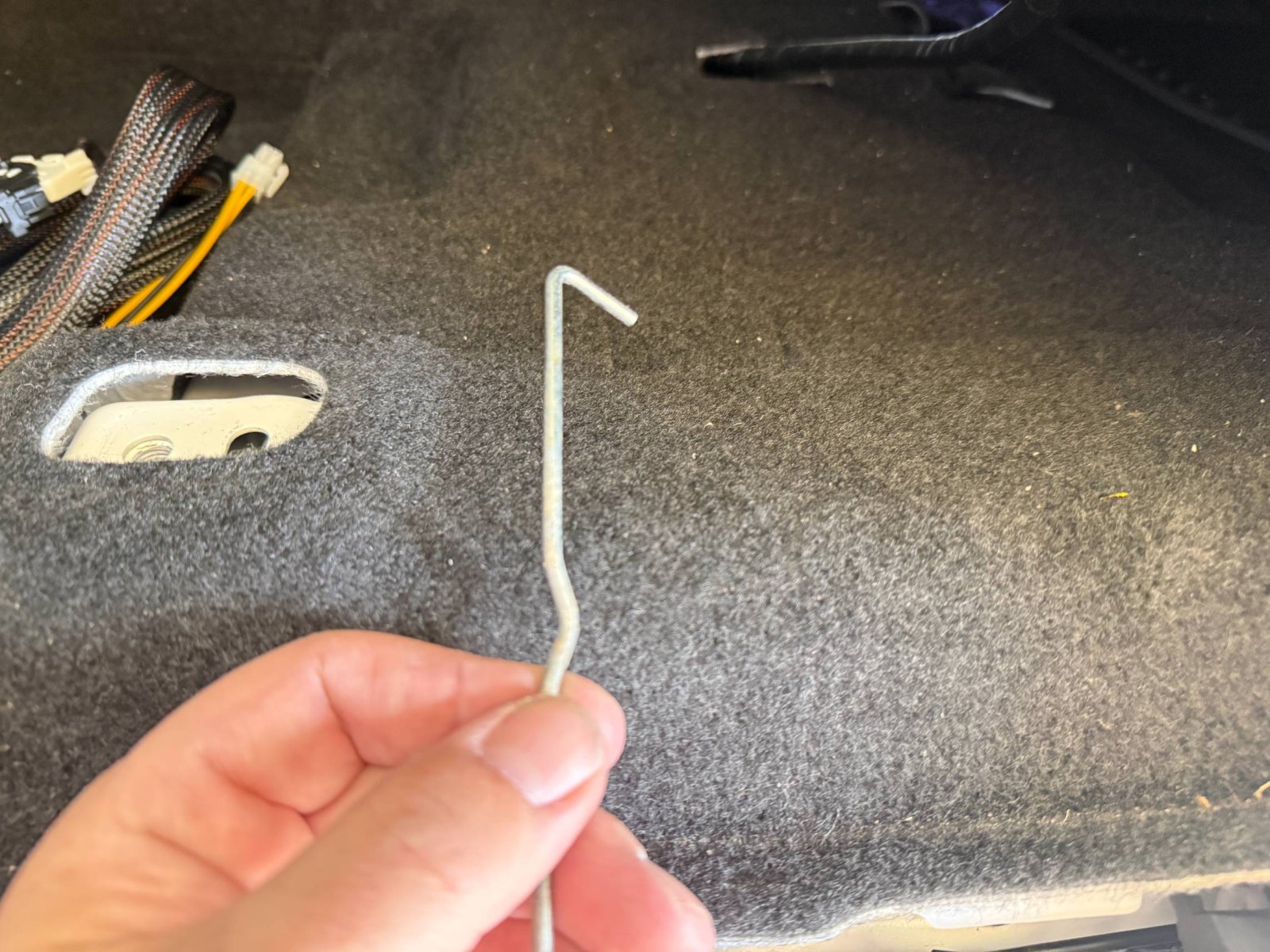

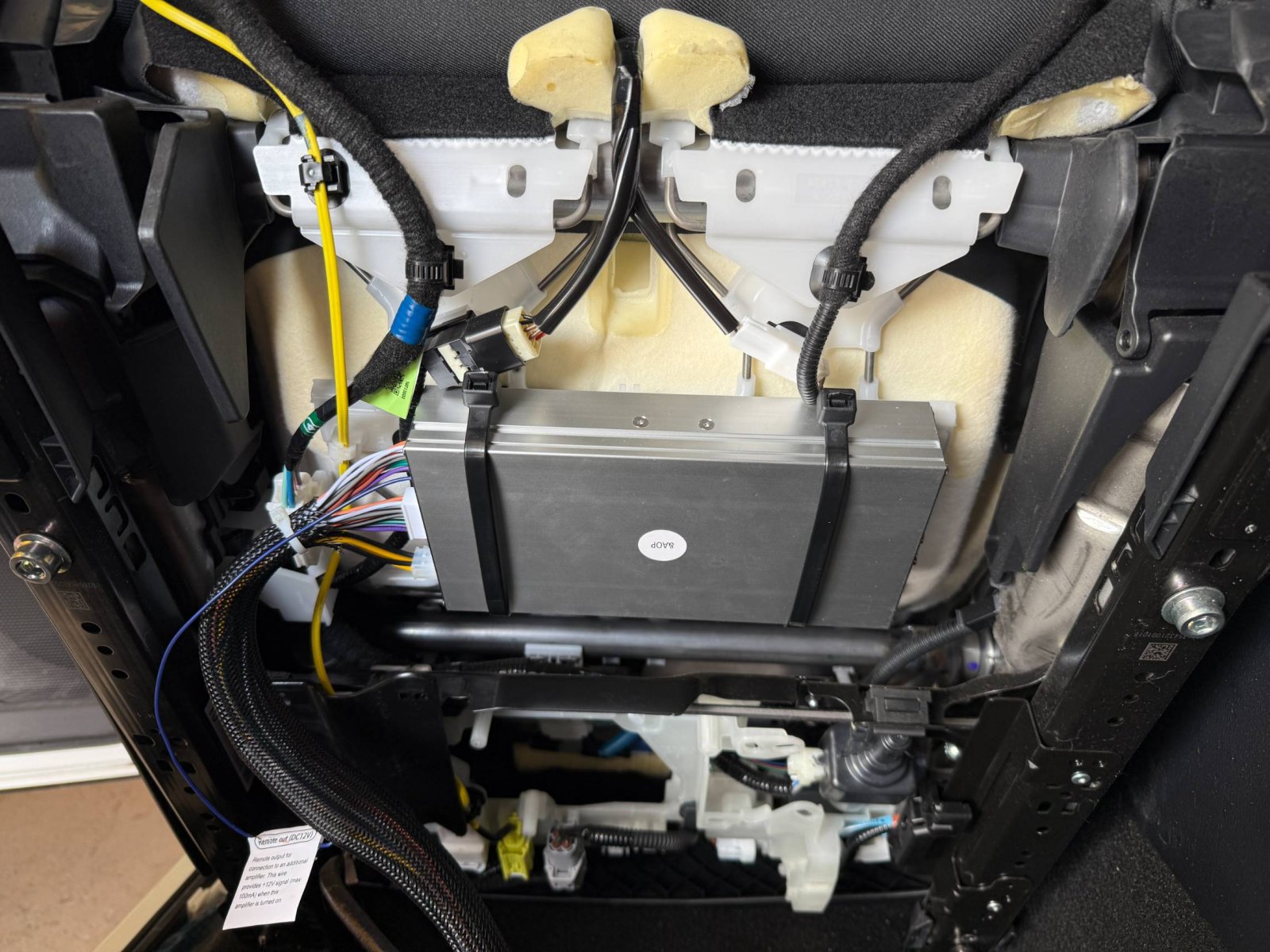

Hey Bill, where did you buy the sway bar links? Most places that I checked don’t have them in stock. Stopped by King who put me on the list but they are 8 weeks out.
I hear you on the stereo upgrades. I have used Audio Express for the last 30 or more years.
I received them directly from King. Must have got one of the last pairs available. I also thought it would be a couple months wait.
