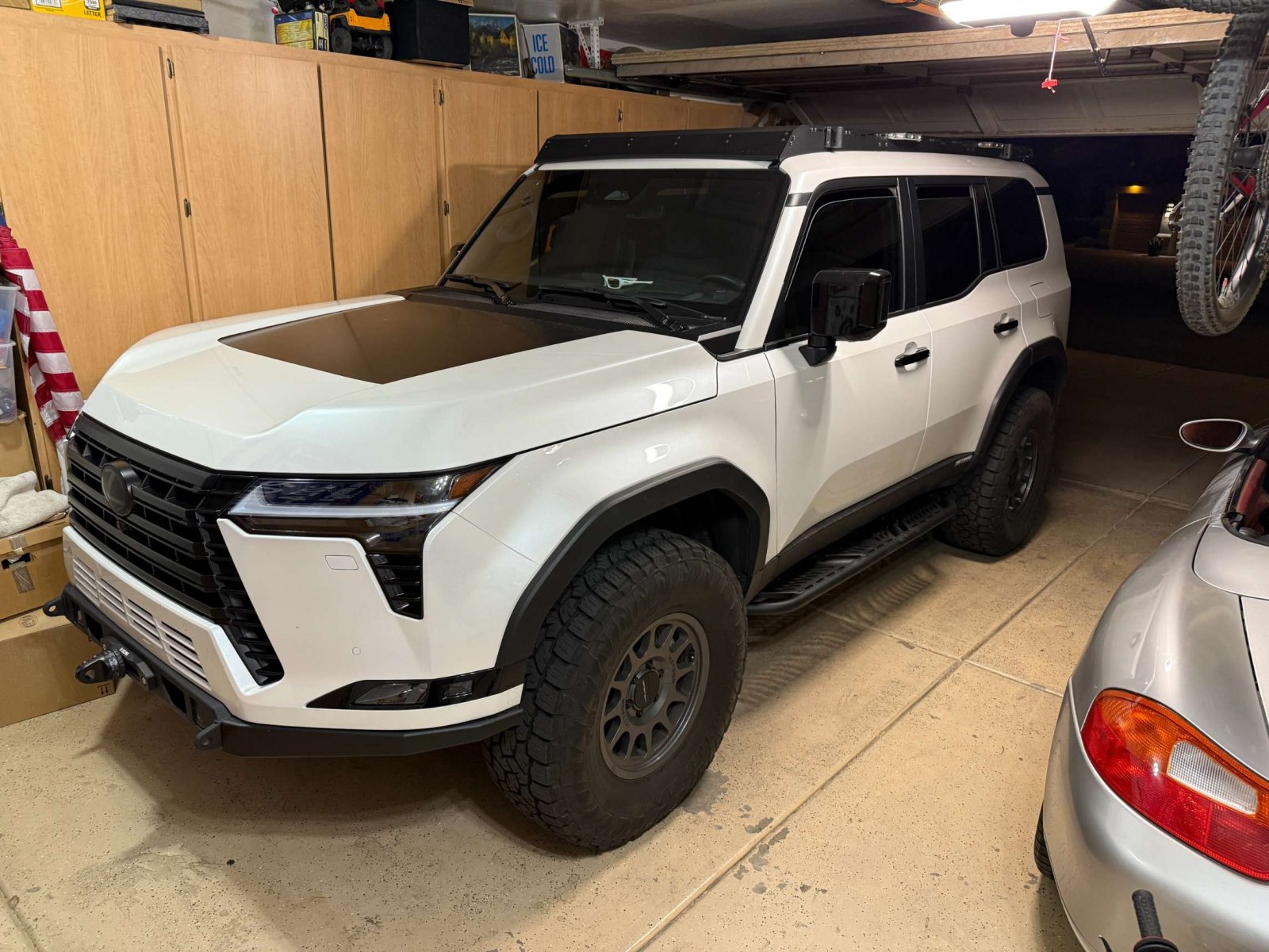

I really like the look of that full length roof rack. When we saw a few GX's at the dealer last week, they had the PIO racks behind the moonroof. Wife said she liked the look, but I told her those make too much noise and it'll drive us nuts on road trips (I've had a bunch of racks over the years on trucks, and she's forgotten how bad they howl on the highway). BUT, if that Westcott is fairly quiet, that may be the way to go. We're still waiting, (and may be for a while) because we want an Overtrail + WITHOUT moonroof, cool box, & a couple of the "nanny" options.

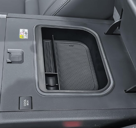

Good idea to delete the cool box - takes up storage space in the front, which is already limited.
The roof rack is actually pretty quite compared to the 4runner which didn't have all the sound proofing. I'll probably gut the cool box too. cool idea (no pun) but wont' really use that much. I already added the little shelf to it.

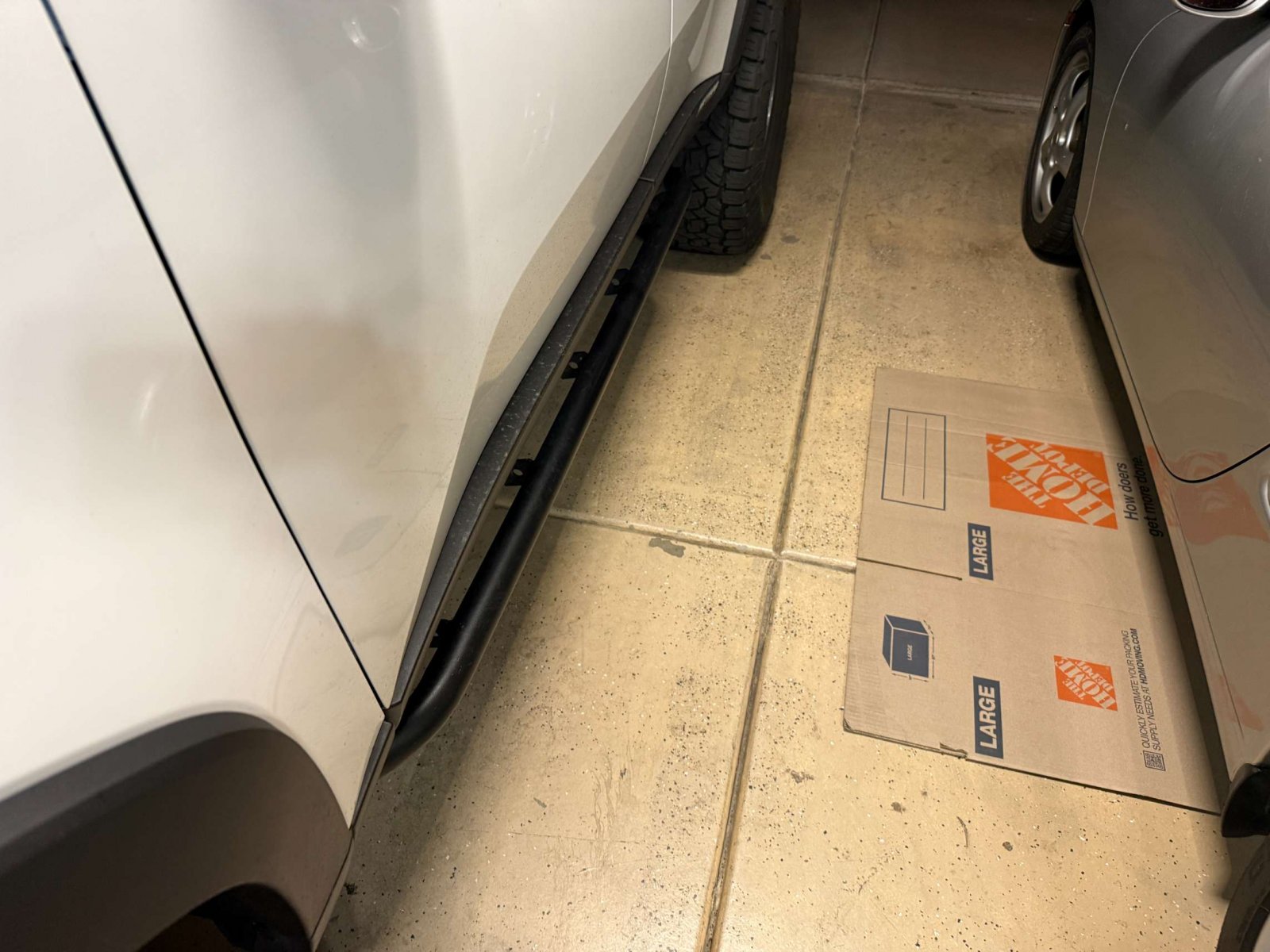

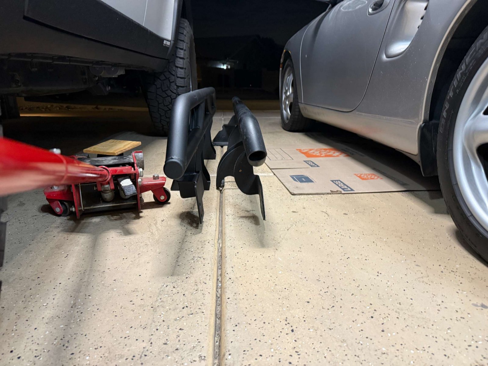

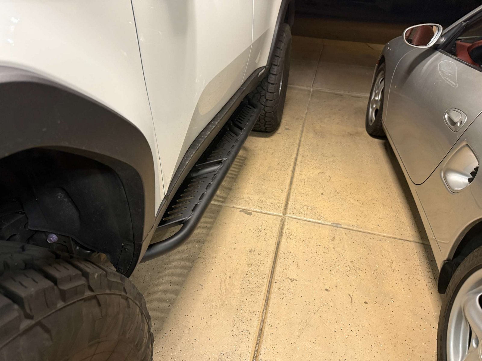

Sliders were almost easy. If it weren't for a couple bolts on each side that are incredibly difficult to get to (and to get a wrench on), this would have been a breeze.
Having a big side step is so much nicer, the kids and wife love it. And they are perfect for standing on and accessing the roof rack with the doors open or closed. Previously I was trying to balance on the door sill and/or the rear tire to get to the roof rack and I had to hold myself up there with one hand work with the other hand. Now it's like having scaffolding to stand on. Very much worth the entry price.

Hey Bluegill. Nice rig! My next purchase will be rock sliders. I really like the Westcott Designs sliders. I noticed you did not go with the “kickouts” on your sliders. I’m deciding whether I should go with kickouts or not. They say the kickouts are a pivot point for your vehicle if you are on top of a rock to save your rear quarter panel or tire. Just curious why you didn’t go with the kickouts?
