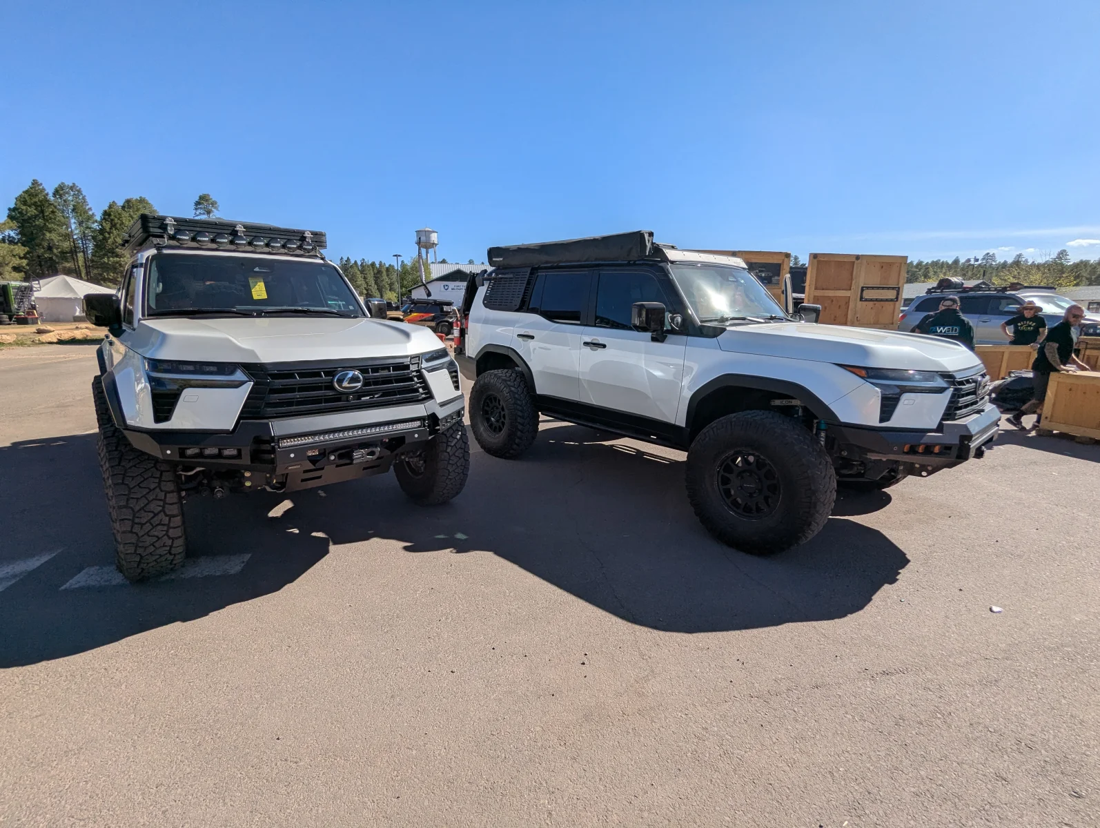

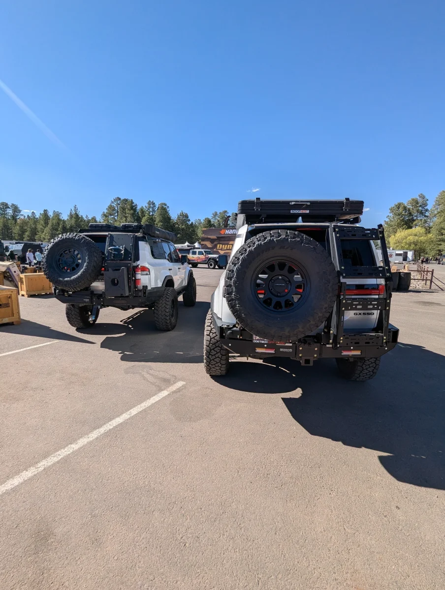

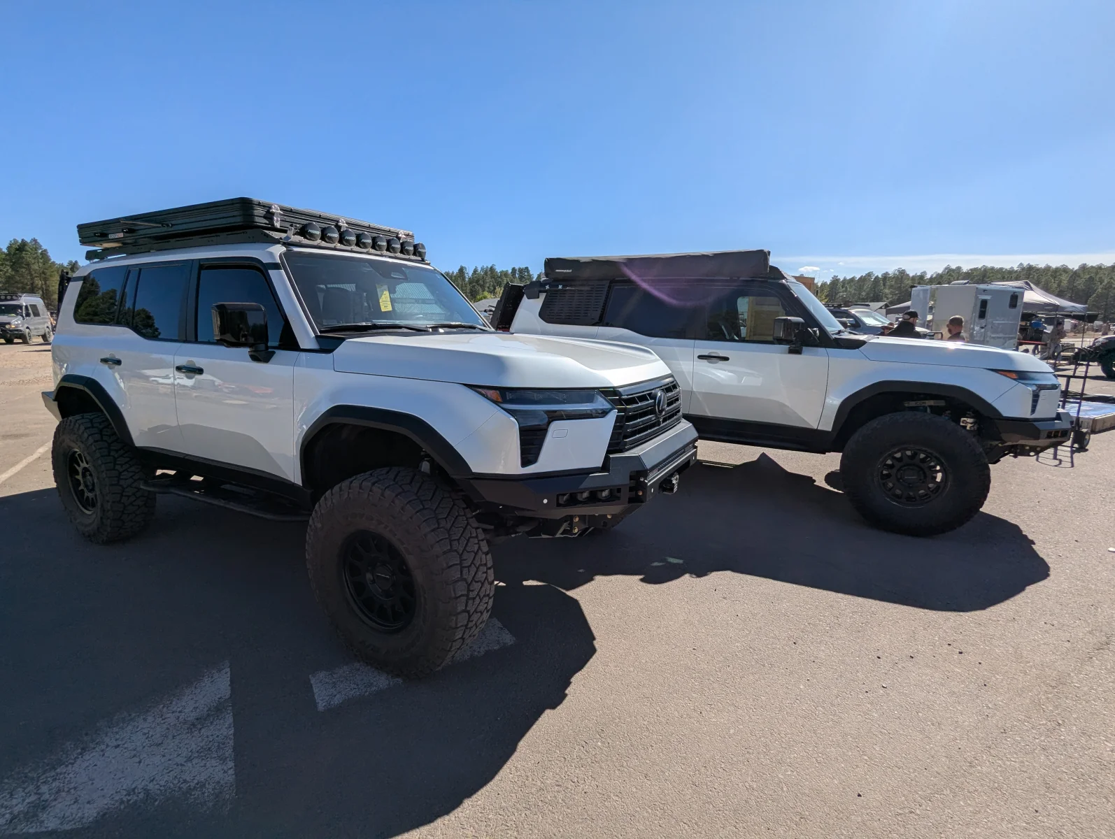

Looks awesome man. Love reading about people's builds since im new to all of it. Question I've been askign, when you get these larger wheels are you recalibrating the speedometer/odo or just accepting that its going to be off by some % all of the time? What's the gameplan if you ever wanted to sell the car?Overland Expo is just around the corner, so I wanted to take a moment to share my build with the community. Say hello to “The Yeti”. So far, this build includes:
Rigid 360 Connect 40” Light Bar
Rigid SR-Series 30” SAE Light Bar with White Backlight
Rigid Triple SR-M SAE Fog Lights
74Weld Portal Axles
Dissent Off-Road High Clearance Winch Bumper
Dissent Off-Road Dual Swing-Out Modular Rear Bumper
Dissent Off-Road Tire Carrier Swing-Out
Dissent Off-Road Ladder Swing-Out
Method 703 17” Rims
Toyo 37” RT Trail Tires
Westcott Designs Rock Sliders
Westcott Designs Levelling Front Collars
Prospeed Roof Rack
Roofnest Falcon Pro Rooftop Tent
Warn Evo 10S Winch
Nytop Skid Plates
Nytop Fender Flares
Magnaflow Overland Series Cat Back Exhaust
Wolfbox G900 Tri-Pro Camera System
Special thanks to Todd at Doetsch Off-Road in Chandler, AZ for doing the build and helping my vision come to life. Props also to Frank Burch. Obviously, I have used many of his ideas and am thankful for him sharing his ride with the community through its various iterations. And finally, thanks to Dylan and Albert at Rigid for their support and for featuring my rig in their booth at Overland Expo this weekend. If you’ll be in Flagstaff for the show this weekend, stop the Rigid booth and say hi! I’ll be wearing a black Rigid hat and Rigid lanyard with my name on it. Would enjoy talking to anyone about their GX’s or wheeling in AZ and Utah!
