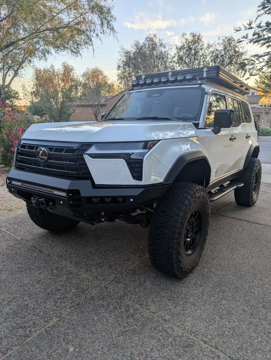

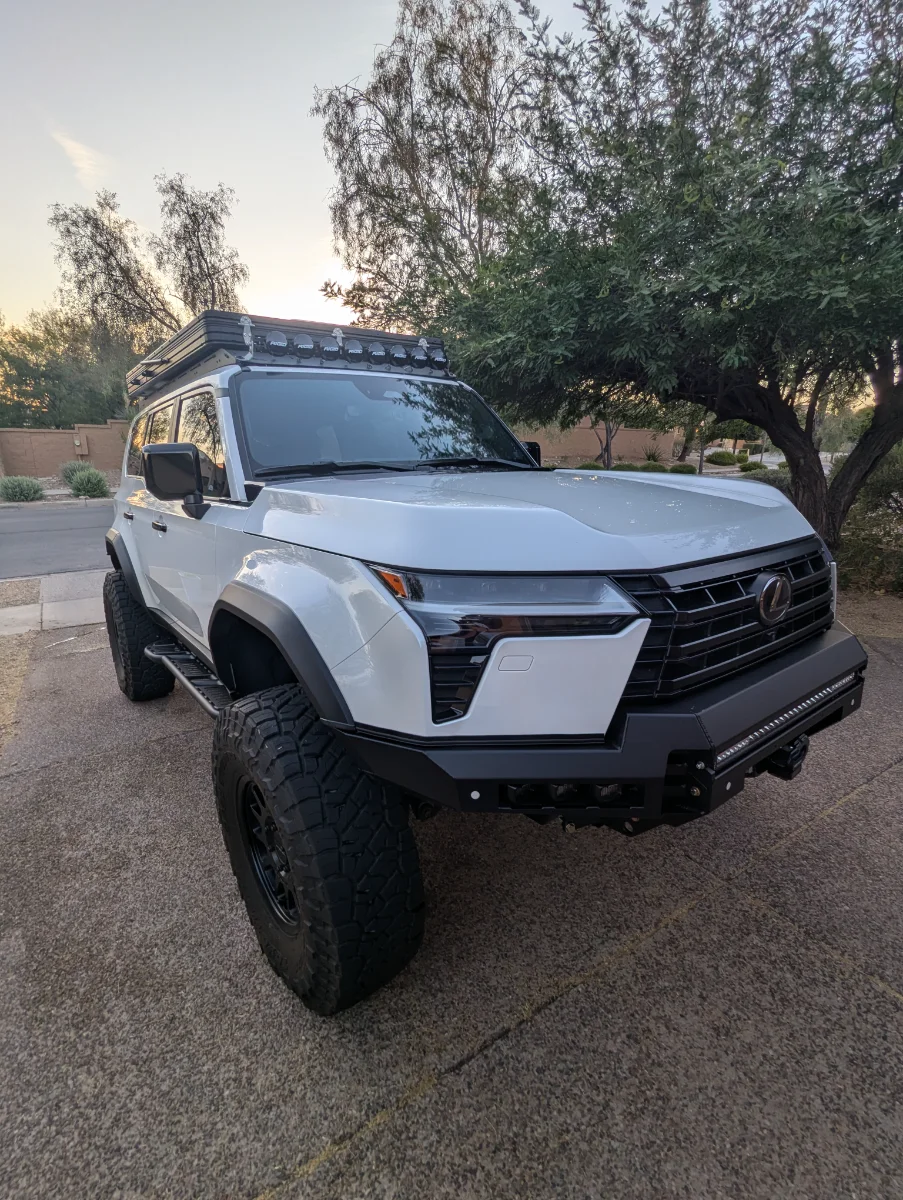

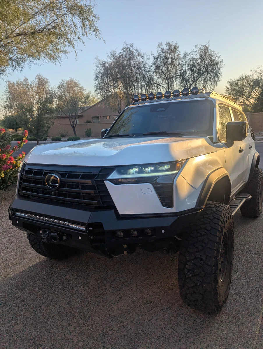

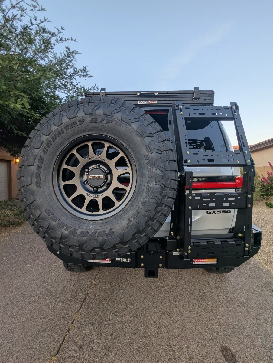

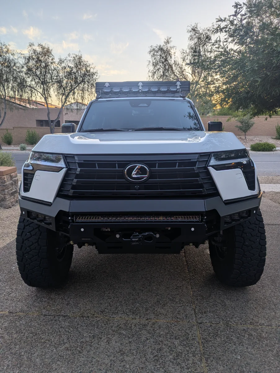

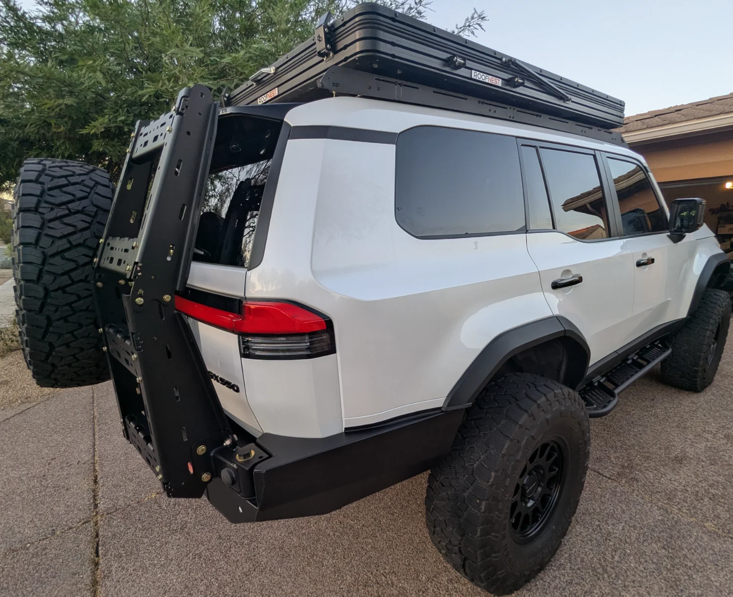

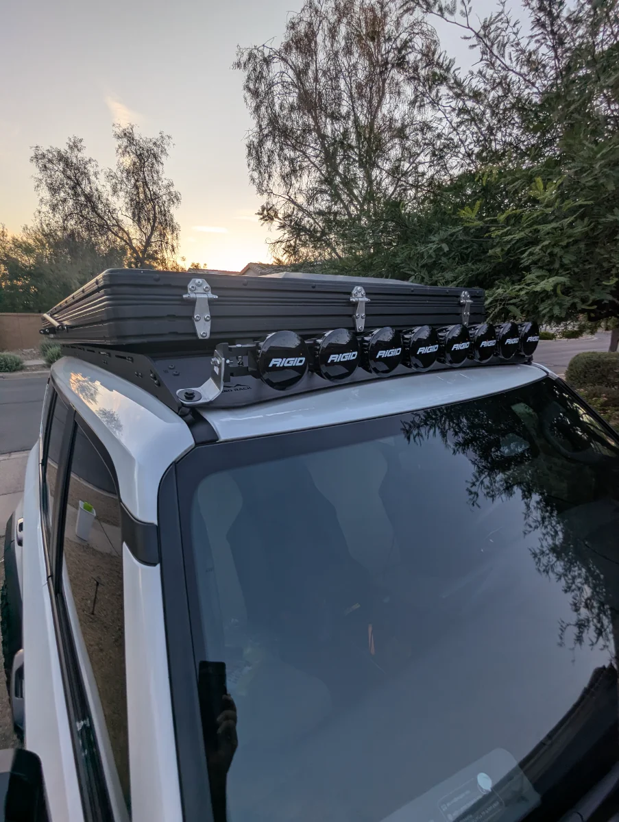

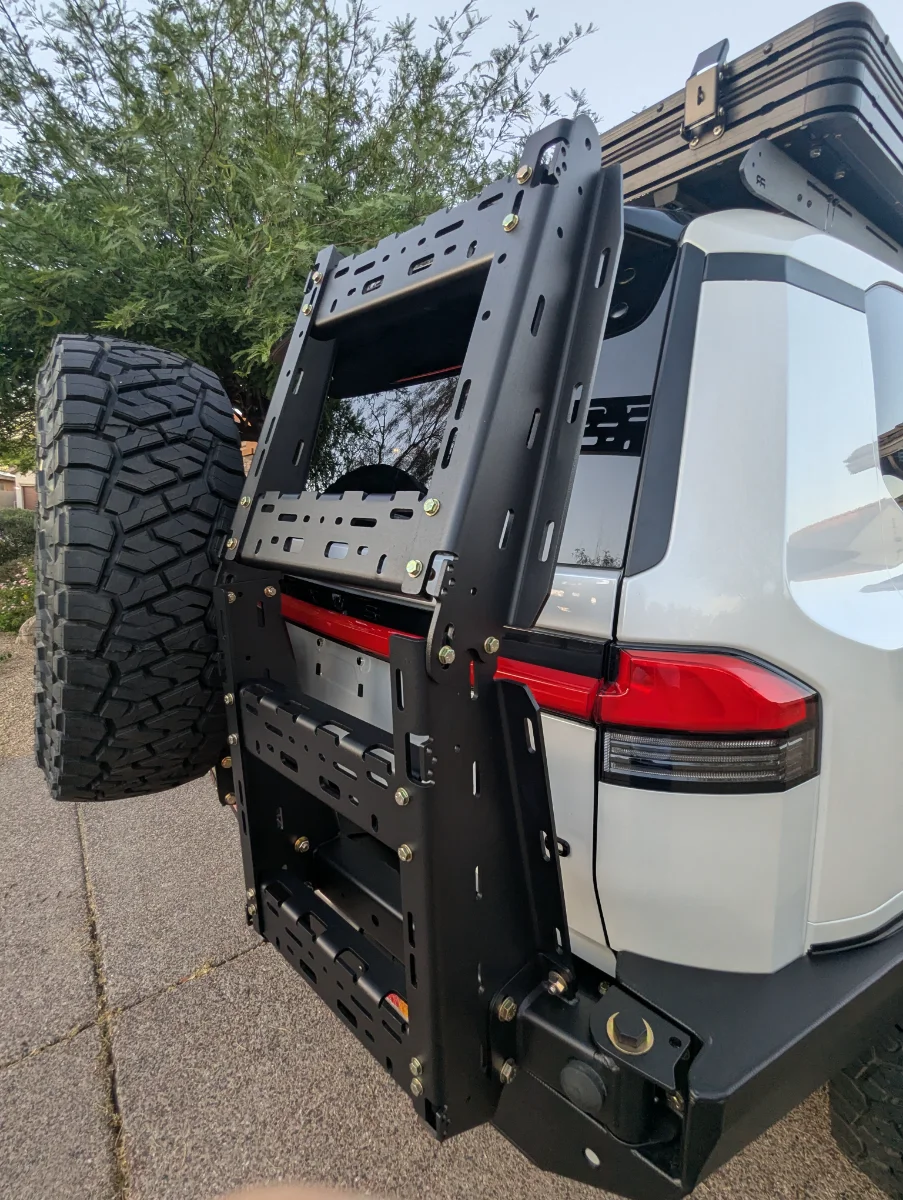

Overland Expo is just around the corner, so I wanted to take a moment to share my build with the community. Say hello to “The Yeti”. So far, this build includes:
Rigid 360 Connect 40” Light Bar
Rigid SR-Series 30” SAE Light Bar with White Backlight
Rigid Triple SR-M SAE Fog Lights
74Weld Portal Axles
Dissent Off-Road High Clearance Winch Bumper
Dissent Off-Road Dual Swing-Out Modular Rear Bumper
Dissent Off-Road Tire Carrier Swing-Out
Dissent Off-Road Ladder Swing-Out
Method 703 17” Rims
Toyo 37” RT Trail Tires
Westcott Designs Rock Sliders
Westcott Designs Levelling Front Collars
Prospeed Roof Rack
Roofnest Falcon Pro Rooftop Tent
Warn Evo 10S Winch
Nytop Skid Plates
Nytop Fender Flares
Magnaflow Overland Series Cat Back Exhaust
Wolfbox G900 Tri-Pro Camera System
Special thanks to Todd at Doetsch Off-Road in Chandler, AZ for doing the build and helping my vision come to life. Props also to Frank Burch. Obviously, I have used many of his ideas and am thankful for him sharing his ride with the community through its various iterations. And finally, thanks to Dylan and Albert at Rigid for their support and for featuring my rig in their booth at Overland Expo this weekend. If you’ll be in Flagstaff for the show this weekend, stop the Rigid booth and say hi! I’ll be wearing a black Rigid hat and Rigid lanyard with my name on it. Would enjoy talking to anyone about their GX’s or wheeling in AZ and Utah!

Hey Mark,
How much does your rig weigh? I'm contemplating adding portals and a rear bumper but quite concerned about the overall weight.
Thanks.
Also I’m curios to know if you have heavier springs and why you choose westcott vs a proper lift kit?
I believe the 74Weld portals already provided the lift so needed the Westcott collar/space to level the vehicle. Probably not enough weight in the rear to require higher rated springs.
Yes ok for lift but what about performance, ride quality, comfort?
I have asked that question for people with portals but no one has responded. Supposedly, the ride should be OEM. I have heard that there have been some issues with the portals that nothing public. More like private campfire talk which gives me pause about taking the plunge.
I've seen Frank's and talked with him about it, and the actual portals are incredibly impressive. The ride is supposed to be just like OEM, which makes sense because you still have (or can still have) the stock suspension, you're just putting everything up on the portals. (Frank has a full King setup.) The look is certainly impressive but I don't want to take it that far. This truck splits daily driving with my 911 and there are more times than not when I need the room in the truck. It's hard enough for my wife & kids to climb in now. I also haven't really found anything that I can't tackle (and want to tackle) that makes me think I need to go bigger.
Mark, I'll have to catch up with you around town someday, would love to see it in person.
Hey Mark,
Thanks.
I've never weighed it, but let's add it up:
Portals ~200 lbs
5 Tires 180 lbs (each tire is 36 lbs heavier than stock)
Front and Rear Bumpers 255 lbs
Rear Bumper Swing Outs 110 lbs
Winch 55 lbs
Roof Rack 30 lbs (difference from removing stock roof rails)
Upper Light Bar 12 lbs
Sliders 43 lbs (difference from removing overtrail stock setup)
Skid Plate 50 lbs
So, in total, I've added about 935 lbs. Base weight is 5675 lbs. Total weight would be 6610 lbs.

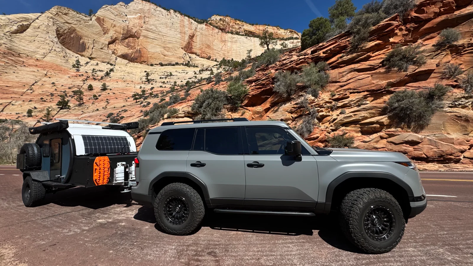

I saw Frank at Overland Expo last weekend, and we took a few pictures with our rigs together. (y)
How are you liking the Dissent products? The rear bumper was a pain to install but looks great. I'm just waiting for the swing outs now. The portals are an expense upgrade which I'm not sure is worth it. I had added a King 3" lift on my 4runner which more than I needed. I added Dobinson heavy duty springs in the rear of the GX for towing the camper and left the Ready Lift kit on the front for now. I'm on the fence as far as the front bumper goes. The dissent bumper looks awesome but its about $6,500 with the winch and lighting its a little pricy.
