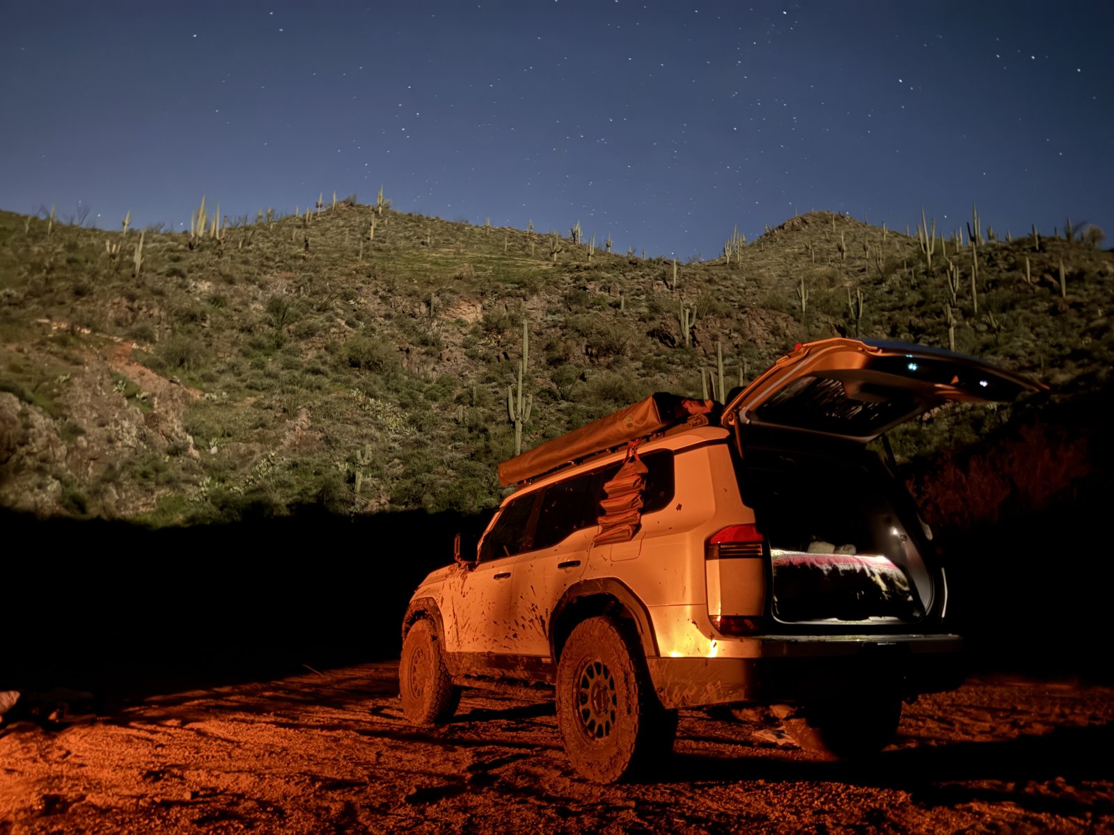

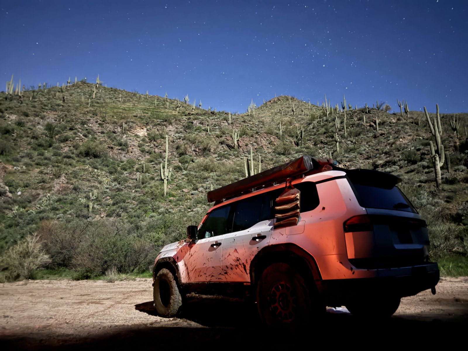

Went on a quick camping trip this past weekend for my buddy's birthday. It was pretty chilly (about 39 degrees at night) and the Bambed in the back of the truck was much appreciated. It was a full moon (or 1 day past) so I also whipped out the Weathertech full window blackout shades. Those things are cool! They all fit perfectly and they easily wedge in place, except for the 2 cargo window shades - these are cut perfectly but they don't have an edge to wedge behind so they just kind of set in place and can fall out easily. I'll have to put a couple little tabs in the plastic surrounding the windows to provide a place for them to wedge behind.

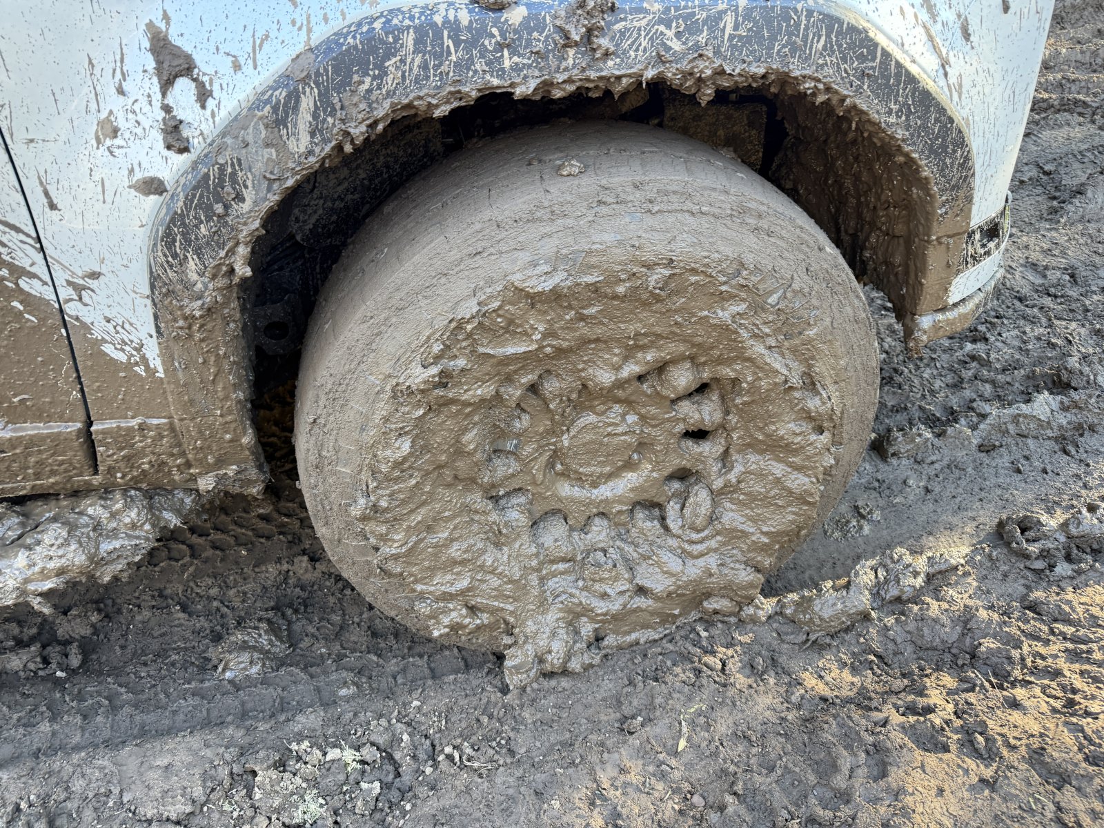

As a special birthday surprise for my buddy's 61st, I got us good and stuck in bottomless mud to start off the trip. This entrance to the river wash has always been passable but not anymore after record rains in October and November. Last time we were here was late September. Now the whole entrance is a giant mud pit. I had the frame on the mud and all 4 wheels just spun. We got out of the truck and promptly sunk - his side was more watery and he sunk to his knees and I only sunk to mid-shins. It was the kind of mud where you can barely lift your foot out and you are in danger of pulling your boots right off. Luckily 3 side-by-sides came by and 2 used their winches to hook up to my pull strap and pull me out backwards. There was nowhere forward for me to winch to, just more mud. Once they pulled me about 5 feet and out of the suction, the DAC/Crawl feature in 4-low worked very well to inch me backwards out of the mud. My Maxtrax boards are gone, disappeared in the mud. I'll have to go back and dig for them when it dries out a bit more. That's 300 bucks down there!
Took some very interesting photos in the near-full moonlight. With the shutter on the iphone adjusted to max (10-seconds), it makes the moonlit canyon look just like daylight.
You can see where the bottom of my truck smoothed out the mud on the right side.
In the photo above, it's pitch black out and the canyon wall in the background is lit by the moonlight. The truck is lit by the firelight.
Here the rising moon is illuminating about 3/4 of the truck with the back still in the dark.
Here's the same photo but from the other side. The fire and our camp is in the pitch-black dark and that's just moonlight illuminating everything else.

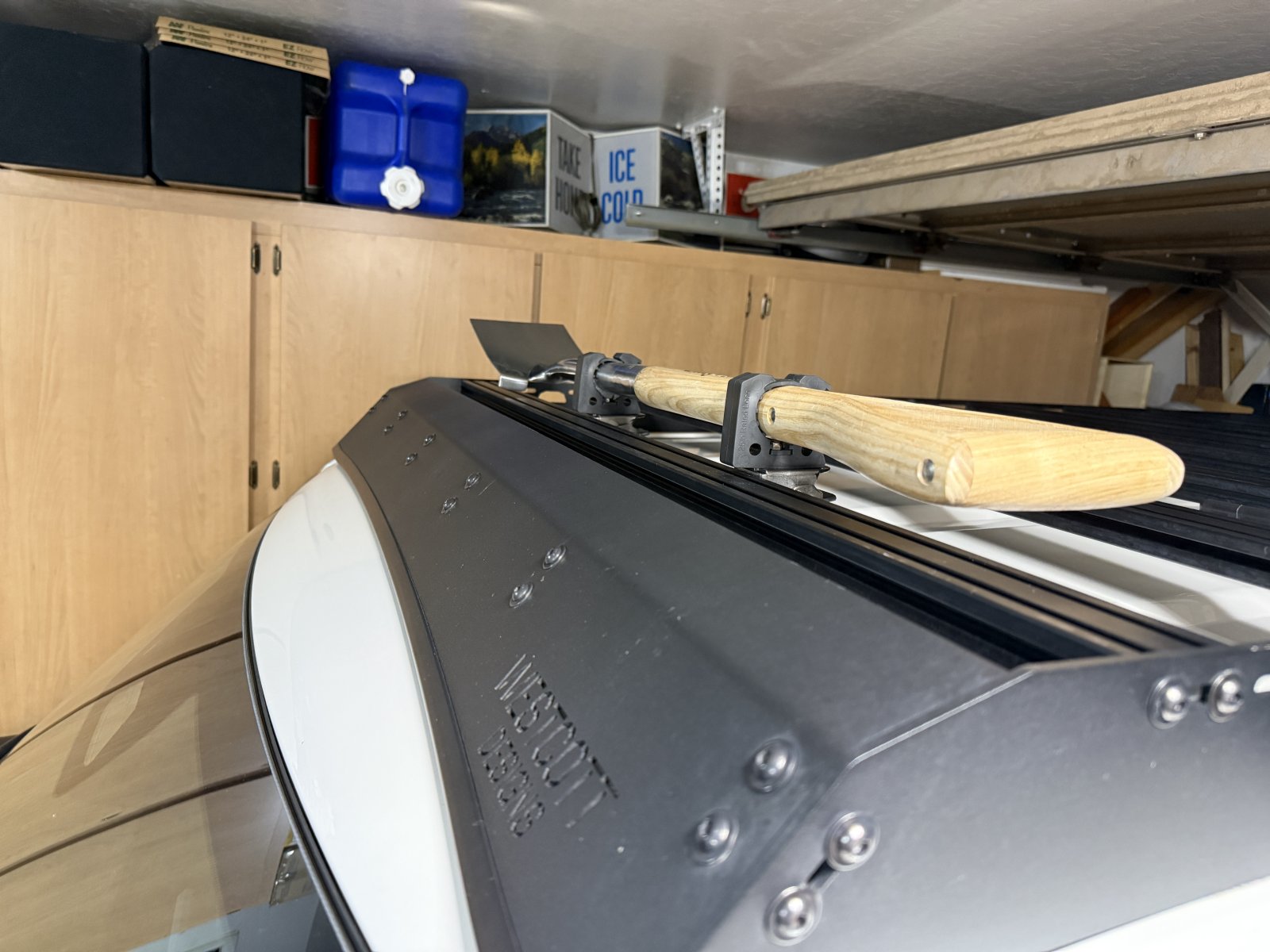

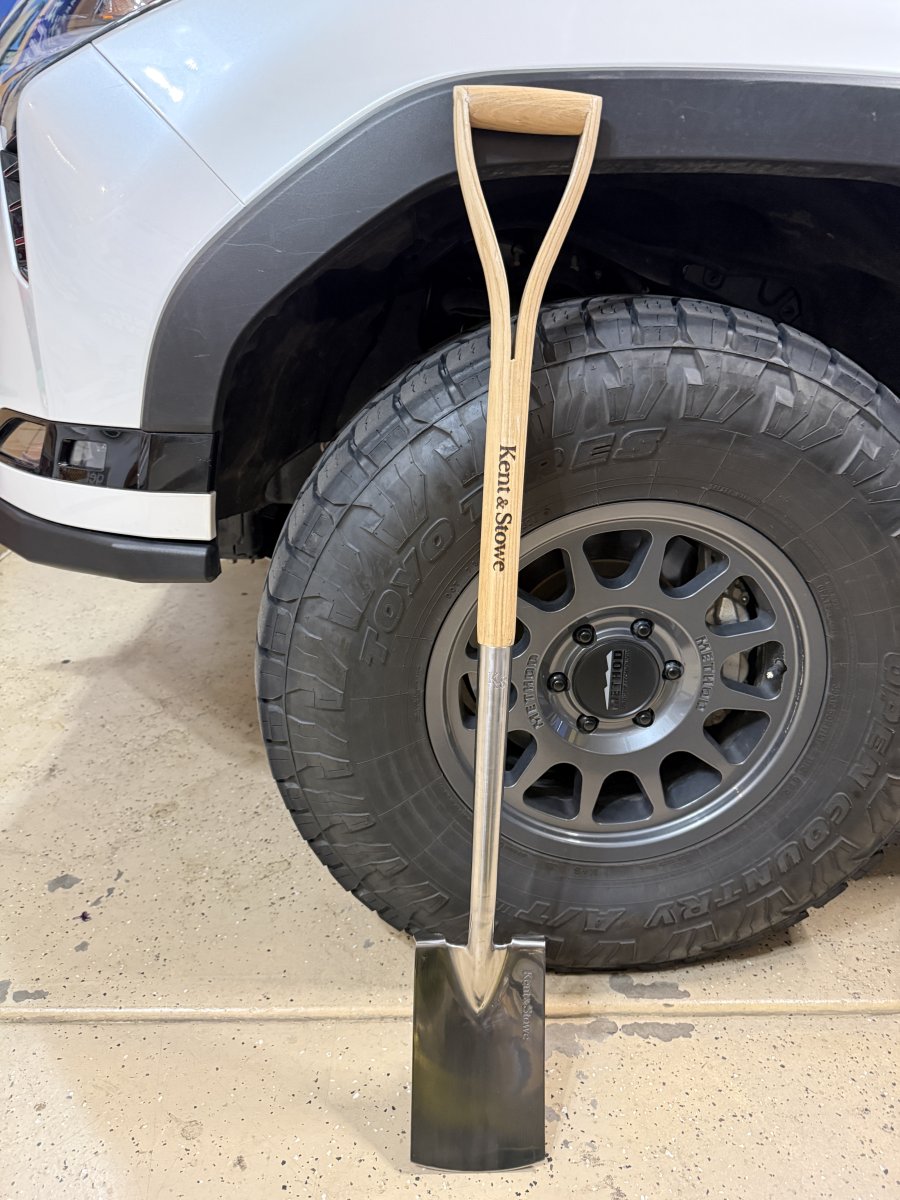

It's been too long since I've done something interesting to Junior, my GX550. It seems like I've been waiting a year and a day for my Camburg Upper Control Arms. I waited a little over 3 months with promises of any week now and I cancelled my order when they finally said 8 to 10 more weeks. I scheduled my King suspension installation at Westcott Designs for their first available date, January 26th. I'm going with Icon UCAs which Westcott has in stock. That was easy. On another note, my December 1st order of a 6-pack of Camburg "King blue" stickers arrived yesterday. How ironic.

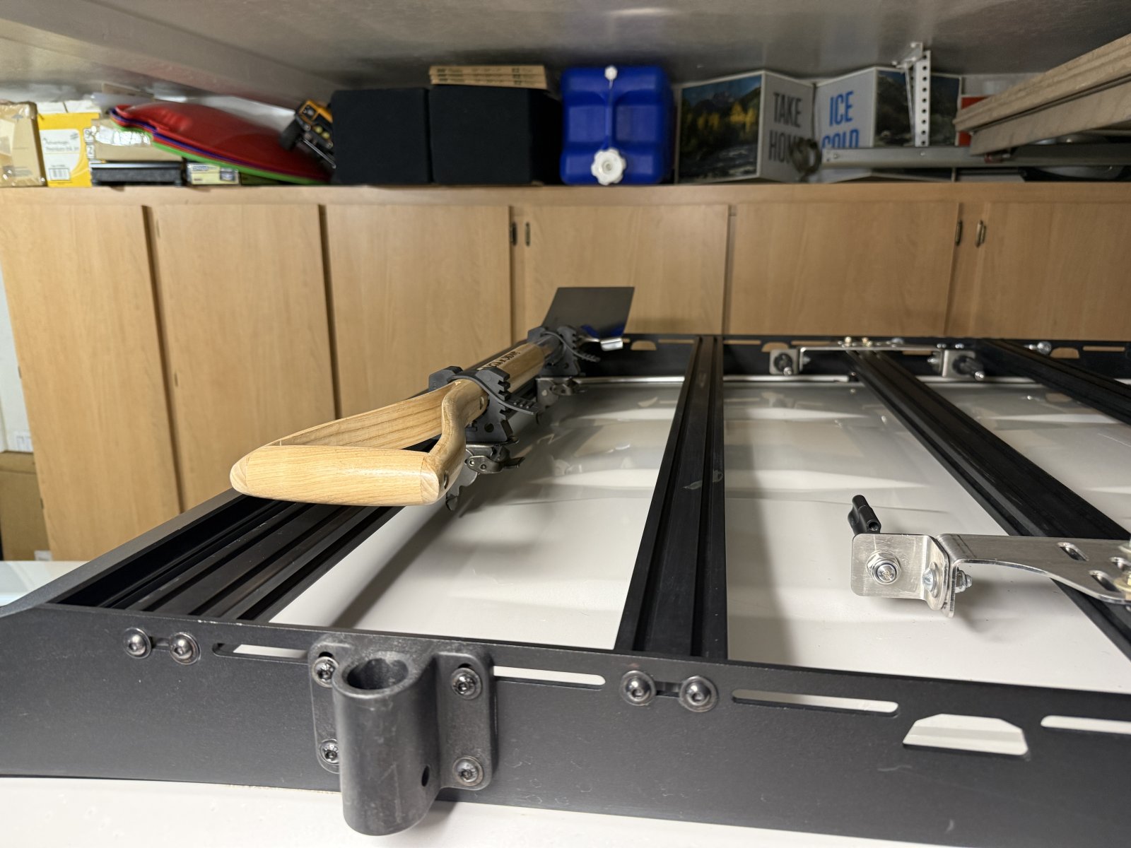

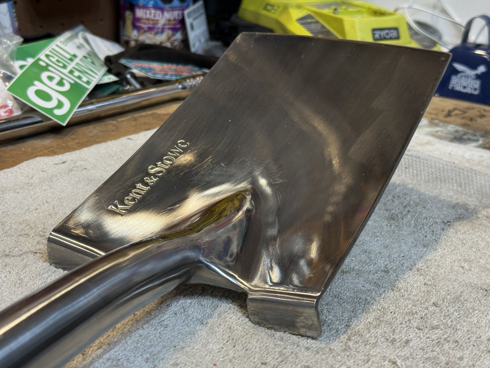

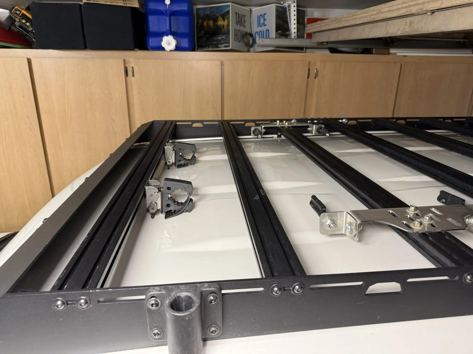

Anyway, tonight I was tinkering, as my wife says, and I finally finished my new shovel mounts for my roof rack.
After my December to Remember adventure in the new mud pit at my favorite local camping spot, I realized that I need a good shovel that you can actually dig with for a good amount of time without breaking your back or making your hands raw. I have carried my father's US Army-issue folding shovel for over 30 years but it's more suited for digging fire pits and single-serving field latrines. Since I'm not a $300-super-off-road-overlander-Armageddon-spiked-razor-sharp-shovel-zombie-survival-tool kind of guy, I looked for a useful and somewhat classy alternative. After far too much research, I settled on the Kent & Stowe border spade which is a quality 41" long English stainless steel spade with an ash handle. Two requirements were stainless steel and a wooden handle with a real hand grip. I hate the simple straight handles that dig into your palm with any amount of real work. I'm not a soft hands guy but I also don't dig holes for a living. I found this fine English tool at Walmart online, of all places. $92 shipped to my door. Only £39.99 on Kent & Stowe's UK website which is about $54 but then you have shipping and import taxes on top of that...a few clicks on Walmart's website and it appeared on my doorstep.
I chose this shovel size and shape because it's good for swiping sand away in a rowing motion as you're on your knees by the truck, such as scooping sand and gravel away from behind the tires. The size (blade is 9" long x 5.5" wide) is good for moving some material but also not so big that you're trying to move too much weight with each scoop. Same for mud. You can cut in manageable scoops instead of trying to move a 40-lb clod of wet mud with each scoop.
In keeping with my quest to keep my roof rack as low-profile as possible, I didn't want to bolt on a shovel mount that stuck up a few inches, thereby losing my garage clearance. I also don't really have clearance on the side of my low-profile rack to strap on a shovel without hitting the body of the truck. Most shovel mounts from the Armageddon crew are also nearly as expensive as the $300 Armageddon shovels. I figured I'd just be throwing the shovel in the cargo bay with all my other junk and then I had an idea.
Years ago I bought a couple of folding & locking hinge mounts on Amazon for some long-forgotten truck-related project. These look like the same brackets. They sat in a little box on the back of my workbench forever. A couple months ago I cleaned off my workbench and I relocated them. As I lay awake in bed one night at about 3:00 AM thinking of stupid random things like mounting a shovel on top of my truck, I remembered these hinges. The next day I had to tear apart the garage cabinets to find them because of course I forgot where I put them. Then I spent a good 2 weeks moving the project forward in very small increments, as is my way.
I found the perfect rubber mounts at Harbor Freight (Vehicle-Mount Rubber Tool Clamp). $2.99 each. Take that, $250 Armageddon zombie apocalypse shovel mount companies. I had to use my Dremel to cut down the flanges on the hinges to clear the roof when folded, and also cut down stainless steel bolts to fit just right in the hinge and in tracks on my rack and into the Harbor Freight rubber clamps. I removed a cross bar to get the bolts all in the proper places on my workbench, reinstalled the cross bar, and it works exactly as designed.

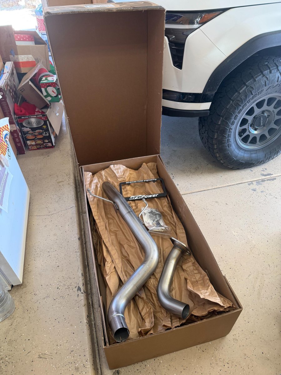

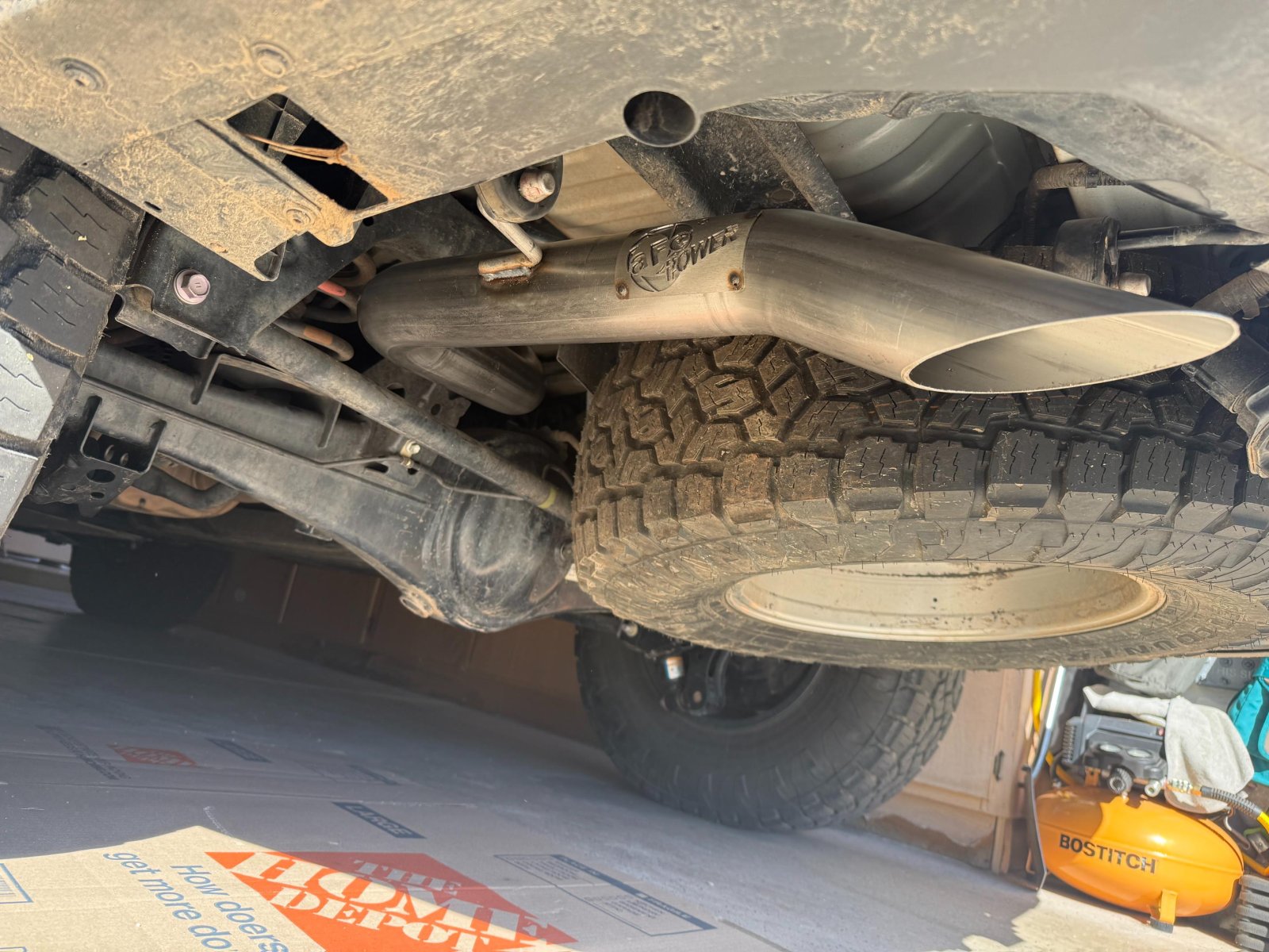

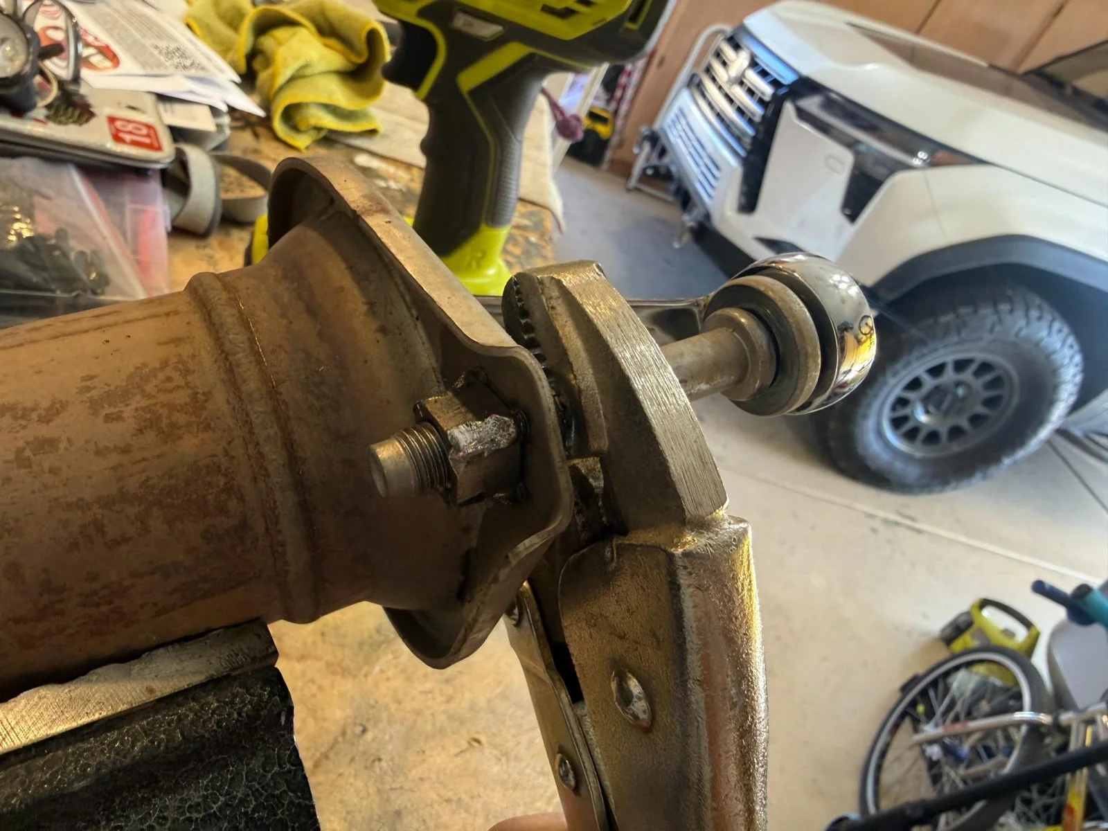

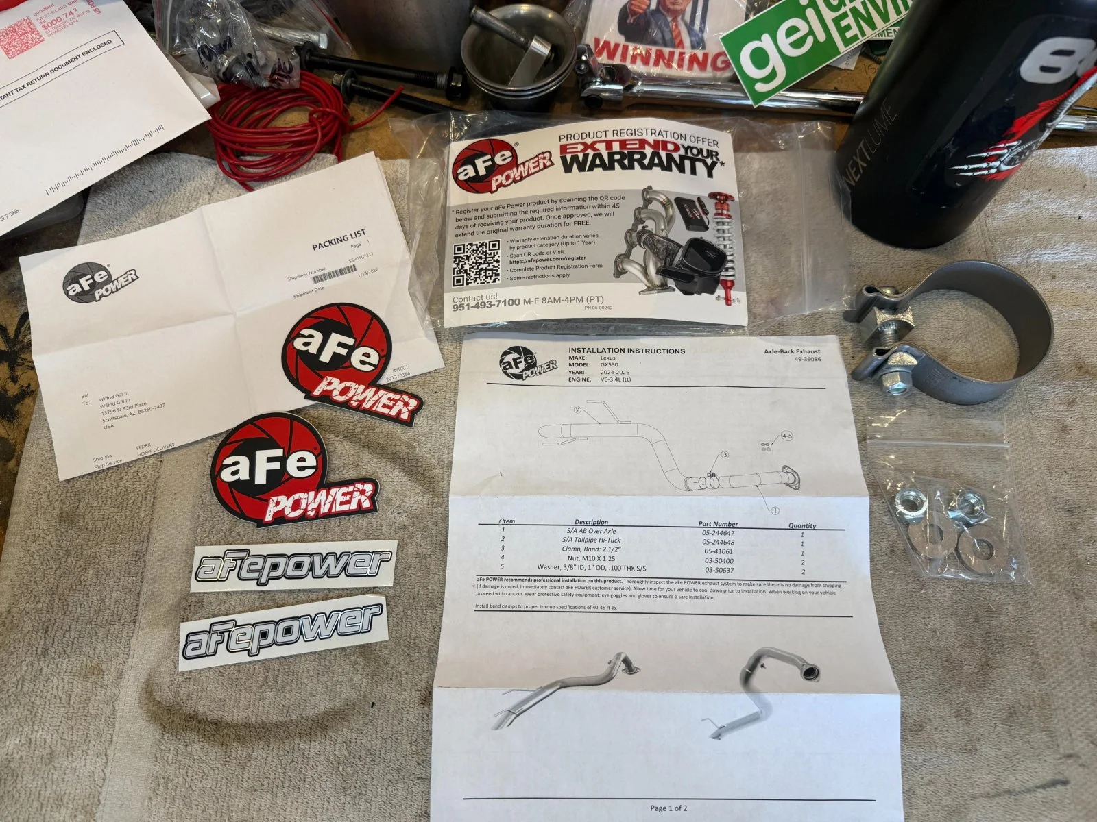

Installed the aFe Power Vulcan Series 2-1/2 IN to 3 IN 304 Stainless Steel Axle-Back Exhaust System.
See this link also:
It's a quality item. It came to $330 shipped with a 10% coupon for signing up for emails on their website.

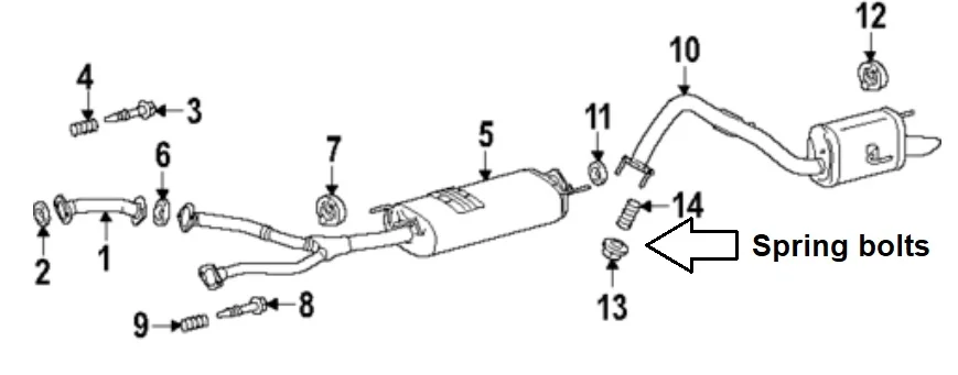

Installation was pretty simple. Getting to the bolts underneath is a bit difficult but the hardest part was getting the spring bolts/pins loose from the stock exhaust. aFe provides bolts and washers to anchor the stock pins to the aFe flange but they instruct you to re-use the actual springs, bolts securing the springs, and the pins.

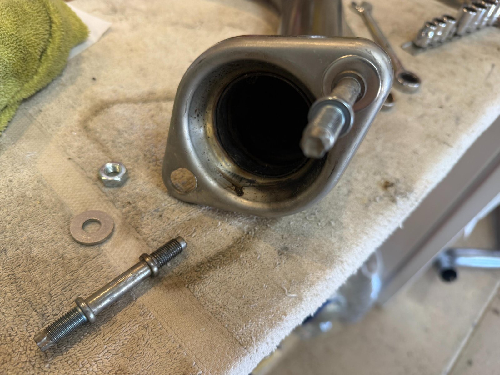

My photos from underneath the truck of the spring bolts and disassembly and reassembly didn't turn out. Normally I'd crawl back under to re-take the photos to provide the best possible reader experience but I just dropped my truck off at Westcott Designs to have the King suspension installed. I beg your forgiveness. Here's a parts diagram showing where the spring bolts are in the system:

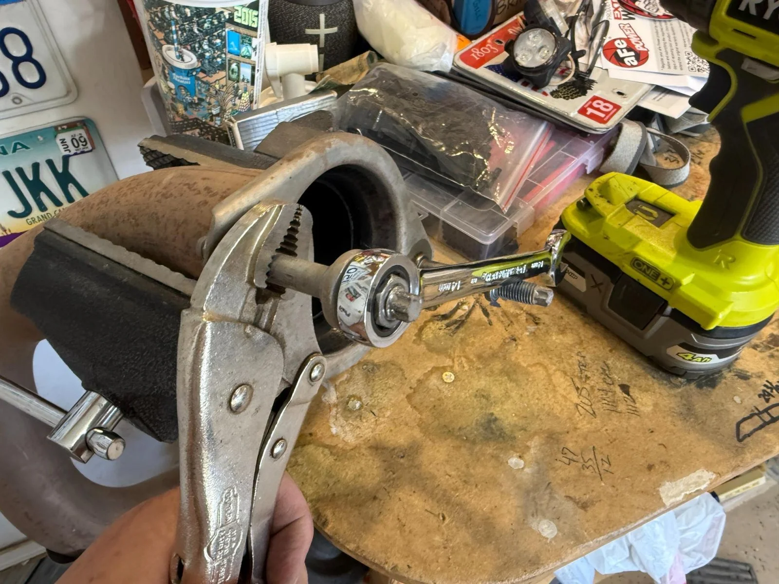

Once I removed the stock exhaust, I had to break the pins free from the stock flange by securing the stock exhaust in a vice and then screwing the spring bolts back down tight (without the springs) and over-torquing them a bit to break the pins free. I applied a little PB Blaster first. Then I had to grab the pin with a vice grip to get the bolt back off, then the pins spun free by hand. The stock square bolts on the backside of the flange that the pins screw into are welded in place.
The spring bolt holes on the aFe flange are bigger that the stock holes and the pins were loose in there so I used their washers on the bottom and a couple new washers on top under the nut they provided.
I slipped the clamp on the tailpiece, fit everything together loosely, got the rubber hangers in place (a little dab of bearing grease helps), and then torqued down the spring bolts and then the clamp bolt.
The exhaust tucks up much better than stock and no more looking at that ugly black resonator box under there. It sounds good, not too much louder than stock. It has a nice little snarl to it and, most importantly, no drone at cruising speeds. You can't even hear it on the highway. My wife didn't notice a thing, even standing outside of the garage waiting for me to back out when I started the truck. Then again, she didn't notice a new steel bumper and winch on an old Land Rover for nearly a year and she didn't notice the Westcott pre-load collar lift and new Method wheels and 35" tires on the GX until my son spilled the beans a few weeks after installation.
See this link also:

Nice! Don’t suppose you took a before pic of the factory exhaust? Does this new one just get it up and out of the way?
See this link also:

would it be less of a hassle for me to just buy another set of spring bolts?
