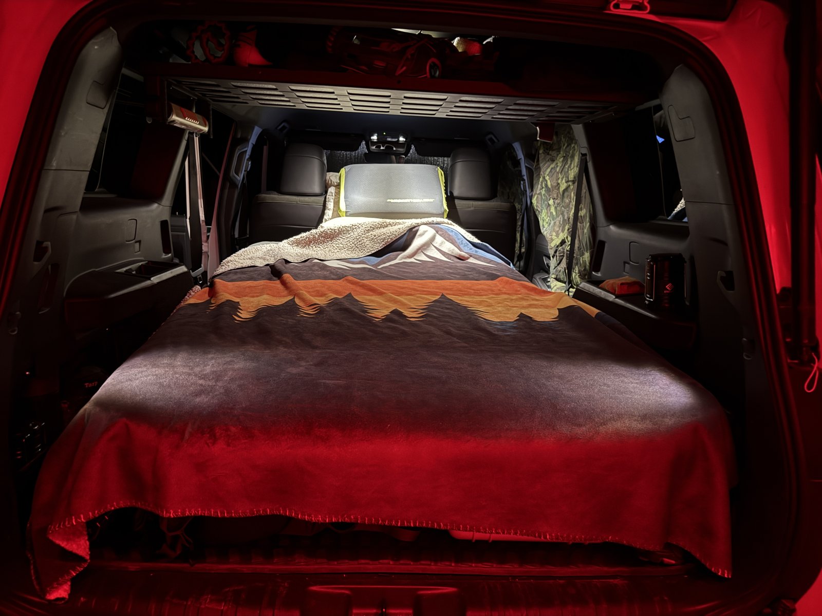

It's a really nice atmosphere inside the truck with all doors closed, and also very nice with just the rear hatch glass popped open. That's going to prove to be a nice feature while sleeping in the truck. Need to create a way to open & close that glass hatch from the inside.

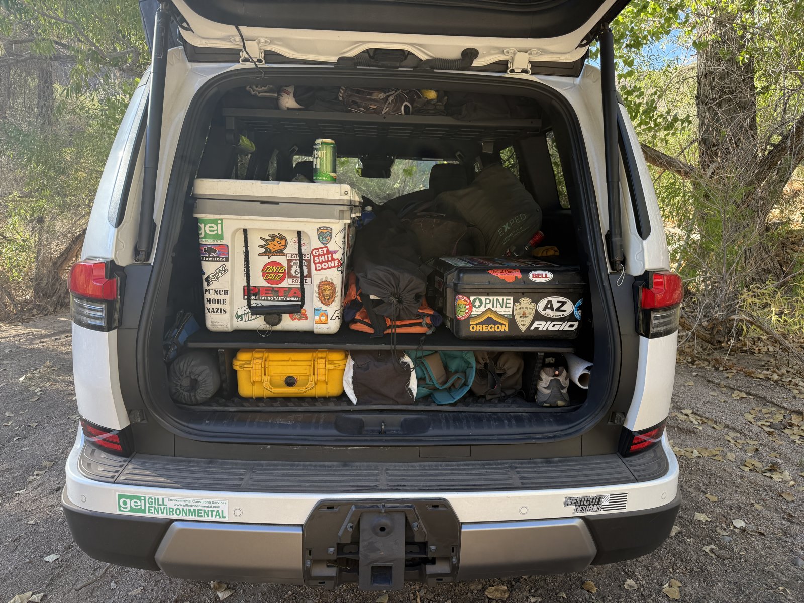

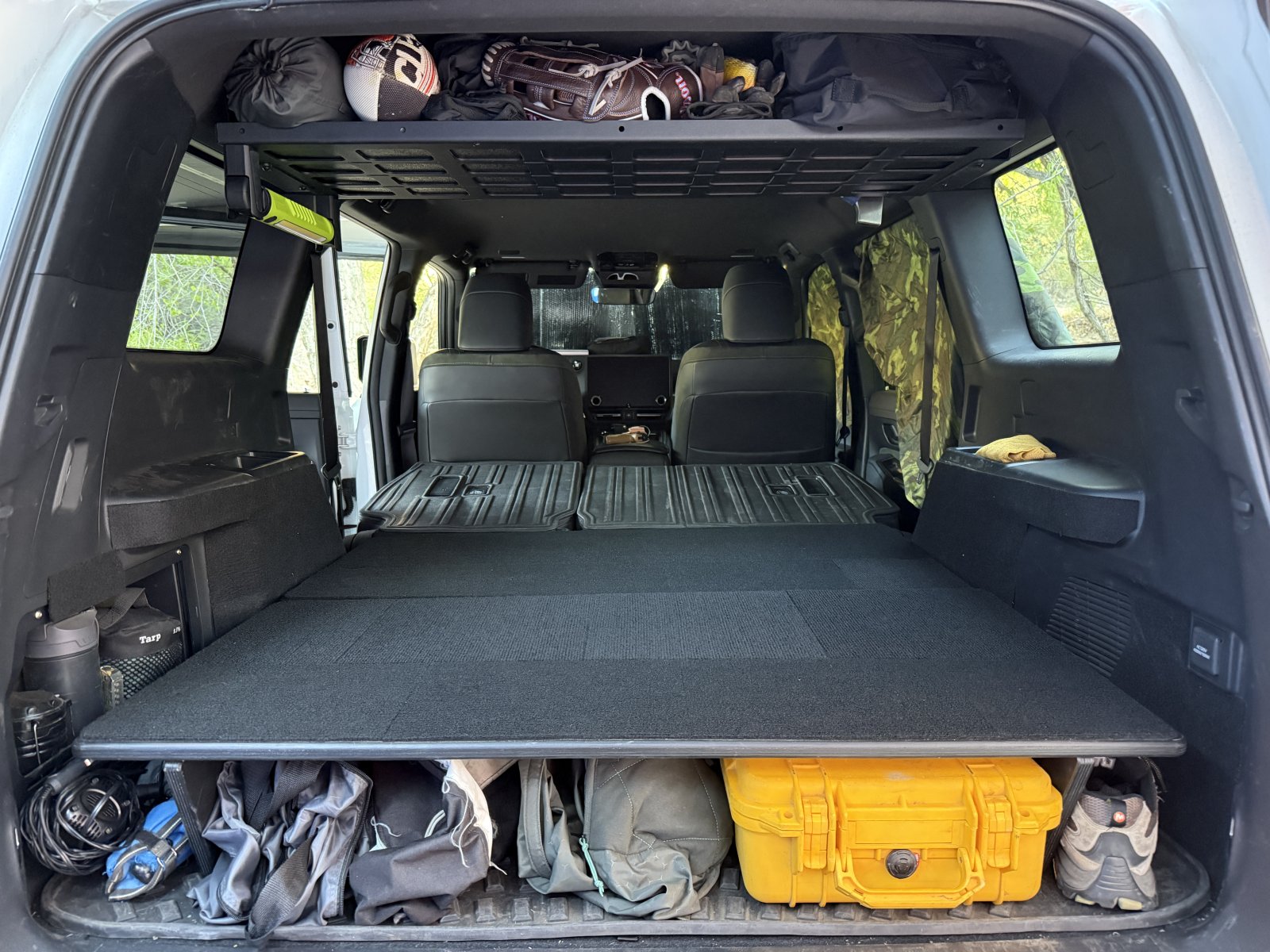

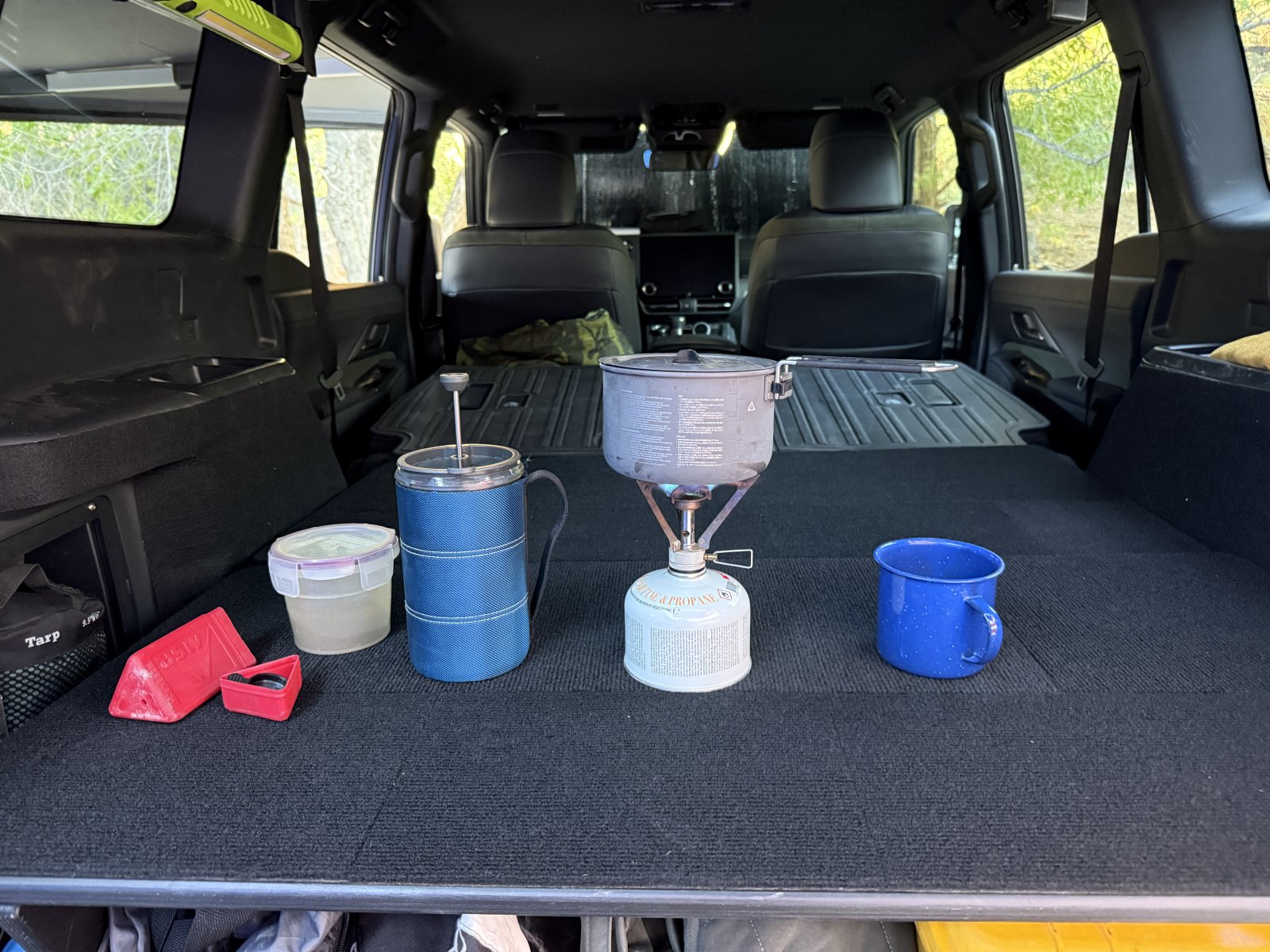

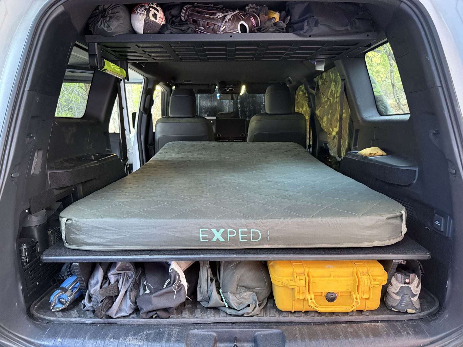

Used the Bambed on a quick overnight camp trip this week. Worked fine. I set it up in the cargo area before the trip and it is very nice to have that extra storage underneath....BUT, one major flaw is that I could only open the cooler a few inches before the cooler lid hit the overhead shelf with the cooler up on the platform. There's a downside to everything! Very inconvenient for loading the cooler, getting stuff out, etc. As far as sleeping, comfort, etc. it was perfect. I painted the edges black and put carpet tiles on top and it worked out well. Unfortunately one of the 2 platform pieces has warped and now it doesn't sit flat, it kind of wobbles back & forth from side to side.
Was very convenient for making coffee in the morning.
Interesting - my inside shelf (we have the same brand) is just about 15.4 deep. Cut the plastic to your measures and it was too wide. Guess the MFR winged a few of these...
I cut the plastic sheet down to 40-1/2" X 15-3/4".
The inside edges of the metal overhead shelf are rolled so there is some variability to the measurement. I'm sure my "straight" cut also probably varies a good half-inch as I just winged it with my circular saw and didn't bother with a guide.
Since those posts I have painted my Bambed base pieces with several coats of black paint and Minwax Polycrylic Crystal Clear Topcoat, re-painted and topcoated the edges of the Bambed platform pieces, and topcoated the underside of the platform pieces (didn't bother to paint the undersides black). So now the Bambed wood is more protected than the exterior of my house. I also completely disassembled that neon green magnetic light and painted the green housing black because the green was so out of place.
For the ceiling shelf, FWIW: I stopped in at our local flooring and carpet shop. Asked if they had any super thin, cheap carpet remnants I could purchase..dude comes back 15 mins later with a small section from the shop, and said no charge.
Measured up, marked the white-ish back side, used some pretty normal scissors, tried it, and a couple trims later had it in. Silent, just enough friction, nothing hanging down now and the underside provides some decent reflectivity to the cargo area. I have extra left for another install in the future if I ever spill something up there. YMMV. 😉
