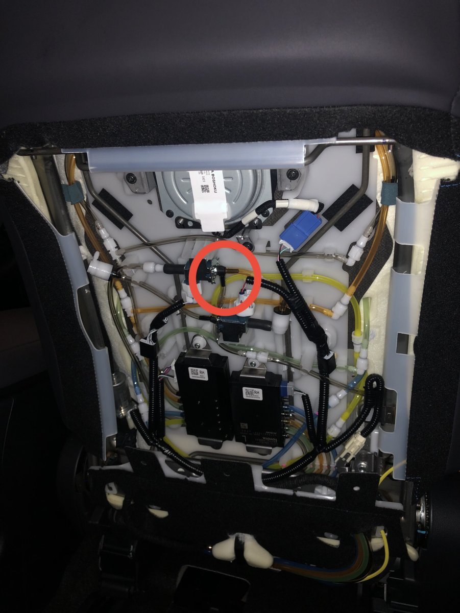

We are having the same issue in my wife's Luxury trim 550. Looked at all the plugs under the seat (there's about 10 of them) and everything looked firmly seated in their respective locations. If anyone knows which plug is the culprit and can grab a picture, post it up, please.
Same problem here, at about 1,200 miles lumbar and massage on passenger side not working. At dealer for repair☹️
Super easy repair - I didn't want to wait for the dealer.... if you want to tackle it on your own, takes 5 mins max. You just need to remove the plastic seat backing.
1) reach under and unhook the elastic hooks and flip the flap up
2) remove 2 screws that are now exposed
3) slide plastic seat backing down
4) reconnect lines that have come disconnected - I zip tied mine to secure them better
4) reconnect lines that have come disconnected - I zip tied mine to secure them betterView attachment 2150

So, after waiting for a week for an update from the dealer regarding the TAS they've sent out to Lexus and not hearing anything, I decided to try to fix the issue myself.
I opened up the seat back and noticed that the hose was still attached (the clear one at the bottom) but was slipping out. I tried to push it back on but it looked like the hose was tight and I was concerned about ripping it out, so just tried the best I could and closed it up.
The massaging now works but it's not as intense as the one of the driver side.

We had this fixed today at the Lexus dealer and I just wander if it will happen again. What do they do to stop the air tube from coming off again?
Thanks for the fix! Took less than 5 minutes. If your tube is too short you can get a piece at most hardware stores for about a buck.
