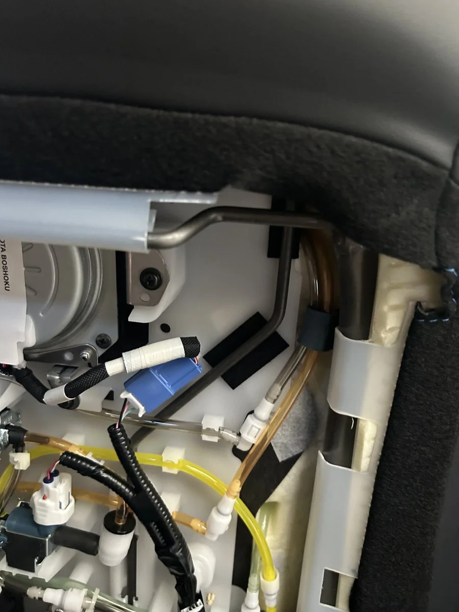

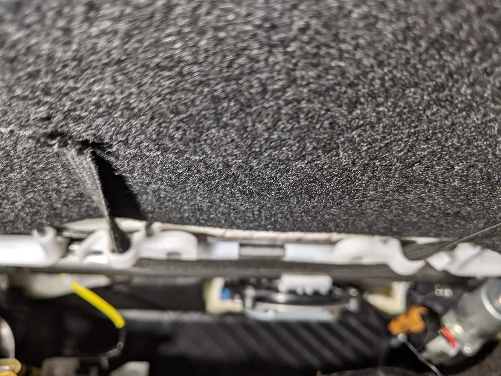

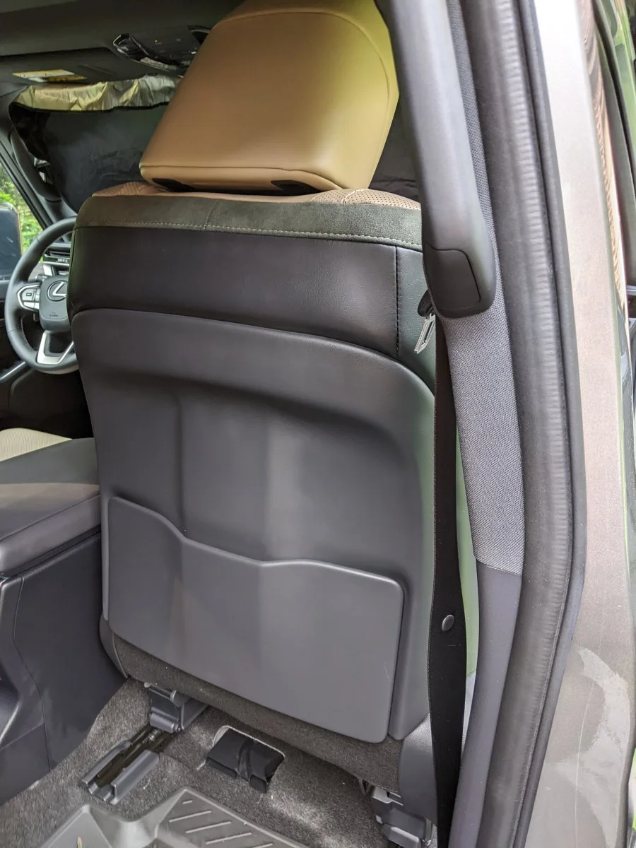

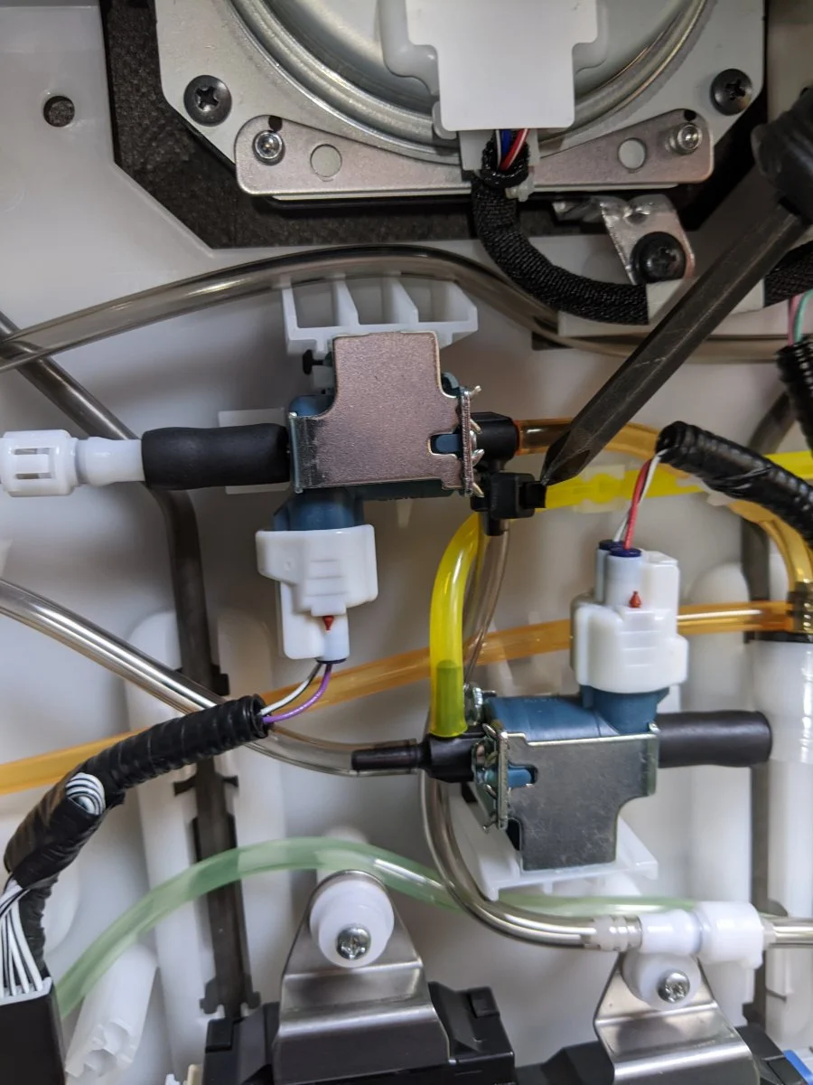

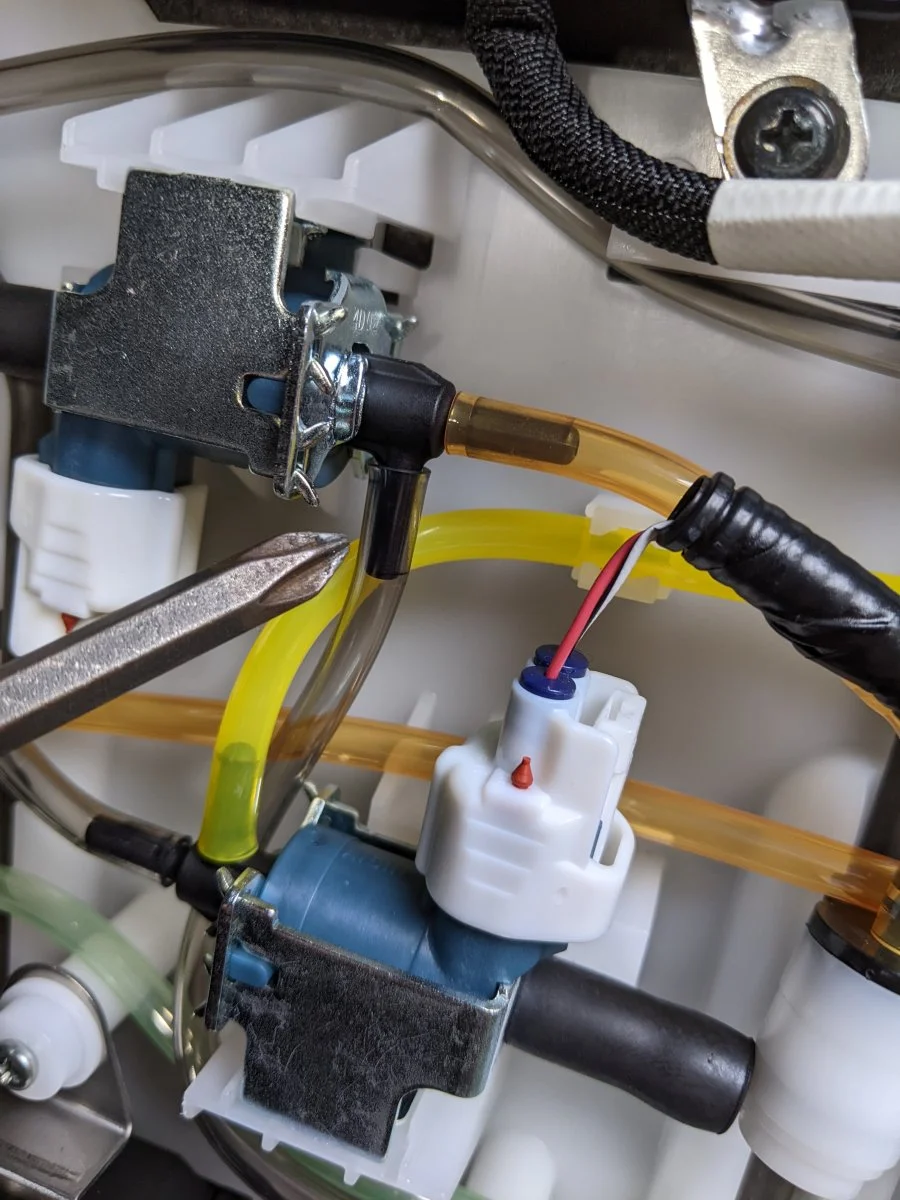

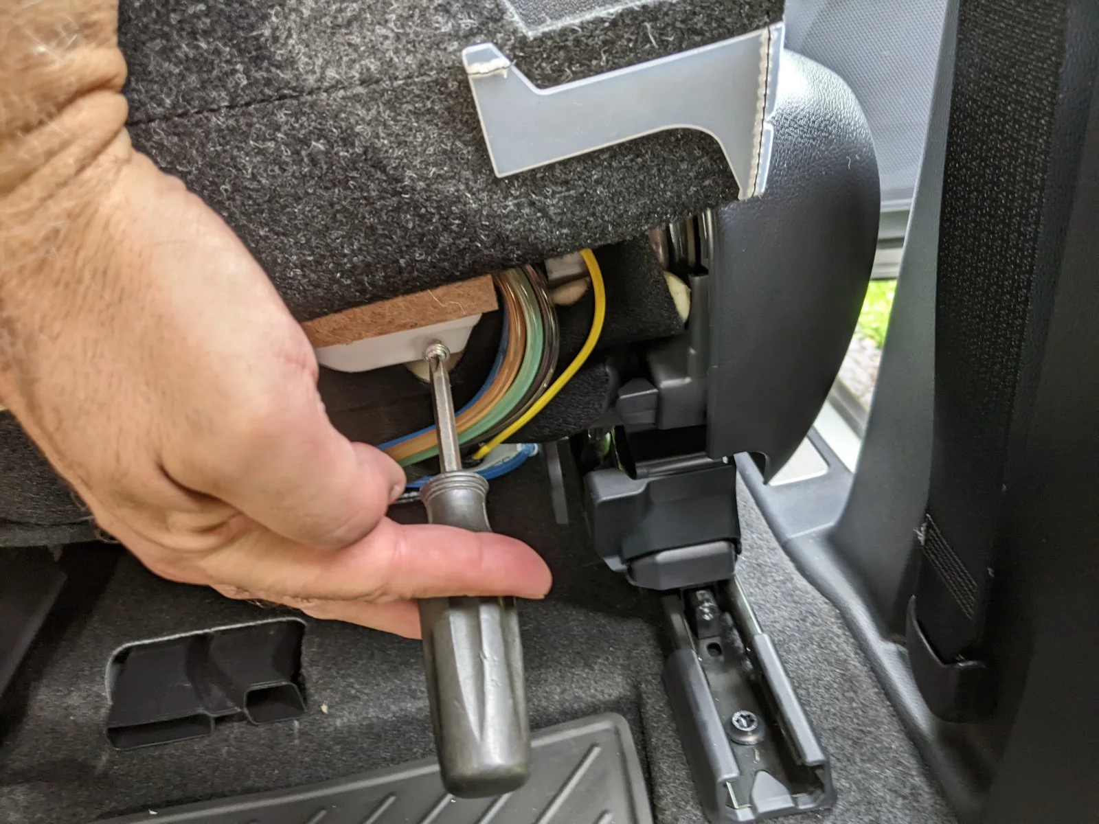

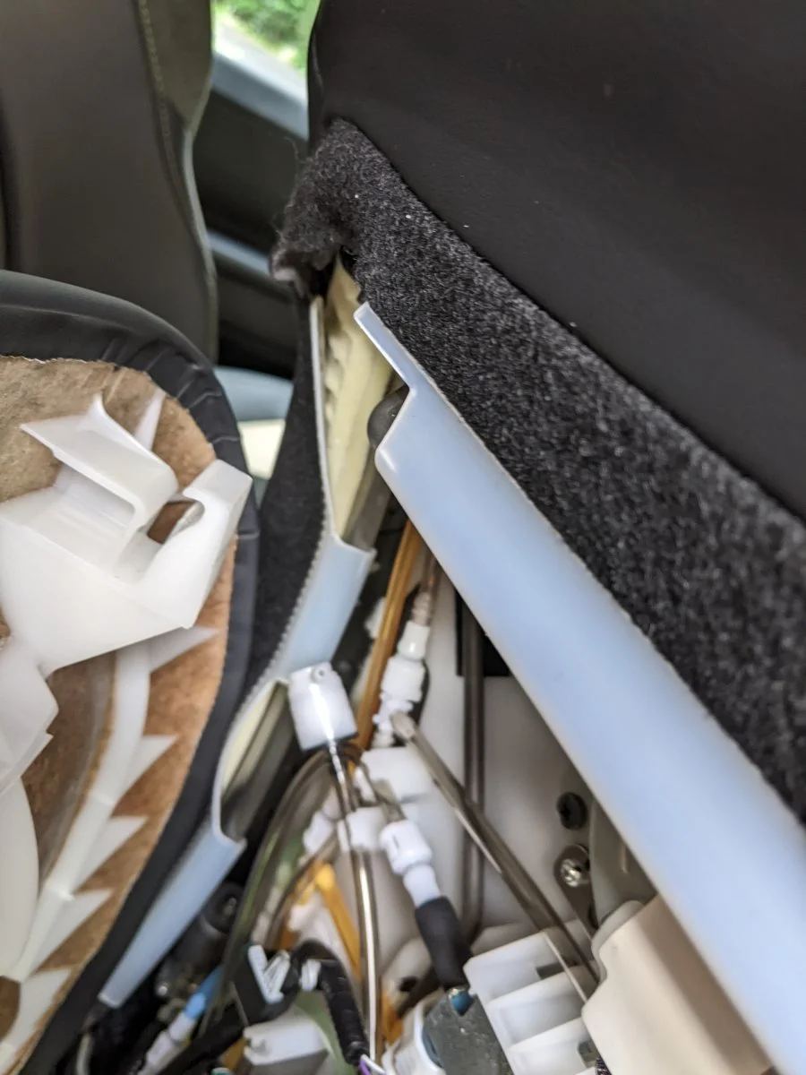

Just fixed mine. Followed instructions above and took some additional photos.

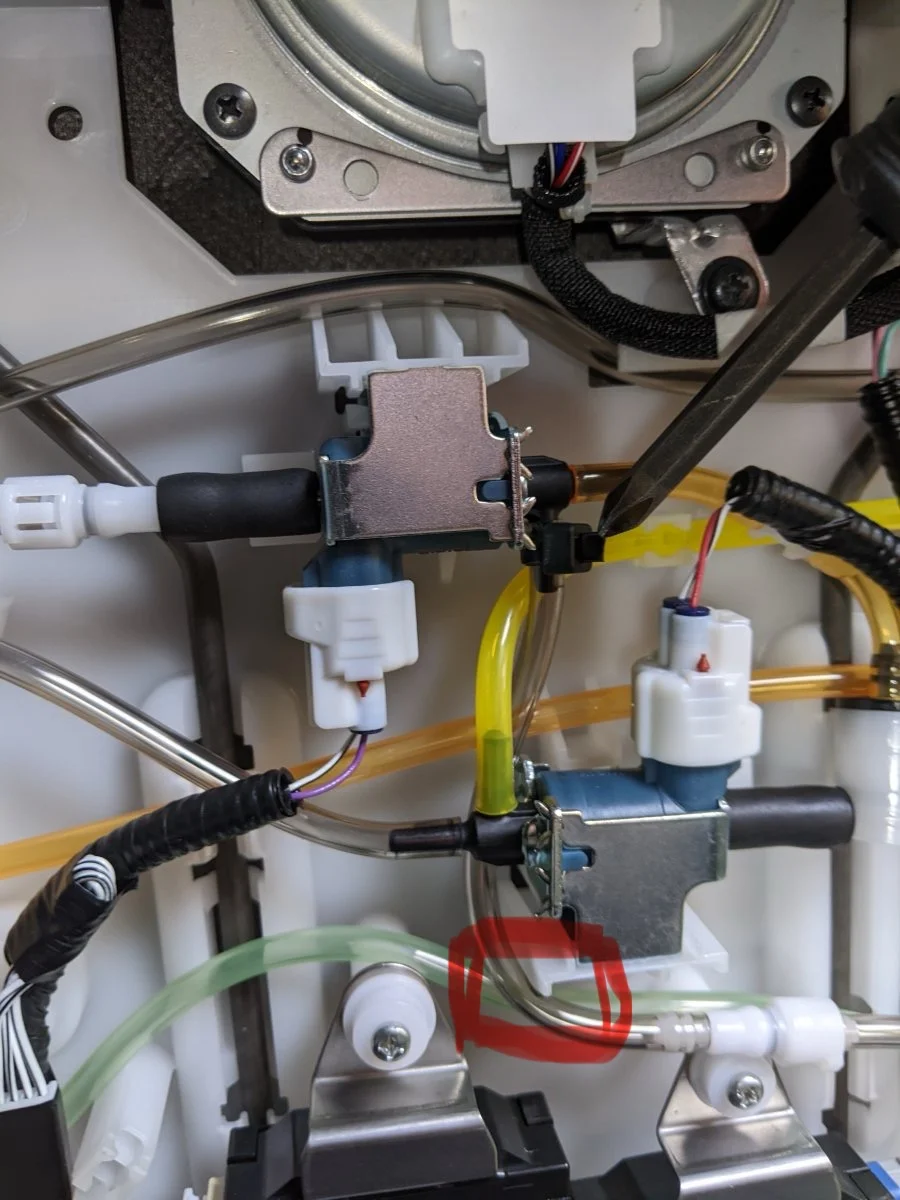

Seat now working again. Tube slipped off. Maybe it was a bit short to begin with. Also there are no barbs holding in place so added a zip tie. Maybe ok to just push hose back up fully. If this is how dealers are fixing it may be worth adding the zip tie if the problem comes back. I spent about 15 min, much less hassle, time and cost(fuel) than driving to dealership. Hope it helps others as the original post did me. Thanks KotaRS.

After being given the run around by the dealer, I was able to open up the seat and fix it myself.
@AtomicEric and @KotaRS, your posts have been super helpful in getting this fixed.
The one thing I noticed that there was a slight kink in the hose due to the pressure from the plastic part. Used @AtomicEric's picture to show the location here.
Yes, likely the root of the problem. If it stays on and works as it is now I'll leave it be. If not, a slightly longer hose would be better. Glad you made use of the photos to get it fixed.

Good to hear Lexus is sourcing a longer hose to fix. Zip tie has held so far. If doing at home it should be added to give a bit more compression to the upper end fitting where gravity wants to allow it to slide off.

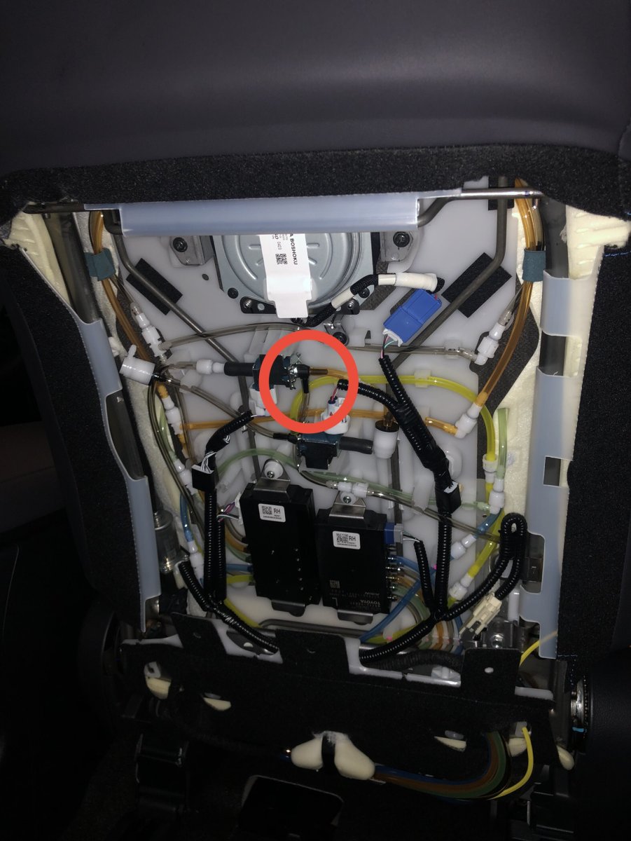

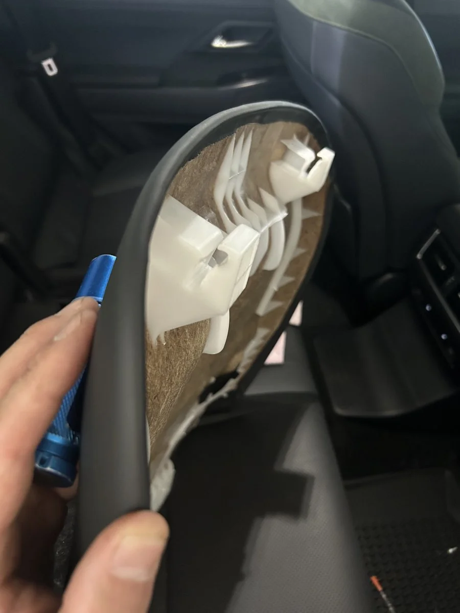

Super easy repair - I didn't want to wait for the dealer.... if you want to tackle it on your own, takes 5 mins max. You just need to remove the plastic seat backing.
1) reach under and unhook the elastic hooks and flip the flap up
2) remove 2 screws that are now exposed
3) slide plastic seat backing down
4) reconnect lines that have come disconnected - I zip tied mine to secure them betterView attachment 2150

Hooked my OT+ back (675 miles) up today thanks to this group. Exact same fitting was out. Hooked up and voila!
Other notes:

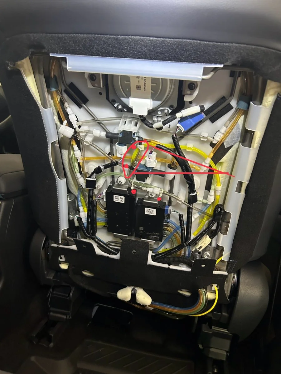

Added a few more pics for backrest -
after bottom screws are out, push backrest then lift up off of bars on seat.
I did not have 1/4 inch tubing but tried to re route hose to get around pinch point a few soft zips should help (see red dots).
Thanks everyone who posted pics - super helpful!
