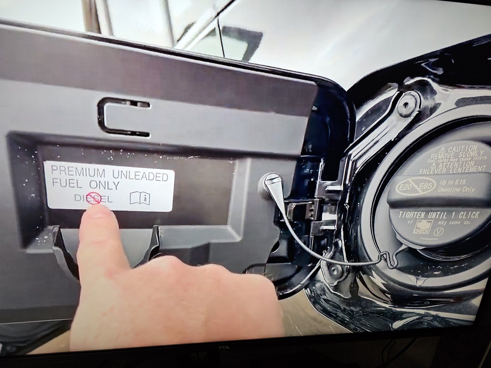

So I was watching a YouTuber video and screen shot this:
I wonder which is it? Driver manual says recommended and this says required. I plan to run premium fuel nevertheless.
Interesting. According to the manual, the new Tundra with the same engine recommends using 87 octane fuel.

Twin Turbo V6, computer is tuned to use 91 Octane (Premium) Mininum. This isn’t a Tundra, don’t worry about their requirements for fuel.

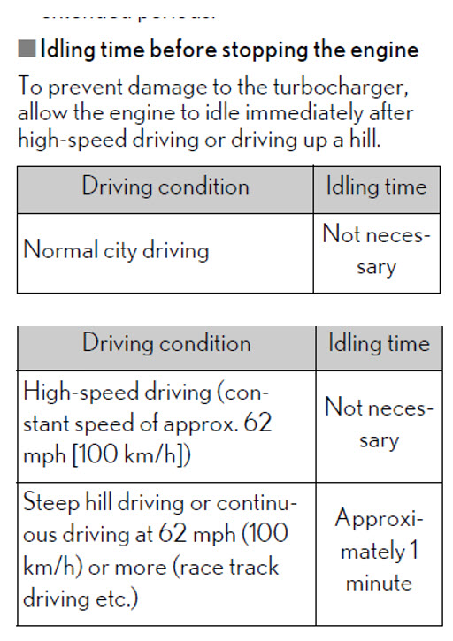

In reply to my own post, I checked a 2025 MY owner's manual and I found a similar recommendation/instruction for idling then engine before shutdown.
Page 174 has this:
Car Care Nut takes this further and says idle for one to two minutes for all driving conditions.
Page 174 has this:
They say that just to cool down turbos after running it hard. Also, if they wanted to be dicks they could try to claim this to wiggle out of a warranty claim.
