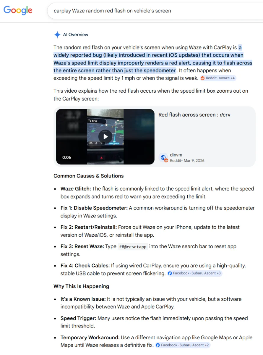

I think it's an issue with Apple carplay, when I noticed it a couple of months ago I did a few searches and seems to impact Lexus & BMW. I did notice after a recent update to iOS that it went away.
I’ve only noticed this happening when using Apple CarPlay, so it might be related to CarPlay itself. Not sure if you’re also experiencing it while connected to CarPlay.
Thanks, AshOT. That's interesting and now as I search CarPlay red flash and not Lexus, I see it's a widely reported problem - and many tie it to Waze, which I use through CarPlay.
Yeah it's a waze glitch, I think it's when there is hazard (red and white symbol) it randomly flashses on the screen. Thought it was the lexus infotainment going bad, but not a big issue.
