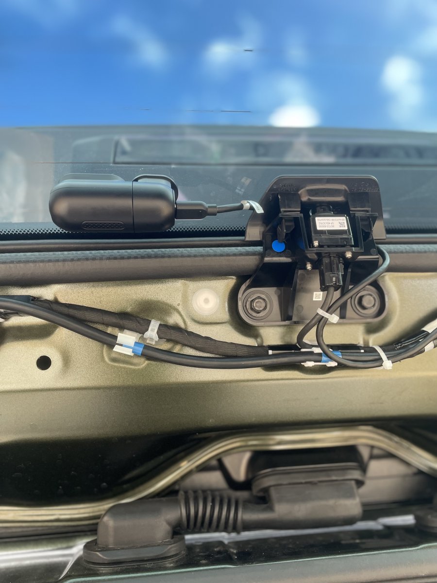

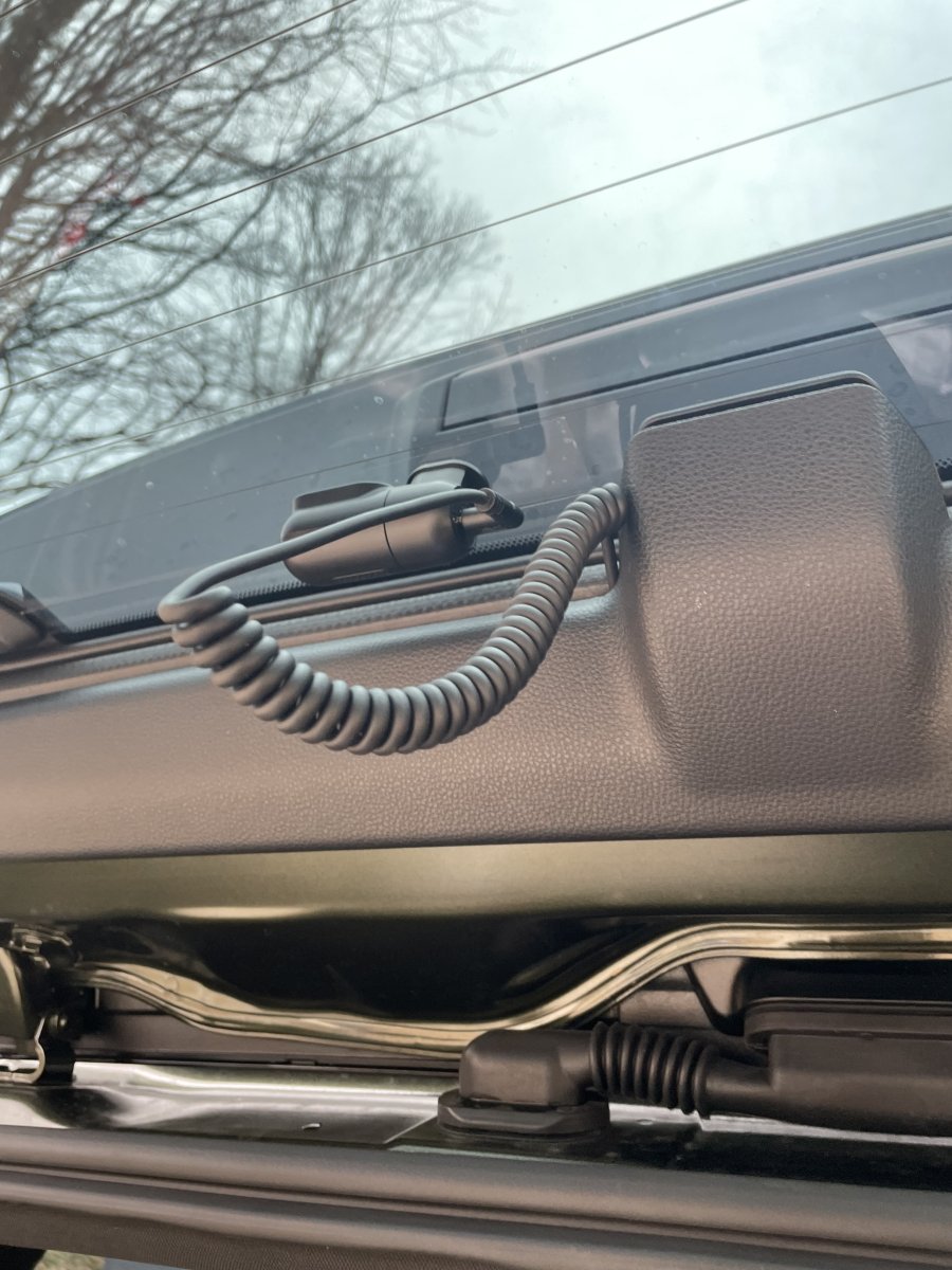

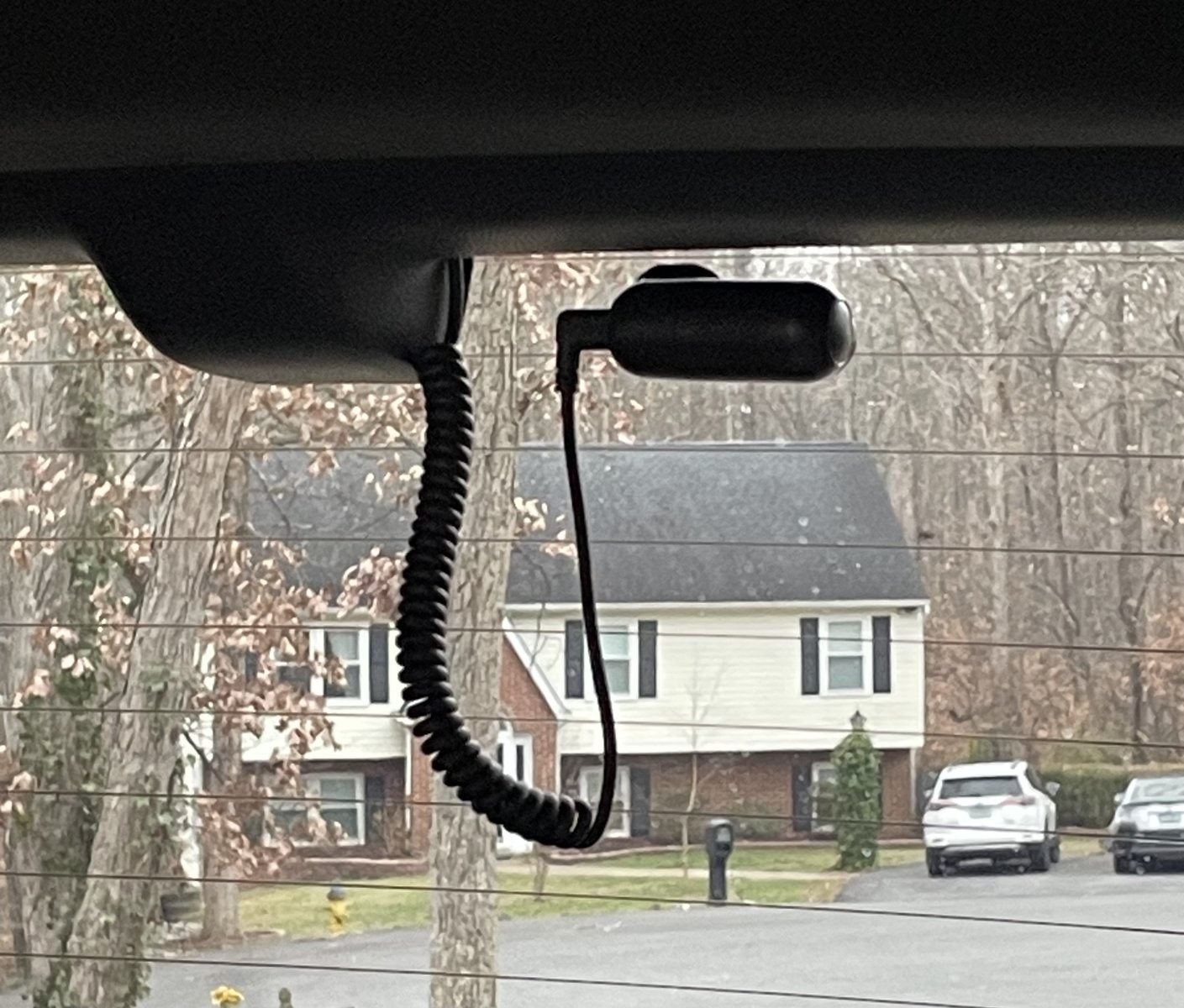

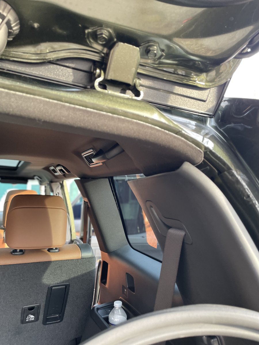

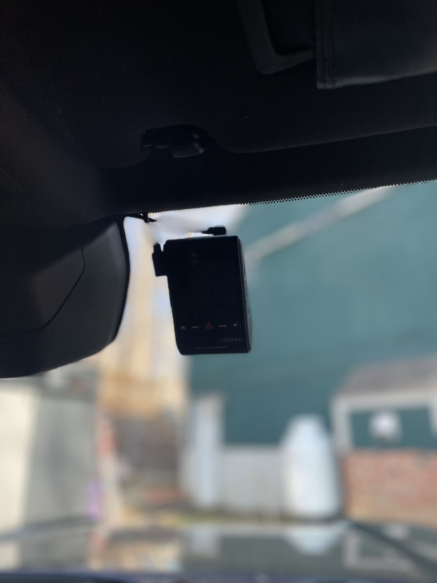

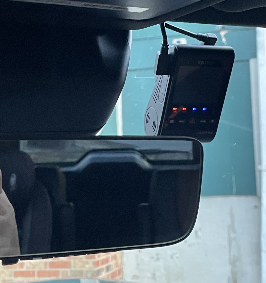

Just finished up my Viofo A229 Pro installation and wanted to share how I mounted the rear camera. Initially I purchased the 3D printed mount, but did not like how low the camera hung from the ceiling, That said, I came up with this solution to mount the camera while keeping the rear hatch functional.
I know it’s not aesthetically appealing, but we like it more than the ceiling mount and possibly hitting it while unloading the vehicle..
Two questions - How did you run the cable from the rear camera to the front one? In the middle pic, I see the 229 camera, what is the other one?

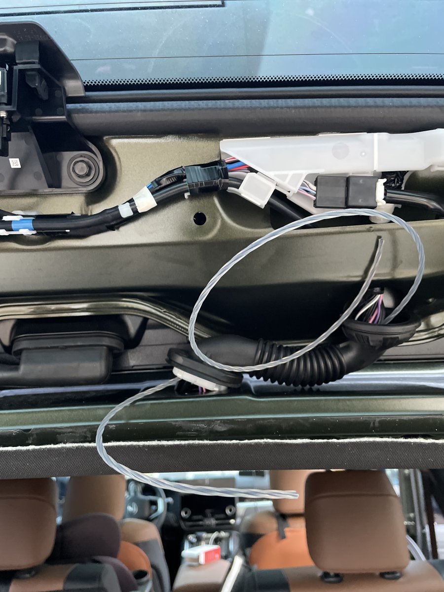

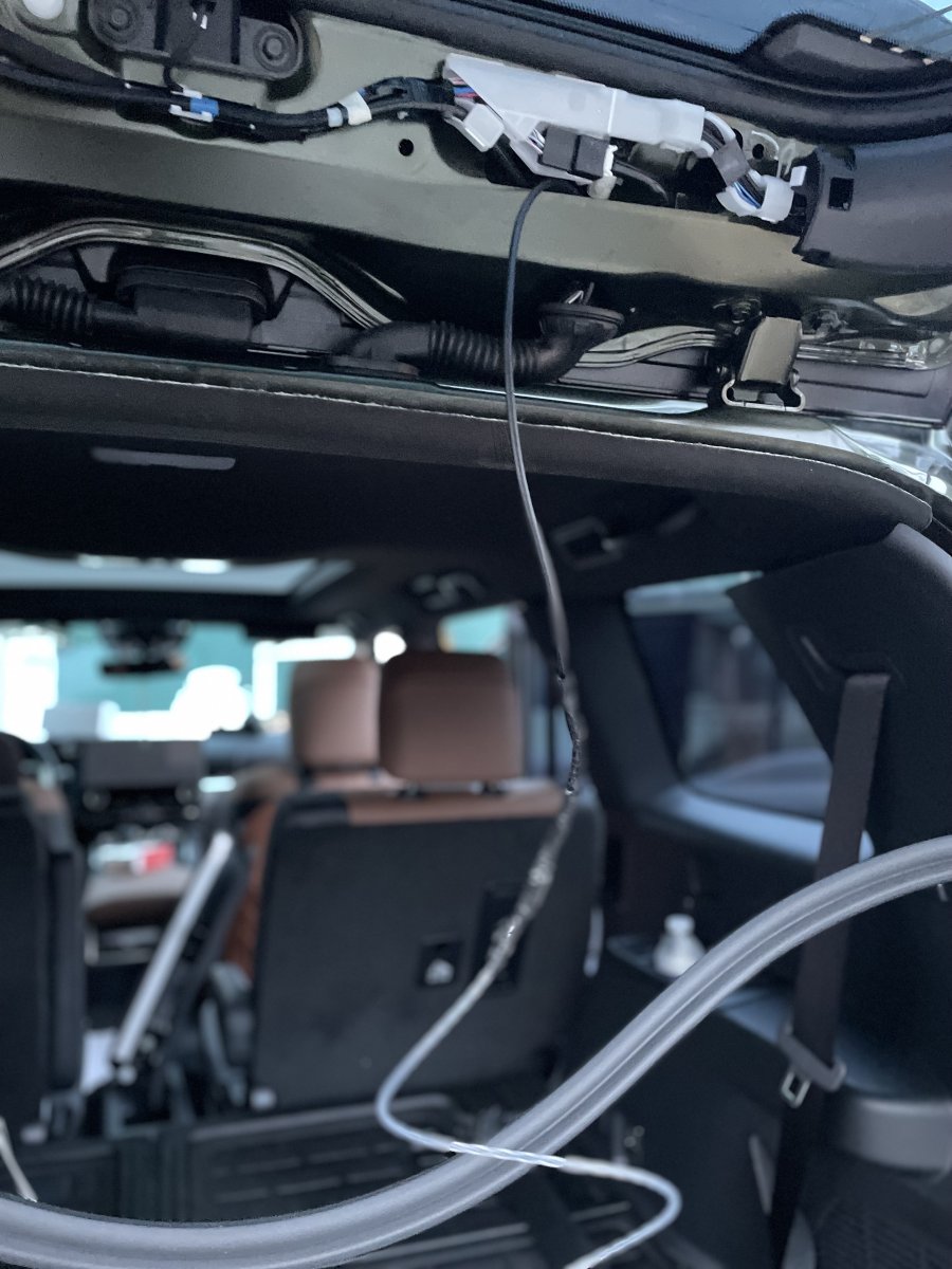

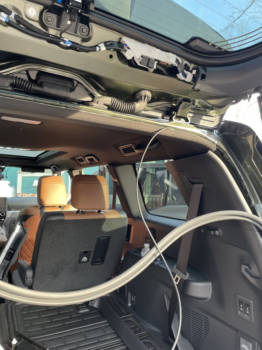

Here are some pictures of me running the cable…
Pull cable through using trimmer string. Had to us a bit of dish soap cause it’s a pretty tight fit….
Wiring before it occurred to me that I won’t be able to open the hatch lol…
For your second question - The camera in is OEM, not sure which angle it’s used for.

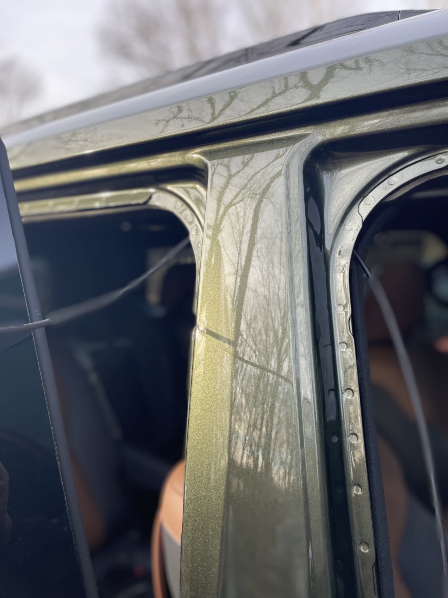

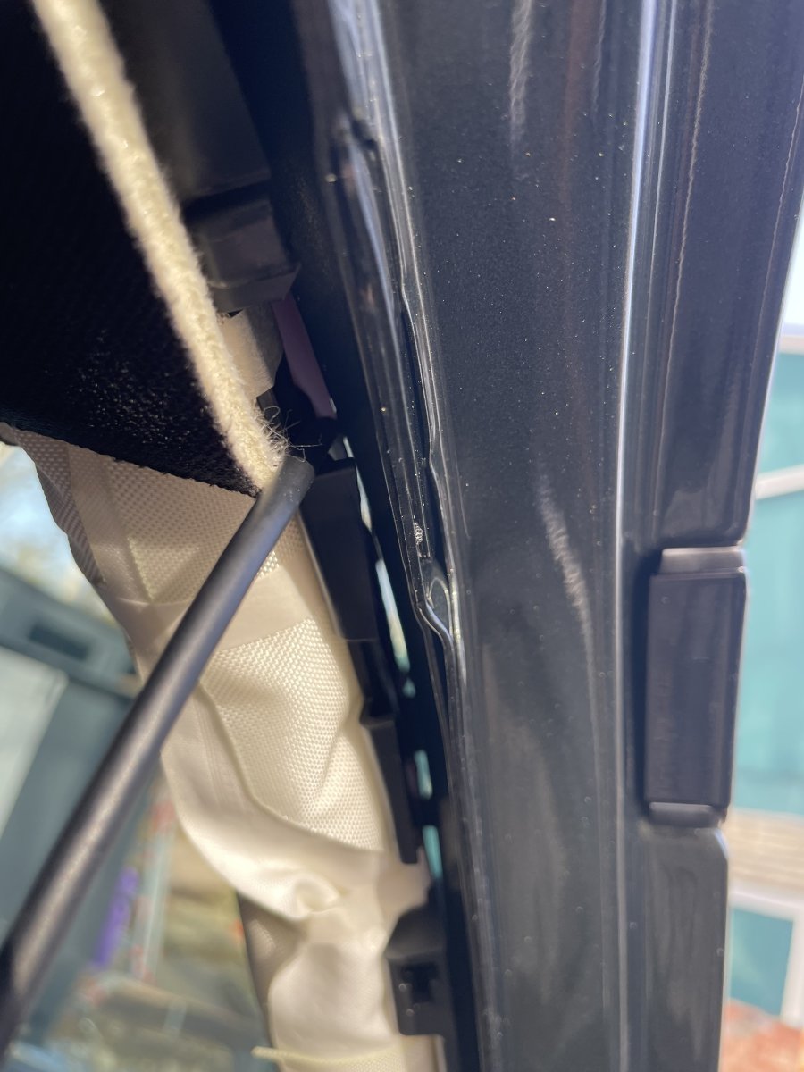

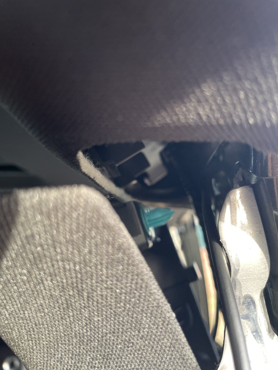

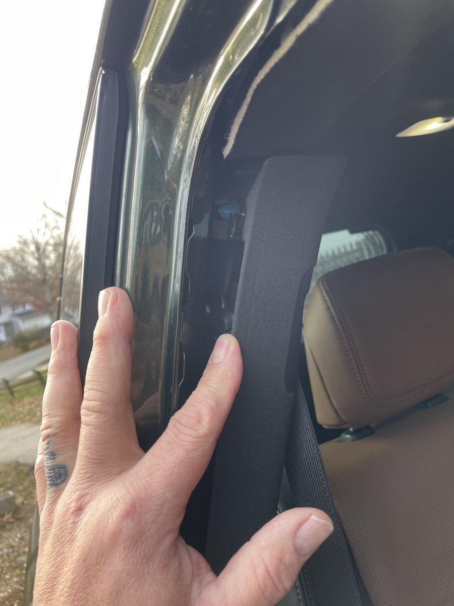

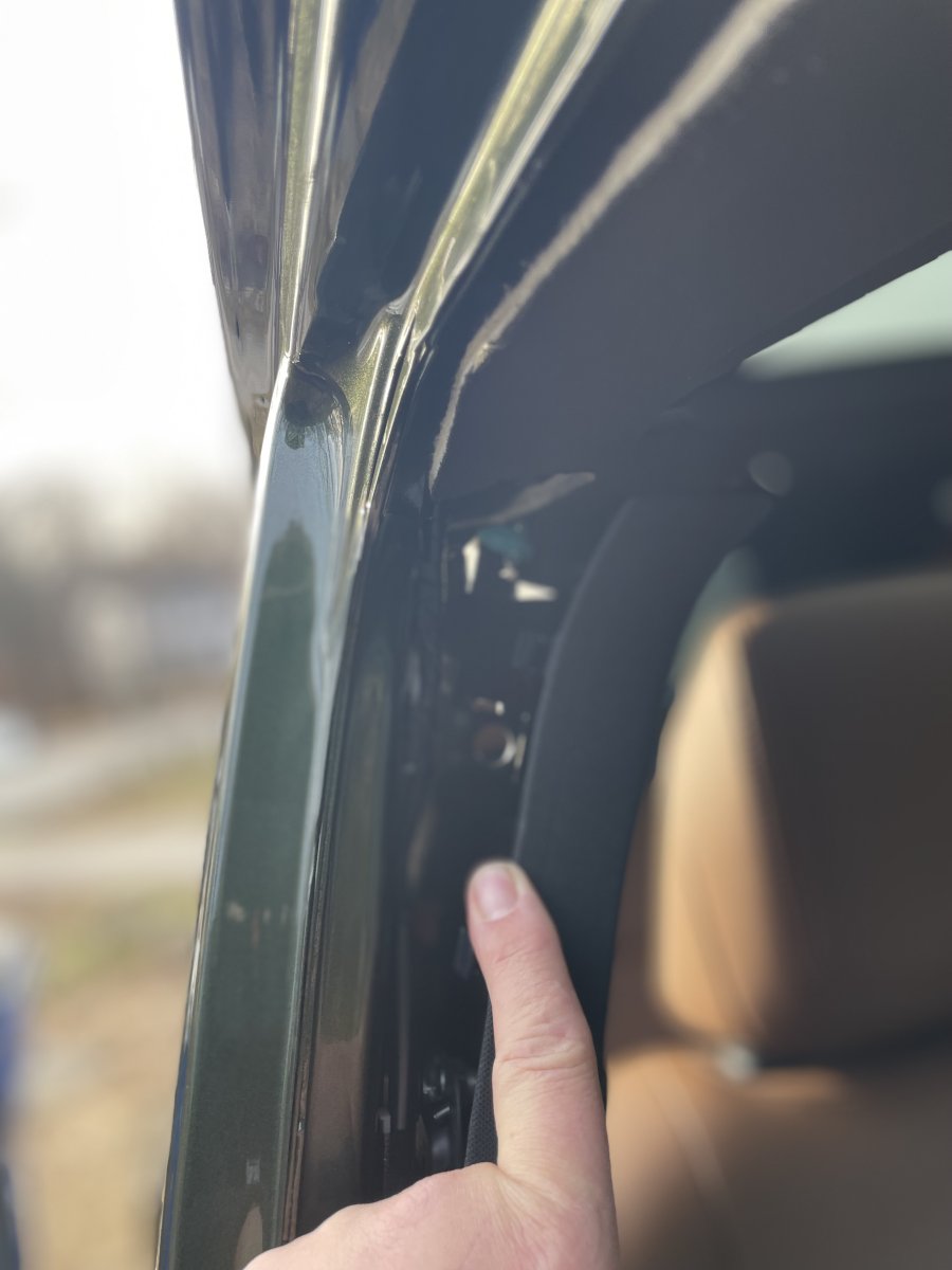

Thanks! No, I don’t have the remote. For cable management I zip tied the cables to a harness behind the air bag, then tucked it along the headliner, behind the airbag and close to the weather stripping…

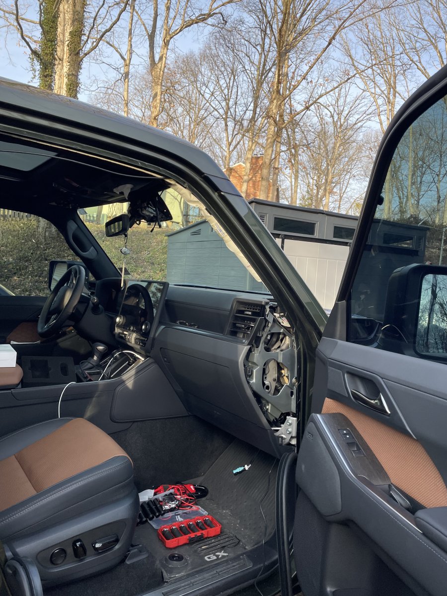

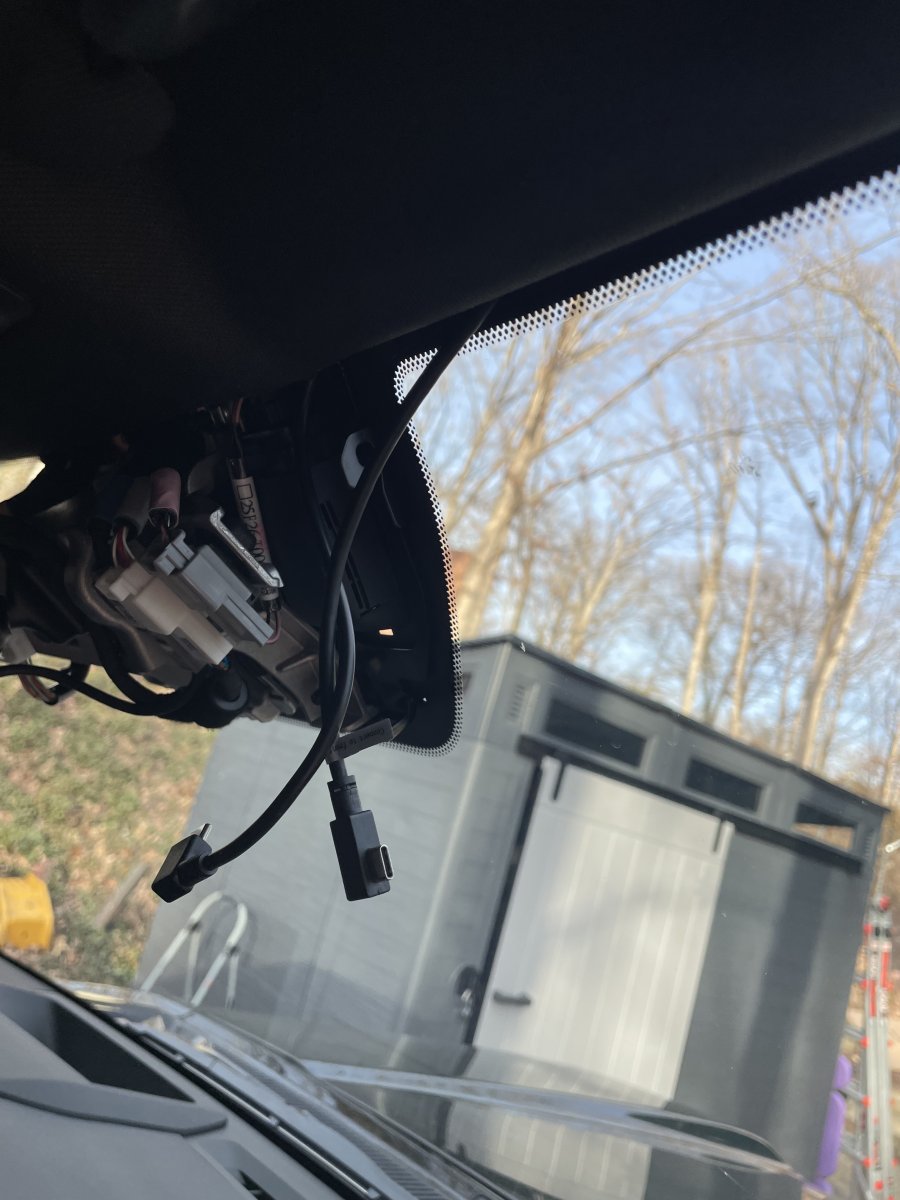

I mounted the camera high to minimize cable exposure.and ran the power to the fuse panel.

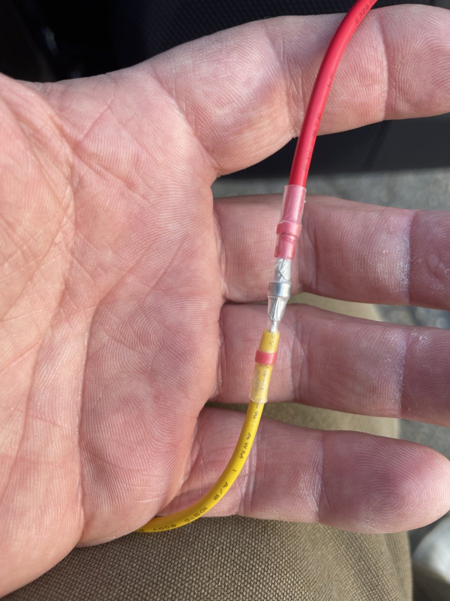

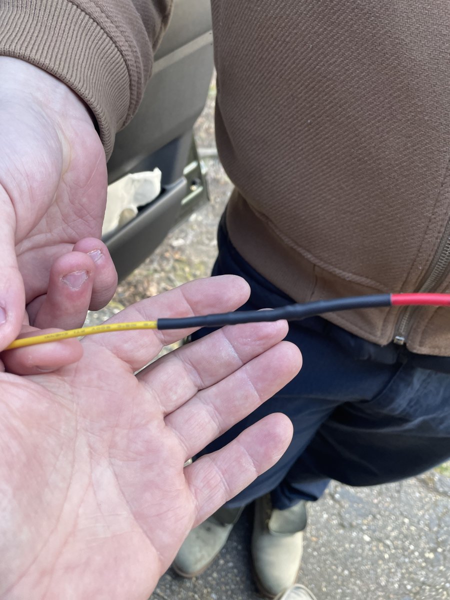

I received a lot of suggestions for tapping into the rear view mirror, but I really didn’t want a bunch of crap stuck to the windshield. I tapped into a fuse name “Open” for battery and one named “USB” for accessory. I also chose to use soldering tubes because I don’t trust insulated connectors….
Shrink wrap…

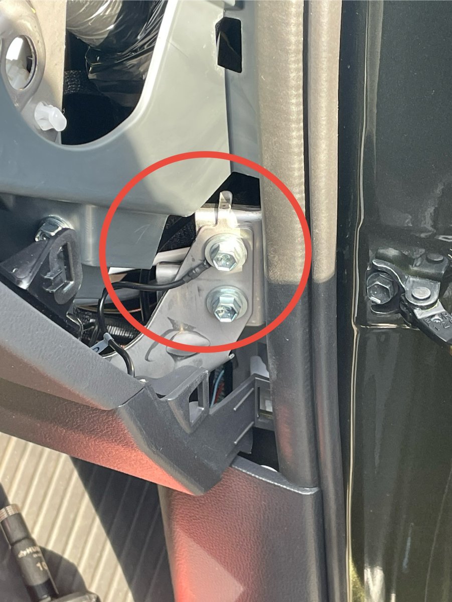

And mounted the ground here for easy access…
I had to replace few clips on the rear panel and trim. The Lexus OEM is roughly $1.93 each, but I found a box of 30 aftermarket clips on Amazon for $10
