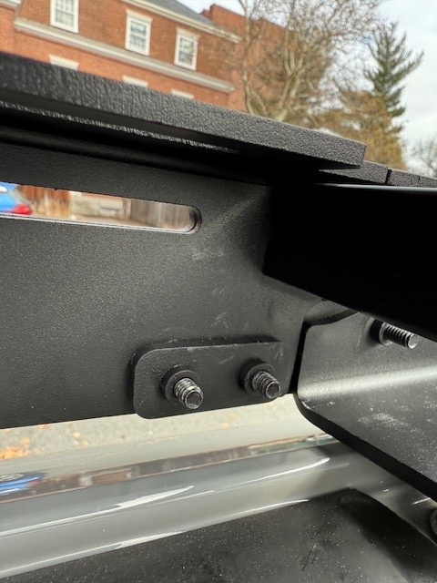

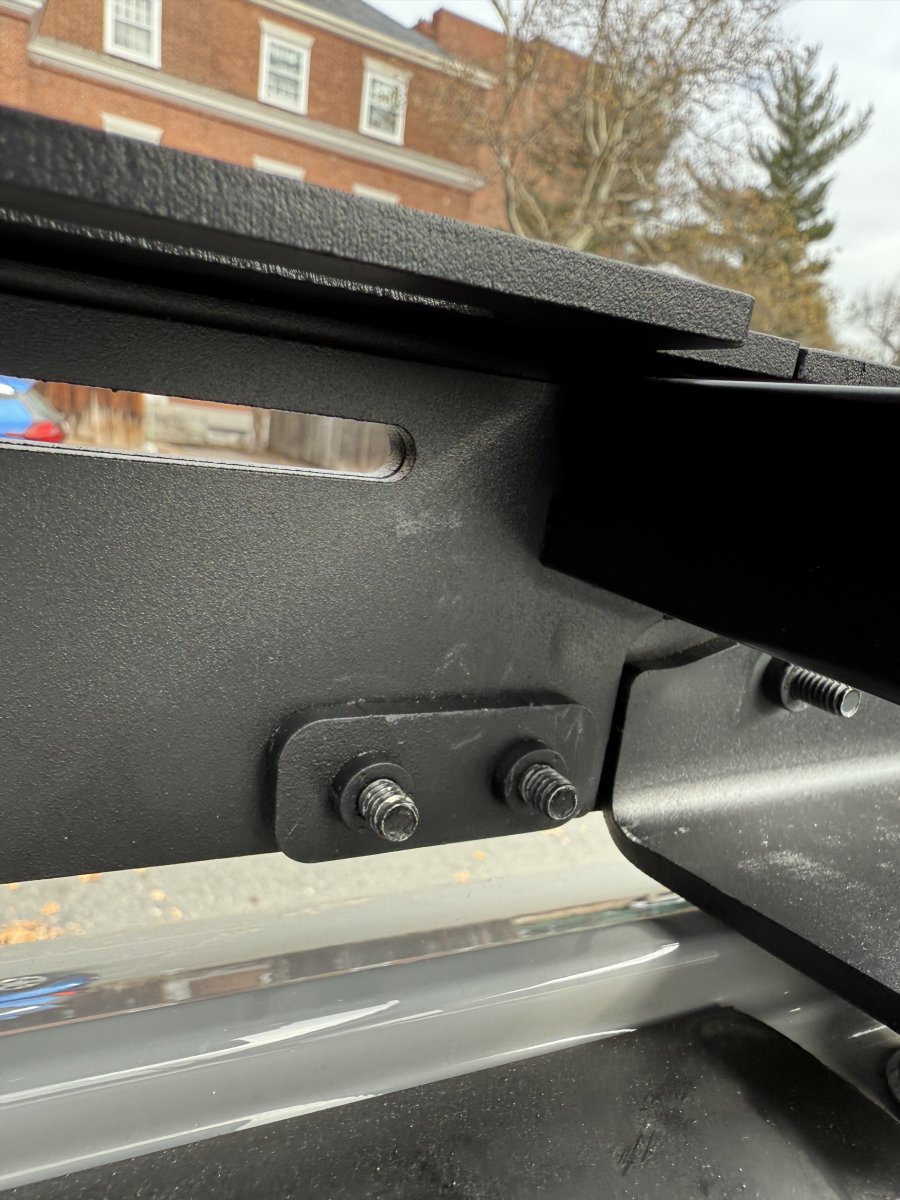

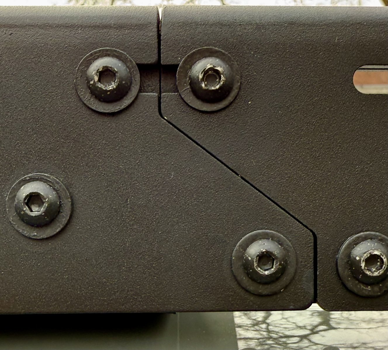

Hi @Arewethereyet - First pic is exterior view of the two rail pieces joined. Interior pic shows the joining/connector plate. You can see in external view how one bolt goes through forward piece and the other bolt in the rear siderail piece. Apologies for not getting back sooner.
When did you take delivery on your rack? I bought mine this past summer and the side rails are joined by the 2 tabs design as shown in the OP pics. Not like yours. I think the tab method of joining the side rails is sketchy as hell but I've got 6,000 miles with mine on the roof with no issues. Though it should be noted I have put very little weight on it. Just an awning and a fly rod vault.
