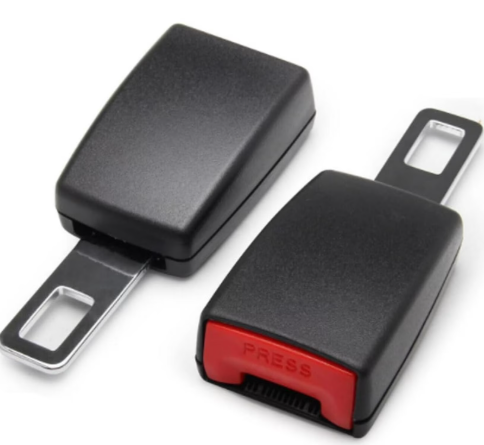

I just use those seatbelt add-ons like the ones picture below. I first bought them so that my boys could reach the seat belt buckle back when they were still in booster seats and then I realized that they were great for my seat to make it easier to reach the buckle, and they eliminate the seat belt chime as a bonus. I wear my seatbelt every time I'm on the open road but I unclip it when I get in my neighborhood and that damn chime is annoying as hell when you're just backing out of the garage, just moving the car a bit, etc.

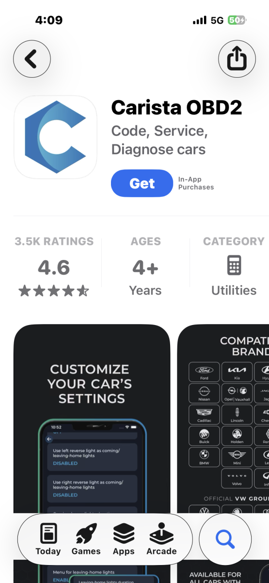

Is this the correct app?
Anything newbies should know before using? Does it connect wirelessly (Bluetooth?) to your GX upon opening the app?
Sorry for the dumb questions. I’m on a wait list and getting prepared. TIA.

The Carista app requires a compatible, high-quality ELM327 Bluetooth OBD2 adapter which you will plug into the OBD2 diagnostic port of the GX. Carista sells its own adapter, I believe, but it's compatible with other high quality adapters like OBDLink's MX+.
If you are new to this, I would advise caution and I'd suggest you do some research about what's required and how it works. The Carista app is doing dealer-level module coding and the process is not bulletproof. It is reasonably possible, though rare, to brick your vehicle when attempting to make these changes if you don't follow recommended precautions, requiring many thousands of dollars of repairs.
I'm no expert in Carista, but I have reflashed and recoded many modules in my former BMW, and plan to continue doing so with my GX - here's a few pieces of advice I have:
  • Make sure your battery is really full and in really good condition. Our cars are relatively new, so you probably won't have a degraded battery unless you never drive your car, but make sure it's fully charged by either trickle charging it or taking a 2+ hour drive
  • Minimize electrical consumers before coding. Turn off your headlights and DRLs, the Climate Control, interior lights, seat & steering wheel heaters / coolers, and the radio
  • Use a battery power supply (DO NOT use a trickle charger - a trickle charger is worse than no charger) if you have one available. I use the Noco Genius 10 in power supply mode. Coding and flashing requires a very specific vehicle voltage and will stop mid-process, bricking your vehicle module, if it drops below the required voltage.
  • Disconnect your phone from the vehicle's bluetooth and any other bluetooth devices (like a smartwatch) before coding any modules via a bluetooth OBD2 adapter. The OBD2 adapter should be the only thing connected to your phone via Bluetooth
  • Follow the guided process exactly. Read instructions 3x before executing them.
  • Once you hit the go button, freeze and don't touch anything until it's done. Don't open doors or windows, touch the infotainment, stand up off the seat, click your seatbelt, flip to another app, nothing. Especially if it's frozen and you think it might be broken. I promise it's not broken and it will finish.
I know I make it sound scary, but it is kind of scary. As effortless as Carista is, it's still executing dealer-level coding changes and that demands a base level of risk mitigation. These settings weren't meant to be available to consumers, so the process to change them doesn't have the safeguards most other settings have. There's a reason dealers hate flashing & coding modules - it's because each of their techs is going through this entire rigamarole and clenching their buttholes every time they hit the go button.
Can you provide the link to yours?

Thank you VERY much for the detailed response.
