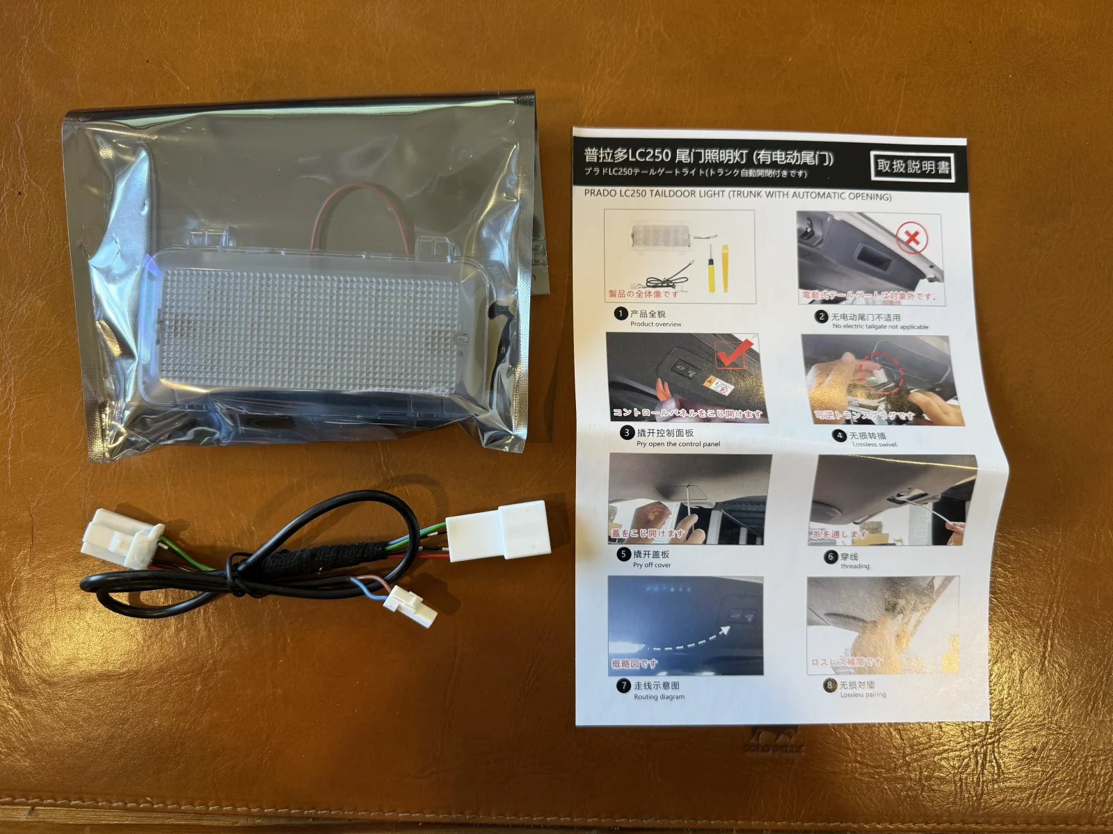

I bought these. The 2 tailgate lights have arrived and I'm still waiting on the single center hatch light. Was going to install all at once but the center hatch light may not be here until March so I think I'll install the 2 lights. I'll post the results up here on this forum. They should be great for camping.

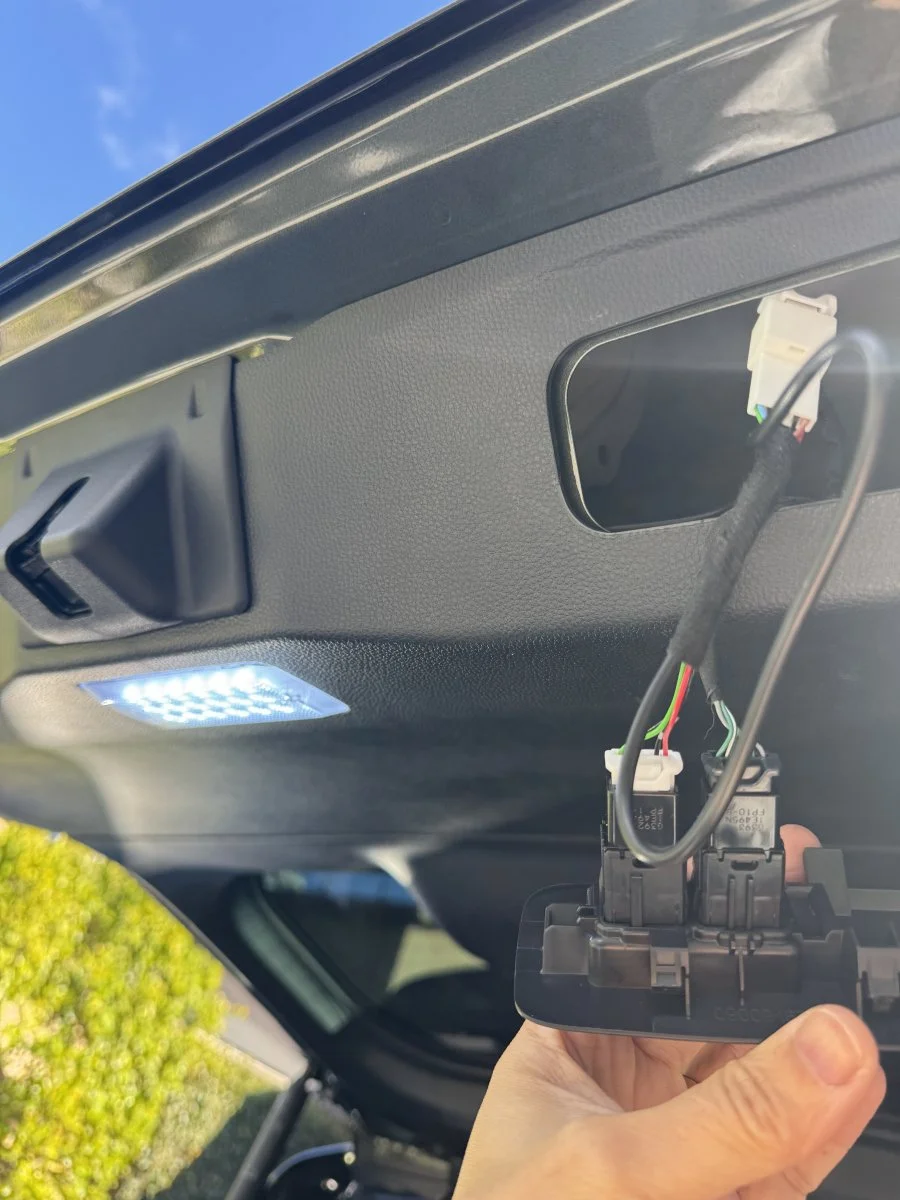

I installed the cartrim hatch light today. The install is actually way easier than the video on cartrimhome’s website. All you actually have to do is pop out the light placeholder, pop out the control panel for the tailgate, connect to the wire harness there, fish the wire over a few inches to the left and install the new light. Literally takes 5 minutes. Highly recommend. The video on their site was shown with a vehicle without an electric tailgate which is a bit bigger job.
Here’s the photo of the connection with the included Y-adapter and the approximate distance you have to fish a small wire through. Takes about 5 min for the install.

Yes, this turns on/off automatically with the tailgate,but can also by dimmed, brightened, or turned off when the tailgate is open.
@YellowLab has the right kit from amazon (and is the same as the one I got from Cartrimhome). They are all from China based on the included instructions. I think they just figured out an easier way to get power or they only had a non-powered tailgate version when developing it. The 1958 LC version doesn't have a powered tailgate and needs to run the cable to the driver rear light.

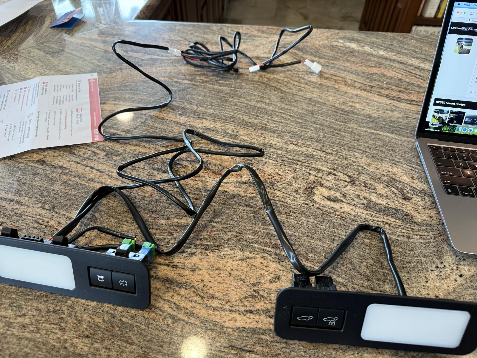

How did you connect power? Ive bridged the left to the right then there is one long cable for the left light that attaches to another cable with two connectors (at the top of the picture). Is there a power cable inside the door that I have to tie into? Or do I need to run a cable from the compartment by the jack and bring that into the tailgate?
