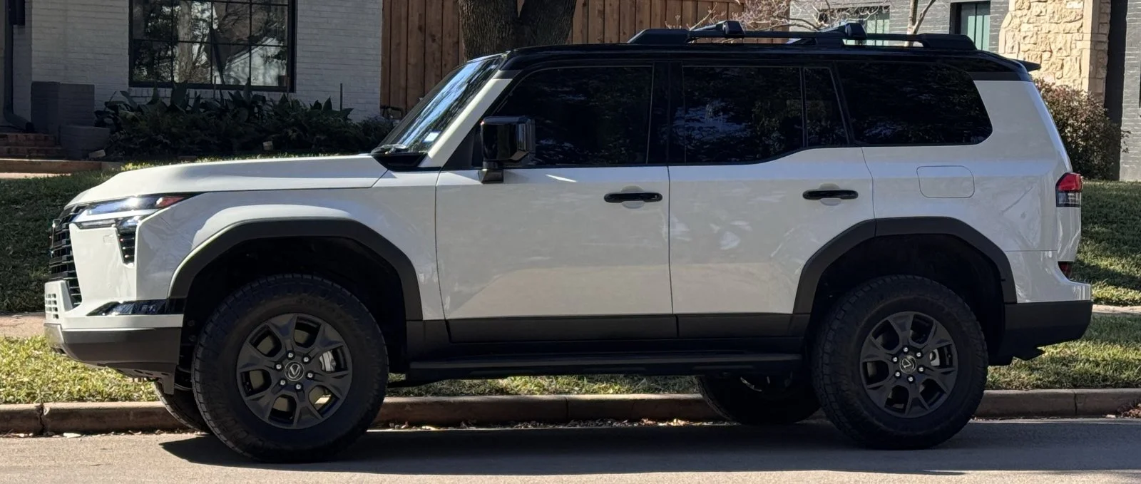

Ah, I never considered for aesthetics. My OT+ is white, but a gloss black roof would look cool.

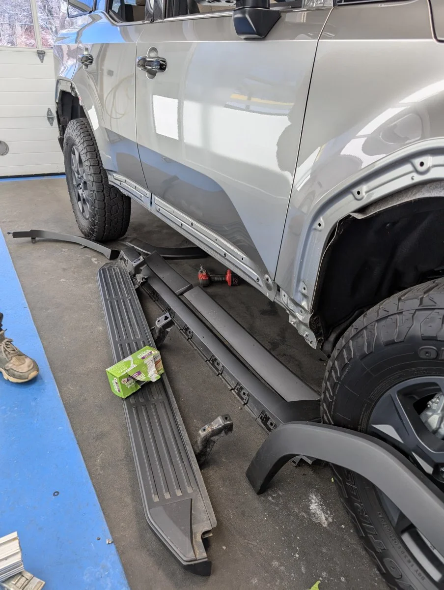

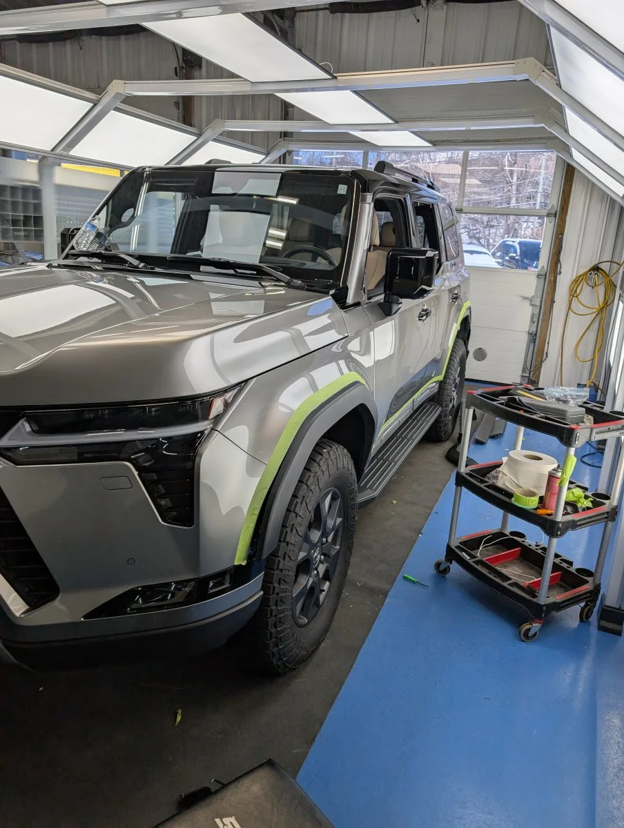

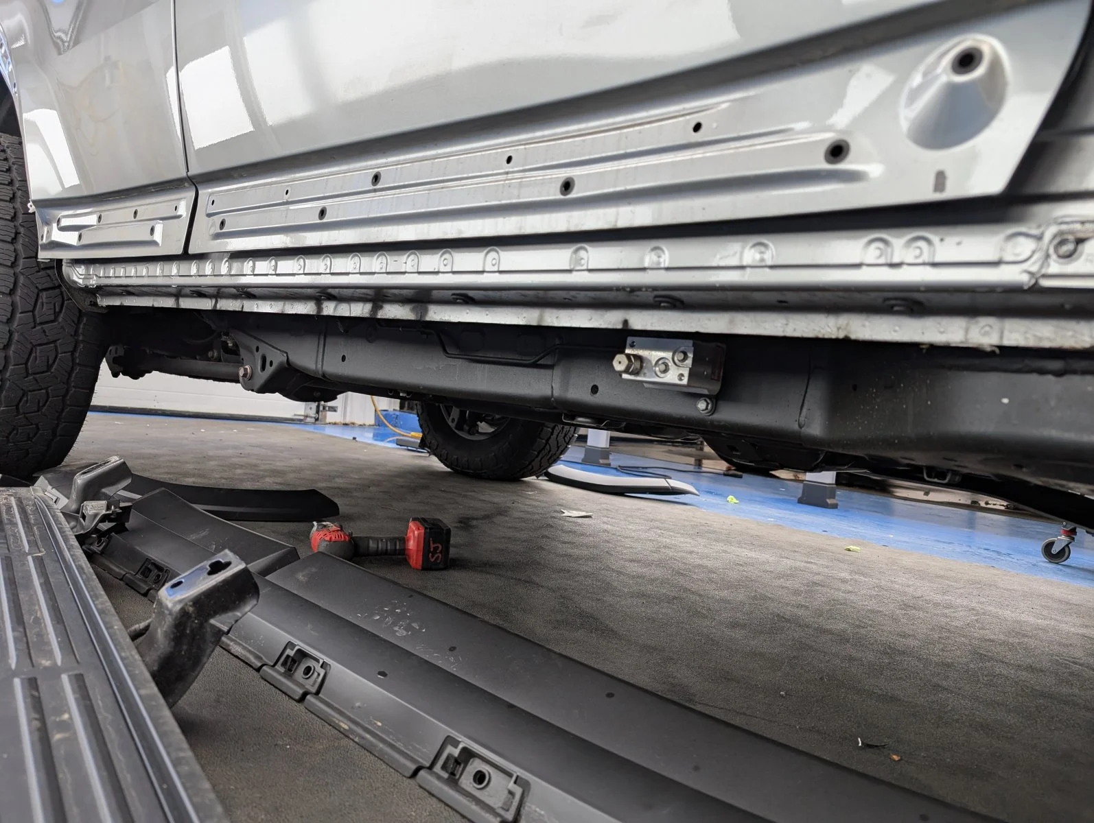

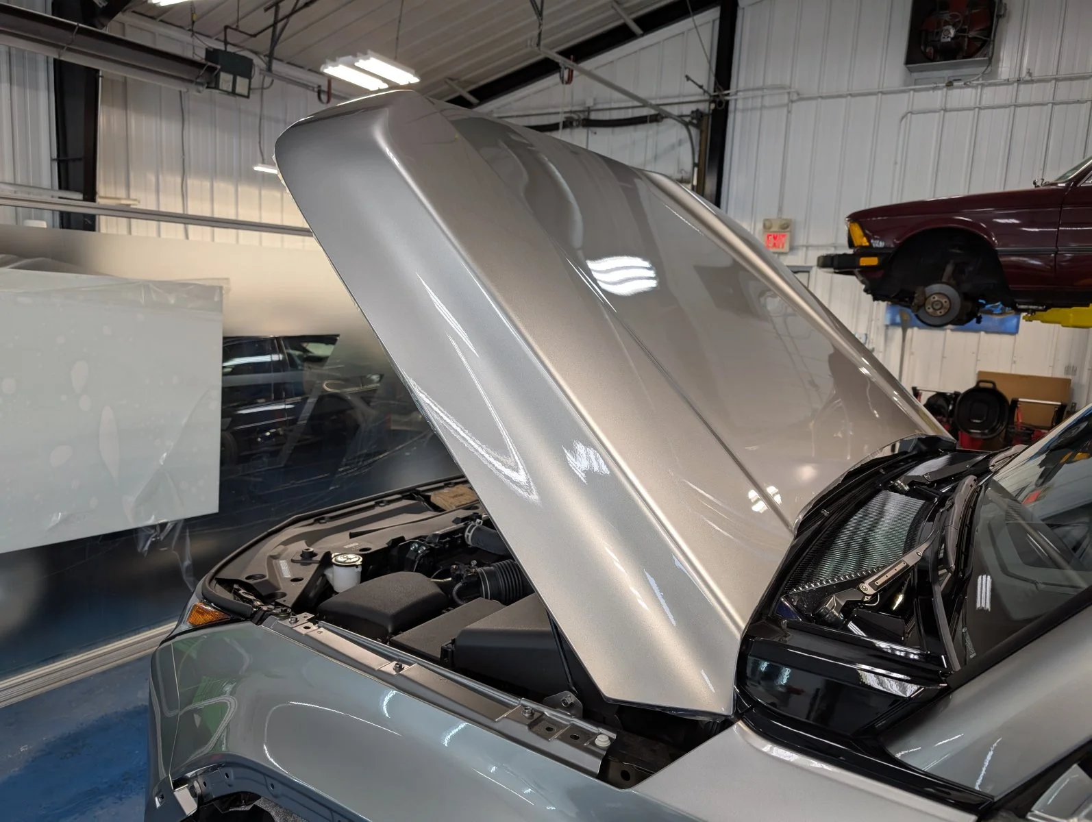

I am jumping in on the PPF. Never had before as all prior vehicles were used and 15 years old. The GX OT is new and will get some light use exploring dirt and class IV roads in New England. These often have a few spots where you will have a few branches and tall grass/saplings that touch the sides of the vehicles. There is a new XPEL optical clear PPF that has some self healing properties that will blends the light pin stripes over time with heat from the sun. Material is UV stable, hydroscopic with a built in ceramic top finish. For road rock dings, parking lot gentle door touches and trail scuffs this will be great and I'll feel more inclined to use it. Lastly NE winter road grime.
As for the Lexus installed ceramic, I would highly recommend NOT getting it. I did and the water beading was awful. I had a professional shop wash the car and they confirmed what I was seeing. Unfortunately my local dealer uses a different product than the dealer I purchased from 2.5 hrs away on LI. If they actually applied it, I do not want the product again. If they didn't, I now don't trust them. The warranty only covers for damage (after the fact issues) AND was only good for a maximum of $2,500. If you have a problem it will be to late or way more than that amount to fix. So I say go to a professional shop on you own pay a bit more and get a rear ceramic coat job done properly. Lesson learned on my end. Also, the dealer, detail shop and claims team had no recommendation on how to test if it was even applied other that saying the water should bead off the car. I can tell you it is not covered under paint protection plan and the dealer won't credit you back. Best case they put the same junk back on.
Mine came with (very expensive dealer applied) PPF. I wouldn’t have bought it on my own. All my trucks get pin striped off road. This PPF will protect the front end from rock chips and highway debris for a while but I think it’s ugly. On my white OT you can clearly see the PPF on the front end giving a dull appearance to the finish. When the PPF starts to yellow (as it inevitably will) off it comes. It’s already separating around the headlight edges. I think I’ll take it back to the selling dealership and make a huge issue out of it since they fleeced me for thousands with the dealer add-on fee.
Agree on the dealer PPF. I was at least warned by the dealer that the factory PPF on the front edge of the hood would show a seam and discoloration over time.
The shop doing my atomic silver GX is called Straight Jacket in CT. They will likely have a media clip on line of the work that is underway now.
I requested to have the plastic fenders, lower door trim AND the tailgate horizontal plastic light bar removed to have a separate film layer put down under these bits to create a shingle effect for water run off. After seeing the truck with these parts off it will definitely be a rust concern for any of us who deals with that. If you have washed your GX by hand and then towel dried it, you can see all the plastic seems allow the water to run off behind. As such, the salty brine will also drip in there and collect. Hard to know, but I think in 10 yrs there could be rust damage that goes unseen under these plastic trim bits even with regular washing.
The PPF shop noted this was the first time a customer requested such a thing be done but agreed it definitely made sense in the rust belt areas if you drive year round.

Man.....you are even more anally-retentive than me, and that's saying a lot!
I have noticed that the areas behind all the plastic bits on the tailgate hold a lot of water after running through the car wash. I go through a TOUCH-FREE car wash (don't ever do the rotating brush car washes!) and I pull into a nearby parking lot to dry the truck with a clean microfiber towel each time. The car wash has the big blowers but they leave a lot of water all over the truck, especially with the roof rack. First thing I do is pop the tailgate and leave it up for a couple minutes as I start to dry the rest of the truck. Then I close the tailgate and there is surprising amount of water that flows out when it closes. All that water is up under all the plastic trim across the tailgate. Then I dry the tailgate and of course have to pop the back window open and then pop the whole tailgate back open to get all the behind-the-scenes areas by the struts. Then close the tailgate and dry the outside again because more water drained out again. Then repeat this process until I go absolutely insane.

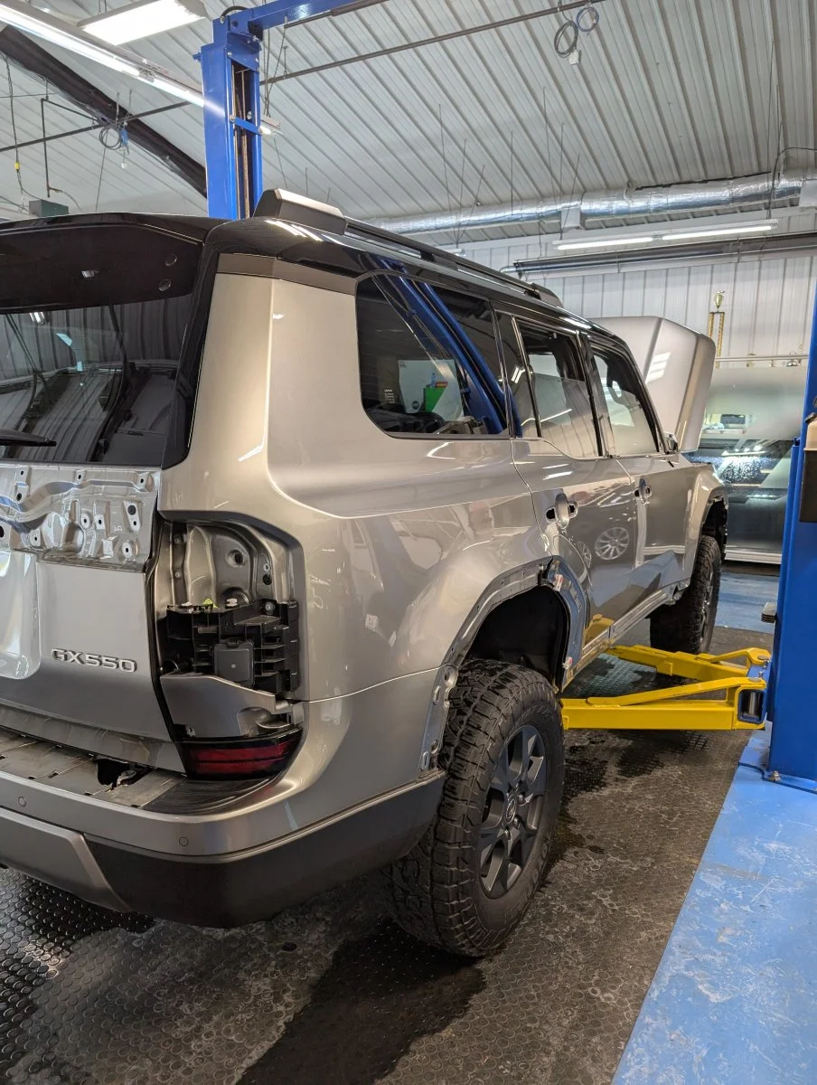

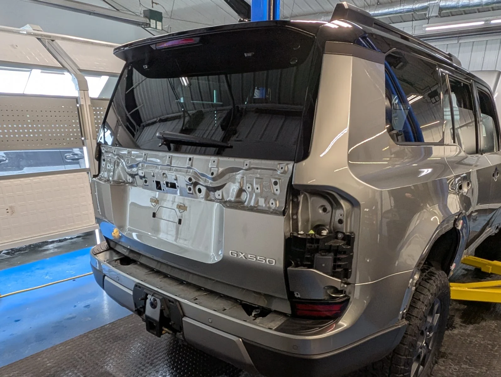

So on my last check in the shop had the rear gate cross bars light off. I was surprised to see that the painter strip of body color above the light comes off with it as well and is likely painted plastic. I didn't see the parts as it was in the truck, but the gate with the light bar looks as shown in the photo. Shop also removed handles and mirrors. Very stripped down and still looks good. Hood photo has PPF on it but not wrapped around edges yet. I am having a bit of silicone run on the top edge of the PPF that will be under the plastic light bar to keep any water trapped from getting under the film. Also asking to smear some under the fender lips for safe measure.

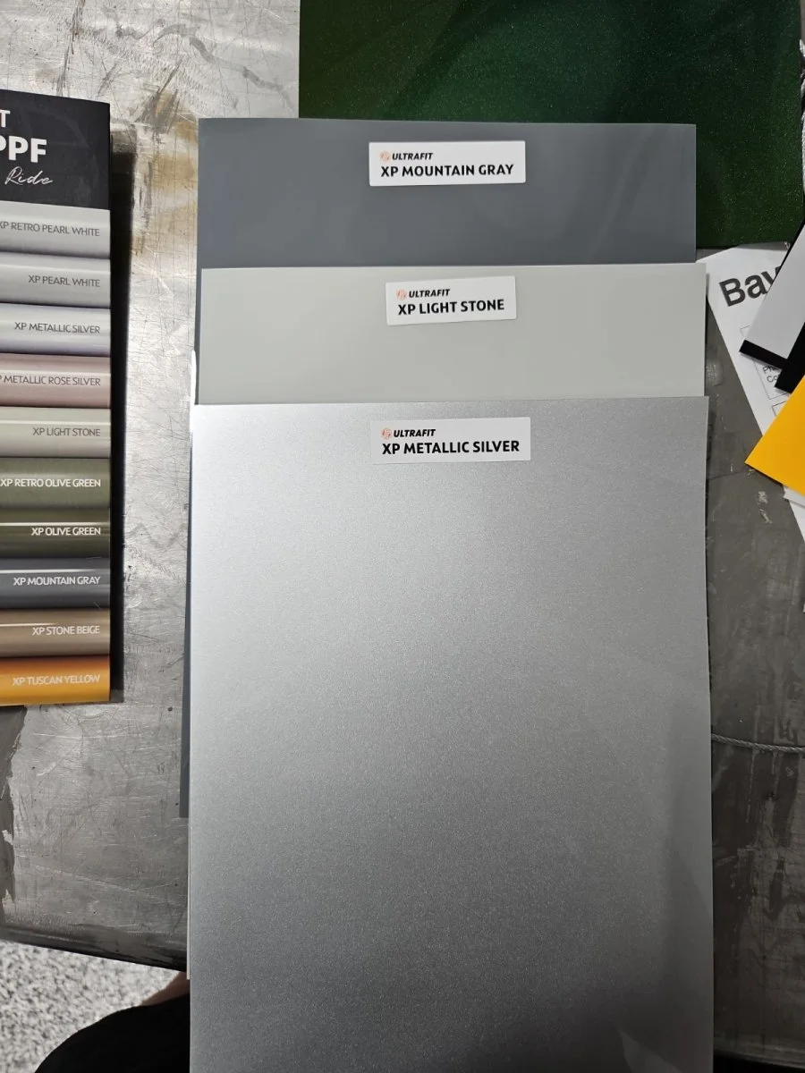

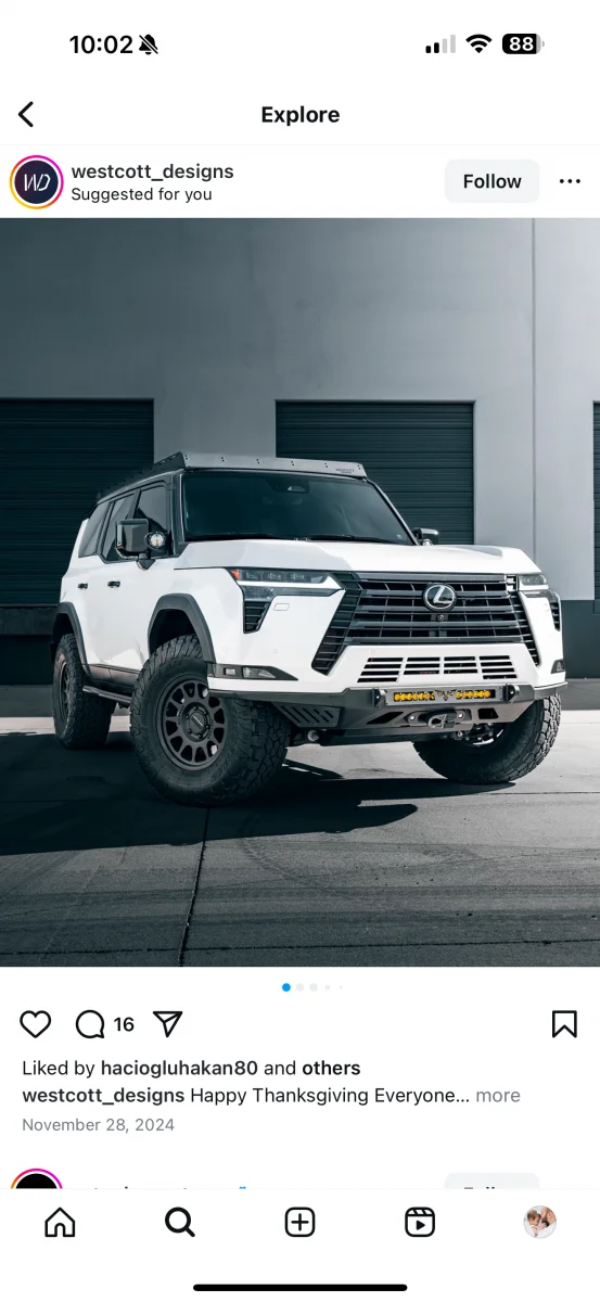

I immediately added full PPF on mine for 2 reasons. 1. I drive on the highway where lots of bugs like to die on the nose of my car and 2. I changed from the pearly white Lexus color to a light cement color instead. (UltraFit XP Light Stone) The light grey looks very different in every light, but always has the gloss matte look. I also color changed the roof to black. Love it. Looks really white in this pic, but it's very light grey...
I recently added the Westcott Leveling lift and it made me love the car even more. I am getting the Method 703s and 35s soon, mostly because I look at @Bluegill truck and it makes me want to toss more money into this. ha! The lift firmed up the ride a bit, but assume the wheel/tire change will soften it back.

Aren't gloss and matte two different tihings? Do you mean gloss but non-metallic?
I think the discussion here is about PPF which IMHO is different than a color-changing wrap.
Sure, non metallic is better way of saying. It is PPF whether it's color changing or not. If i was doing the entire car anyway, then went ahead and worked on color too.
