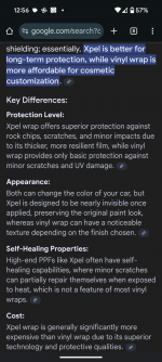

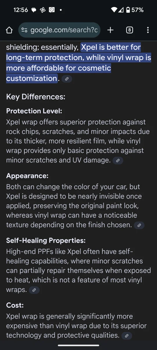

Found this on line.
Mine is a PPF and not wrap.

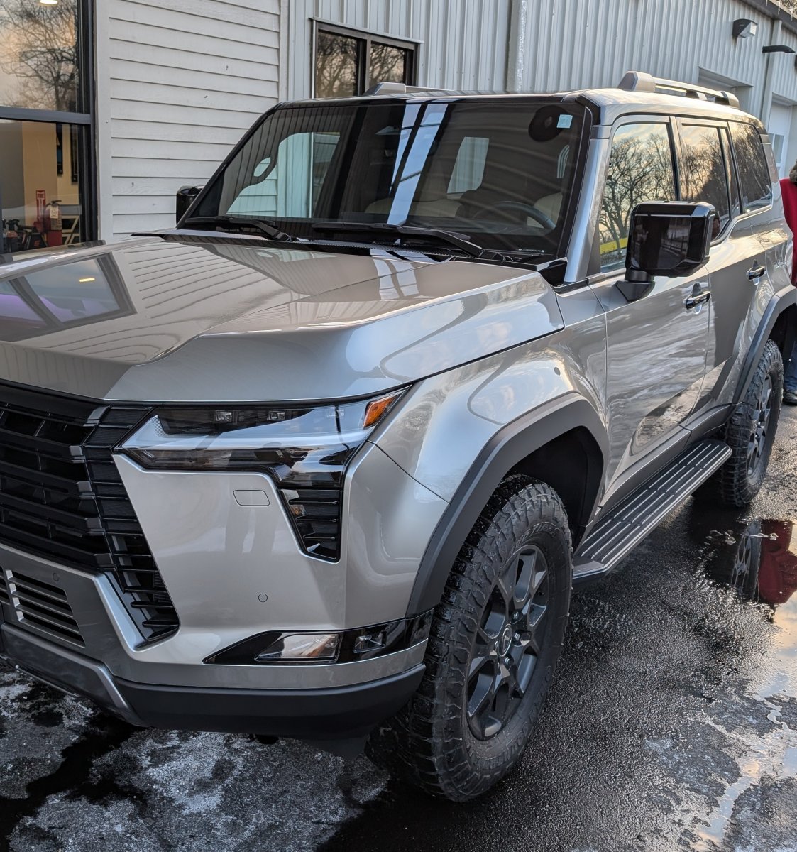

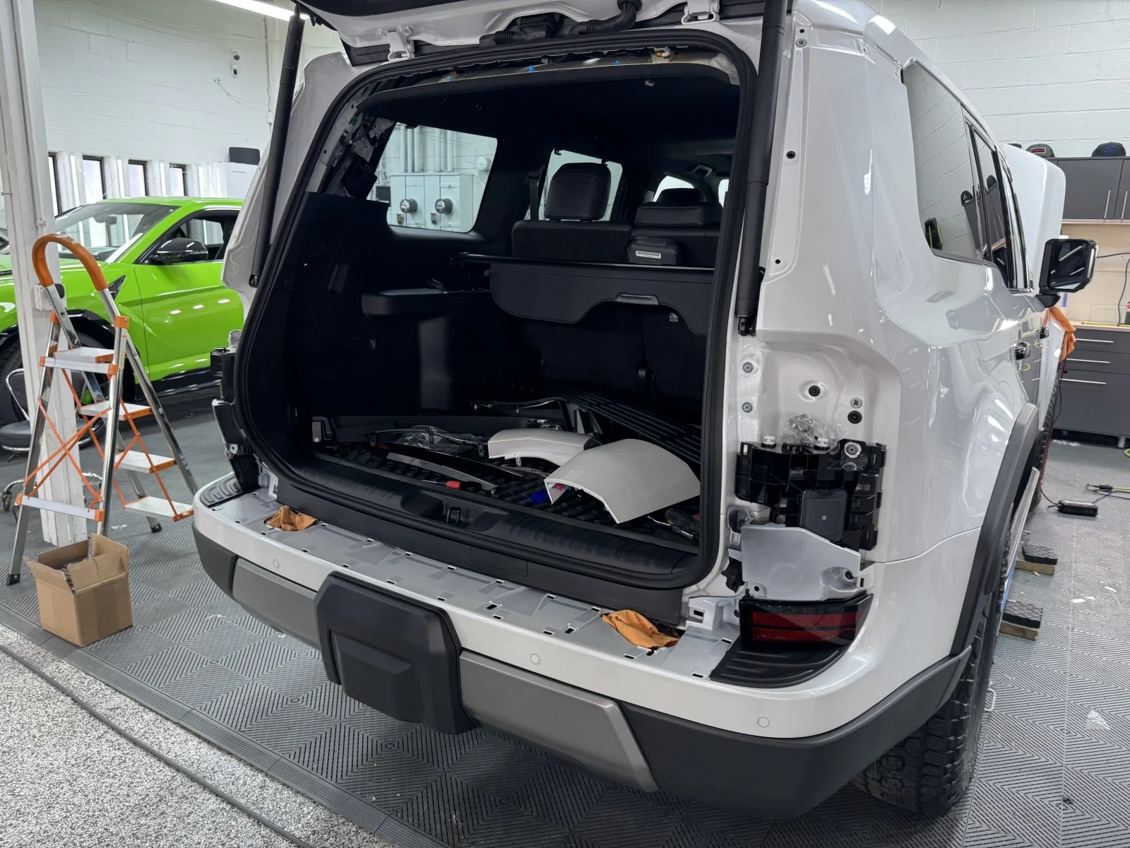

I always PPF due to the crazy amount of highway driving. I have a 10yr old BMW that still has SunTek PPF on it and it looks AMAZING. No chips anywhere, it was money well spent! I took the GX to the shop with 60 miles on it do front PPF, door cups, pillars, and black roof. Xpel now offers black gloss PPF that looks like paint and matches perfectly with the rear spoiler.
Every installer is different and each uses different brand materials. You get what you pay for, plain and simple. If installers are still using blades, it should only be limited to bulk wrap sections where corners are tucked and hidden away. Everything else can be made in a pre-cut pattern and extended to wrap around edges.
Taillights were removed to get the rear bumper edges all hidden. Headliner was dropped to remove roof rails in order to do the black top with no seams or white paint showing through.

If you go the route I did there are no visible seams any where but on the head light lens edges. Just picked it up today from a shop in CT call Straight Jacket. They did a great job.

Yes, costs a boat load but will hopefully ward off the rust and scratches. Total was about 8k. Would have been a bit less without trim removal and extending film but at that point the extra is well worth the protection in the North East. The film has a 10 yr warranty as well. After doing my own rust repair on our 80 series LC, and buying a used upper tail gate for swapping to keep it "hole" free, the cost of preventative rust protection starts to make sense if you plan to keep your ride for 20 yrs like we often do. These GX's are limited so finding bone yard panels will not be easy or cheap once out of warranty. After seeing the dirt and grim on the fenders and door bottoms behind the plastic with good cleaning effort, I would expect rust in these areas to go unnoticed until it's likely to late. Hope this helps other owners with some insight.

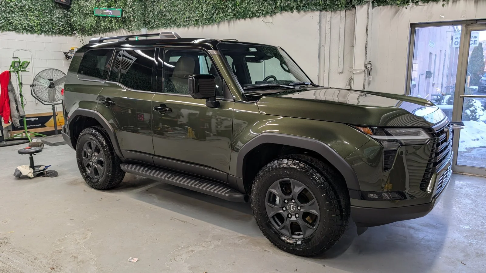

PPF around the entire front, doors, and pillars. Ceramic coat over everything as well. This is probably the cleanest the GX will ever be.
