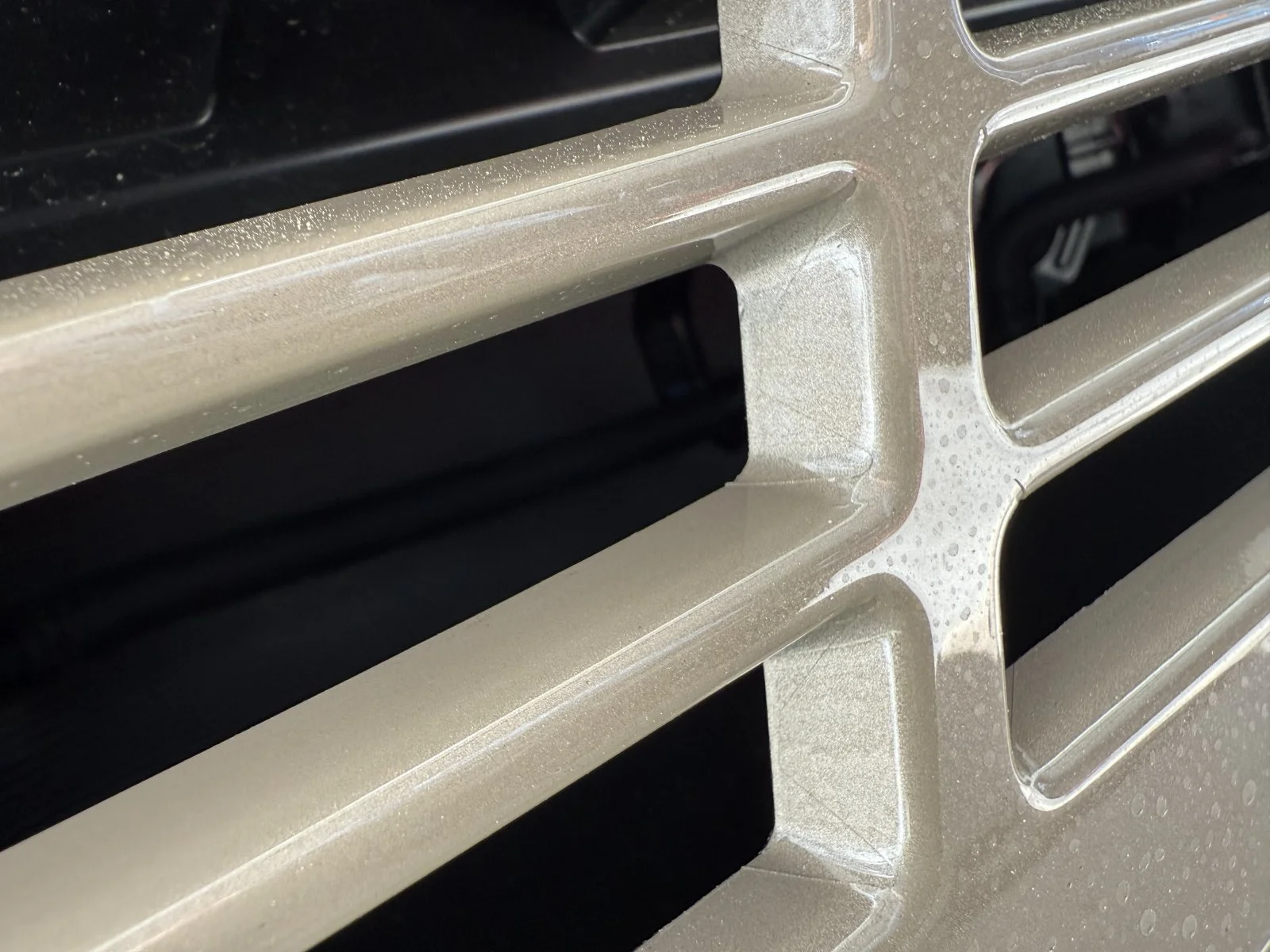

Not sure how well you can see it in this picture, but those slits below are covered and you can tell where they’ve made incisions. It’s not 100% but I’d say 90% of that opening and the inside of the opening is covered and the only exposures are on the sides, which I’m OK with.
Thank you for that. I'm going to have to see if they can do something similar. With mine being Nori I think the seams should be mostly invisible.
I think it will be more apparent but you'd have to really get down there to notice those cut incisions. It's not like its a line running across the hood, and I am not sure how much better of a job you could do with an area like that.

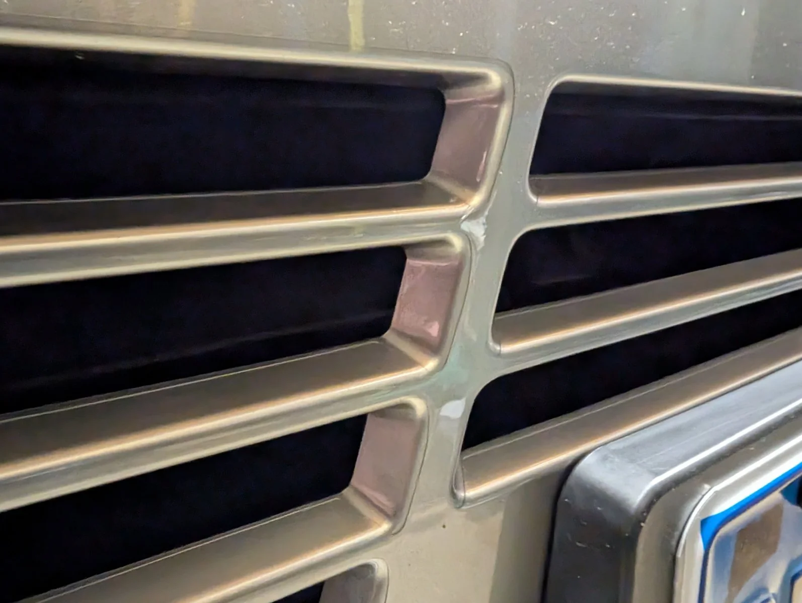

My PPF was done similar as well. Looks like they covered the upward facing part of the grill slot and the webbing. It noes not look like they folded any material on the vertical slots.

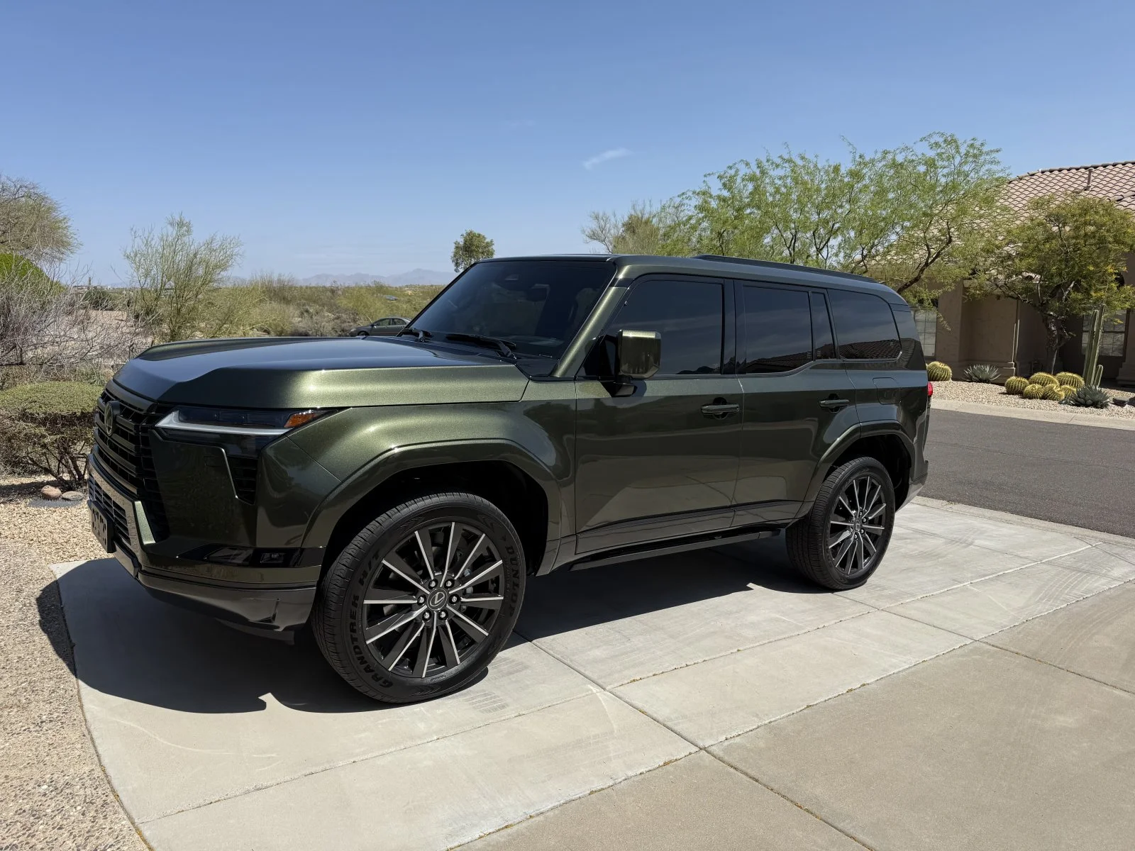

Mine will never dirt, lol. Front end all PPF, Feynlabs ceramic, Xpel windshield protection. Best urban vehicle ever.

I thought the same but mine is dirty and needs a bath soon.

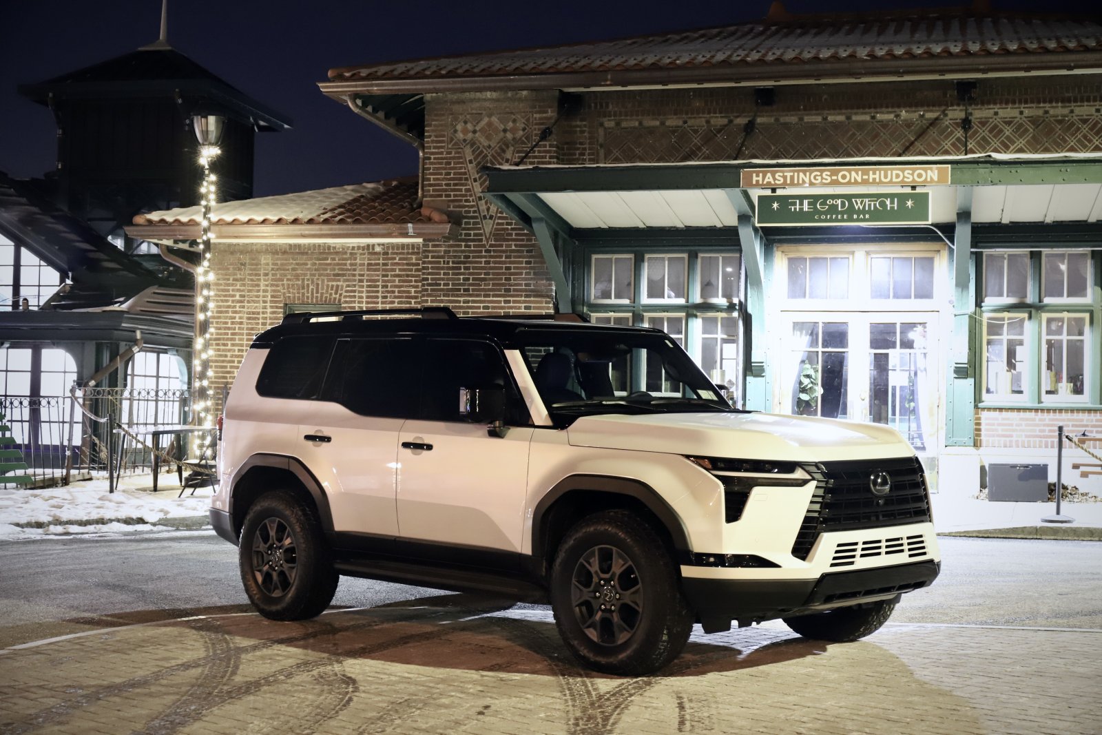

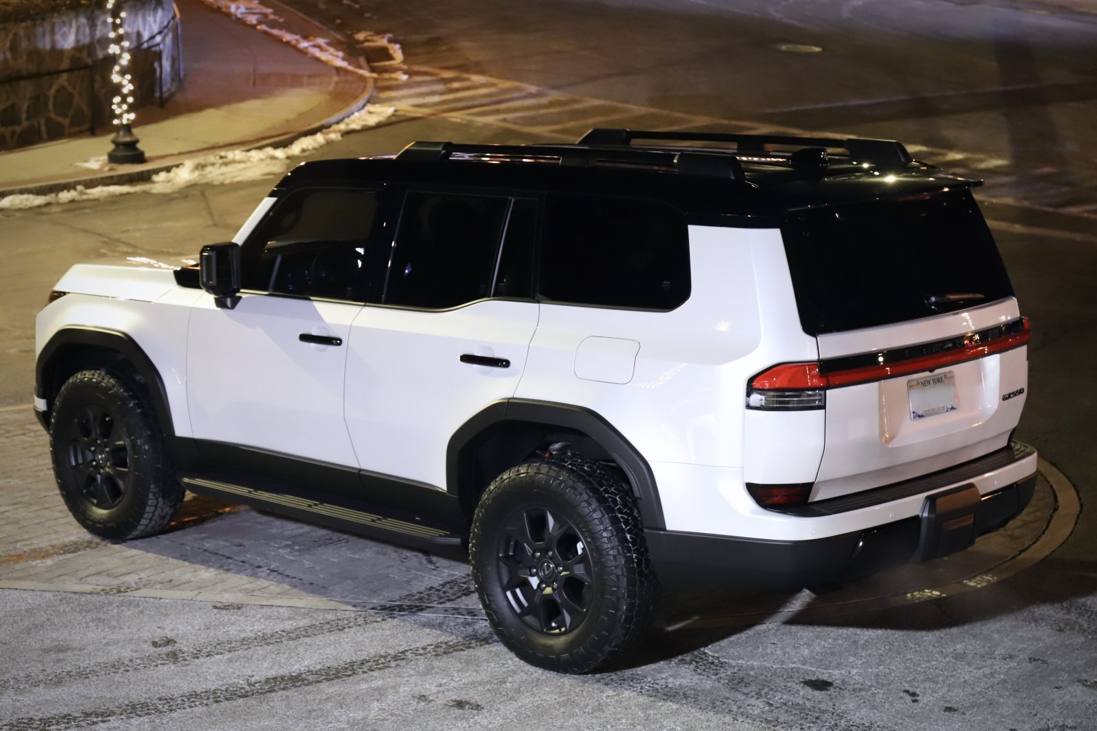

I always PPF due to the crazy amount of highway driving. I have a 10yr old BMW that still has SunTek PPF on it and it looks AMAZING. No chips anywhere, it was money well spent! I took the GX to the shop with 60 miles on it do front PPF, door cups, pillars, and black roof. Xpel now offers black gloss PPF that looks like paint and matches perfectly with the rear spoiler.
Every installer is different and each uses different brand materials. You get what you pay for, plain and simple. If installers are still using blades, it should only be limited to bulk wrap sections where corners are tucked and hidden away. Everything else can be made in a pre-cut pattern and extended to wrap around edges.
Taillights were removed to get the rear bumper edges all hidden. Headliner was dropped to remove roof rails in order to do the black top with no seams or white paint showing through.
Did you do the pillars black as well? Would love to see pics if you have them!
