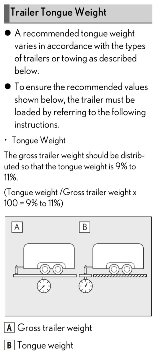

P. 186 of the 2024 OM. 9% to 11% of the trailer weight. So nominally 900lb.

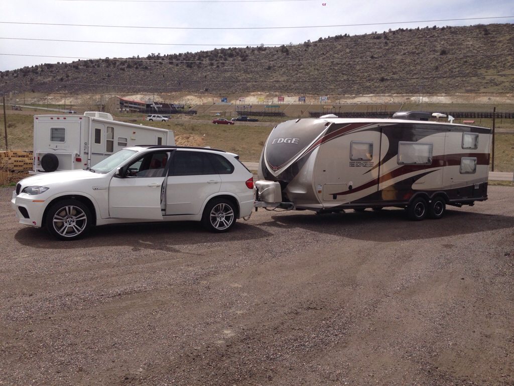

My .02 is to stick with that nice X5. It has all the factors that make it a great place to hang a motorcycle off the back. Independent rear suspension, low to the ground, short distance from wheels to hitch, wide rubber and air sus (sometimes). I towed heavy with an X5M for years and it was a super stable platform for it. GX has the frame but it is, ahem, dynamically challenged (on road) imho, nevermind hooking something up to it.
