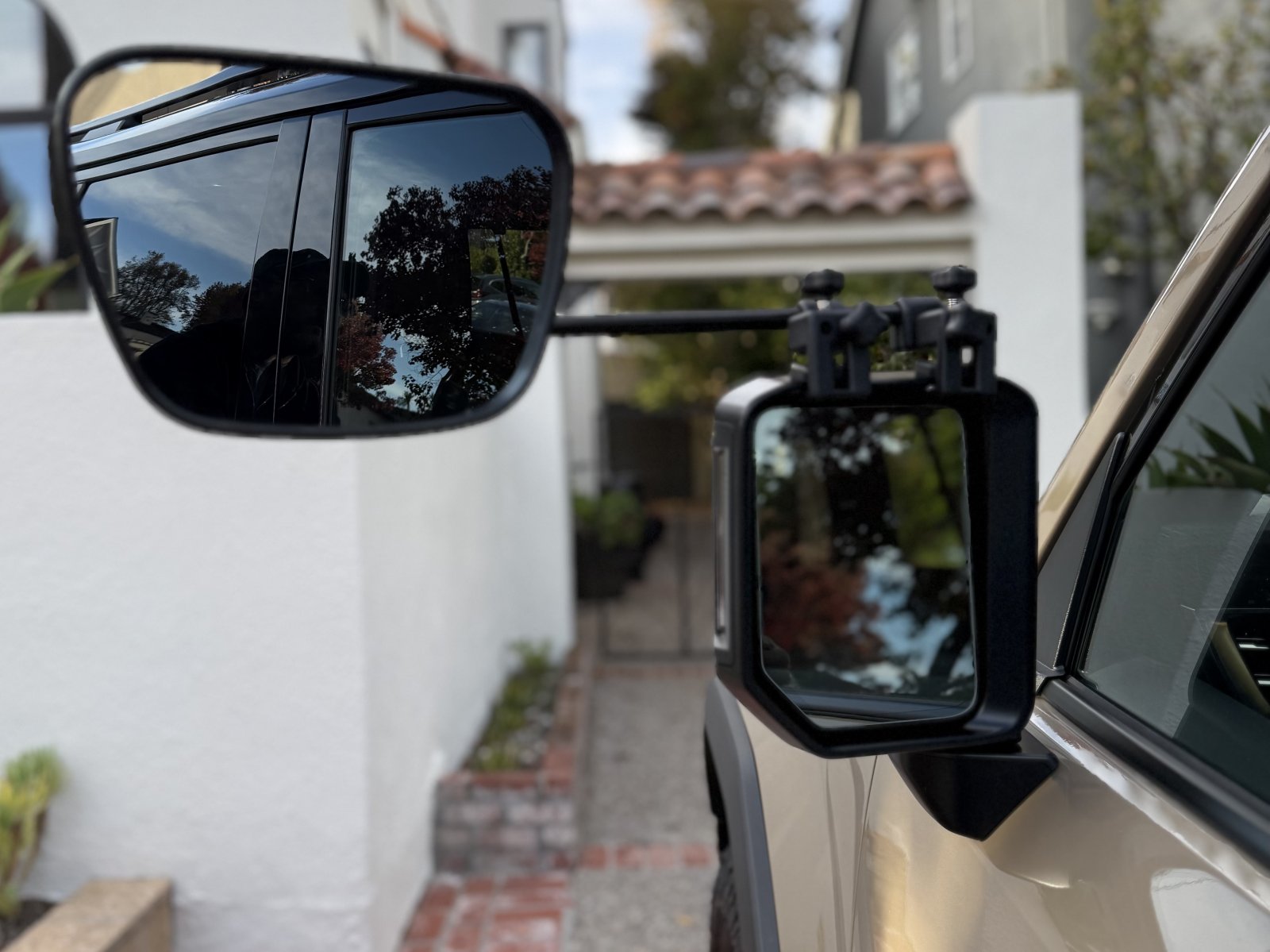

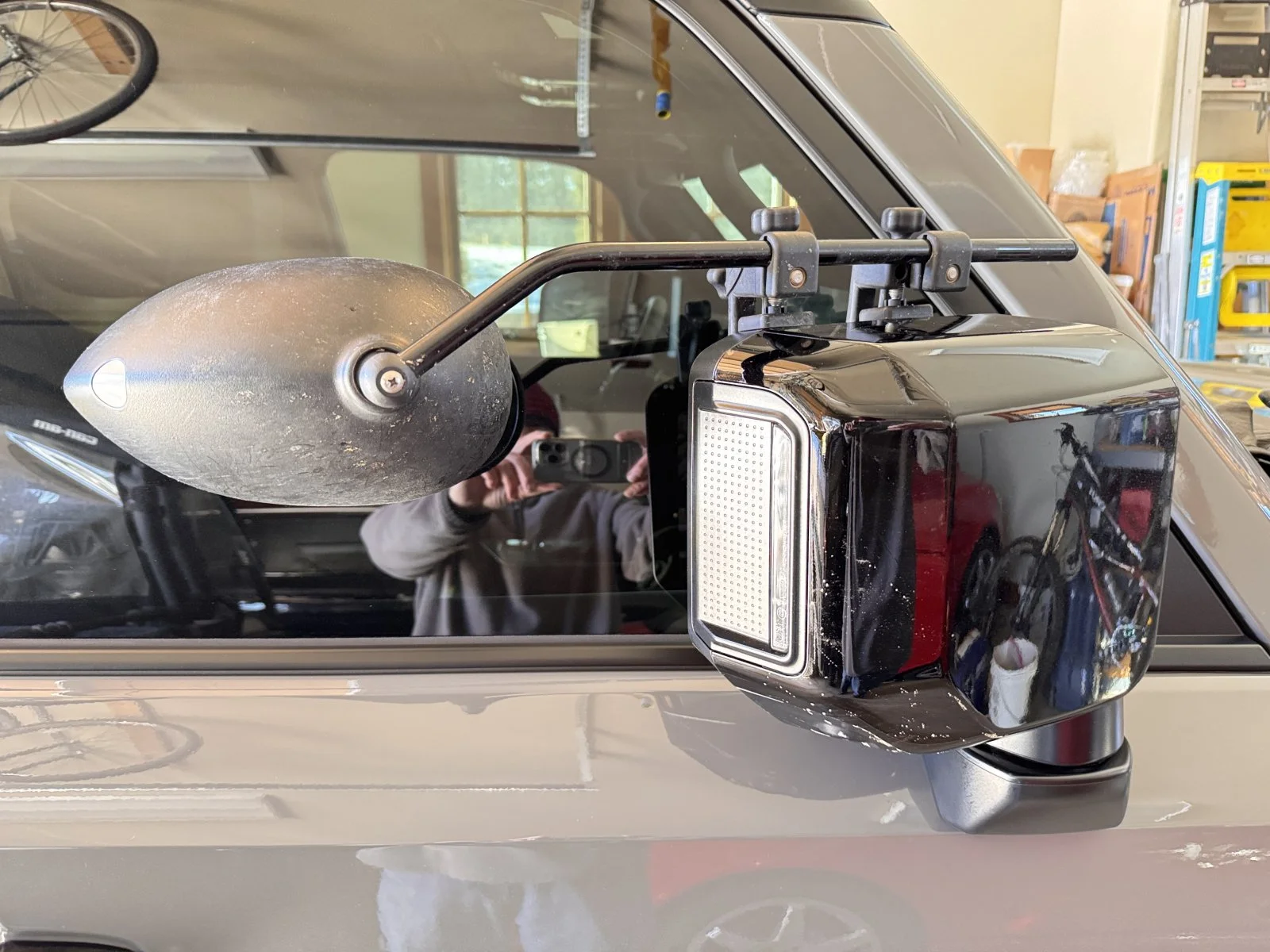

TOWING MIRRORS SOLVED!!!
After several brands purchased then returned, I have a solution that works, extends the mirrors quite a long way for towing a camper, and still allows the mirror to self fold without banging into the door. I’m so excited!
MIL-2912 Grand Aero 4 Towing Mirror - Pair​
Bought from Amazon:
Amazon.com

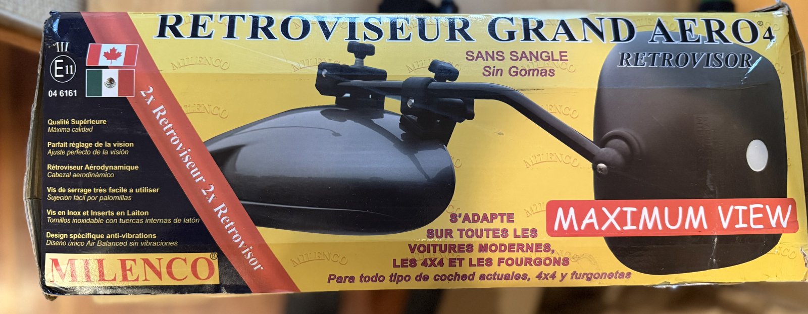

Here is a quick picture of the box and a picture of the left mirror after I installed it. The mirrors swivels into various positions, and feels very secure.
View attachment 5235View attachment 5236
Please note that in my original post I had listed what I thought Amazon sent. But i have since gotten several other versions and had to return them. The only one that fit well is this 2912 one:

I got them, tried to mount them and they seemed solid for about 5 minutes then the easily wobbled off with just light pressure. While I am not doubting you got them to stay on well, I'm wondering how? We mounted like the photo on the box but there is no instruction manuals. Can you share pics on how you mount them that they stay on please?
Mine were solid but they’re in storage at the moment. I had uploaded a picture. Here it is again.
Thats how we attached but the curved top part of the clamp just wouldn't sit. If you get a chance next time you bring them out (maybe not until spring? :-) if you can get a close up of the clamp I'll give it another try.

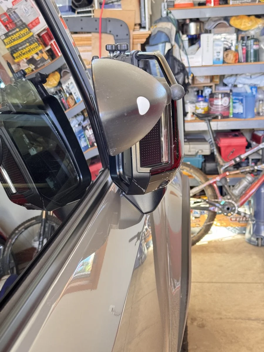

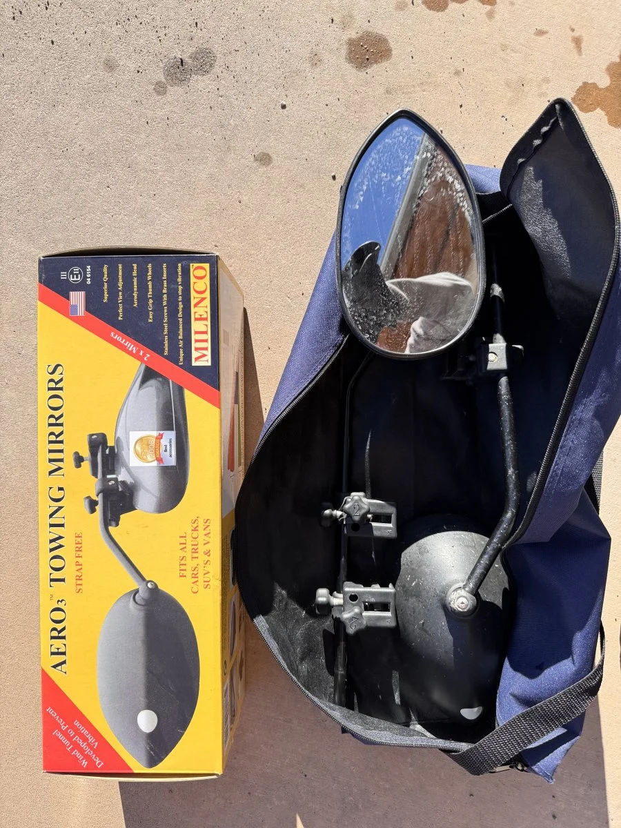

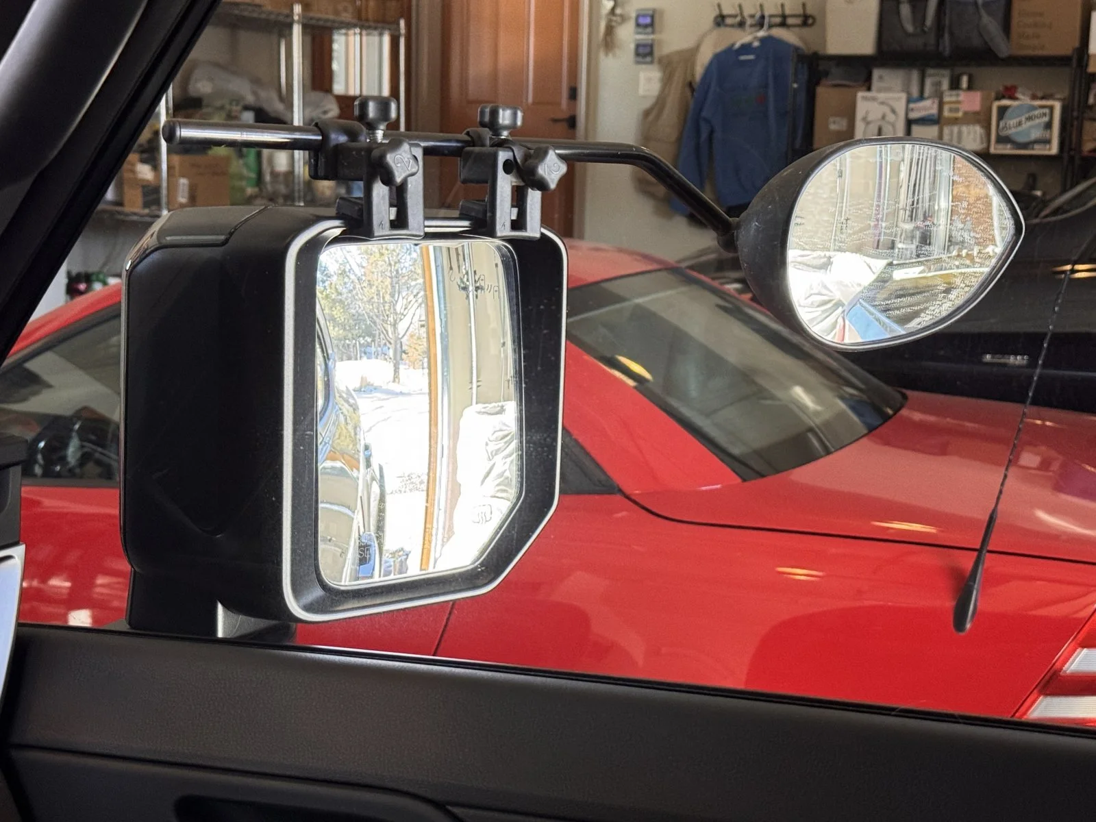

I have the Aero3 version from a few years ago. This will be the 3rd tow vehicle to use them on. I did a quick test today. Seems like they’ll work for me.

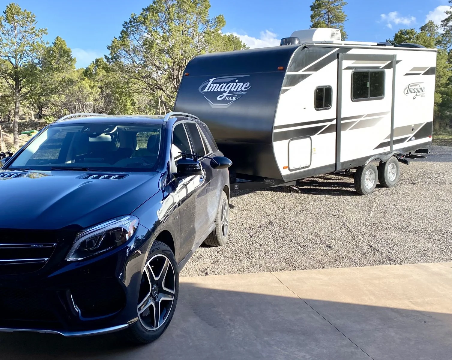

That clamp looks like it is flat on both surfaces. That would work better. The one we have - which otherwise looks pretty identical - has one of the clamp surfaces rounded like for clamping on a pipe and that is what caused us the issue as far as I can tell.

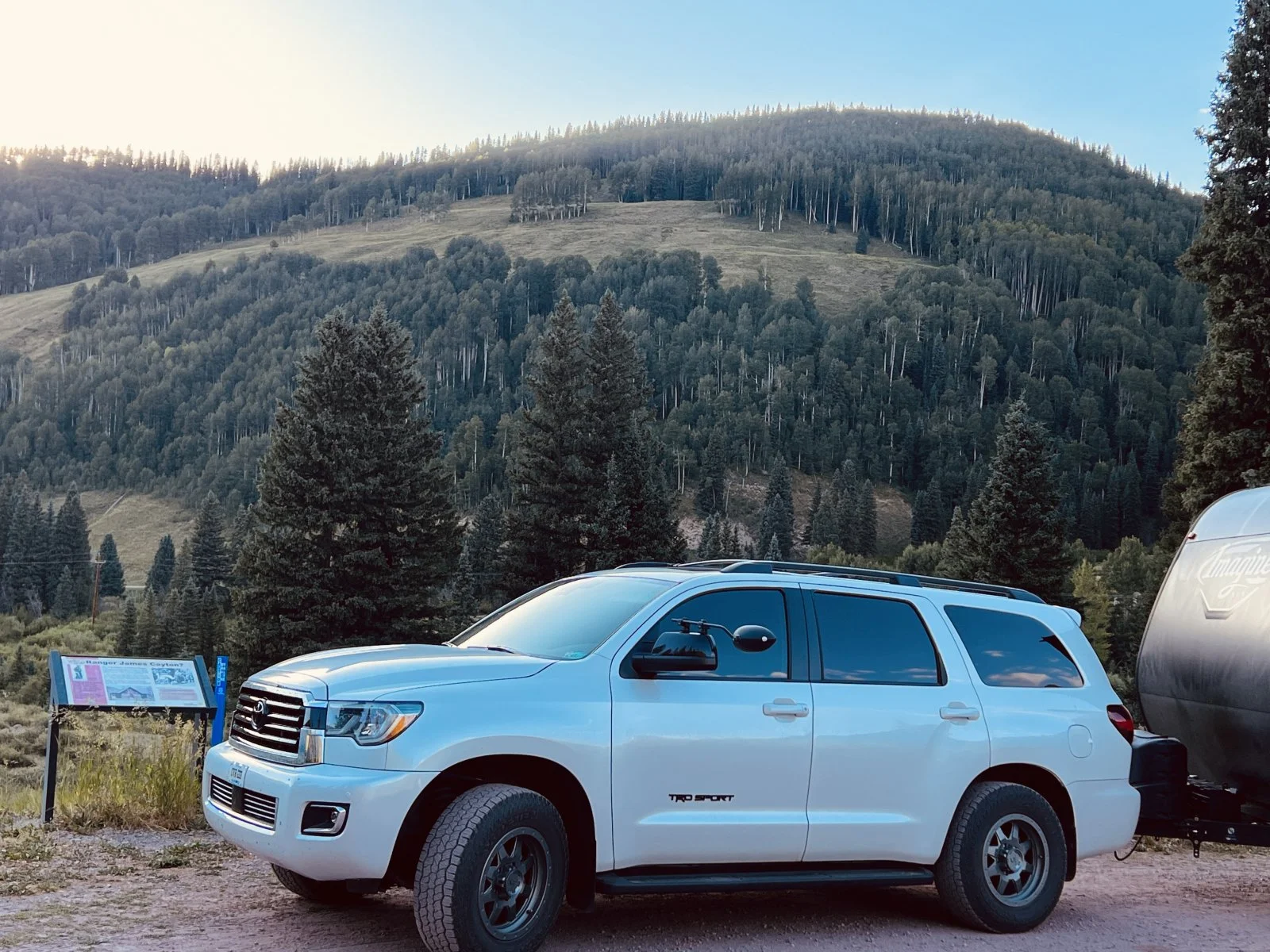

Cilles,
Yes both surfaces of the mirror clamps are flat. As you see, bottom is thinner to sneak into a tight fit between the glass and mirror frame/box. Both are rubberized for grip..but top one is thicker and a bit more foam-like. The top one clamps/reaches onto only the non-glossy portion of mirror frame..which is nice as I just had entire front end PPF’d, including glossy part of mirrors.
They grip very well, never had one fall off 2 previous tow vehicles. I usually slightly re-tighten at first stop….
I might comment that the angle of the GX mirror box that the clamps hold to..is more severe than my previous 2 vehicles. So..I will drive and test and see if the clamps want to loosen at highway speeds. If so then I’ll try a tiny piece of very strong double sided tape on the inside of mirror box to provide more grip.
Let me know if more detailed pics would help. I just attached pics of same exact mirror set on the other two cars..
UPDATE 7-8-25: Wanted to add that I’ve towed twice now with the Aero3 model described above, including freeway speeds (to/from Moab) and they are working very well on the GX, just as on my 2 previous tow vehicles. Easy on, stay on, easy off.

Thats the thing, the ones we got, while otherwise looking the same as yours have the top part of the clamp curved like it is to go around a round bar. This breaks the entire system. 😥😥
