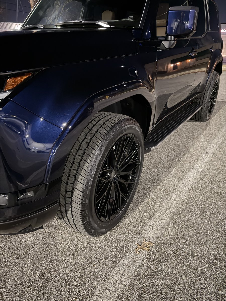

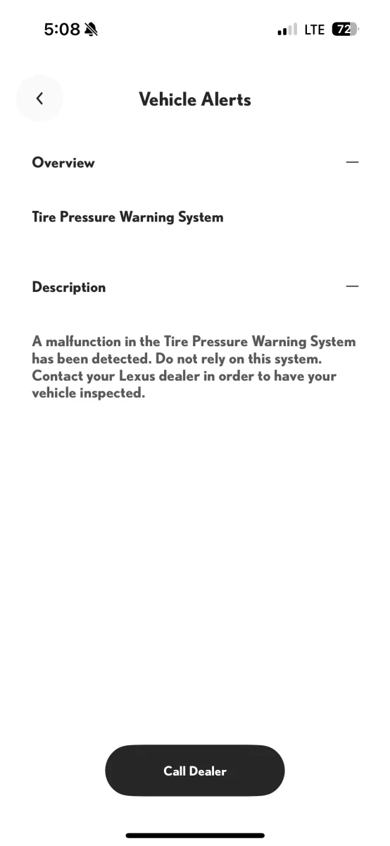

Hey guys, want to bump this topic.
I just bought and installed 4 OT wheels and tires on my premium plus. Drove for two days with no issues and today after a second (>30 min) drive, the malfunction message appeared. My tire sensor light came on and the setting tell me the system malfunction contact dealer... My spare is still a premium plus, only changed the 4 OT driving wheels. I assume if the OT wheels didn't have the sensors, I would have gotten the error days ago...

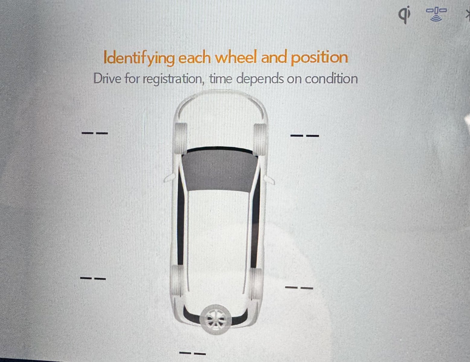

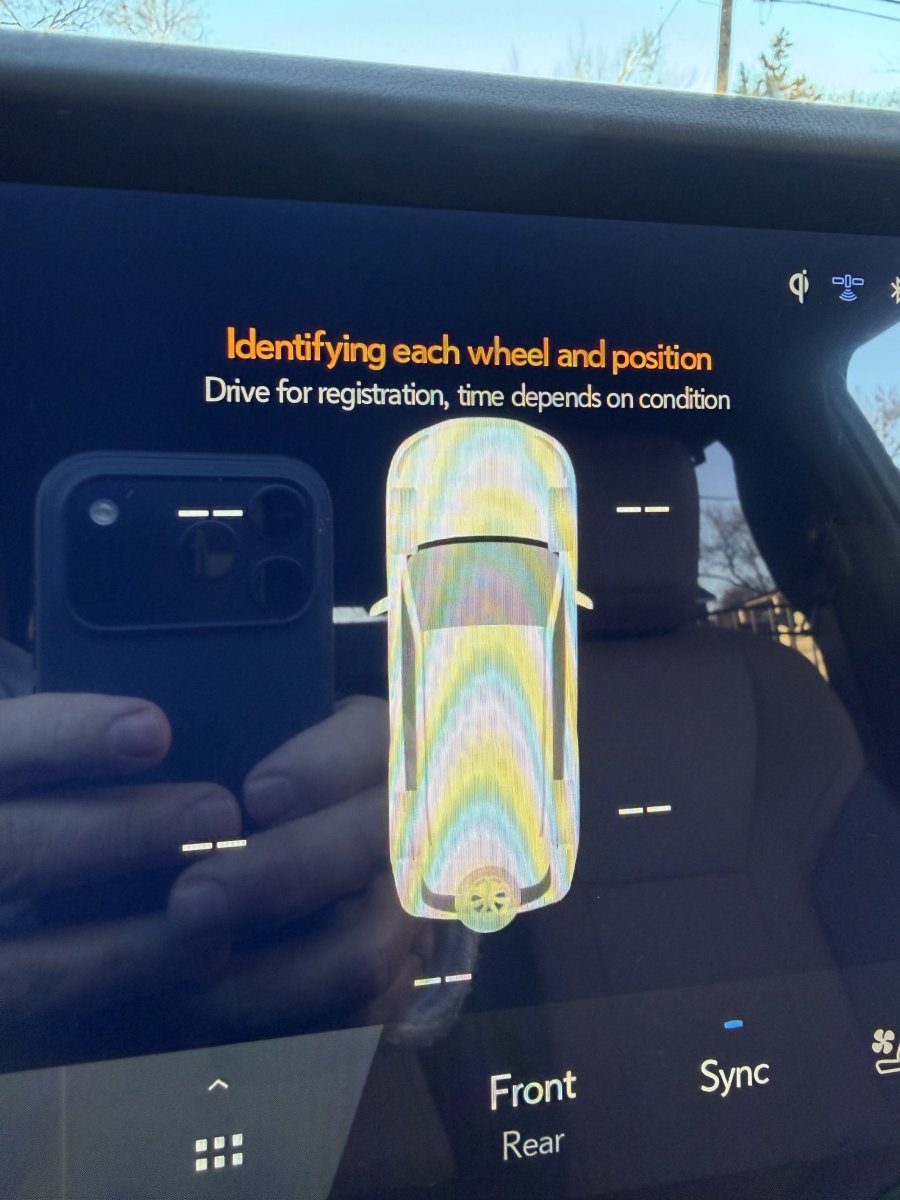

I've been stuck in this mode for 3 weeks now. I replaced the OEM wheels and tires. New TPMS sensors from Dill were installed as well. I took the GX to the dealer have the register the new codes. I left the dealership and 3 weeks later I still have a message that says Identifying each wheel and position. Most of my trips have been around town. But I did take 2 trips on the interstate to the lake. Each trip is 1 hour unstopped each direction. No change :-( I guess it's time to take another visit to my local Lexus dealership.
IMO the dealer should've directly programmed the new TPMS codes vs activating the self-learn function, you could have done that at home through the menus and if your dealer charged you for that it's a bid shady.
I have a TPMS tool since I do the seasonal tire swaps for my family at home, in my experience the self learning function on Toyota's is a bit hit or miss. TPMS registration through OBD/computer works instantly.
If your old wheels & TPMS sensors are within range of the vehicle when you start it, it takes 20-30 minutes of driving for the vehicle to recognize that it's lost TPMS signals and throw an error. This is what happened with my car, since my OE wheels sit in the garage next to the GX.
If you believe you have TPMS sensors, then you simply need to register them with the vehicle through the infotainment. New genuine Toyota sensors won't auto-learn, unlike aftermarket sensors which clone an existing sensor ID.
I'll also leave a link to my post in your other thread, MBearGX, detailing the exact process I used to get my wheels registered within 5 minutes of driving: TPMS Sensors not recognizing after OEM OT wheel swap

Thanks for the write-up. All very good points and exactly what was happening to me that my old wheels were in the garage and the car was sensing them initially... I took my GX to the dealer and they could not locate or connect to the sensors that are (technically) supposed to be in the OEM OT wheels. I will have to remove the rubber and see if they are there or just swap our my originals back to the OT wheels which will be the best option as they are already linked to the car.
This is going to cost double but unfortunately, don't have any other choice...
I did try going to press through the menus a couple of times before going to the dealer and asking them to program the new TPMS. It wasn't immediate and they said I should drive around and it would eventually register them. No luck so far.
