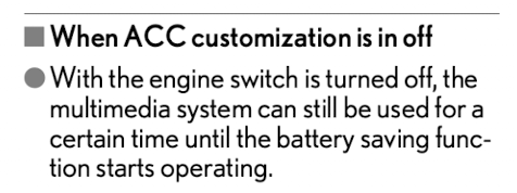

I had the same issue as YellowLab - it seems like some of us have ACC Customize on by default, and others off. It's such an ambiguous name for a feature, but I'm sure it's in the manual.
Yeah, the wording was definitely not what I would have expected. That's why I spent way more time than I would have hoped digging through settings and trying different search terms while I was figuring this out for myself over a year ago when I got my GX.
From page 197 of the manual:
