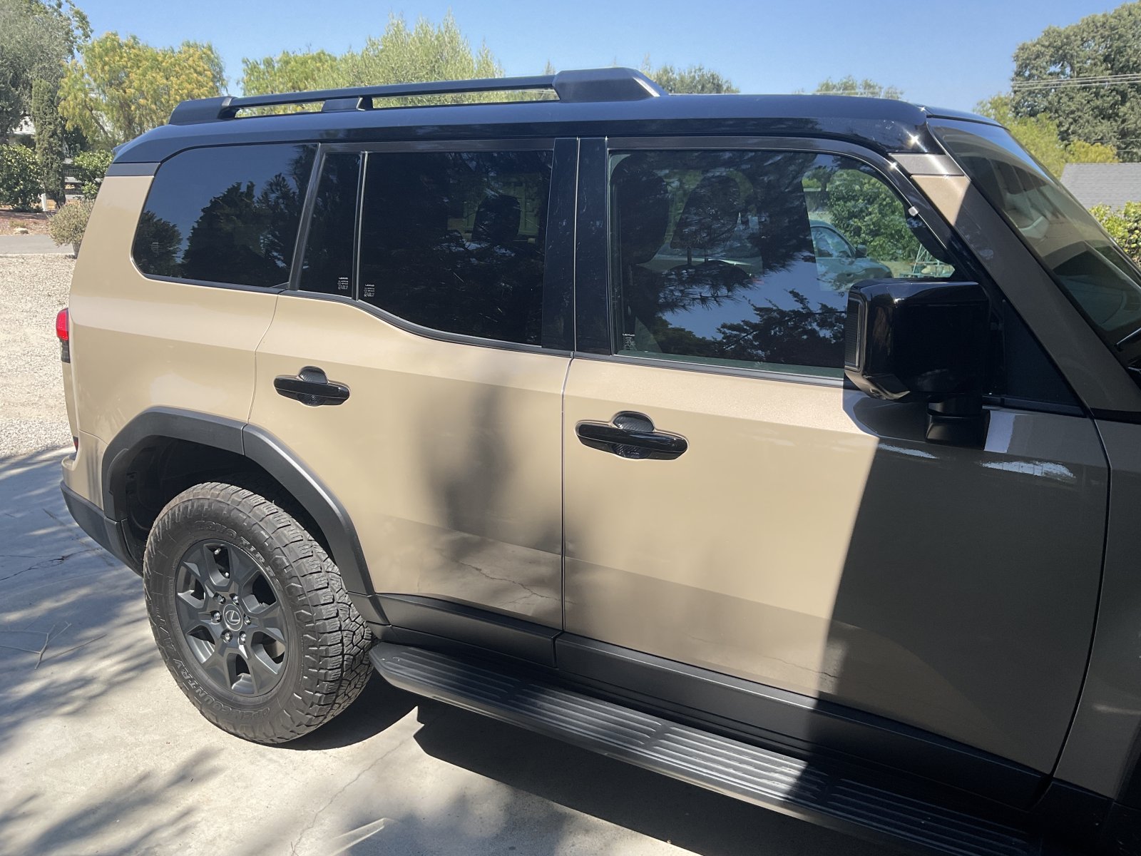

Hard to tell from picparked next to a 2025 OT+ interesting to see the difference in stances compared to my 2024.
