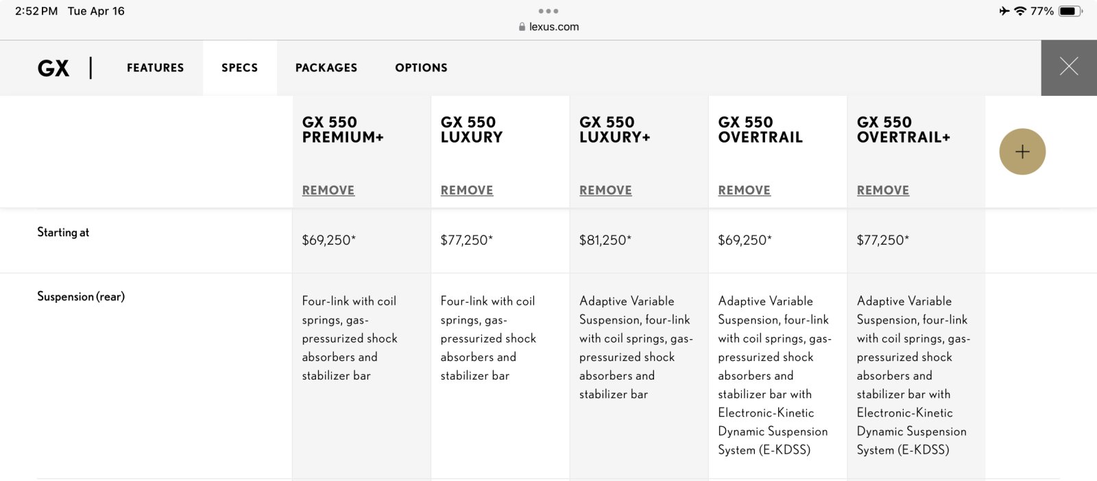

I’ll drive 99% on the road. Which trim would you expect to have a smoother ride on a road surface? Overtrail with the E-KDSS?

Keep in mind that the "Luxury" or "Premium" trims refer more to accessories/options that the GX is equipped with than to a difference in suspension/ride. The Luxury+ trim does get the Adaptive Variable Suspension, which will improve the ride, but all the Overtrail models get the most advanced suspension along with smaller wheels and tires with more sidewall.

I think the overtrail would have the best ride because of EKDSS. It’s slated to be a great on road advantage to keep the vehicle flat in corners and over undulations and imperfections. It’s a shame kdss wasn’t standard for all trims.

Note the both the Luxury and Overtrail models come with Adaptive Suspension but only the Overtrail has the larger tires / taller sidewall. The 22" wheels on the Luxury model will probably corner better but not offer as much cushion. If you set the adaptive suspension to Comfort, the rebound rate is a bit more plush and slow, vs. Sport+ which tightens up everything and makes cornering firmer.

I also want to note that for on-road use, the E-KDSS system is not really in play as often; it uncouples the front and rear sway bars to allow the tires to travel further up and down (ie. "articulate") -- up to 24 inches, which most roads hopefully won't require. If you keep your GX on the road mainly, you may not notice whether E-KDSS exists at all (since the driving dynamics of cars with and without it are the same on-road).
I've heard that the OT &OT+ have a slightly larger E-KDSS bar than the other models in the 550 lineup. This helps contribute to the OT models handling a little better on the road with less roll in the corners.
Great point - from images and video of the underside, the bar looks beefy. I would be curious to know the size difference between the different trims.
