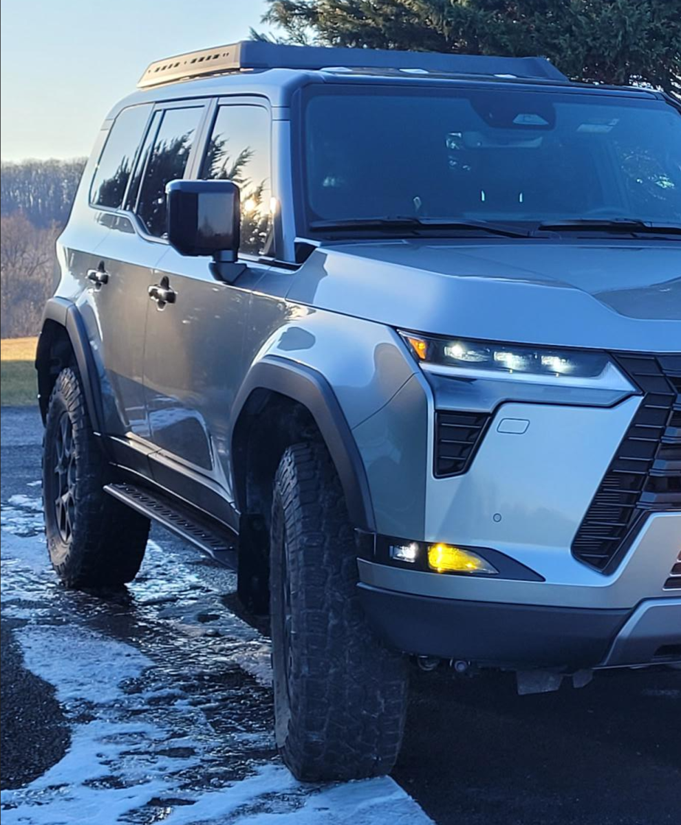

In for pics. This is what I plan on running

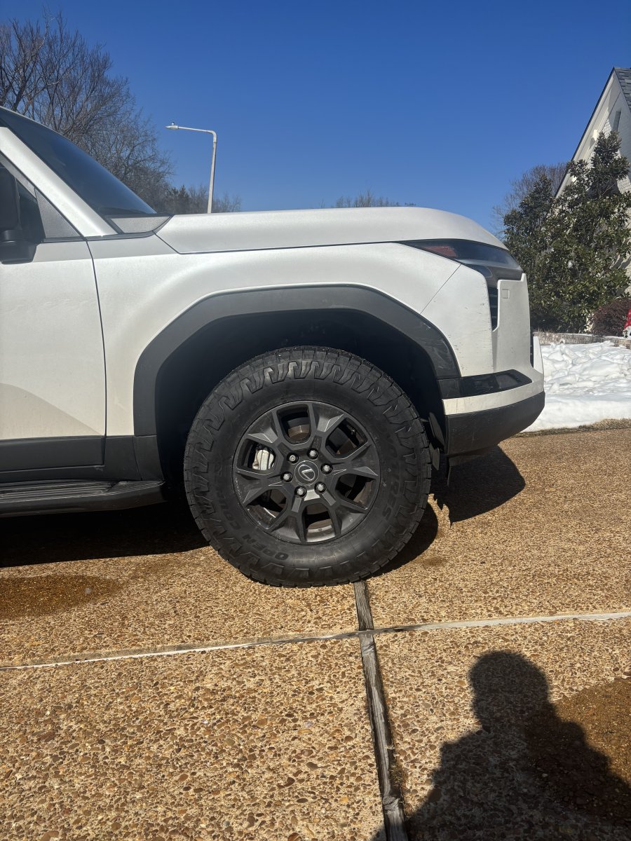

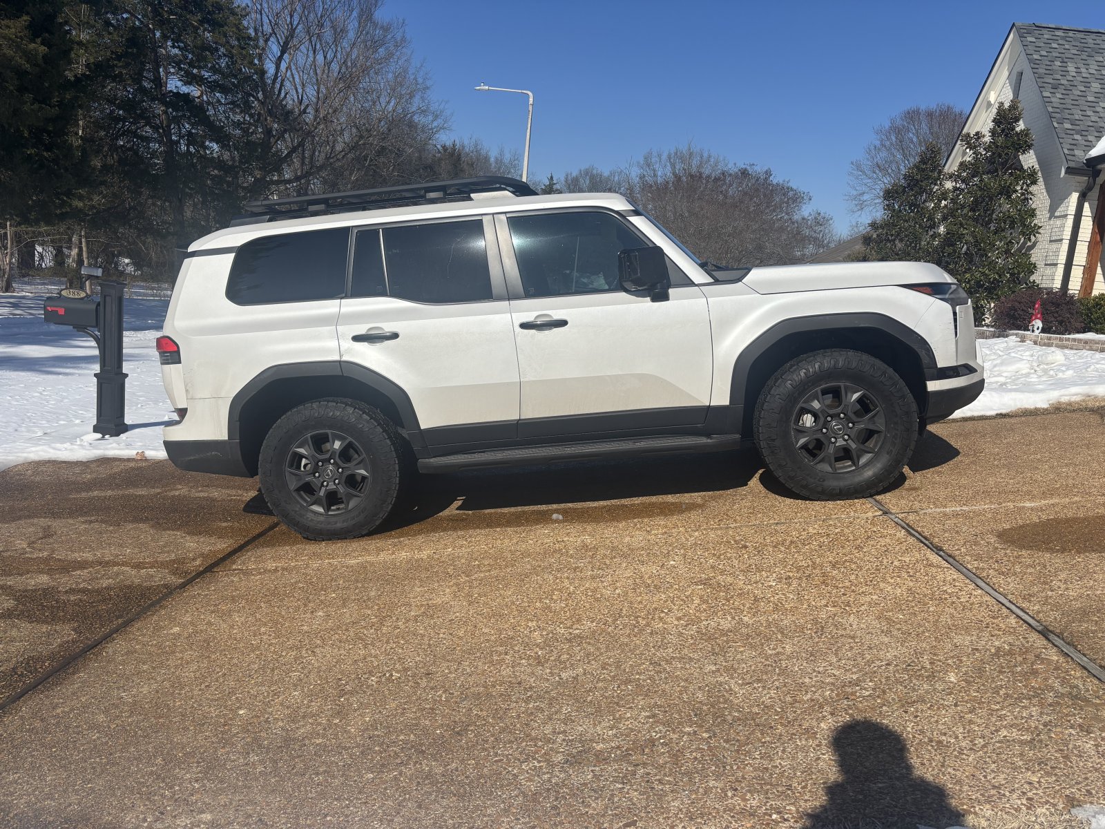

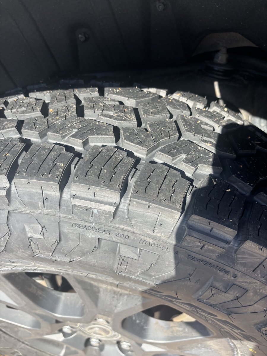

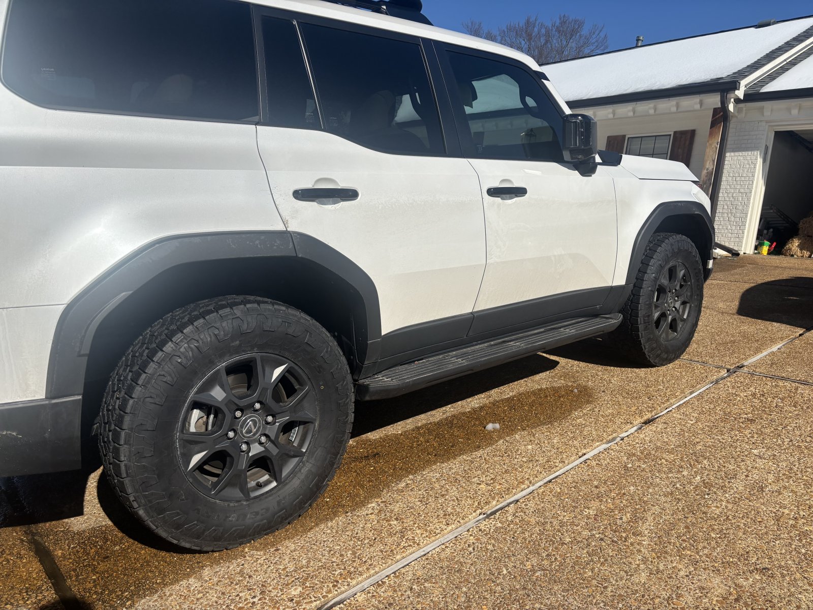

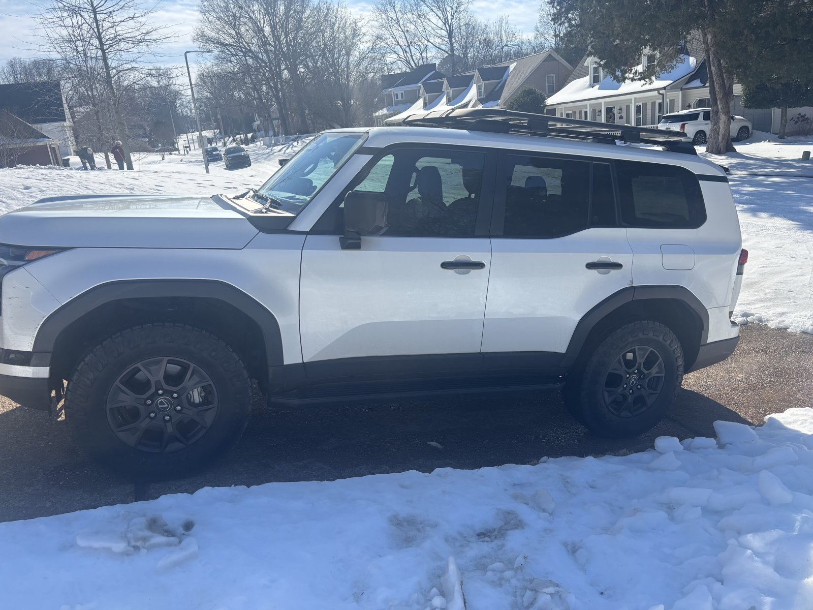

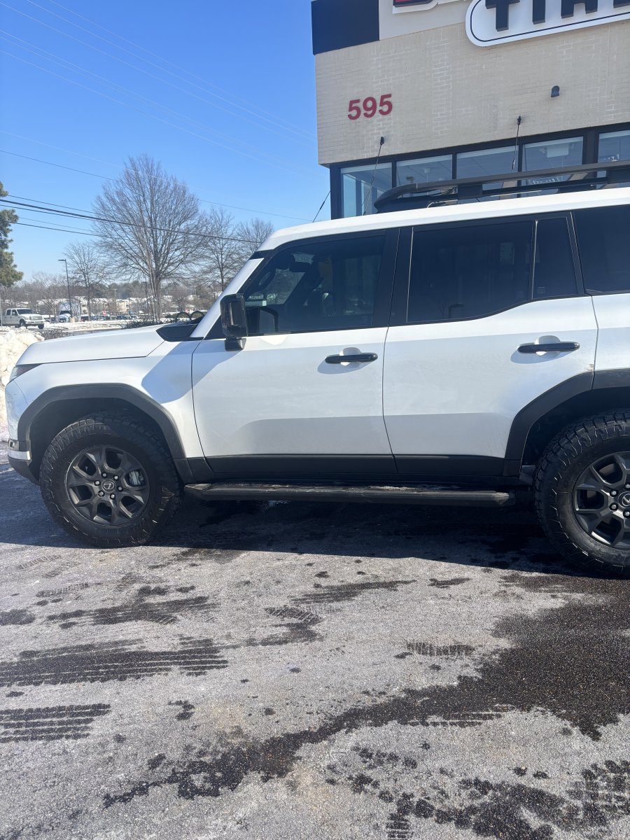

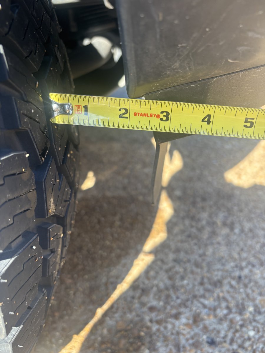

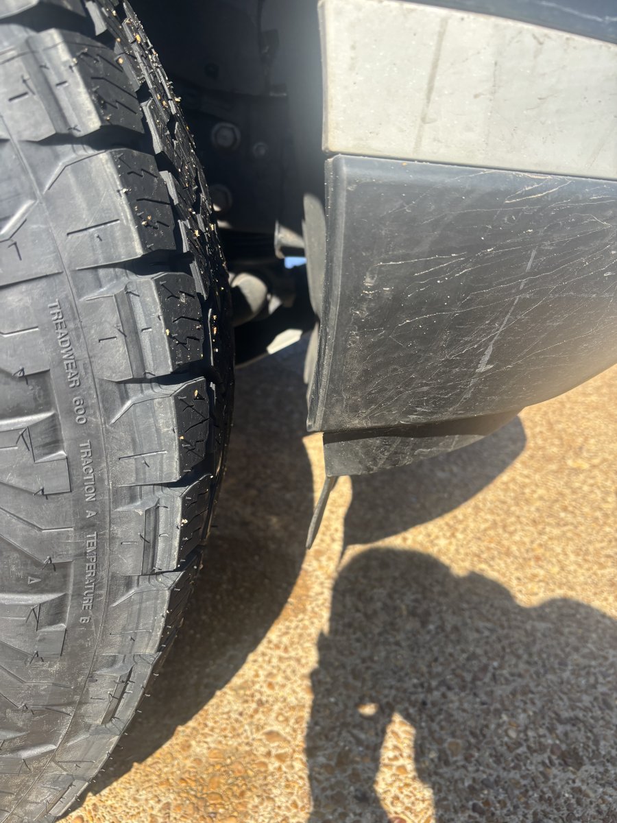

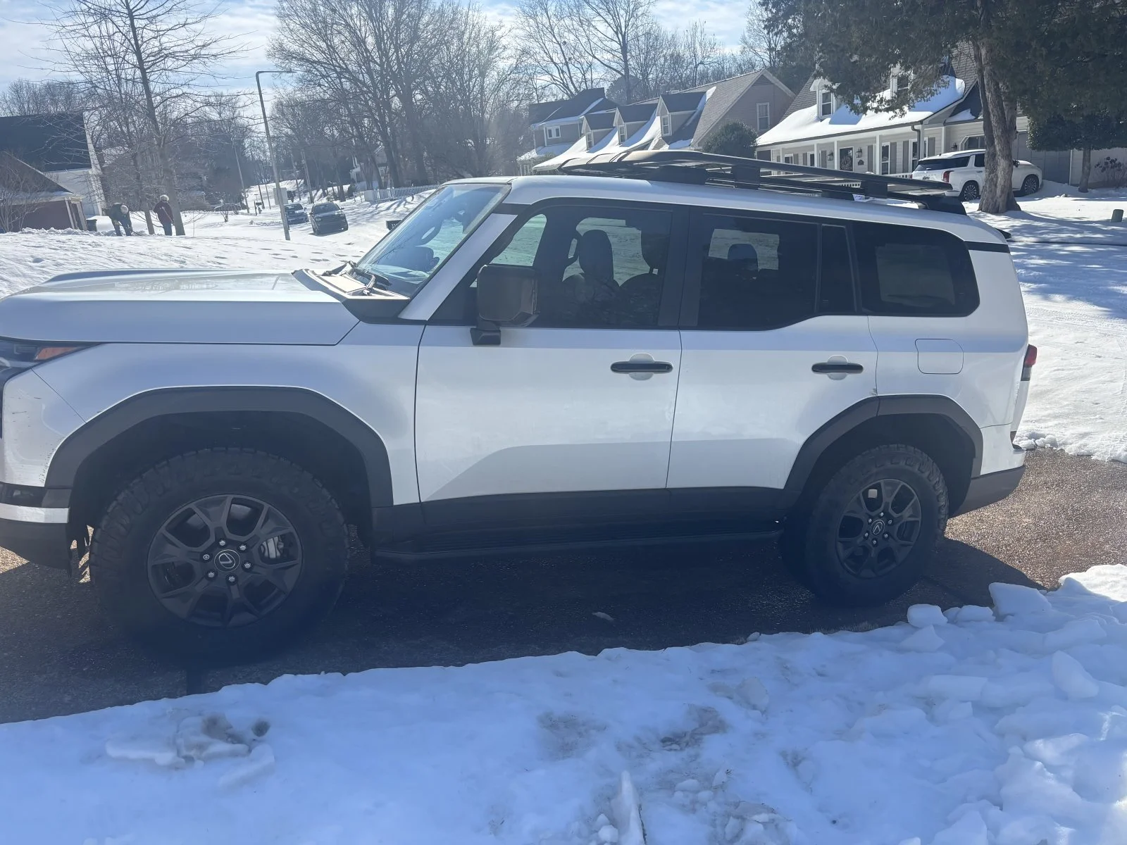

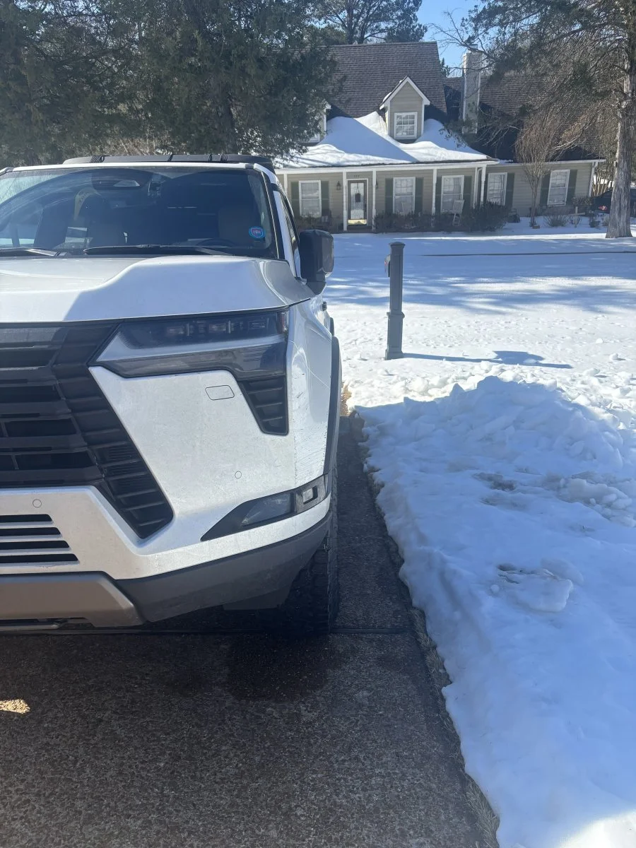

Got the the 275/70/r18 toyo AT3 open country EV SL tires put on today. They definitely look more substantial than the stock tires. The treads are much deeper than the OE overtrail tires. The OE AT3’s always looked slightly undersized to me. The 275/70/r18’s look to be exactly proportionately sized to the vehicle. From other’s photos, the 285’s look slightly oversized to me
I have photos below that don’t do justice to what they look like in person, but i have photos below that show how deep treads are and distance from front tire to front fender (just under 2 inches)

You're right - definitely look more proportional to the truck now, looks good!

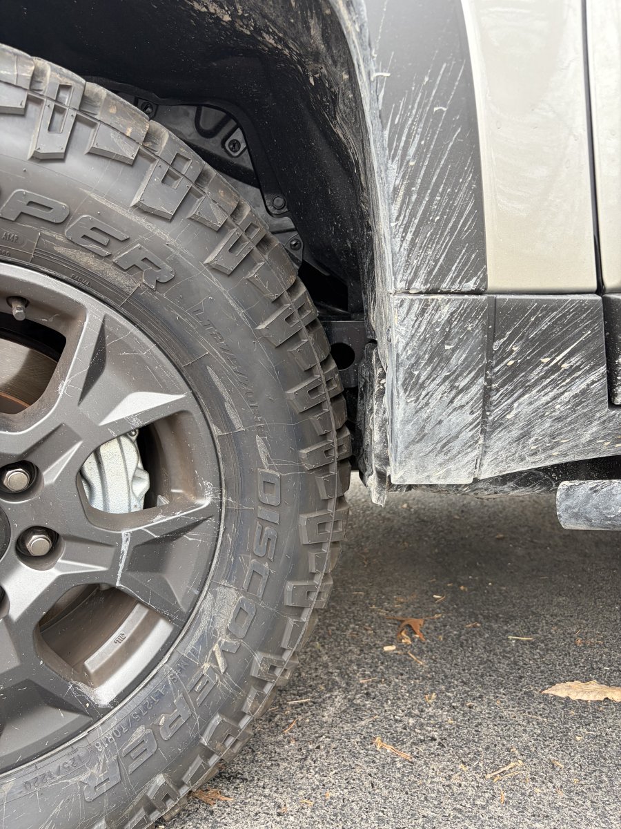

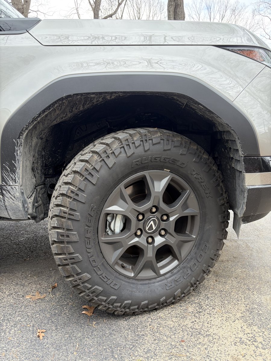

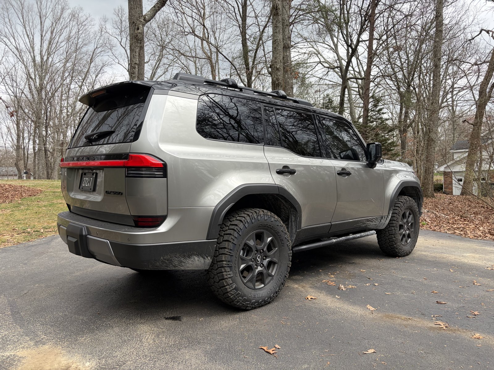

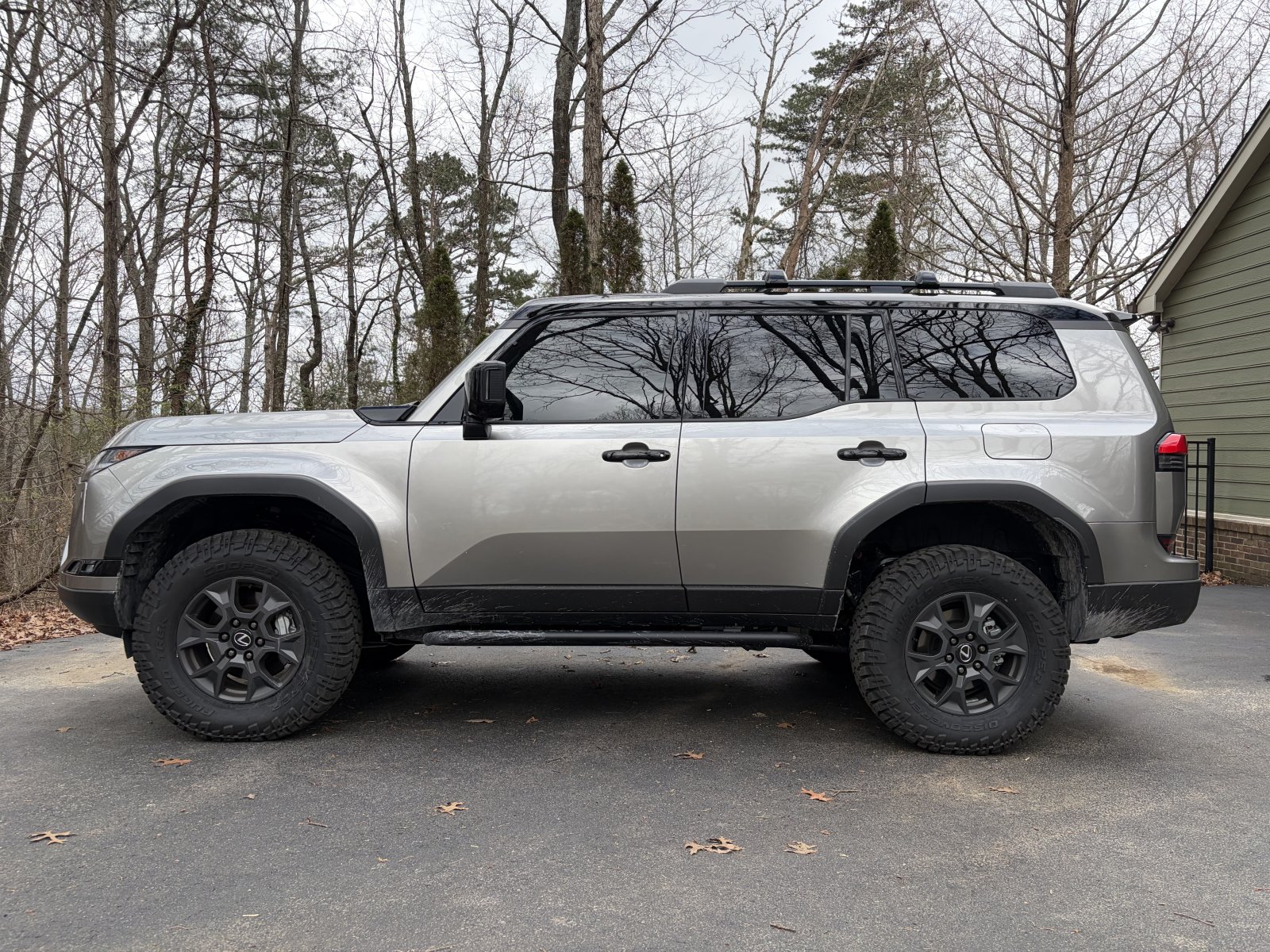

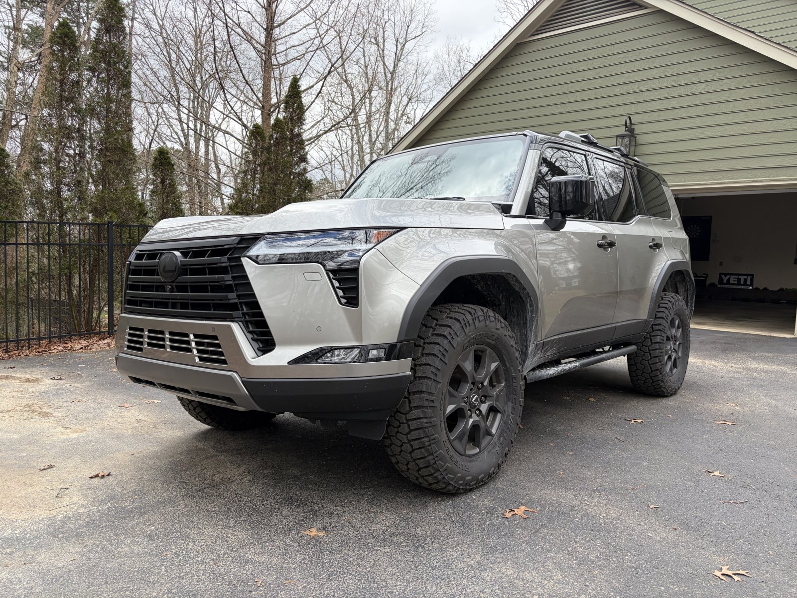

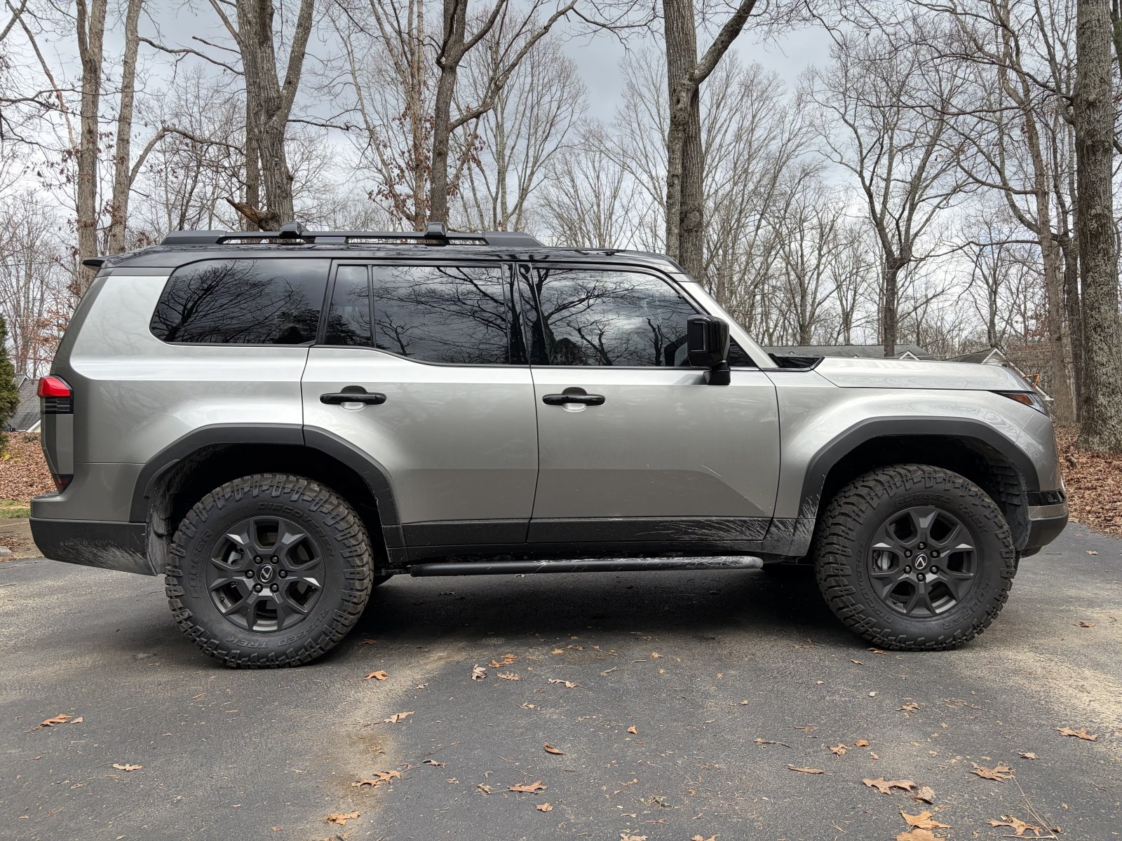

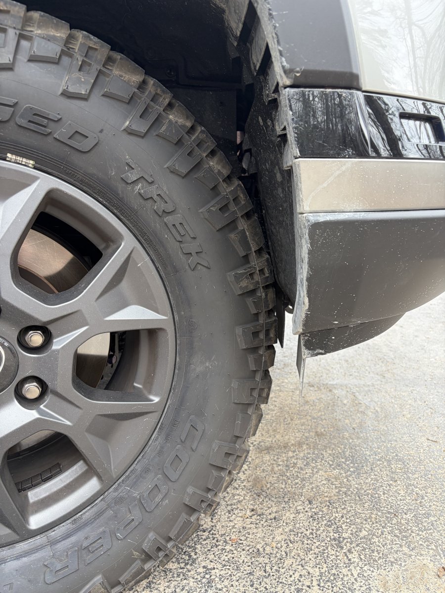

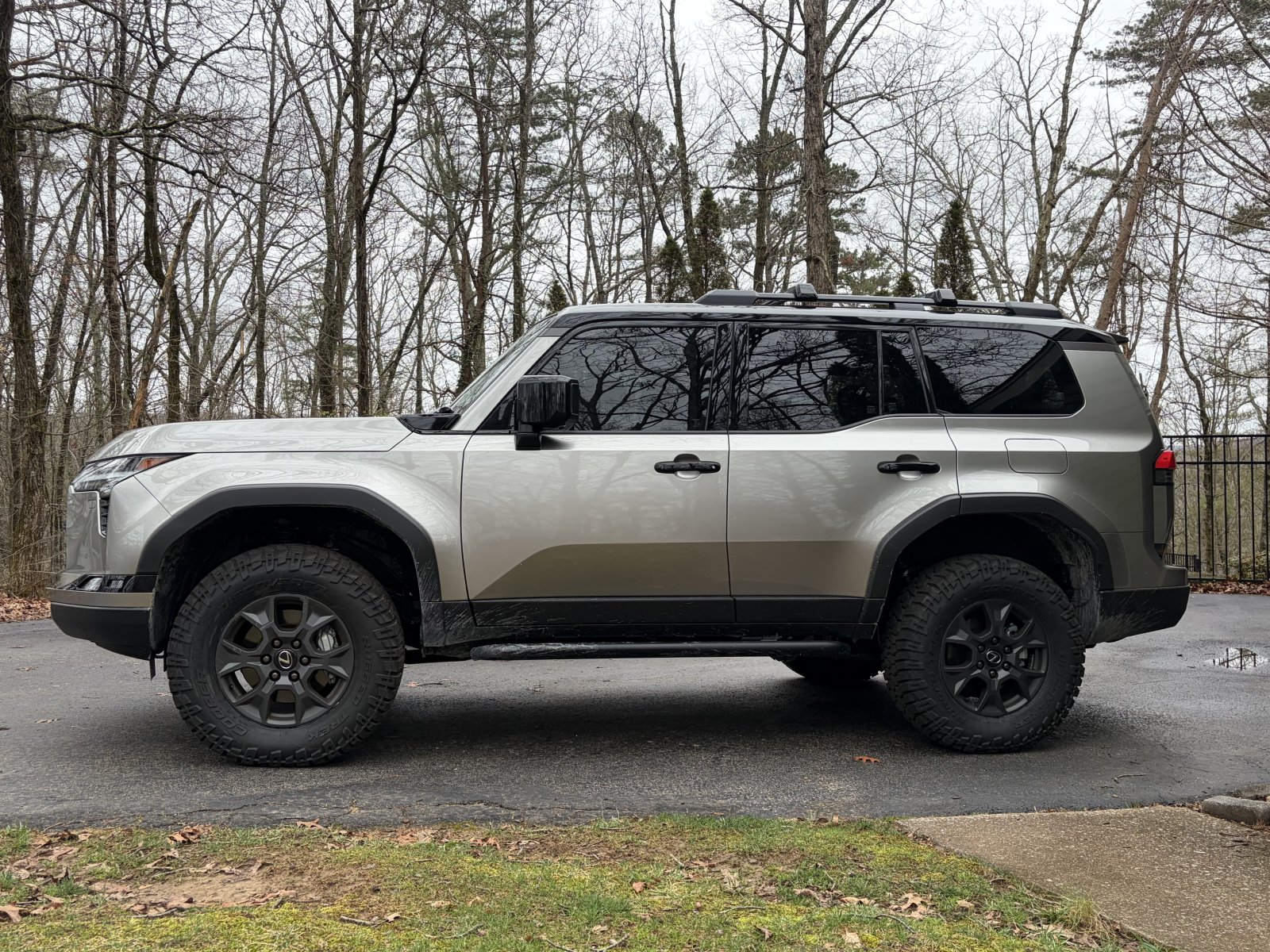

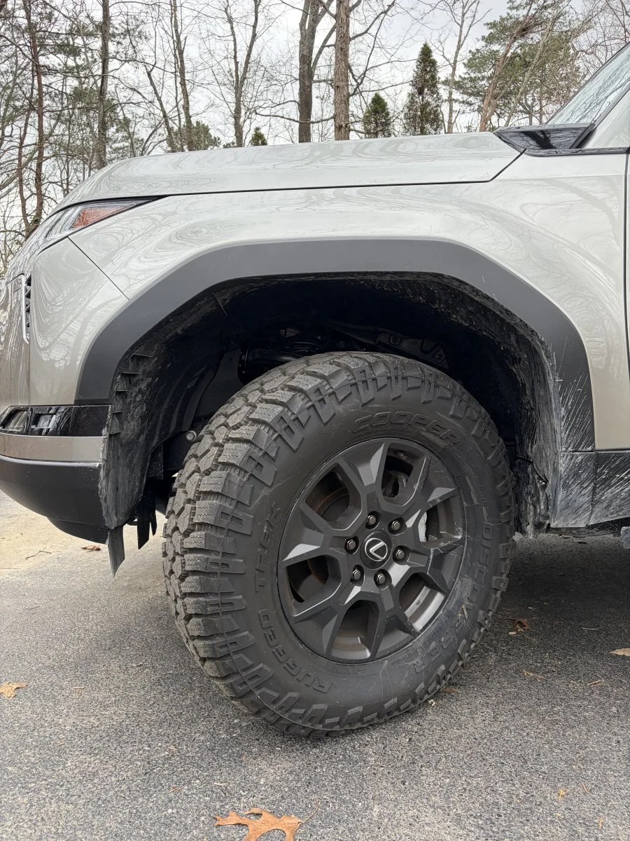

Update: WD 4-hole 1/2 front spacer with the 275 70r18’s Cooper Rugged Trek’s installed. The spacer removed .75” of rake (1.5 “ OEM rake to .75” rake). The tires, essentially thin 285 70r18’s at 33.7” diameter (like a pizza cutter for those with Tacomas), fit without any rubbing or trimming. I have about 1,000 miles on it since install and there is no discernible difference in ride with the WD spacers. The tires have been impressive for an RT tire. Quiet, absolutely no additional noise than OEM Toyo’s, and handle just as well. Like what this set-up did with the stance. Left a little bit of rake for heavy loads (I don’t tow with it) and the tires fill the wheel wells while leaving enough room for off road articulation.

Very nice, still liking these? I’m interested in these for my ‘26Lux+ along with nitto terra graps non-E rated on OE OT 18” wheels for more “off (fire) road” capability without losing stock settings. Looks like they fill the wheel well nicely & with no poke…
